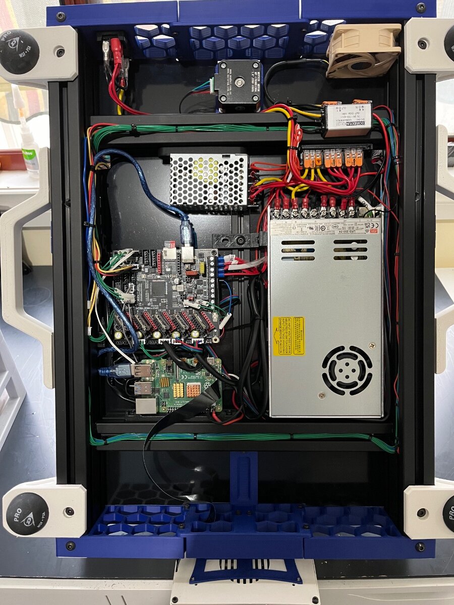

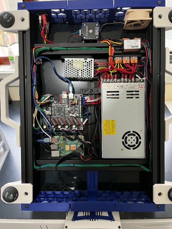

Well it was the board after all. Swapped the SKR1.4 out for the NEW SKR 3 EZ with 5160 pro EZ drivers running in SPI mode - beautifully SILENT! Left the inductive probe in for the interim but will swap it out for a clicky when I have the patience to do it.

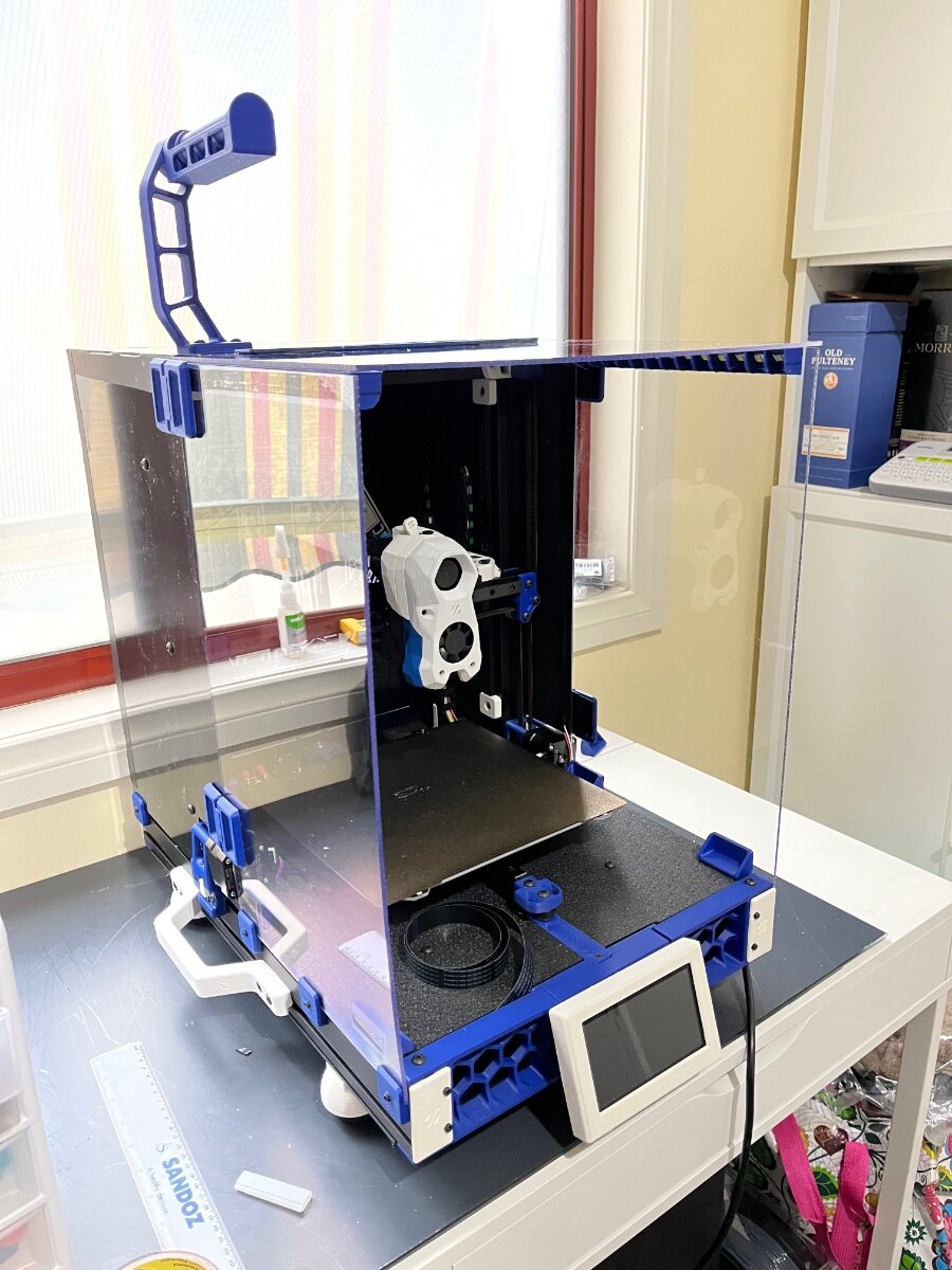

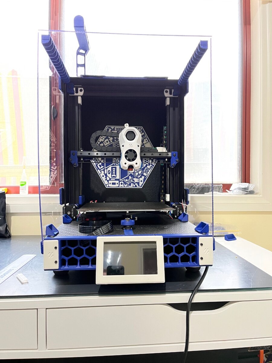

Started enclosing the printer - worst design for an enclusure I have come across so far. But then, The Voron design Team never meant for the switchwire to be enclosed.

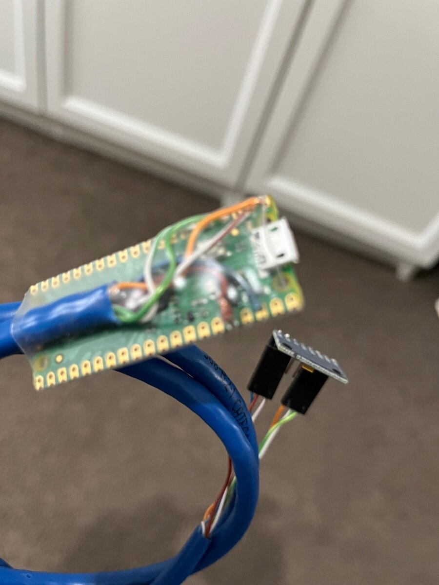

Have made the cable nero3dp demonstrated for input shaping and will soon put that to use.

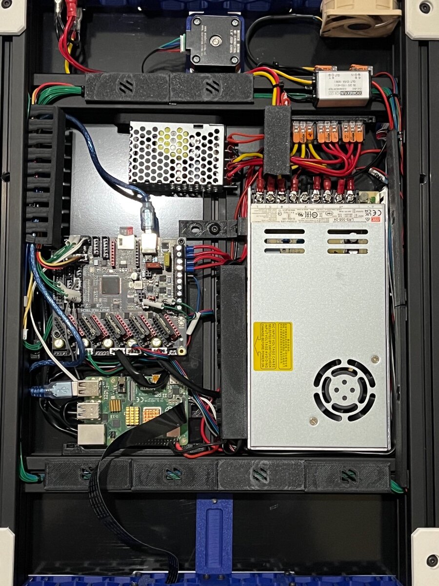

Electronics panel enclosed after tiding up wires.
