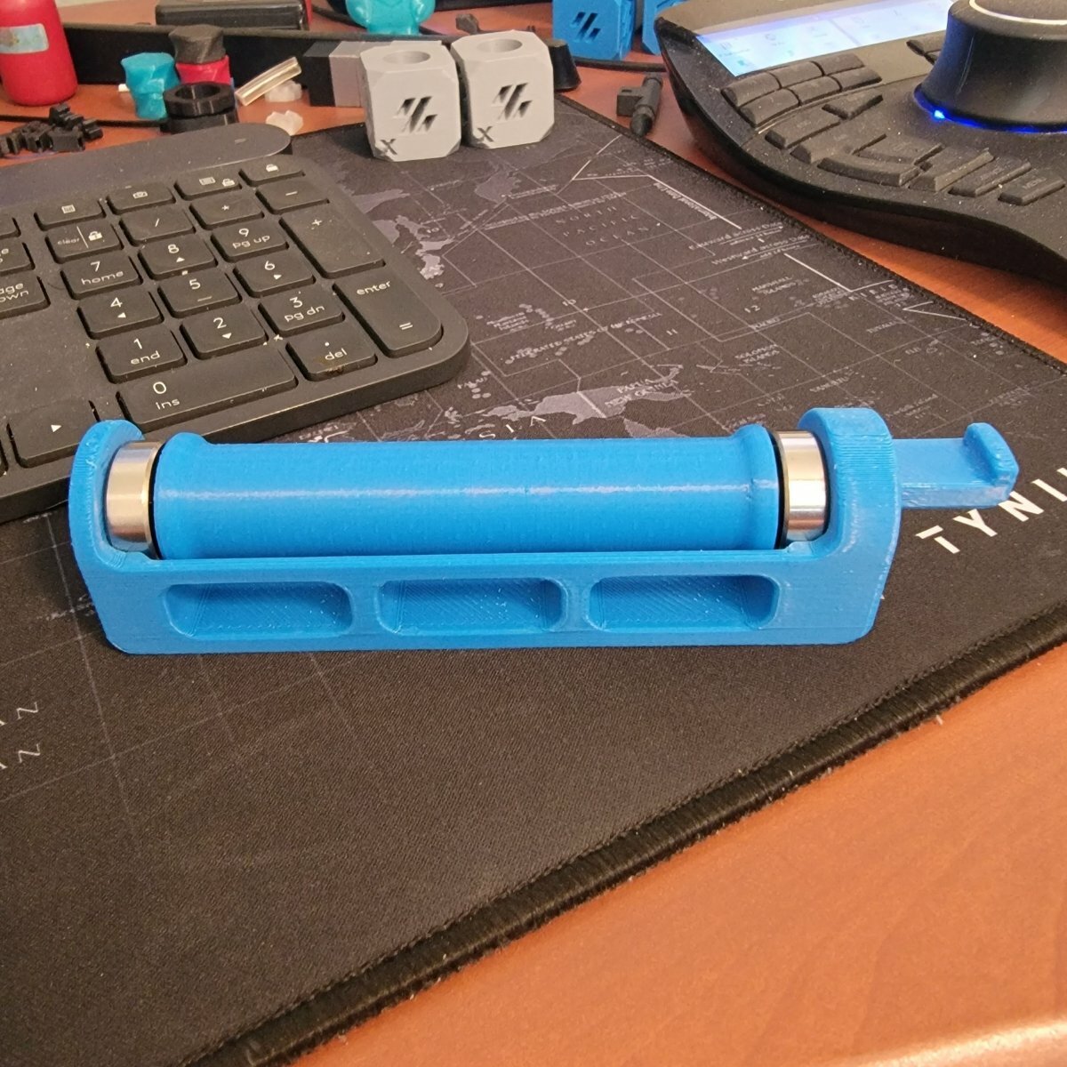

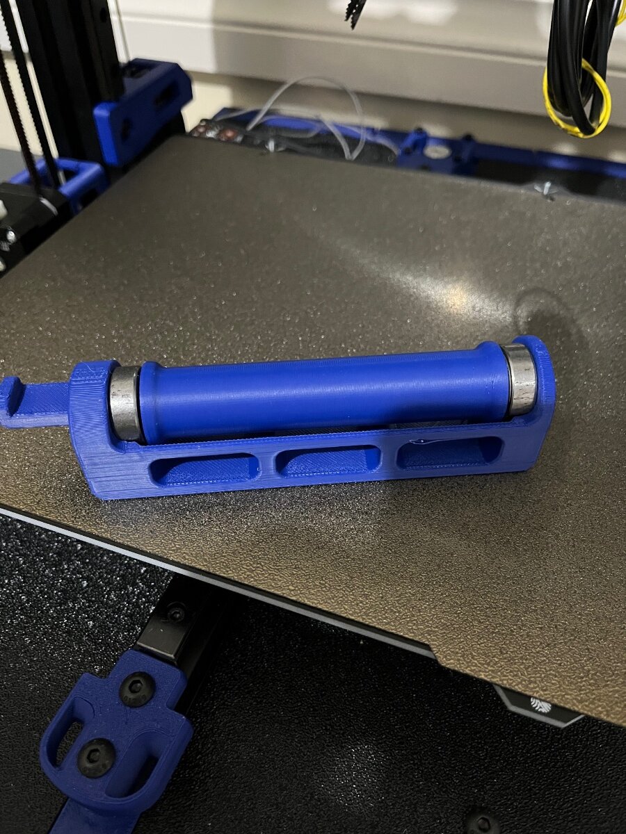

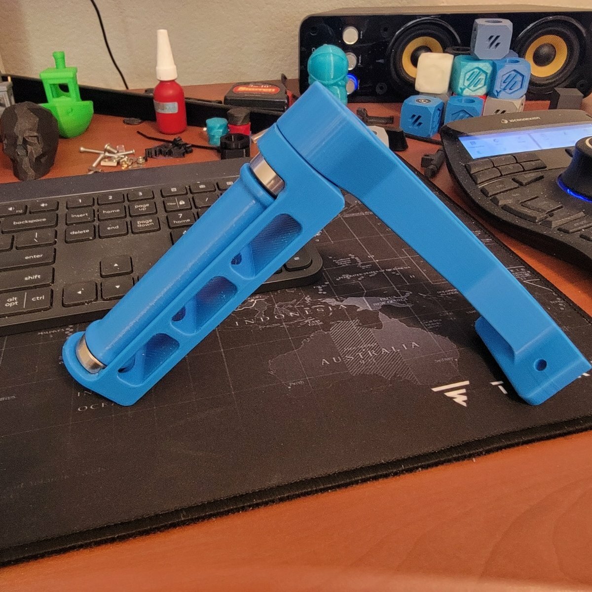

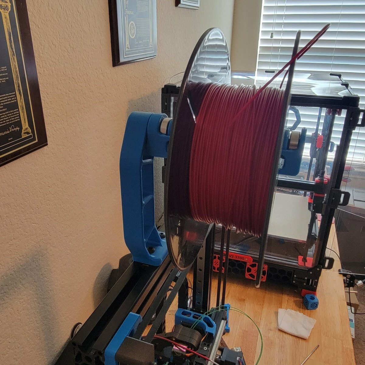

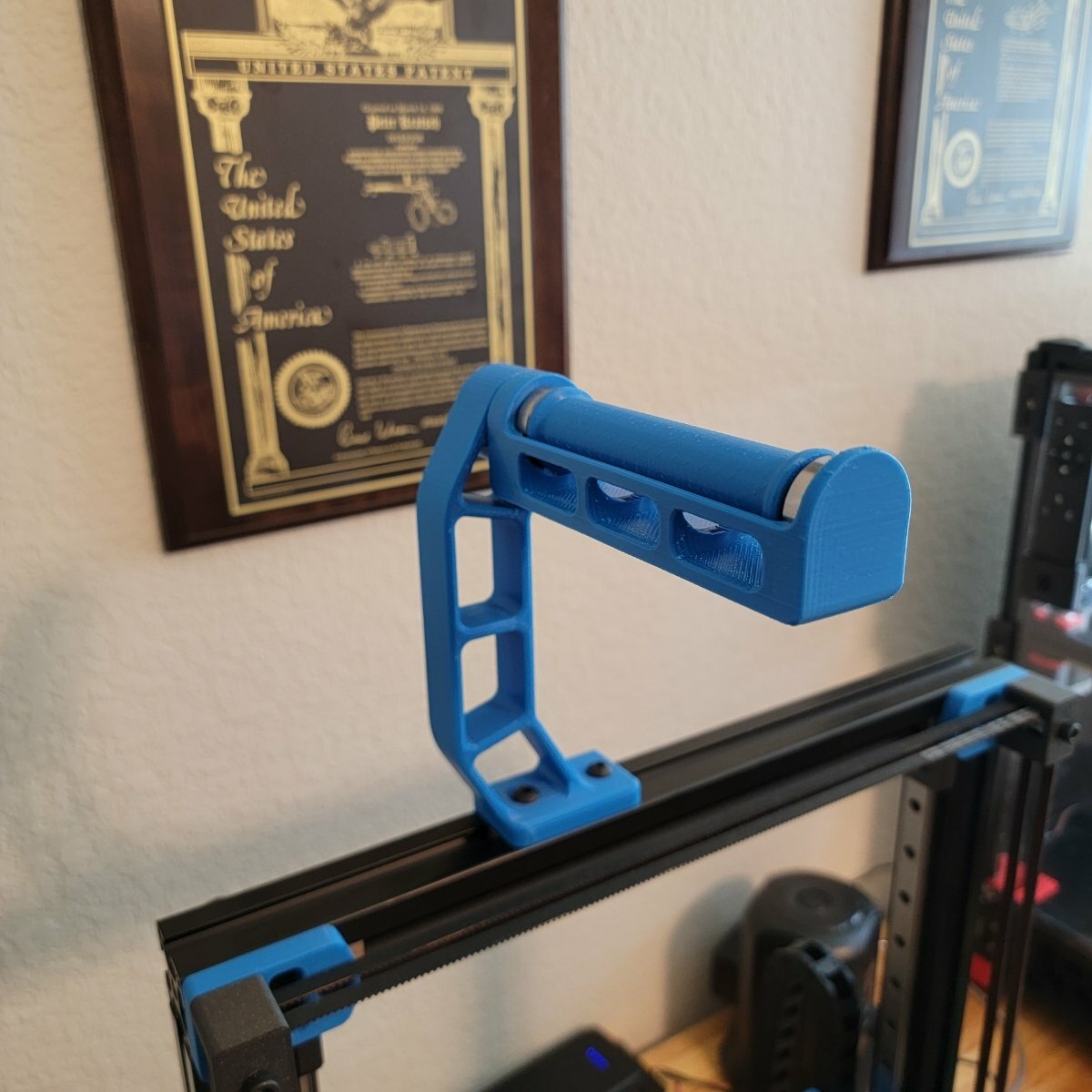

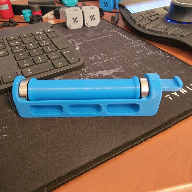

On 8/28/2022 at 2:37 AM, Penatr8tor said:
You're welcome! Let me know how well it fits and how easily it rolls. I might need to make an adjustment. If I do it'll be the pegs so you don't have to reprint large parts.
@Penatr8tor Printed and assembled. Quite a tight fit of the pegs into the roller and the bearings. Works very well, rolling freely, thank you.image.thumb.jpeg.e465bd75bbcc2cbab4561546eeeff62c.jpeg

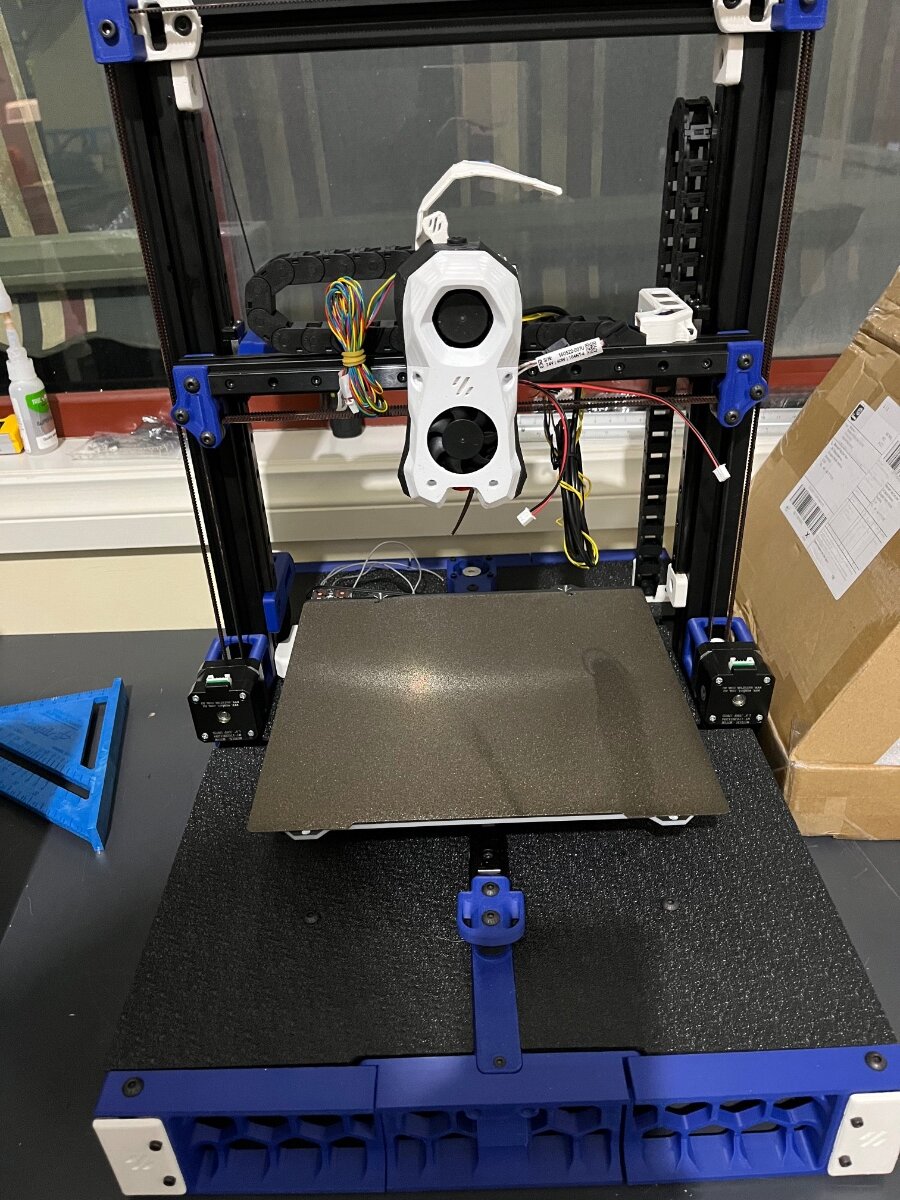

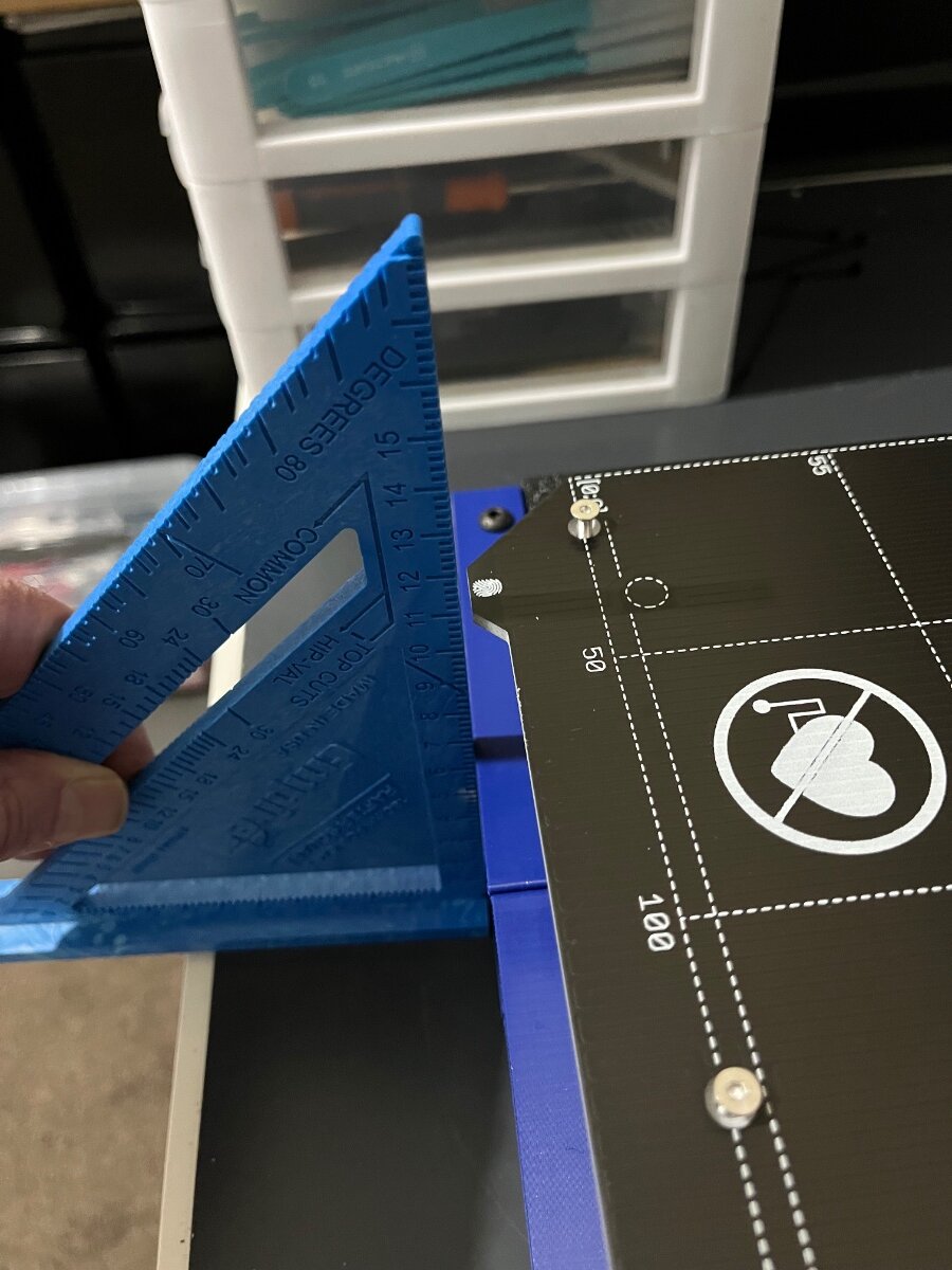

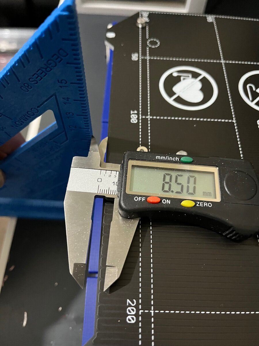

On 8/25/2022 at 9:45 PM, RopusLongus said:

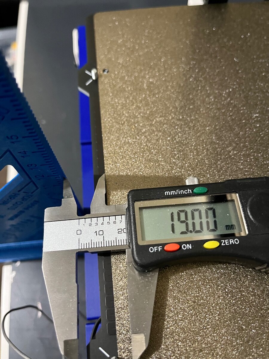

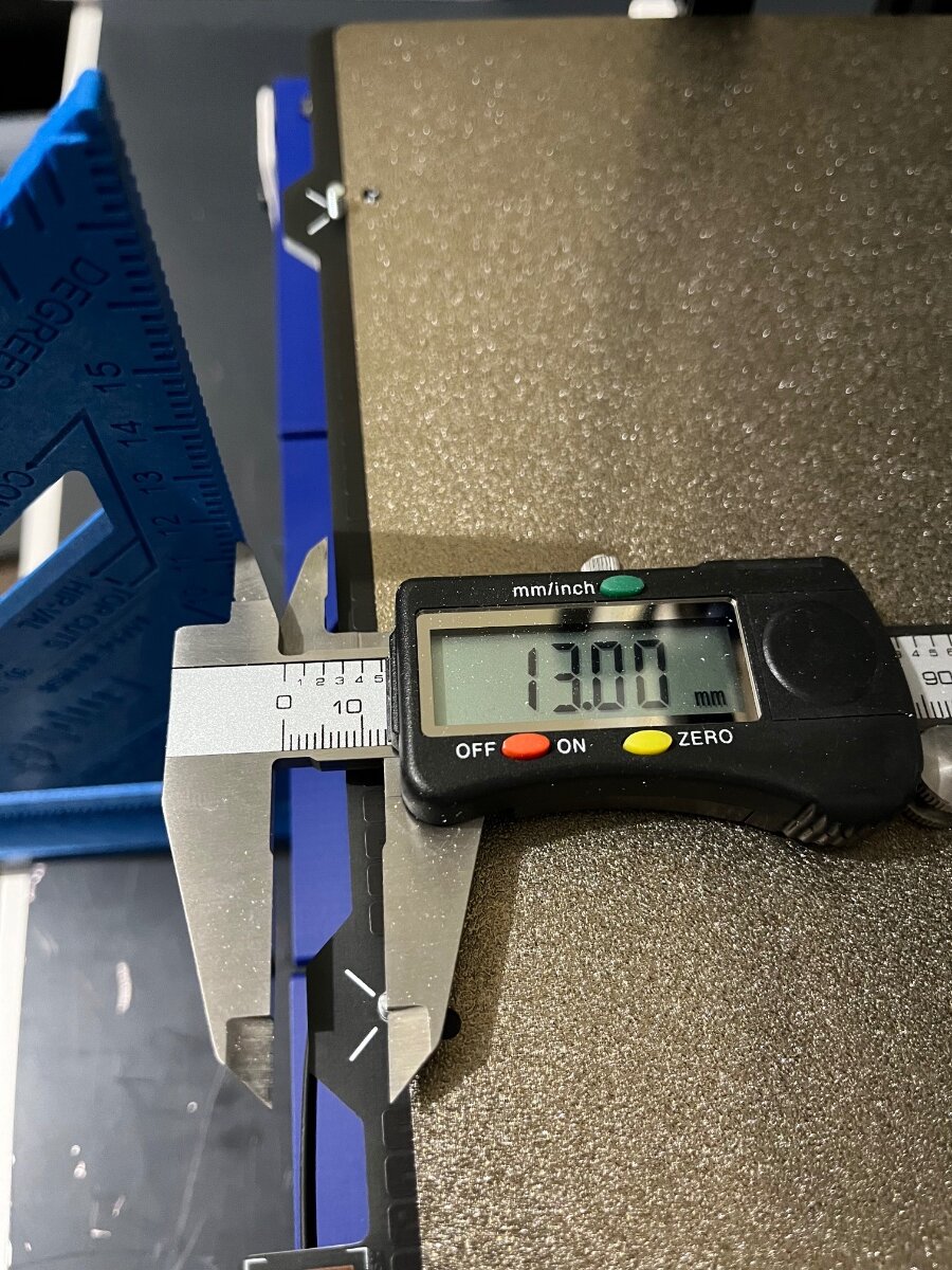

Another thing coming up for me : when you finally set in the hotbed could You be so kind and measure how much space is between the end of the heatbed and the grill of the voron. I need that to decide where to place my X/Z frame.  Currently I think 50mm more forward will do it but looking at your picture I start thinking I could be wrong.
Thank you.
@RopusLongus Here are the measurements of the assembled hotbed to the front of the grill. Hope it helps,
3 minutes ago, Buurman said:
Should not roll too freely 😉 ... I have seen full spindles unroll ... wildly...
Let's rephrase - spool of filament rolls freely, no catches, no unwinding. Must go and relearn my English 🤣

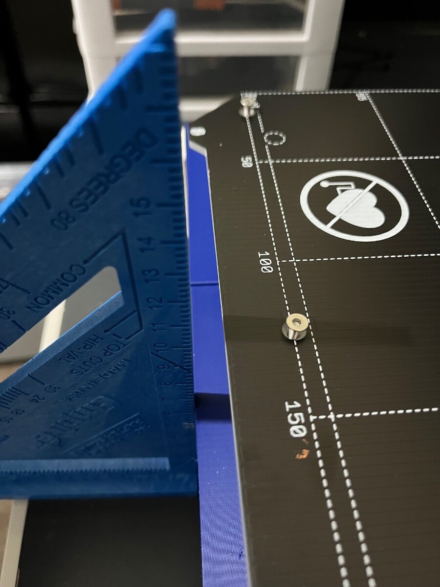

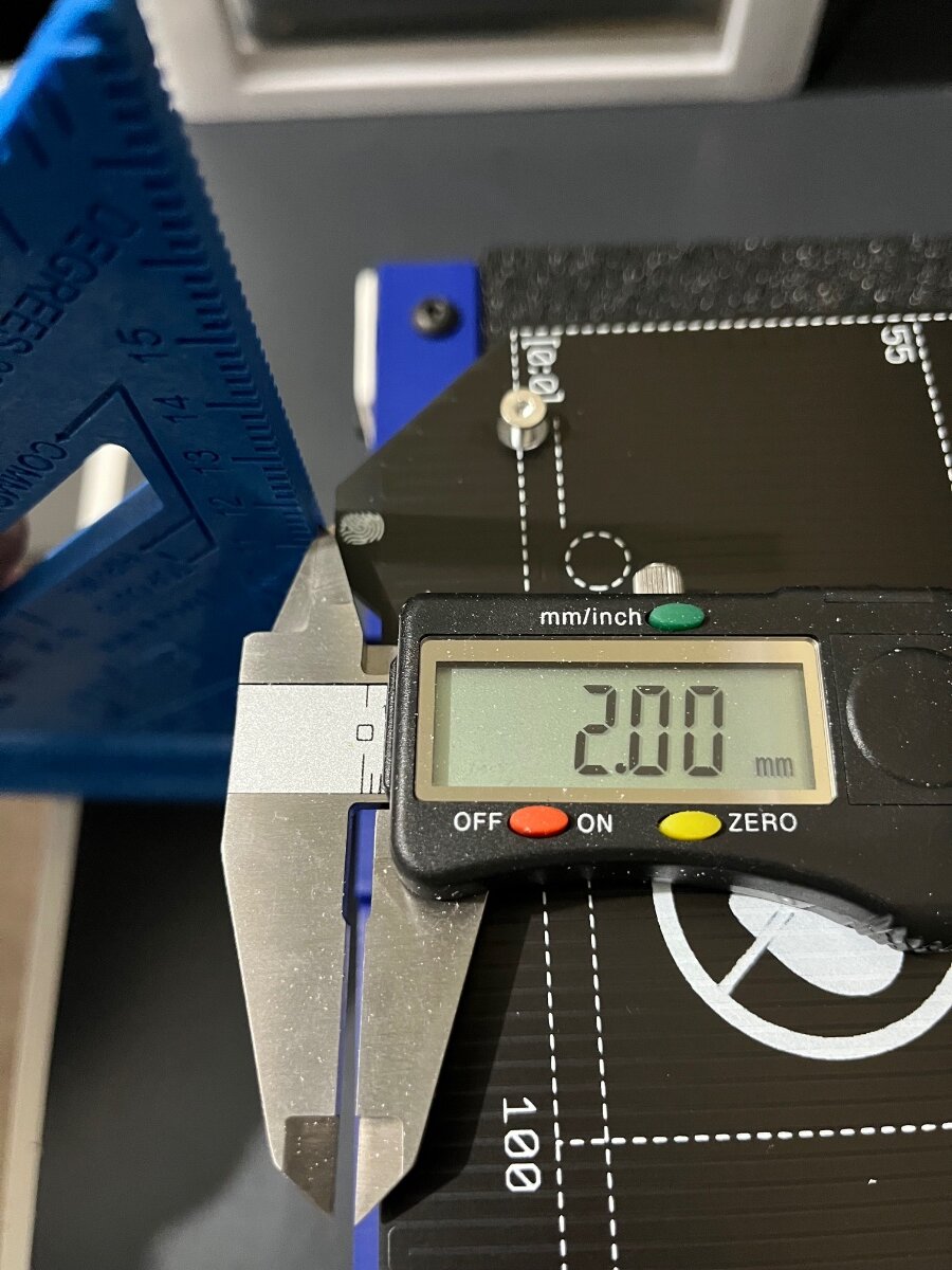

Ahhh dammit me and my English an the skill to ask for something....
OK back again trying to explain.
I need the mm from back end to the heatbed, it's to see if I have to move the frame. For X/Z forward to the front side.
Either I need to move it 50mm or 100mm.
If I am correct the heatbed is 25something to 23something.mine is 310x310 so I assure atm that I need to go 50 or 60mm forward with the frame on top. I hope I did explain it a bit. More understandable.
Is this what you need?
I just uploaded Rev-02 of the bearing pegs. They provide a bit more clearance for the bearing to slide into the holder and the roller rolls more freely. At least it helped with mine. All you need to do is print the new pegs and install them. No change to the roller or holder.
