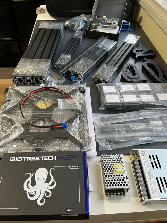

Have all the hardware for the build - self sourced late last year. Looking at options and the escalation in postage costs, this I feel is no longer a viable way to go. Kits in the end work out much cheaper and that is the way I will go in future. Looking at kits on Formbot's Aliexpress store,  the delivery times to Australia is within 6 weeks. And the kits are approximately 500AUD cheaper than locally sourced kits from Formbot. Enough of this and on to the build.
Frame done and parts printing. As @Buurman, planning a few mods with the build and even though the Switchwire is not meant to be enclosed, it will be. Will be a slow build but definitely not as drawn out, as was the 2.4r2 build.
Lets start: -Individually self sourced parts

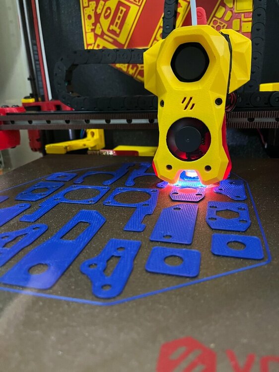

Parts being printed on the newly build V2.4008. Color scheme will be Blue, White and Black.

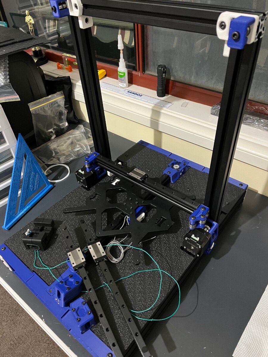

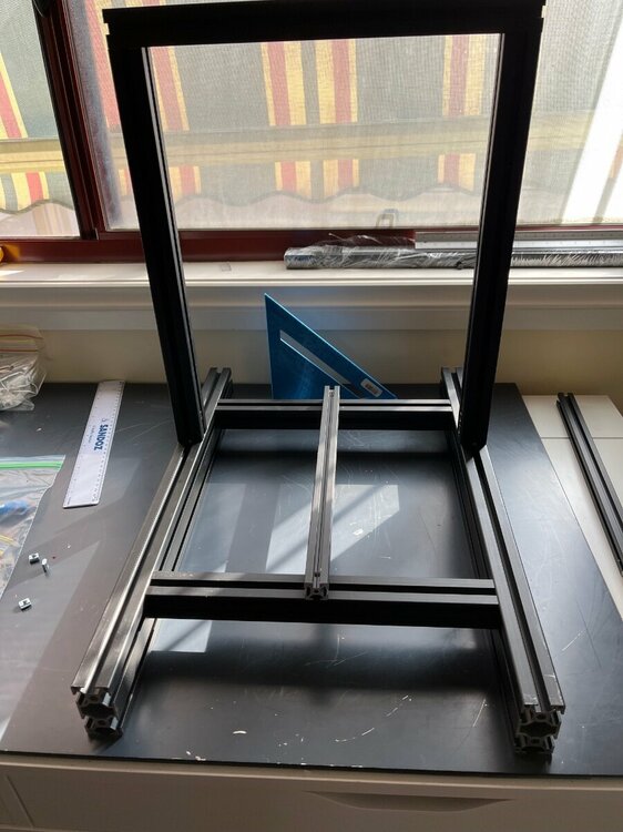

Frame assembled: (Build on a mirror)

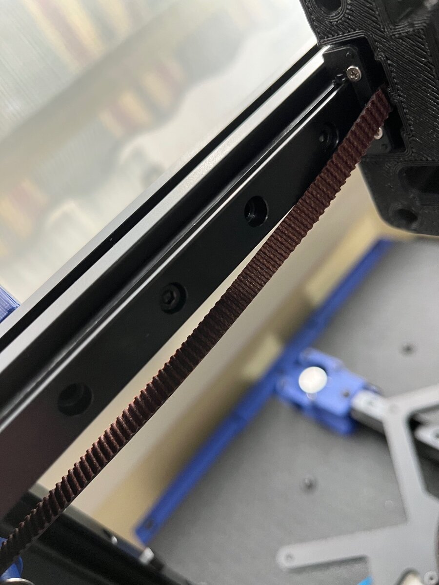

Belt path- teeth facing up:

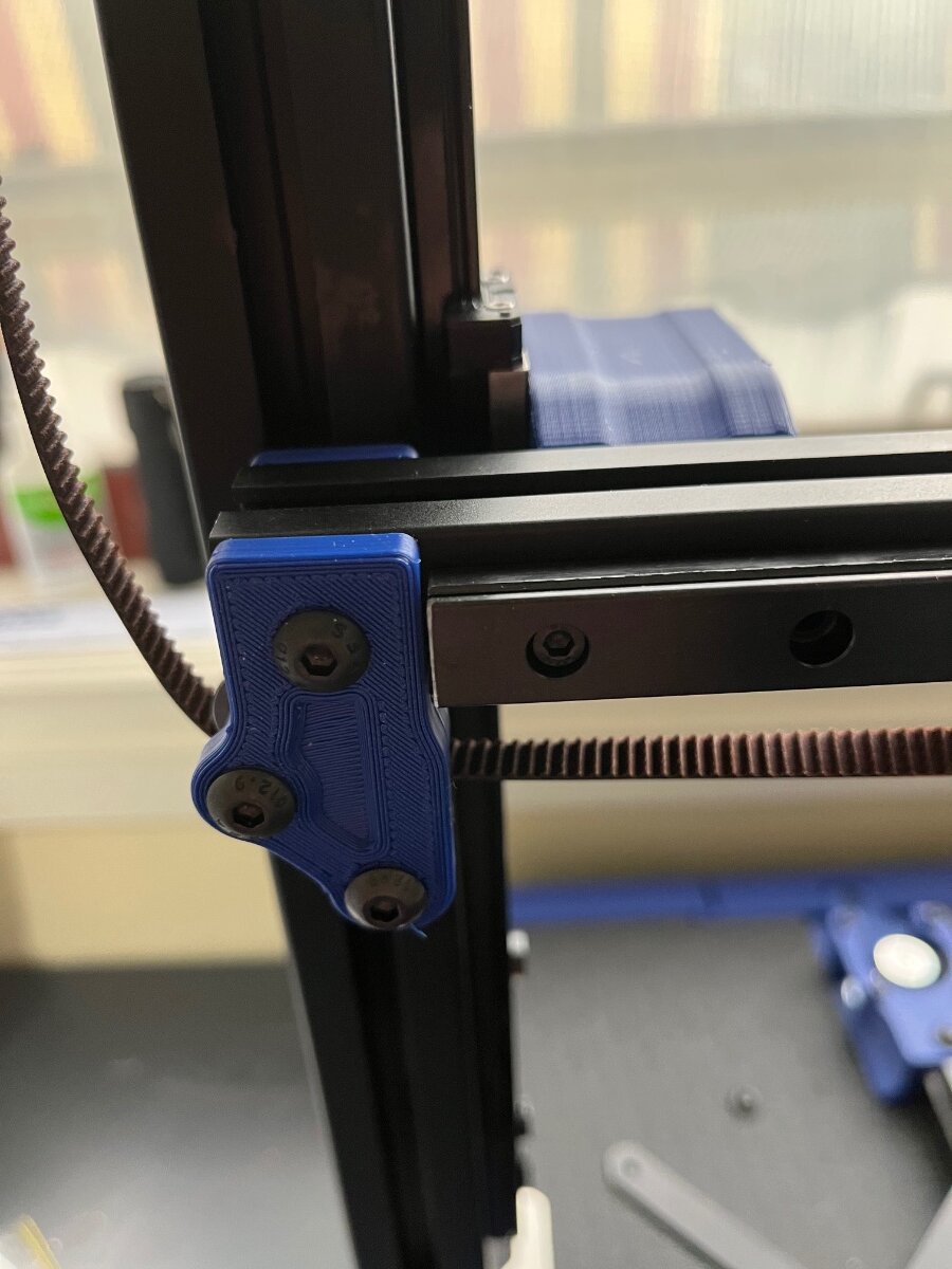

X-Carriage - Belt teeth facing forward
Printed the X_Frame_MGN12  instead of the correct X_Frame_SW.  Have to remind myself, this is a Switchwire NOT a 2.4

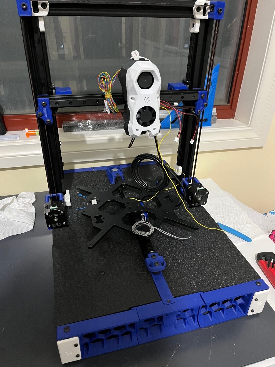

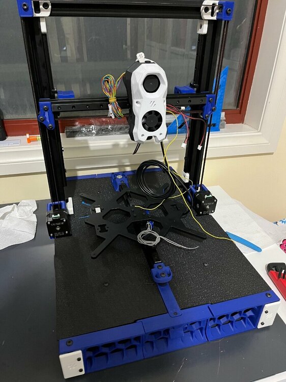

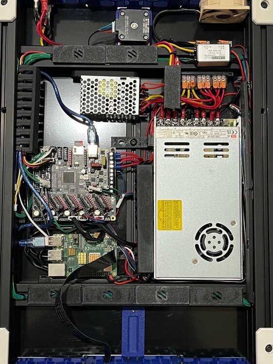

Correct part printed - X-carrige and toolhead mounted. Decided to use the Moron Probe and do the Euclid mod later - have to have something to do after this, don't I?Lets get onto the fun part - electronic. Oh yeah - still waiting for the keybak to arrive - should be here tomorrow. (Yet another oversight on my part- next build - a kit form of sorts)
