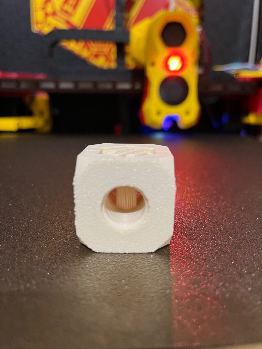

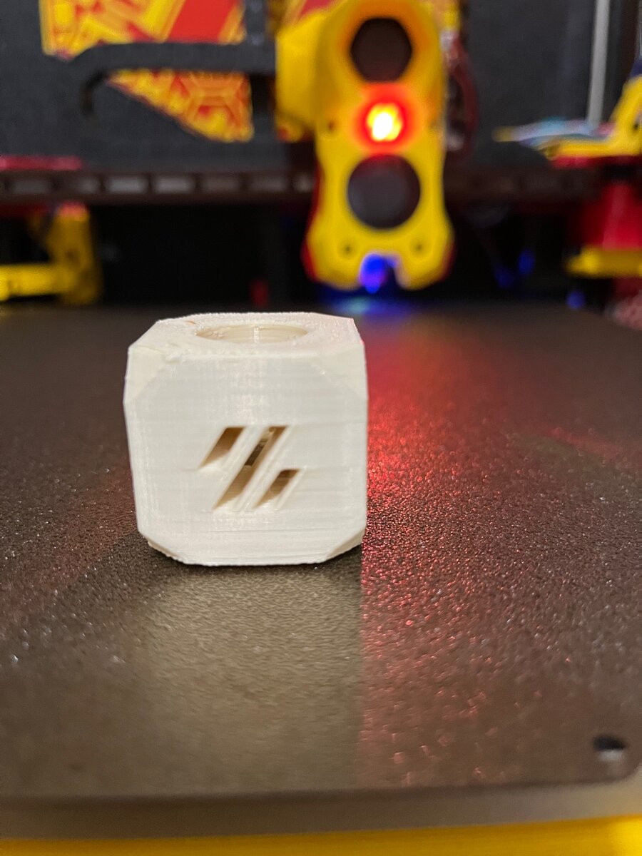

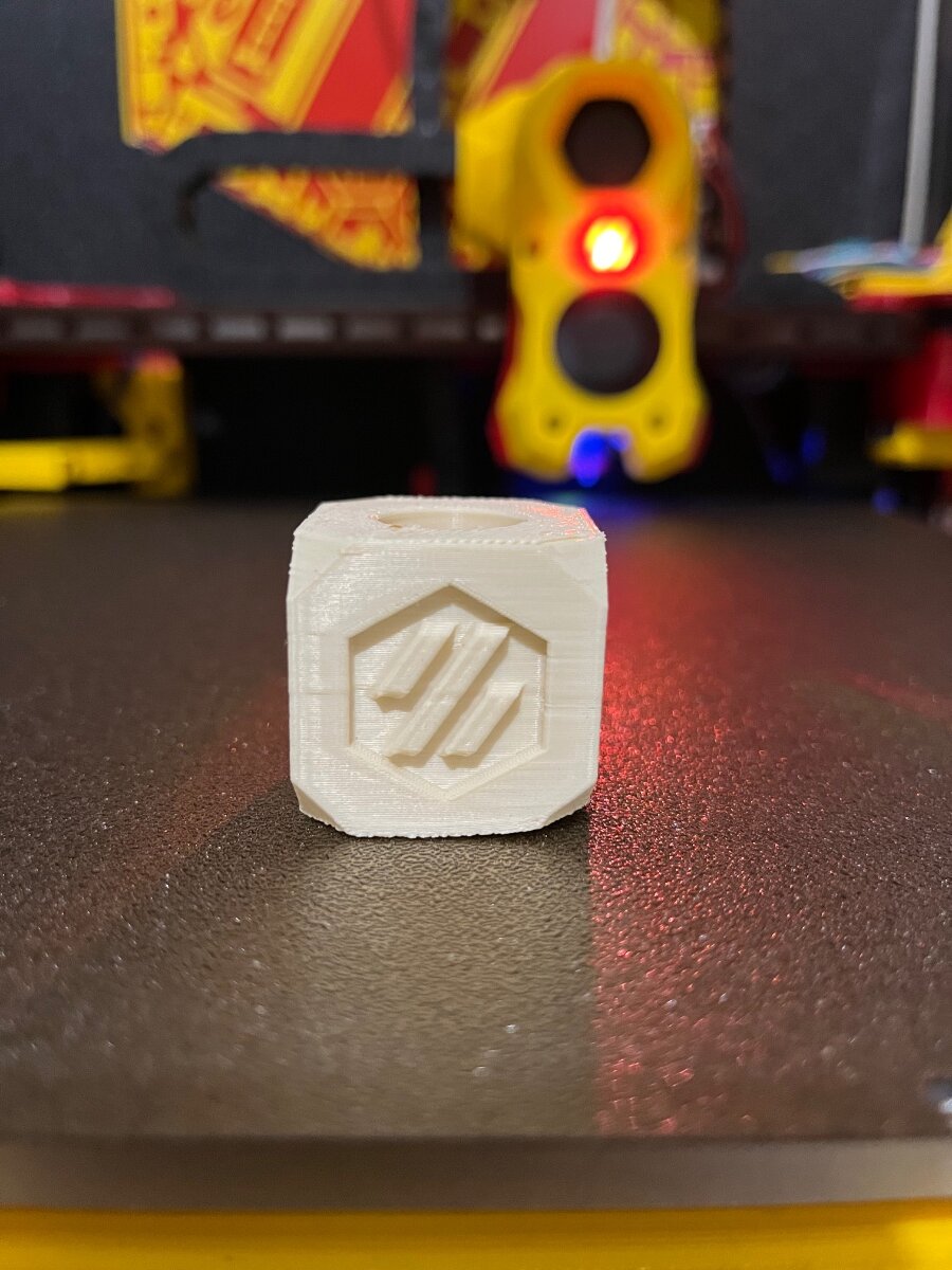

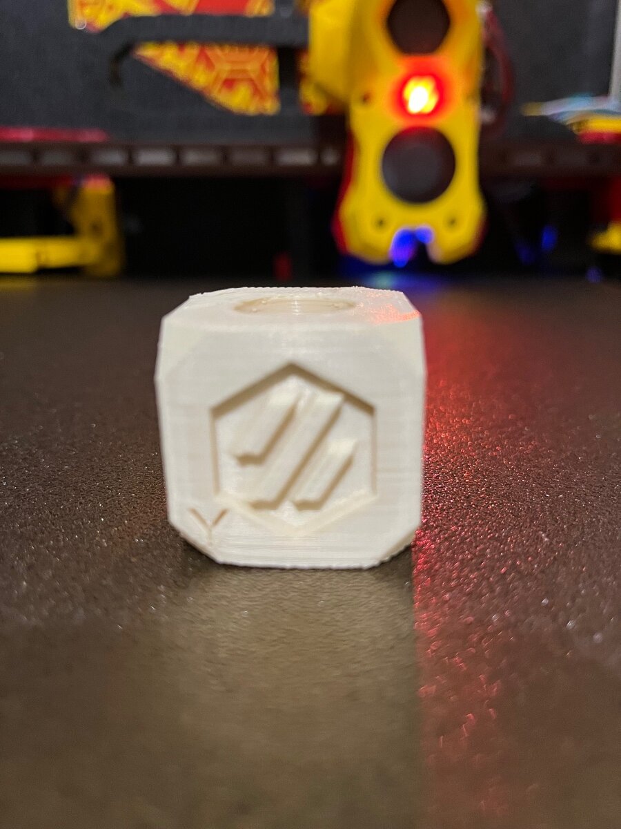

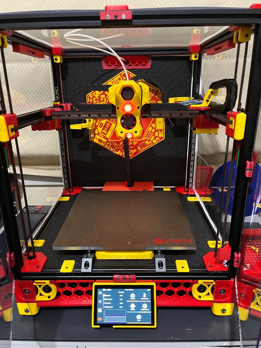

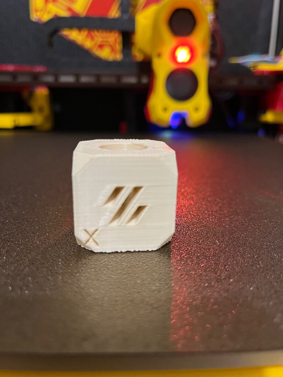

Voron Cube printed without a hitch. Considering the printer is not tuned, quite a good outcome.

Alright lets finally finish this build - Enclosure then done!

Not bad. The belts probably could use some tightening.
Now for dialing in, tuning, setting up your macros. Then mods! 😁
Thanks for that. The fun part is over, that is the build, now the work begins. Hate doing macros, don't know why.
Will tighten belts to 110Hz as per Voron documentation.

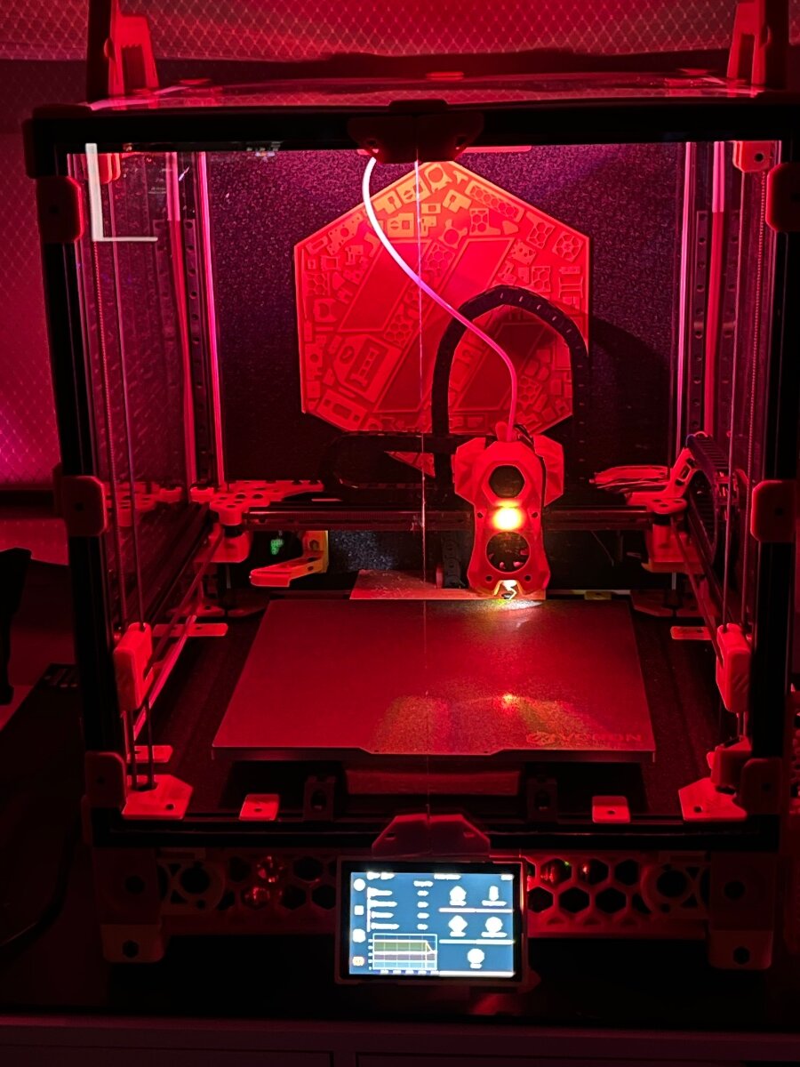

Here she is saying thank you and this journey has ended.
Looks like a proper red/yellow beast!!! I like it!!!
I would pull the nevermore filter forward, almost to your window. The air it blows out now, cant really go anywhere, if you pull it forward, you will notice a better chamber temperature, building up faster.

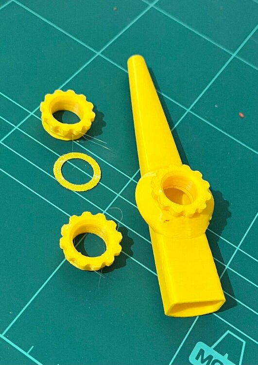

I think we should change the title of your diary to the "Never ending Story"  (Sadly we couldn't spring for Limahl so you'll have to make do with me on the Kazoo......once I get it printed)
