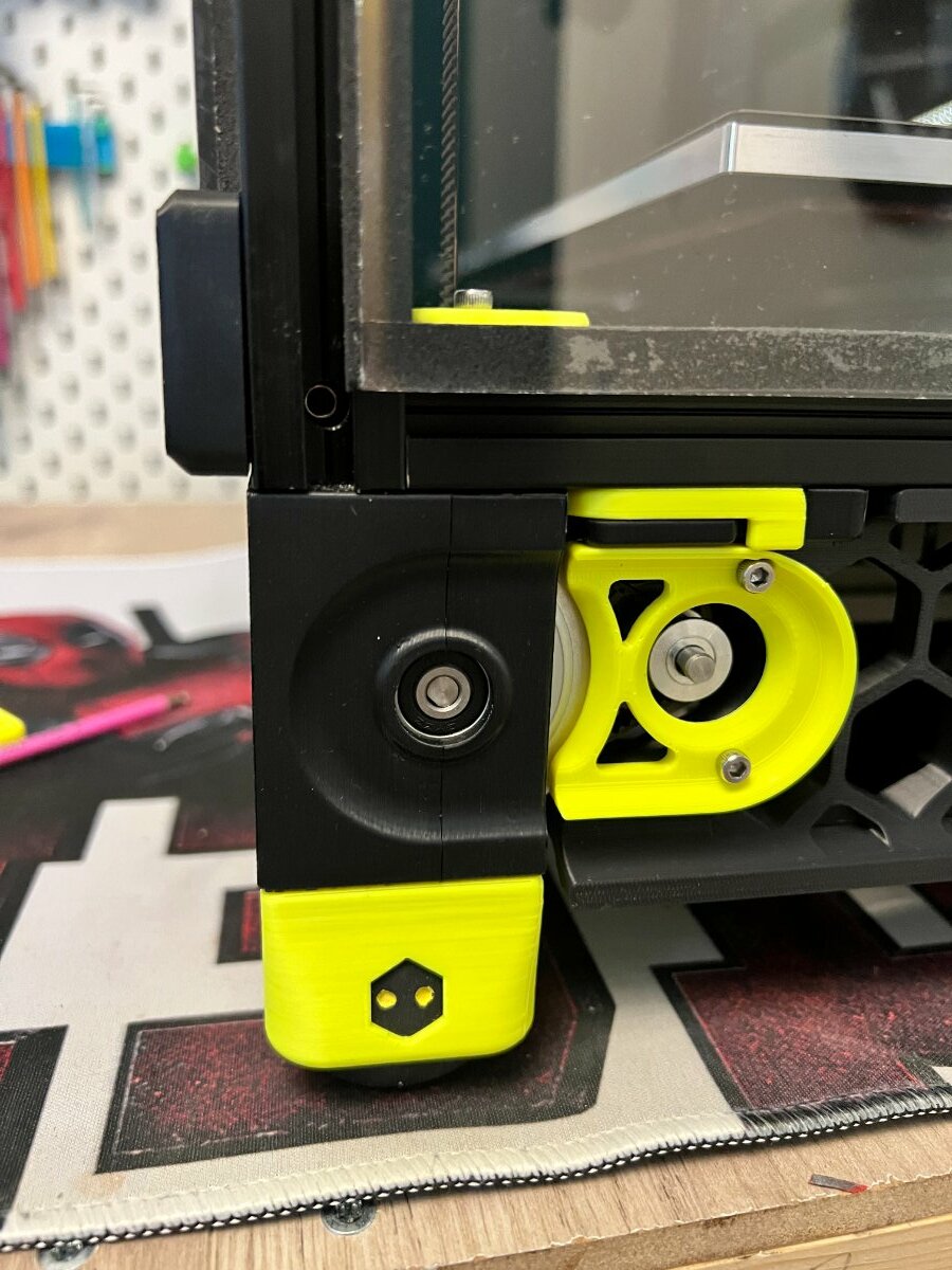

Where did you find the squash ball feet mod? TBH I haven't really looked. Just saw it on a post somewhere and thought it would be a decent upgrade for my 2.4 300^3.
Hi @Penatr8tor. They are on GitHub under User mods:
https://github.com/VoronDesign/VoronUsers/tree/master/printer_mods/Slidr/PanzerBalls2.4
My printers with "squash ball fee" are much quieter than those without. (less vibrational noise from the motors) Thought I'd give them a go and see if it makes a difference on the Voron build.

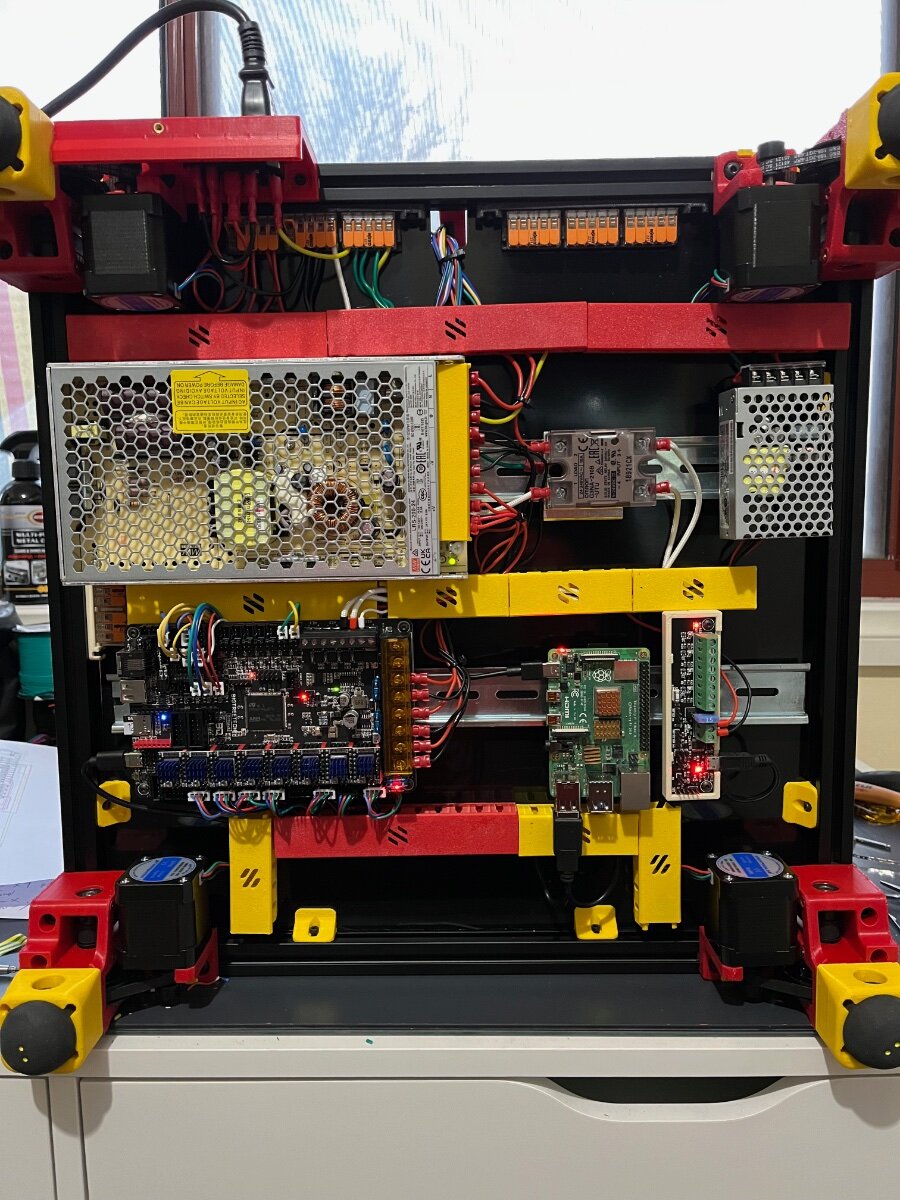

17 minutes ago, smirk said:
Now, that is a thing of beauty.

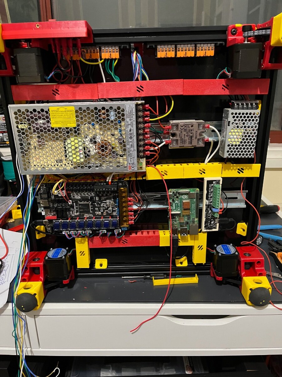

@smirk Thank you, as you said - very satisfying about creating neat and orderly cable installation. Rapunzel no more 🙂

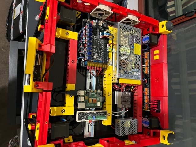

Screen and electronics bay fans fitted (went with 6025 Noctua fans)

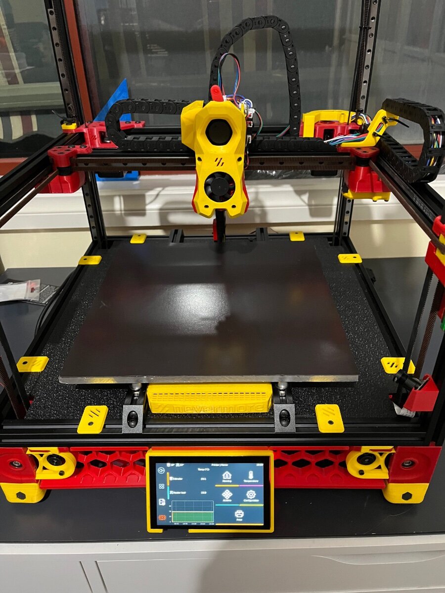

Working on raspi pi cameral mount and filament runout sensor. Still need to design a cover for the PCB. That stealth burner look lopsided!
Slow but steady. More importantly - enjoying this build

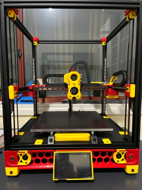

Well.... Raspi replaced, screen replaced (had a faulty screen in the end). Reinstalled Klipper. Allup and running. Now for the pin configurations, then testing before enclosing the printer
Oh yes - still have to design the part for the lopsided stealthburner

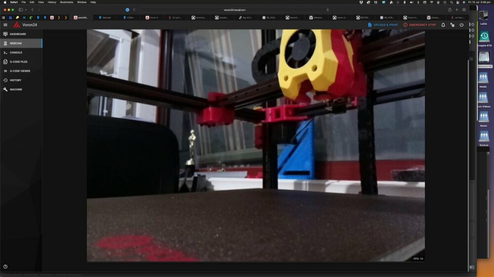

How is your view from the webcam? I mounted my on top, like it ok, but its not perfect...

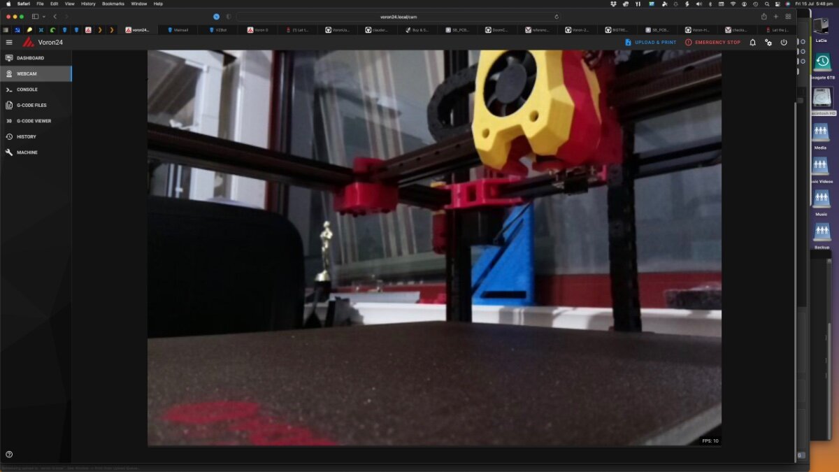

@Buurman Have not done a print as yet to see camera effect. But this is what the cameral looks at (Mounted low right front extrusion:
BTT ducks on back corners, red alignment tool is middle of bed and green alignment tools are front of bed. Thus missing the frontlet corner of the bed.

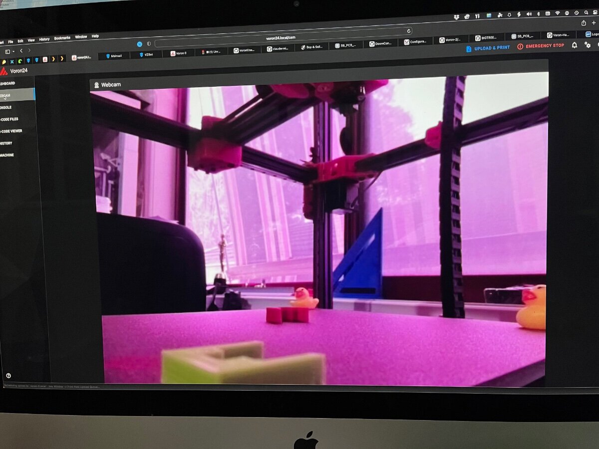

And it’s pink, my pi cam had the same effect, switched to a Logitech for that reason and quality on focus is … well bad I think.
view from the top ain’t perfect too, don’t get me wrong…
Edited by Buurman

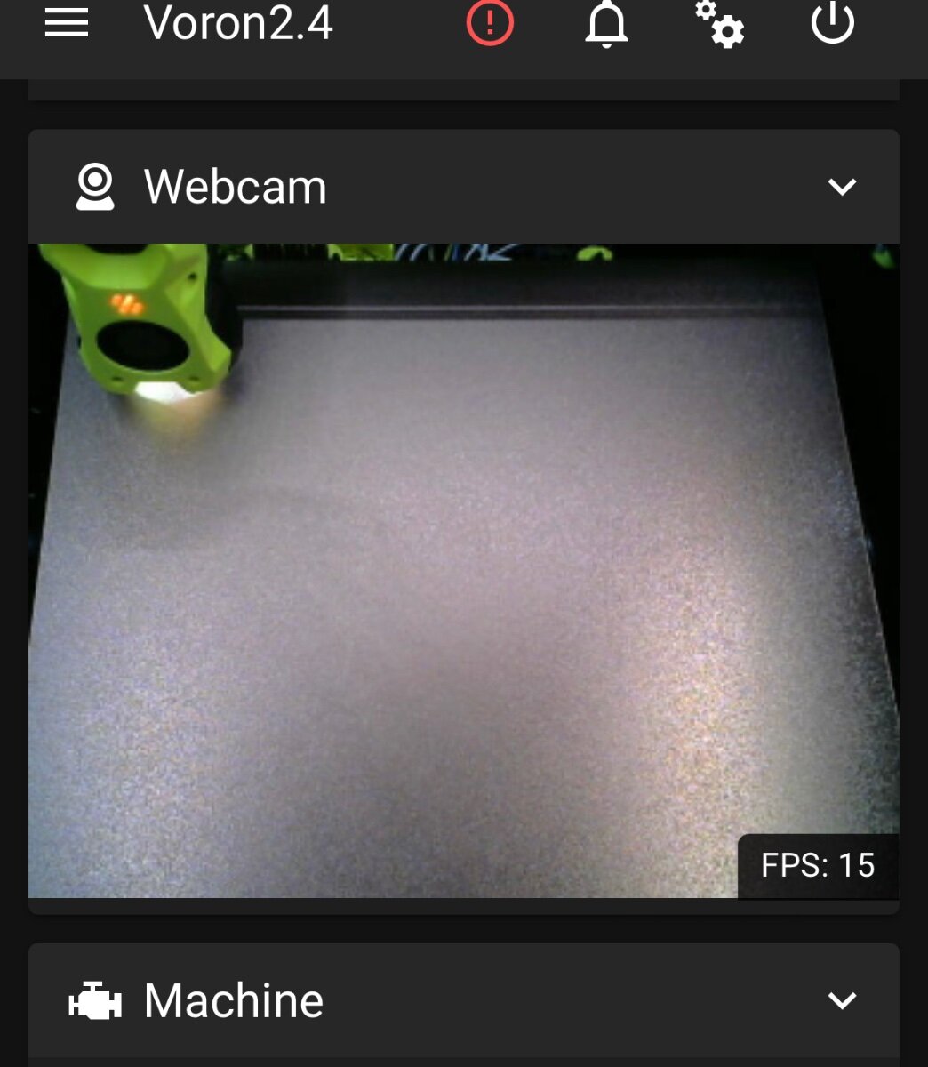

I think the pink is just the background lighting. Here is a screen shot from mainsail:
