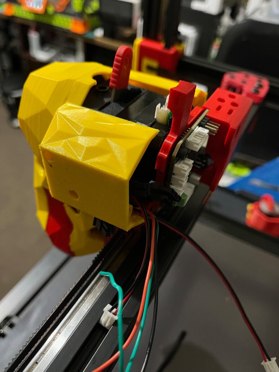

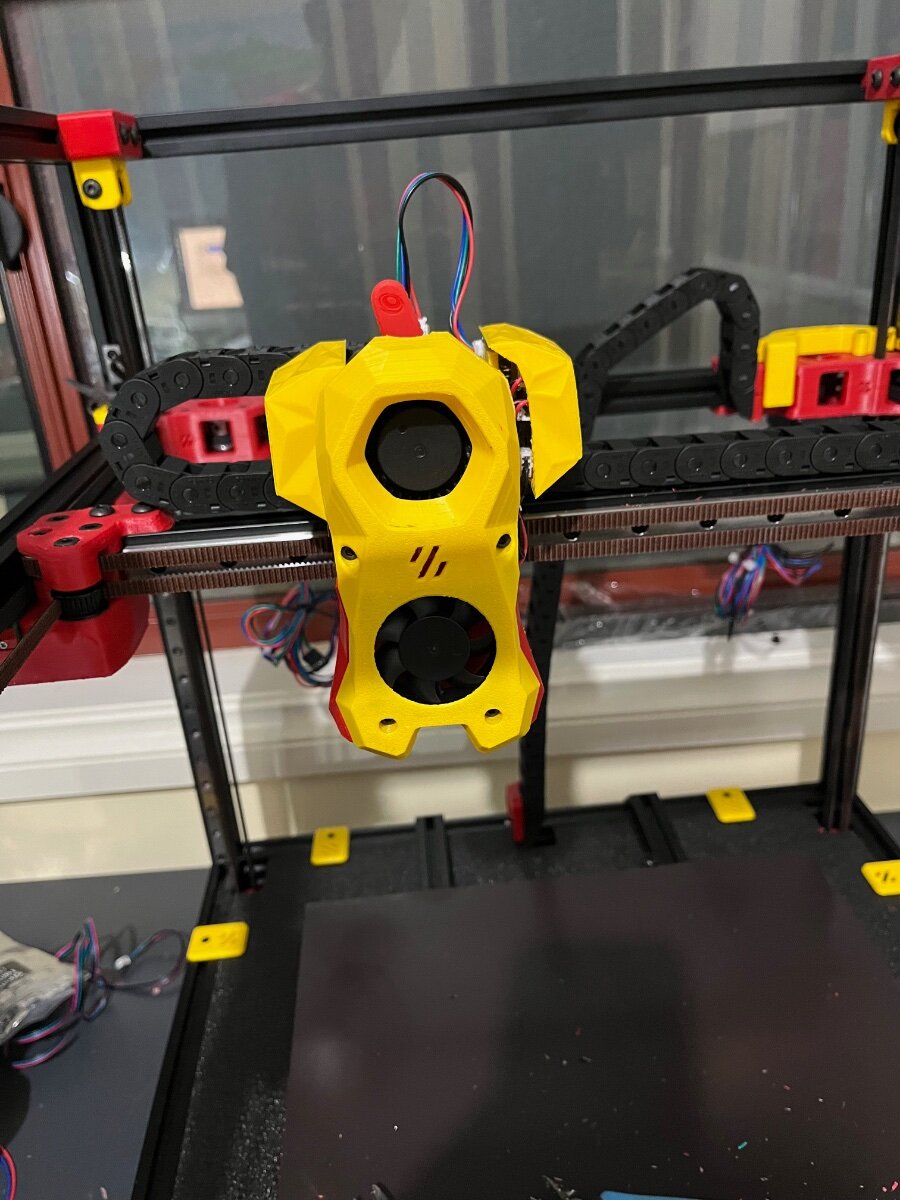

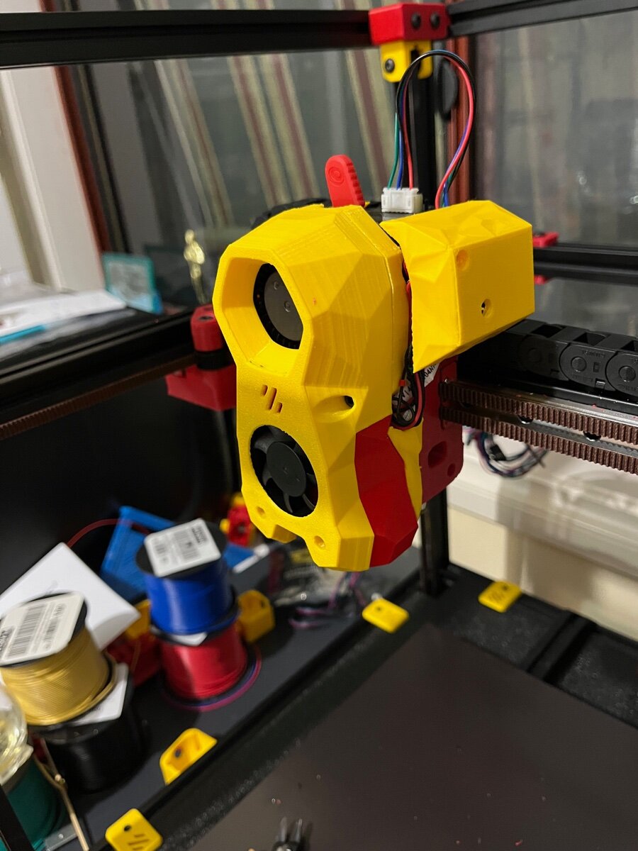

Maybe I am a sucker for punishment. Like to try new things - maybe it is the challenge or maybe just a stubborn "Frieslander" in OZ. Currently trying to design a PCB holder to fit the Stealthburner with LGX mod that would hide the cables.

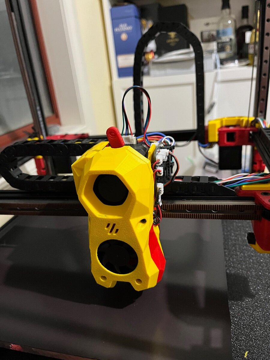

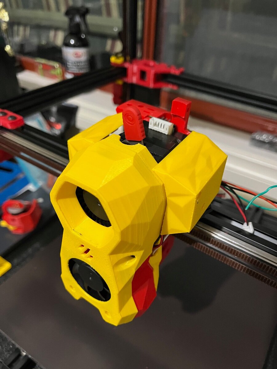

Finally found a good solution to mounting the CanBus to the Stealthburner with LGX. Mounts at the back of the motor - integrated chain mount and pretty neat overall.
https://www.thingiverse.com/thing:5414483
IMG_2405.thumb.jpeg.d49335801ddde21cc91ac501823ceb8c.jpegIMG_2406.thumb.jpeg.f6a995ee843424e494f7eaee5f856ef7.jpegIMG_2407.thumb.jpeg.a4f3be8130b96971bf489d5c9c6491d9.jpeg

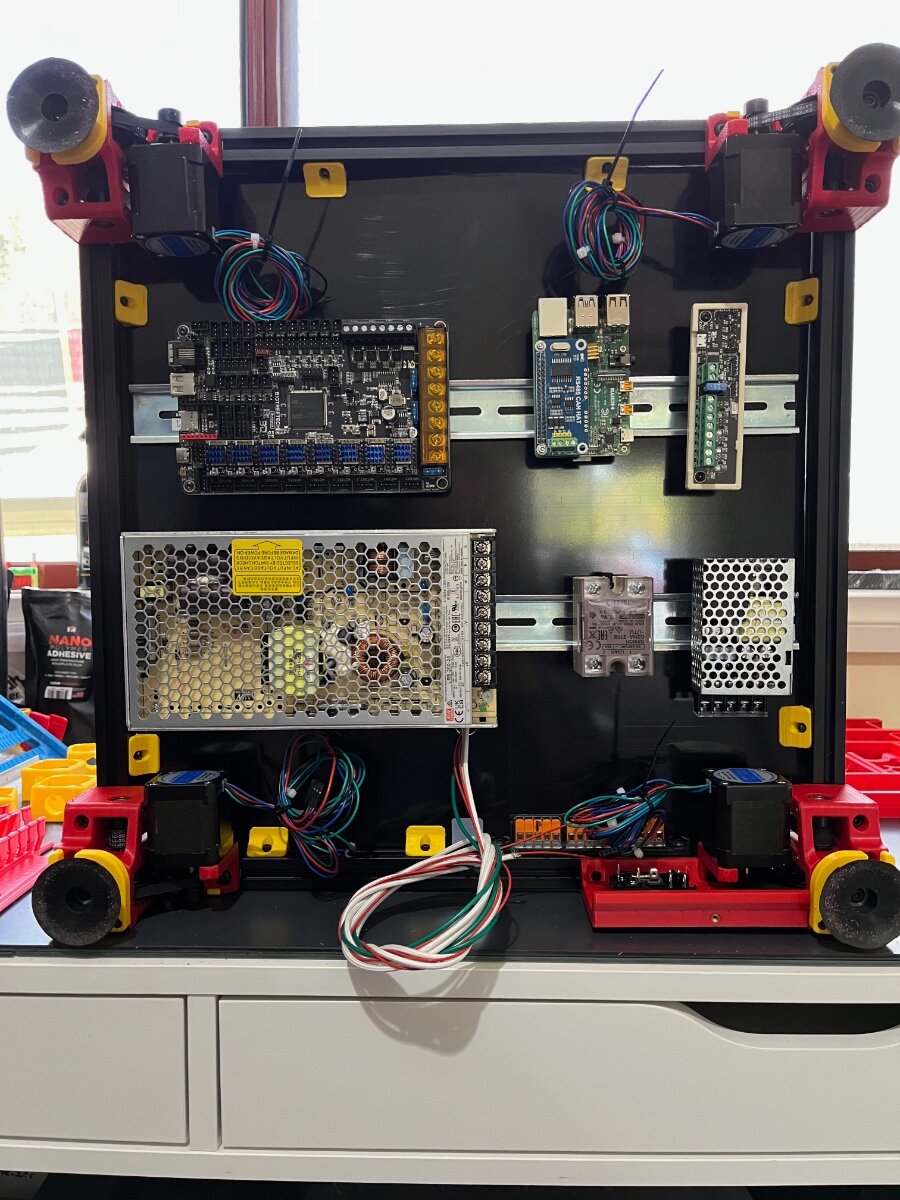

Electronics bay fitted out . Raspi Pi 4B+ with Waveshare Canbus and a Klipper expansion board are the only extras to the standard Voron configuration.  Next wiring....
Going to wire the board directly from the PSU.
WEll, seems I have mirror vision as I mounted all the hardware as a mirror image to the manual. Has since rectified this. Ah the joys of building a printer....
Have a thermistor in the electronics bay and a chamber thermistor that connect to it. On the other machines I have neopixels attached to the board, as well as the exhaust and chamber fans. Guess the Octopus will manage all that easily. Installed purely as a precaution for If I need the extra ports

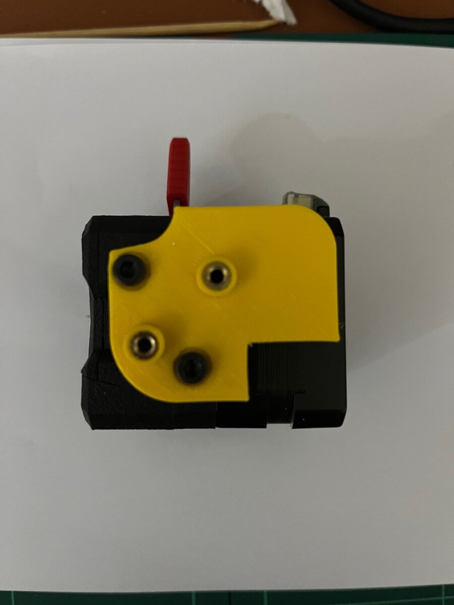

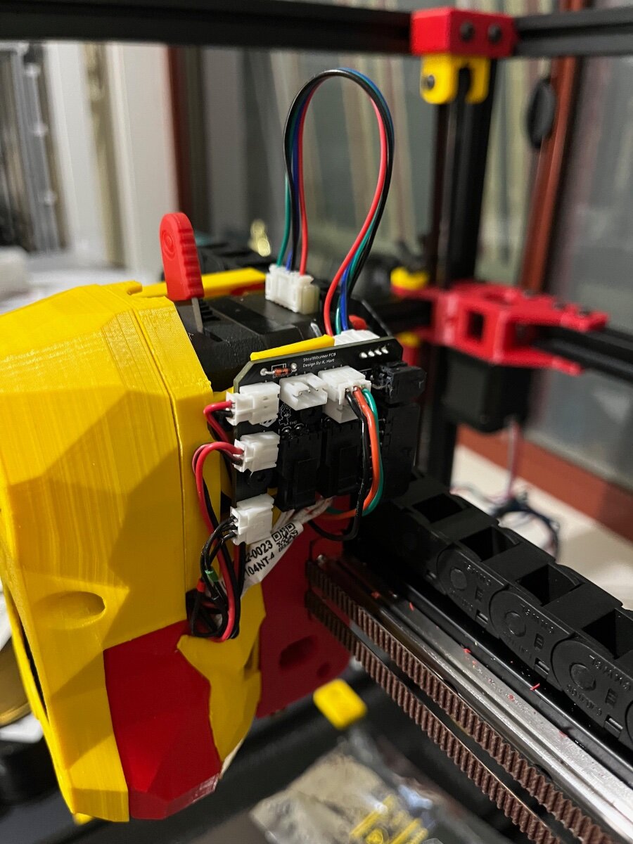

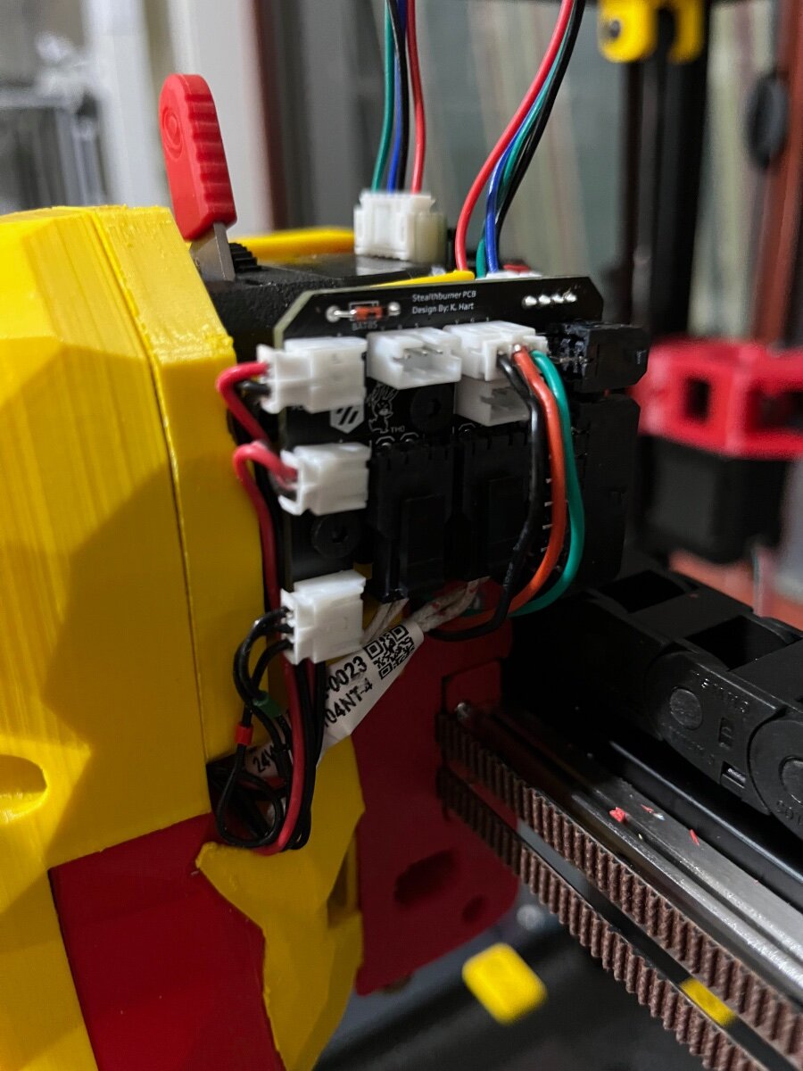

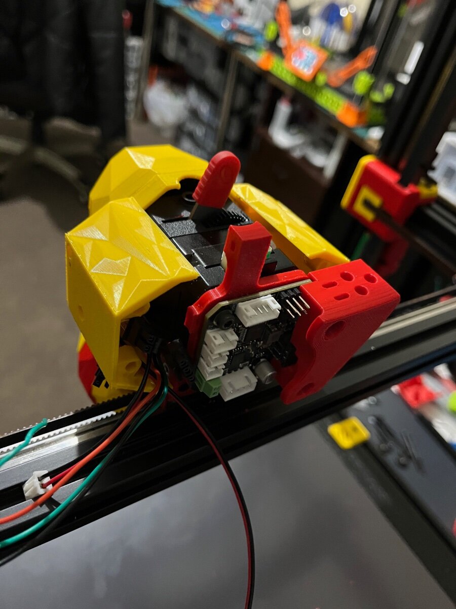

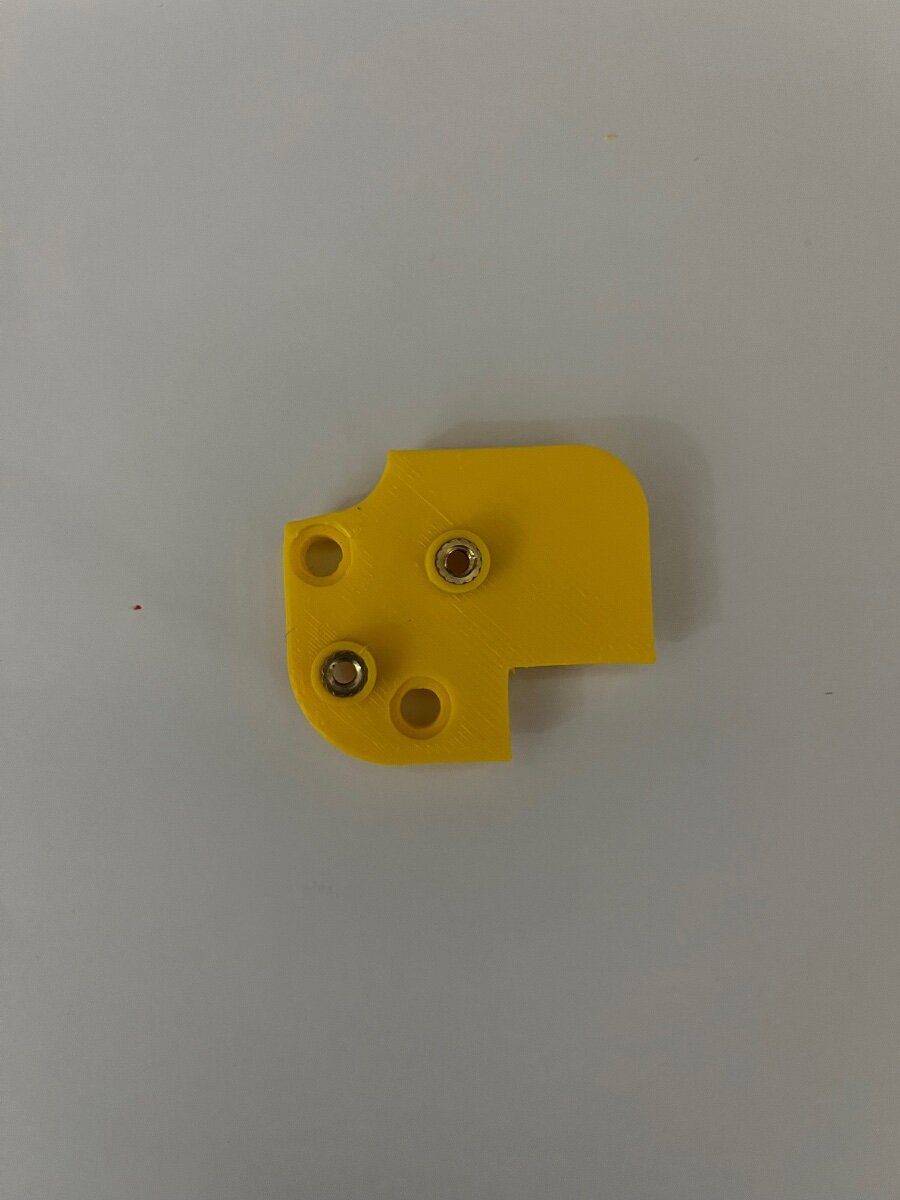

Will certainly give that a try if the CANbus does not work out. Have designed a mount for the Stealthburner PCB. Reason I did not use was that it would be exposed. I am not that familiar with designing thus integrating a cover will be challenging for me. This is prototype 11 that was printed and fitted thought it needs a cutout for the extruder motor connection.
Trial Fitted the LGX PCB adapter with fittings. Looks Neat and Tidy
Now to redesign the cover . This one just fitted with VB tape. Searching for the STEP file to adapt.

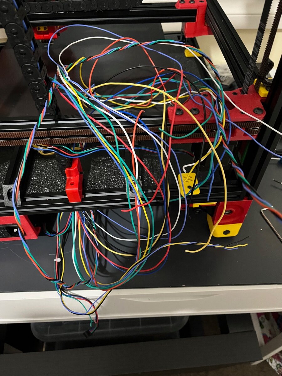

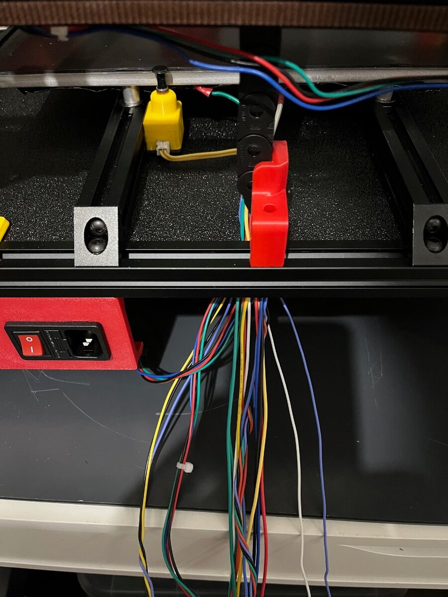

The problem with NOT buying a wiring harness.  Mostly used 24AWG rigid wiring for the hotted PCB and silicon AWG24 for endstops. Hopefully this will last a couple of years and not break as silicone does.
Let's tidy this up.
and this.
Gonna be a long night.....
