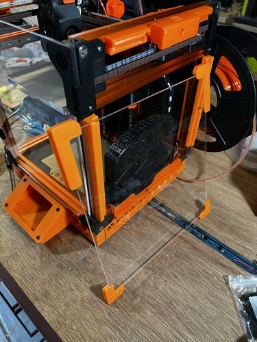

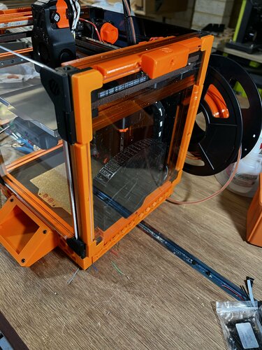

Here's some modified inserts to the V0.1 magnetic panels design by bravefruitcake, I've made a single filler piece with option for single screw mounting, optionally a filler that has built in handles, and a filler that lets a nevermore filter be magnetically mounted with a magnet power connector. Turn it on/off by snapping it on / off.
Also a strong magnetic rear panel mount.
Magnetic electric connector was from aliexpress 'Magnetic Connector 2 Pole Pogopin Male Female 2A Spring Loaded Pogo Pin Waterproof Pad DC Power Charging Connector'
