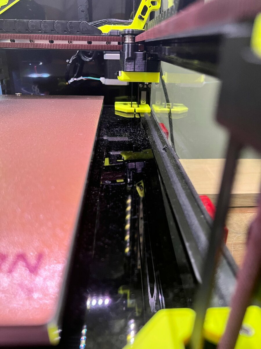

Voron 2.4 R2 350 Octopus + StealthBurner + Clockwork2 + Klicky + SexBolt

6 hours ago, HarshReality said:
Beautiful.. so, hows it print? My being a fool Im still tuning
It prints just as well as my other voron, but for pla printing it may be better since cooling is better on a SB.
most tuning for me was a good asa profile in superslicer. But seem I am close to perfection.
And the leds under a SB are simply nice.

Let me know how the acrylic bottom panel holds out for you, I'm curious.
On my first Voron I didnt use the belt protection corners and the little turnable locks on the bottom side, and yes, it warped like crazy after few hours of printing. (upwards).
But I installed the (good looking corners that you can find here) and installed the turnable slot locks on the bottom and it stays pretty straight now.
It is a little up in the middle parts, but you can even print things for that, to push it down, after heating again, its finds its way I guess.
The only reason for me to swap it with something else is that I would like to have a MATT one, instead of shiny.
This printer has now (time of picture) I guess about 500 hours of printing on it.
