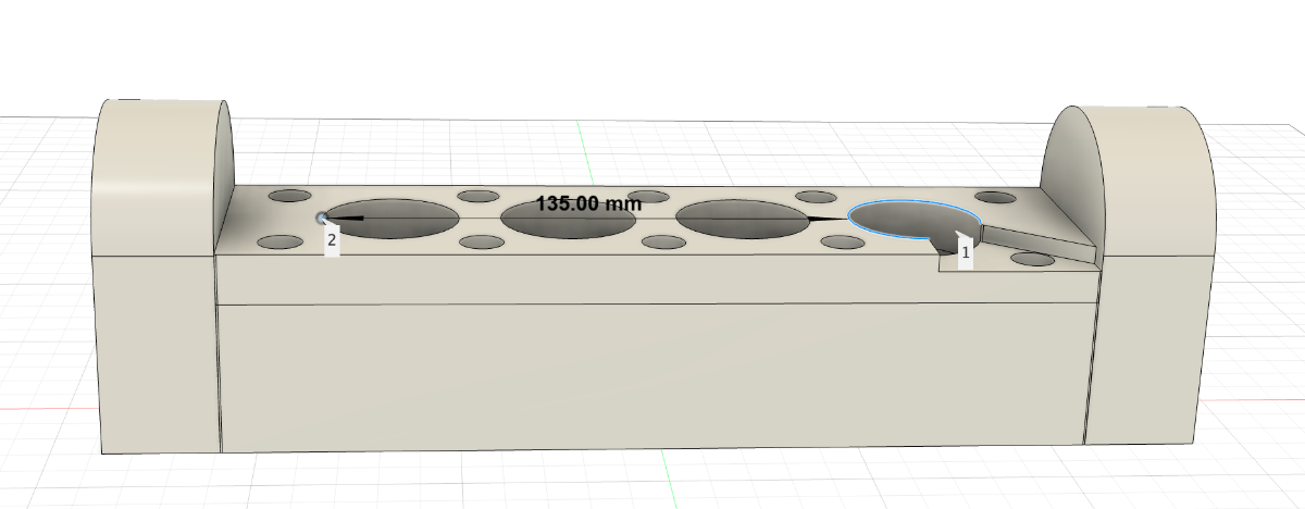

I was thinking the same thing, maybe have the rapidchanger on a platform sitting on a servo-operated motor.
Or maybe just mount it on the end of the bed like the Milo one. There should be enough Y to reach all of the tools and not many people fixturing parts at the end of the table.

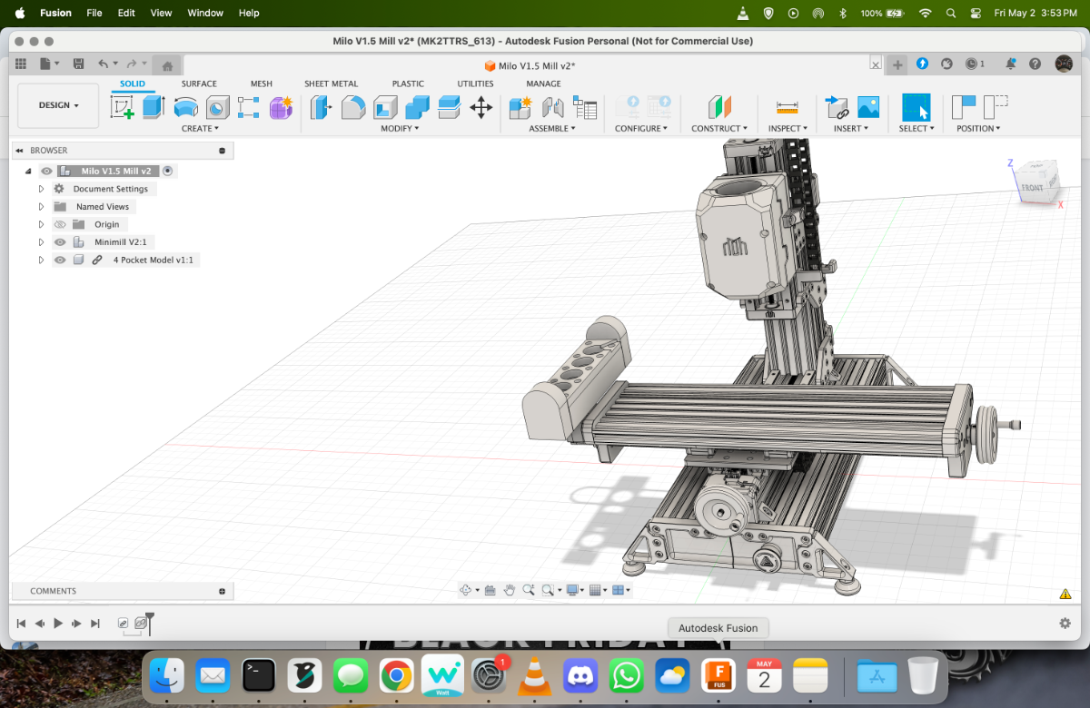

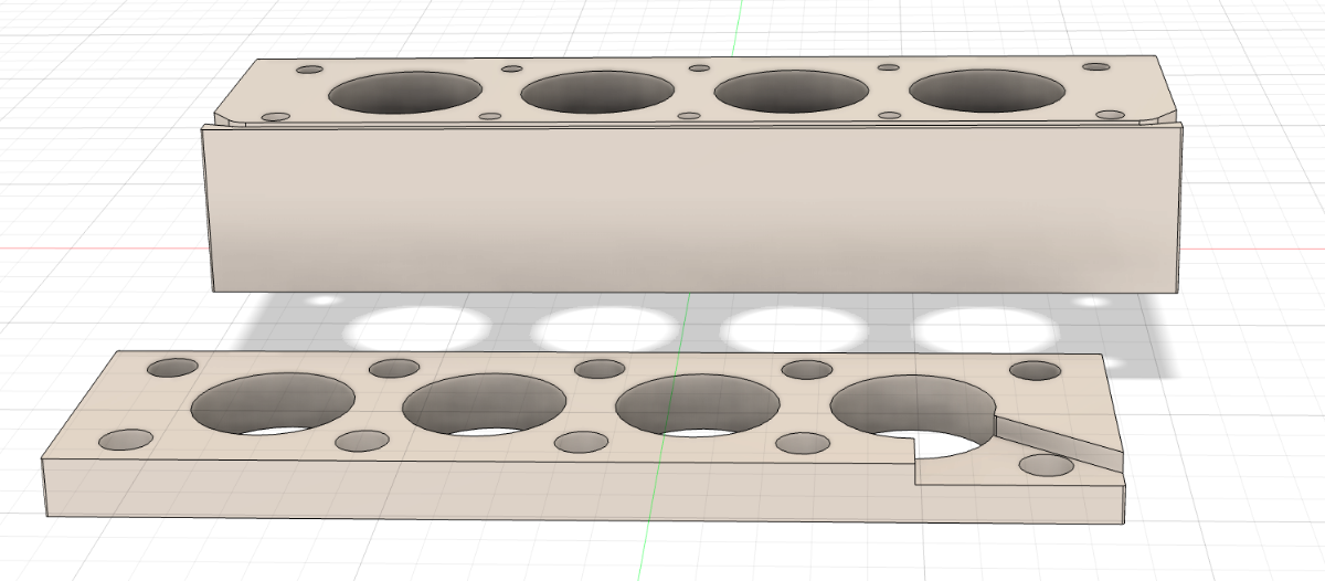

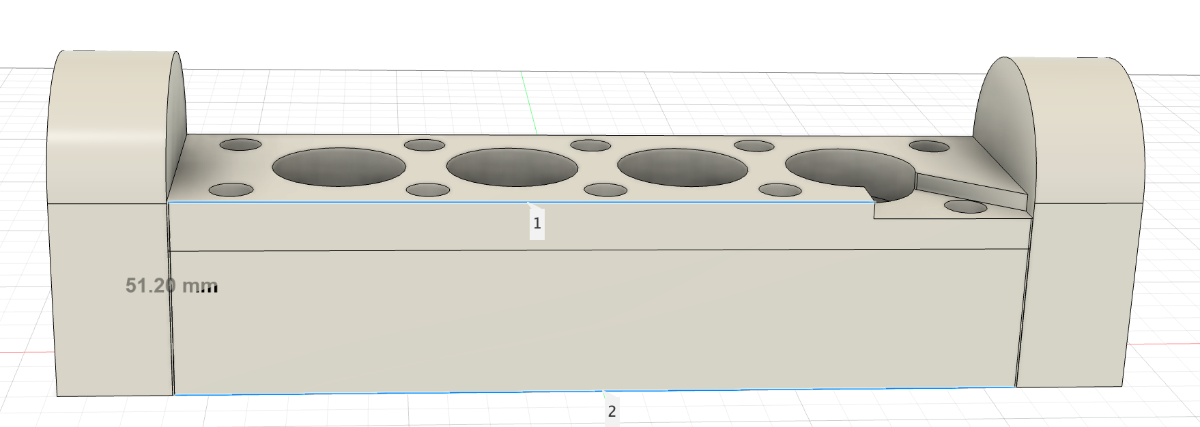

Your right should have enough Y to reach the four tool ports. The X axis shouldn't be an issue, it can be mounted in the dead zone. The changer's height on the Z is 51.20 mm. The model that has a dust  cover, IR collet sensor, and toolsetter is an additional $200
I will 3D print the top and bottom and test the fitment and movement.

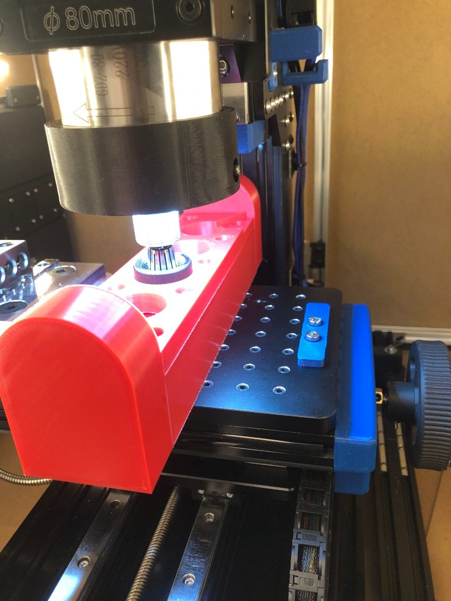

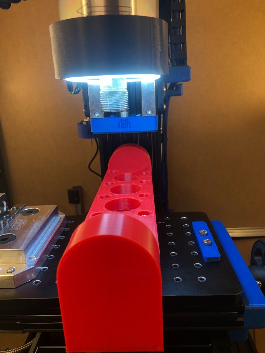

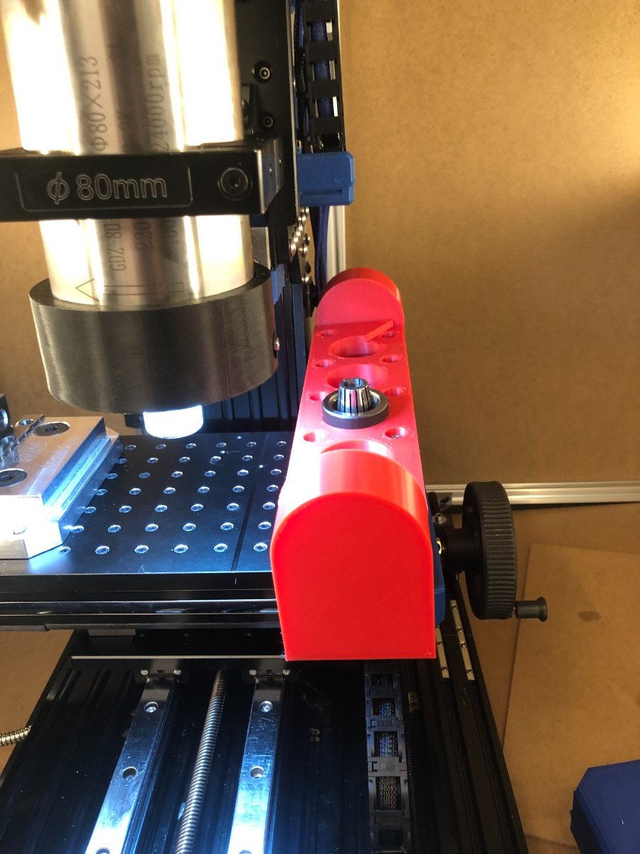

@Penatr8tor Putting the Rapidchanger on the fixture plate is out of the question.
For the spindle to align with the center of the changer on the x-axis, it needs to be in this position on the fixture plate
In this position, the spindle can only reach the 3rd port of the changer.
The changer needs to be aligned away from the Z tower for the spindle to reach the 4th port.
Maybe mounting it in this position on a movable platform with linear rails and a stepper motor to move it forward to change tools
Edited by PFarm

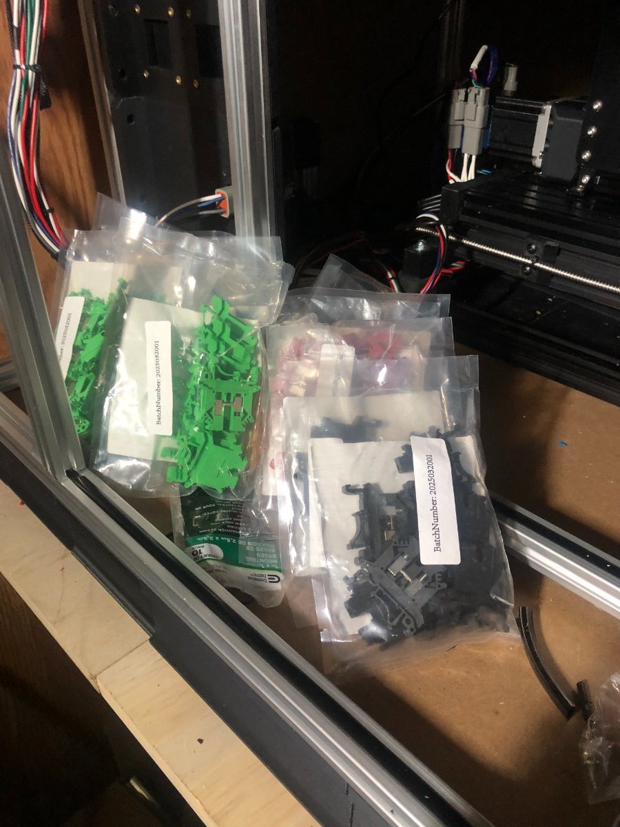

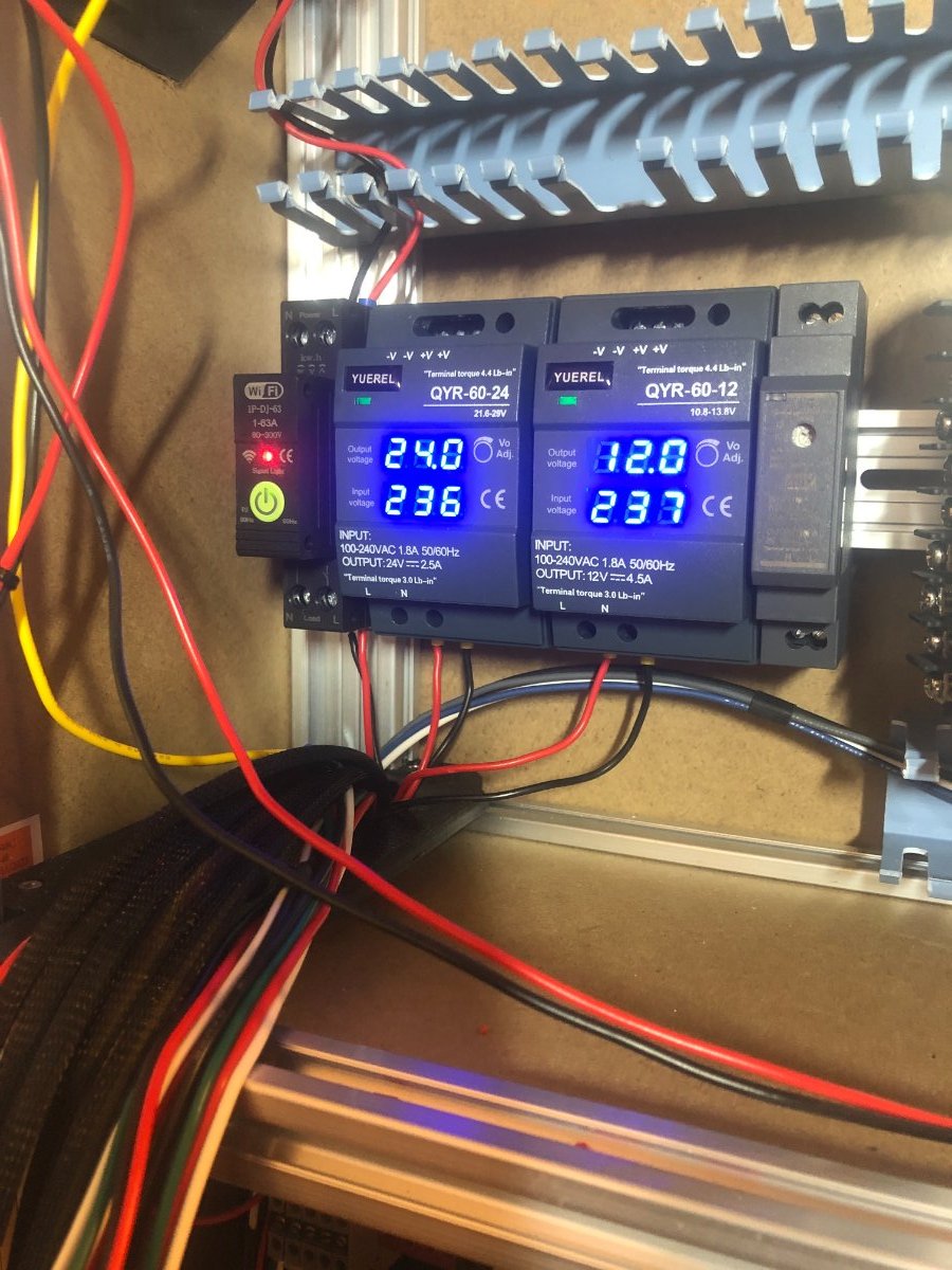

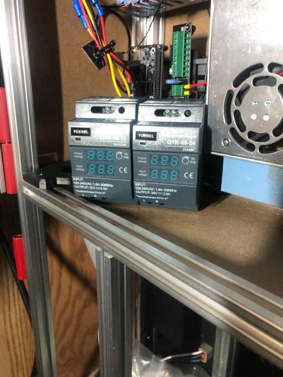

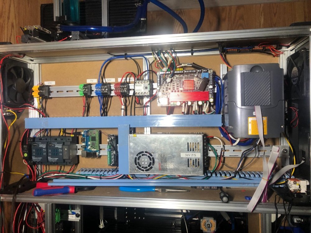

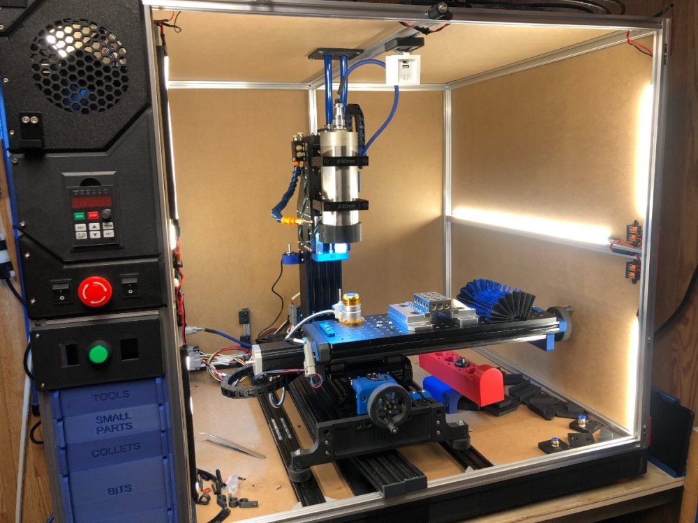

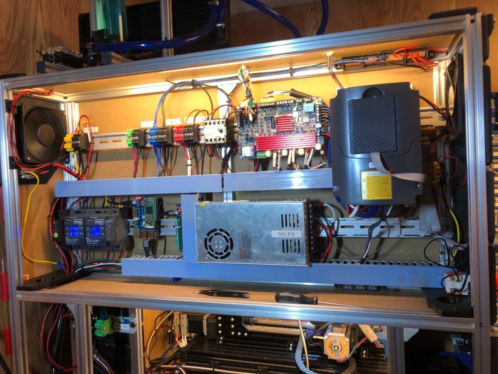

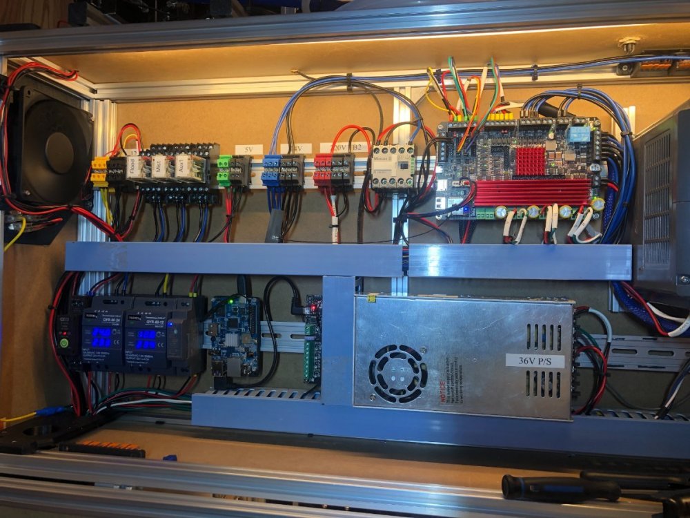

I started the re-wiring of the Casa enclosure, installed a Wi-Fi circuit breaker, a 24v 60w PS and a 12v 60w PS. Waiting on the FBI-10-6 bridge pins for the UK2.5 DIN terminals.

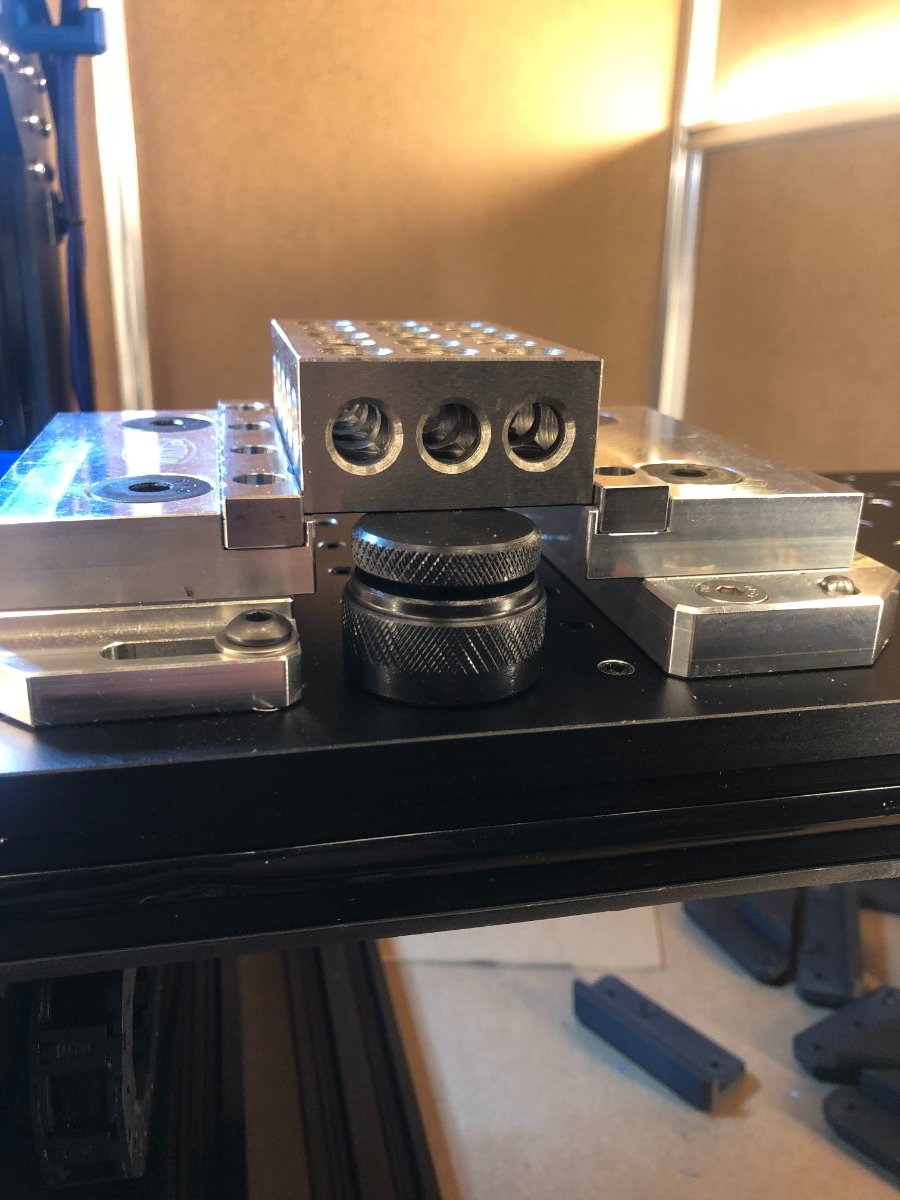

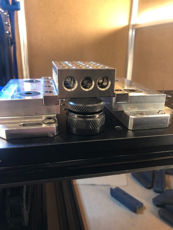

I purchased two of these machinist jacks, used to support overhangs of 1 inch or greater to prevent chattering. The second one to arrive tomorrow.  Adjusts from 23mm to 30mm. These work nicely with the Saunders Metal Works hobby vice.
Machinist Jack Link

Not at the moment, I'm going to stay with the Scylla board to get more experience running the mill. Millennium OS really helps beginners learn the operation of the mill.

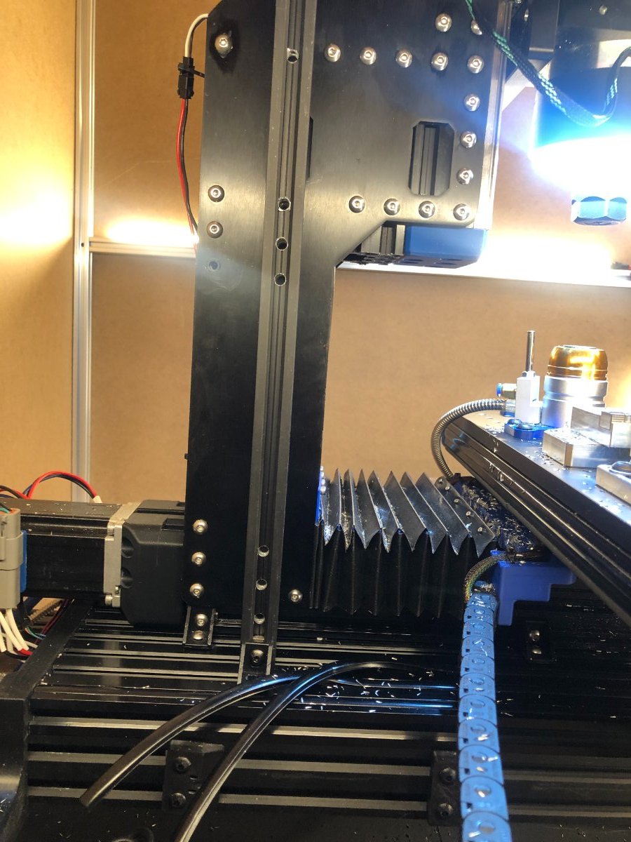

Yeah, you bet it's been over a year, self-sourcing slowed progress, and the last bit was finding bellows for the Y axis. With this first process found some things that need to be tweaked. Need to move the toolsetter to the opposite side where I first had it to prevent the touch probe from getting tangled in it during probing.

I cannot believe other Milo owners are running it without Casa or any Enclosure at all!

Thanks, yeah, can't imagine what it would look like without a Casa enclosure. Water cooling is not necessary. The idea when I purchased it was to be able to run it at a lower RPM, but I didn't know that this mill needs to be run at 12k and above.

Wired in the coolant relays today, I need to complete the air plumbing and wire the solenoids.  Wired the pendant e-stop in series with the Casa e-stop, I couldn't get the software e-stop to work with the pendant.

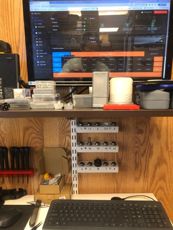

I printed some wall-mount ER20 collets. It's nice that the Casa has a collet drawer, but in reality, when doing tool changes and opening and closing that drawer isn't very convenient.

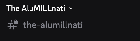

@mvdveer Have you done anything more with your Milo? Video your first cut to get a serial number on Discord, enter the syntax .serial_request followed by any description of your Milo. You then get access to this locked directory.
Edited by PFarm
Sad to say , I have not. I need to finish the CASA enclosure and mount the unit. However, it is in an area under the house and I guess - Out of sight out of mind - applies. Will revisit the project again.

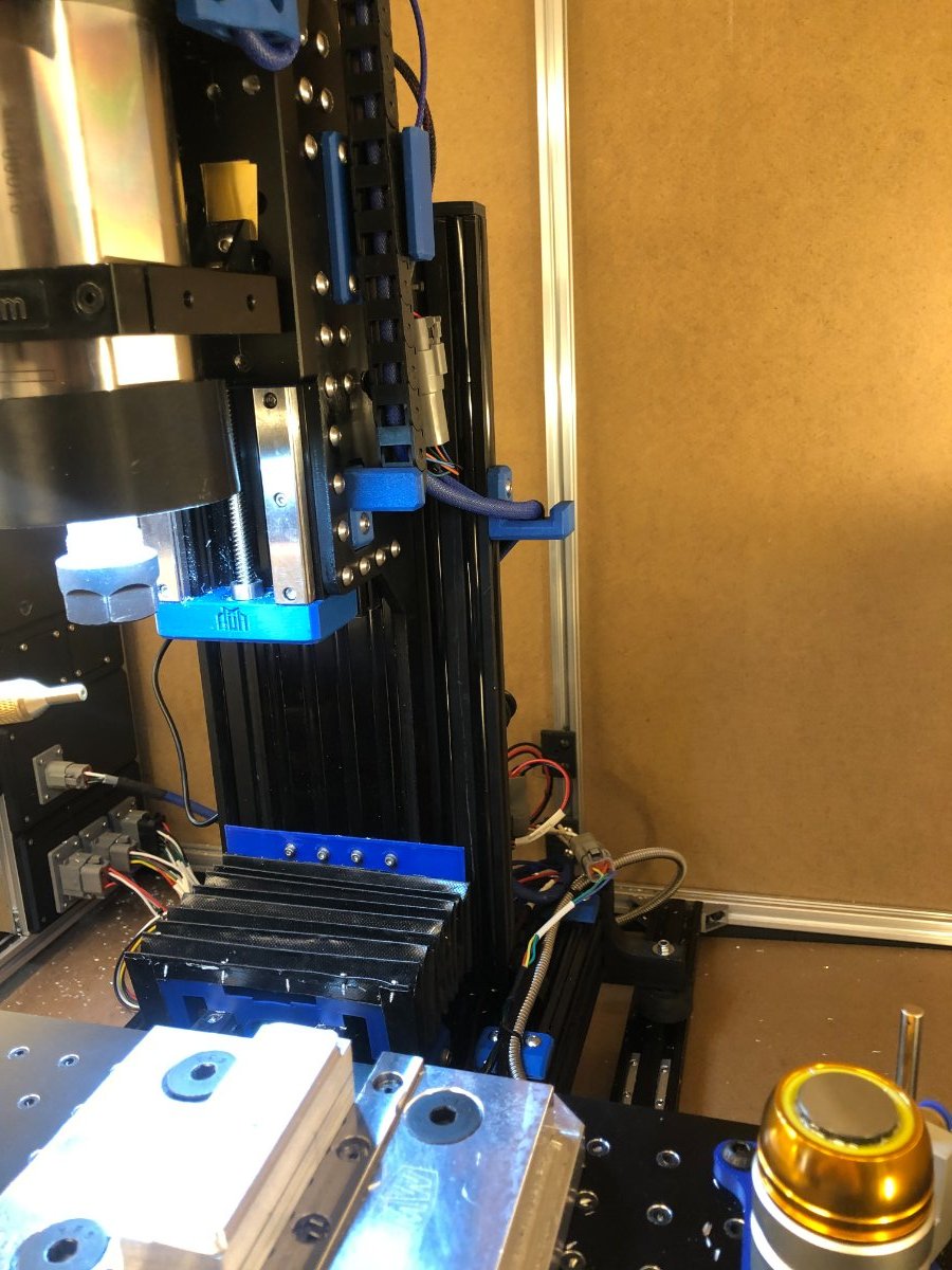

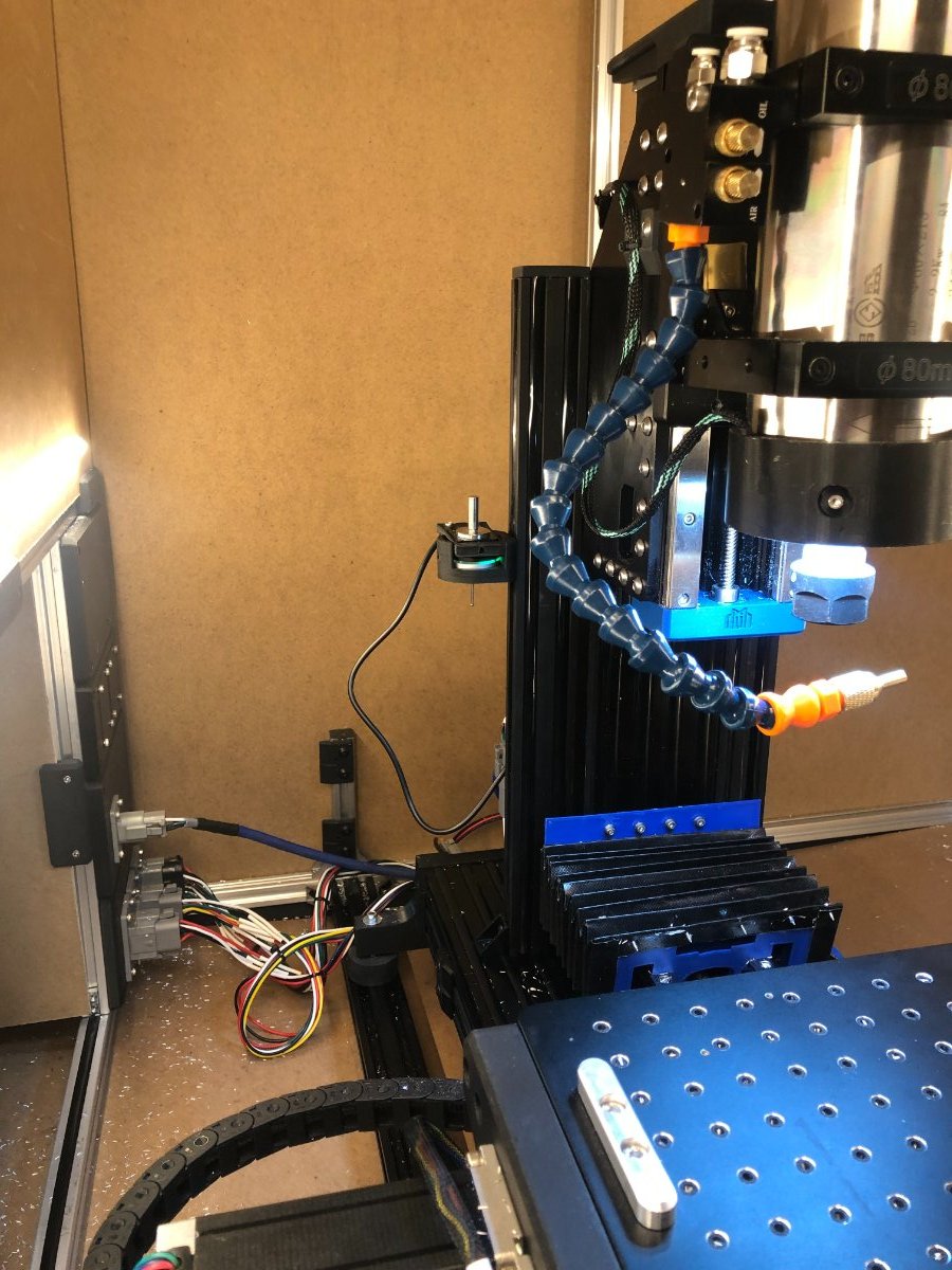

A weakness of the Milo is the stiffness of the Z column, which allows for some deflection. To stiffen it up, I've installed a 2040 extrusion on both sides of the column. I drilled through holes in the 2040 to line up with the FMJ screws so I can slide the 2040 onto the M5 and tighten them.IMG_3113.thumb.JPG.518b18d3104e74c9c1d1204a60168476.JPG
I had to relocate the touch probe holder and the cable guide on the opposite side.
