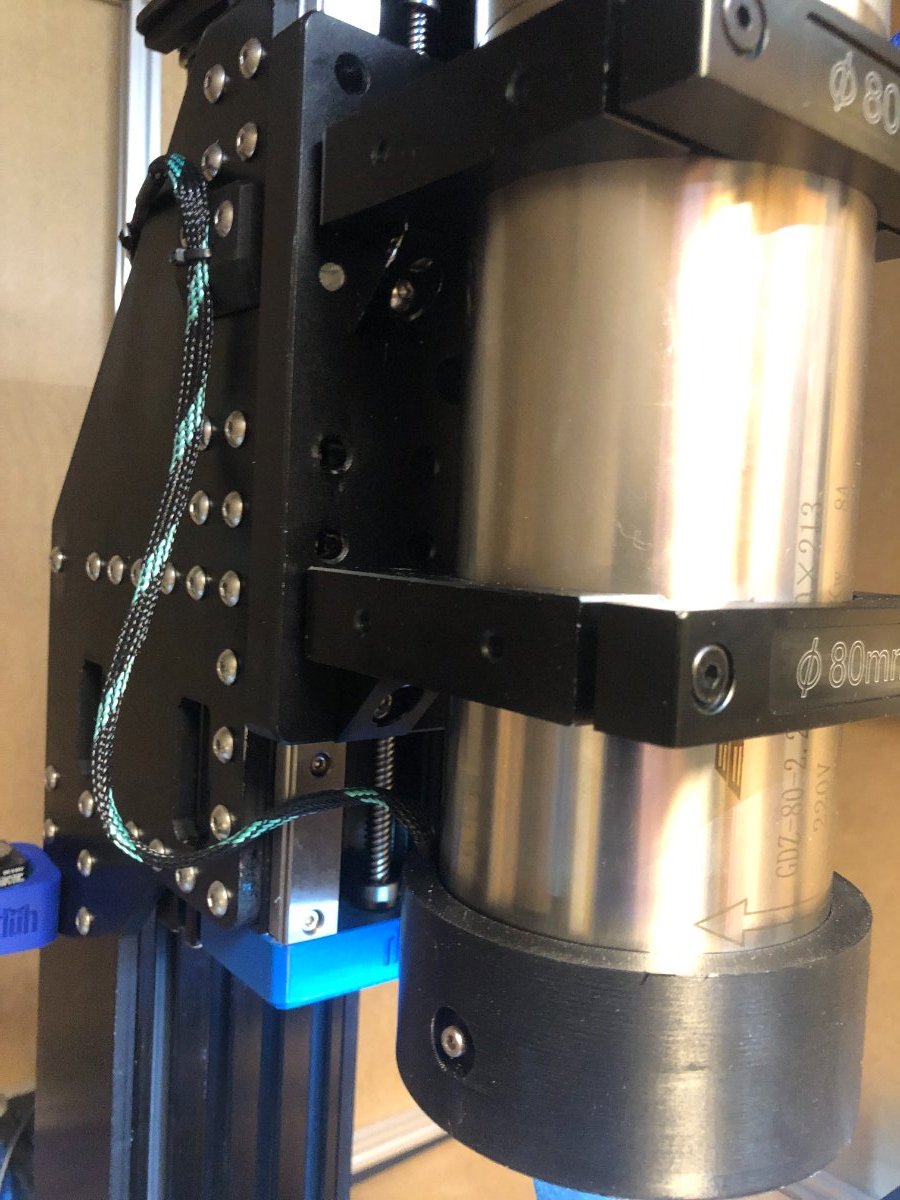

Update: With the holes enlarged, I got the spindle trammed side to side .-001mm and front to back .-003 by shimming the top bracket with 0.1mm shims.
Edited by PFarm

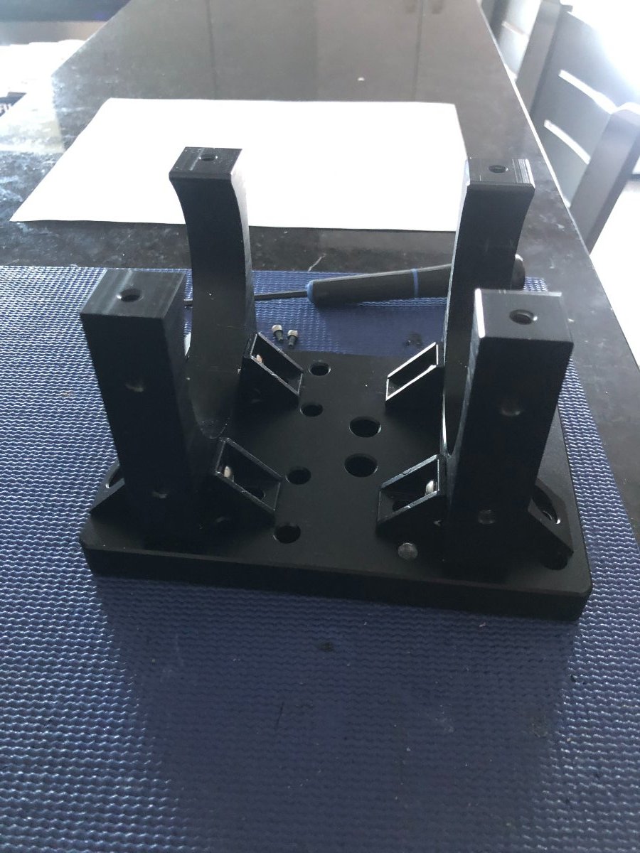

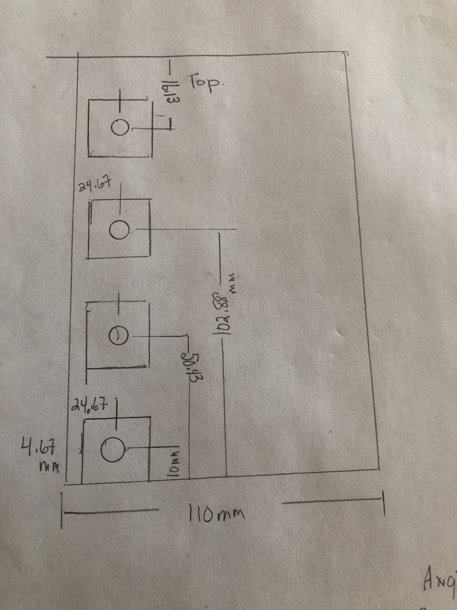

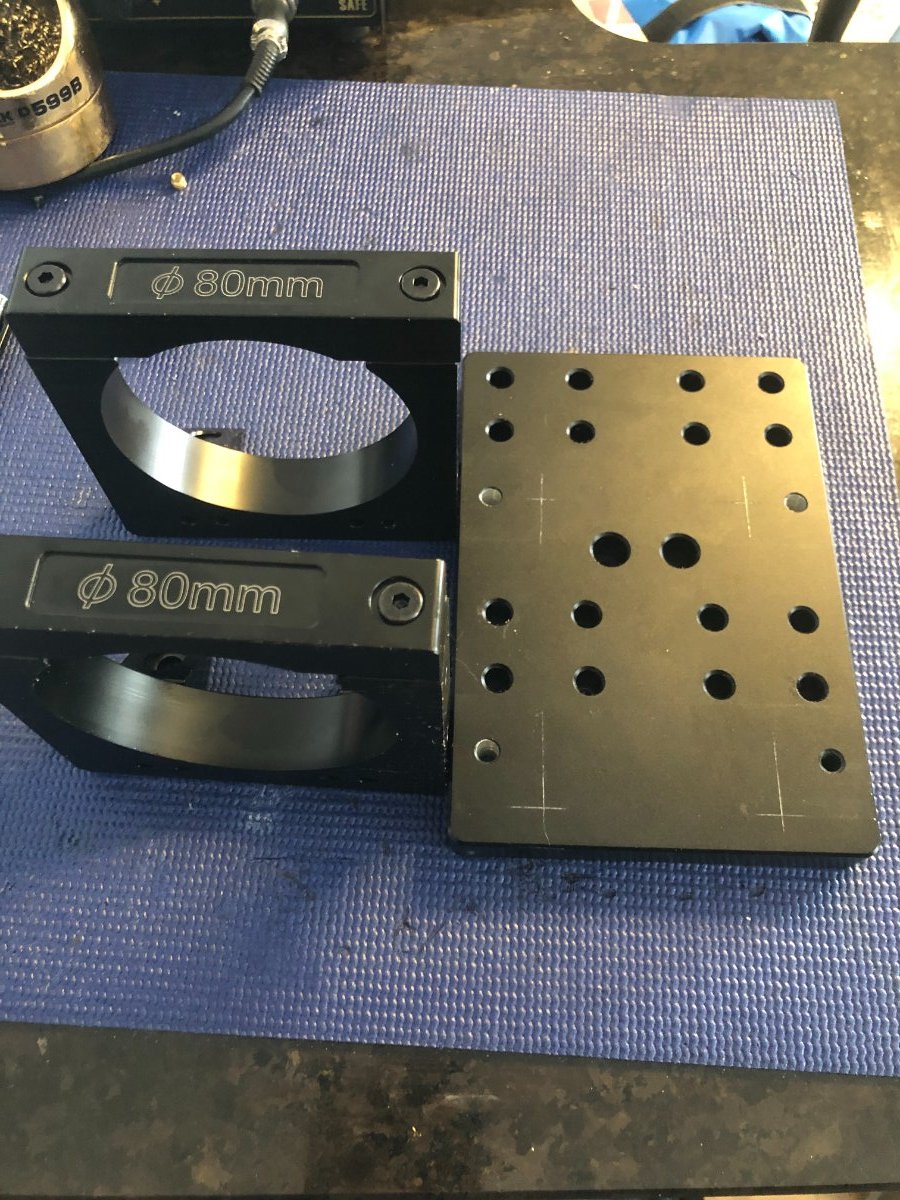

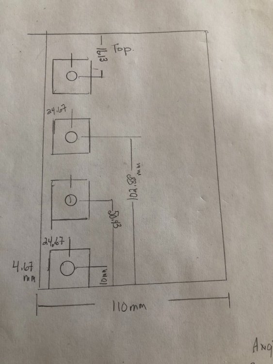

Aluminum mounting brackets for the spindle came in today! Marked out the hole locations for the angle bracket and aligned with the center of the Z plate.
Here are the dimensions for the holes and these are the brackets I purchased 80mm Brackets
Mounted the brackets and re-secured the spindle. These brackets have a nice tight fitment clearance with no front securement plate tightened, the spindle won't slip downwards under it's own weight! Loctite everything. Don't mind the mess of wires behind the mill that next on the to do list.
One thing I wanted by mounting it this way as opposed to using the rear mounting holes of the brackets was the ability to easily tram the spindle. I highly recommend these bracket will worth the $50 spent.
I'd like your opinion regarding the angle brackets I only had 4 on hand would you install 4 more to secure the bracket?
Edited by PFarm
Can't hurt - will only add to the stability.
Those corner brackets are cheap enough and the added weight is too little to matter that much so...
more rigid is more betterer. 😃

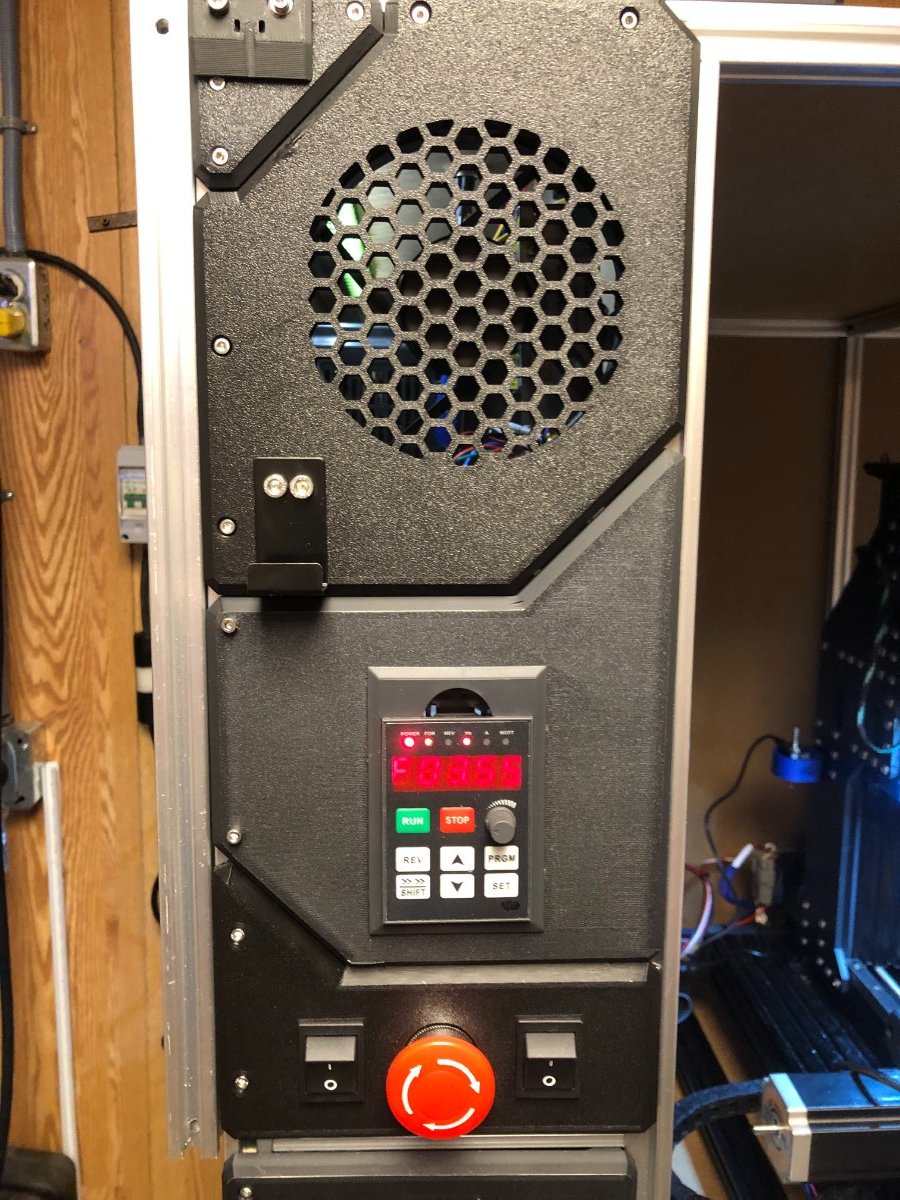

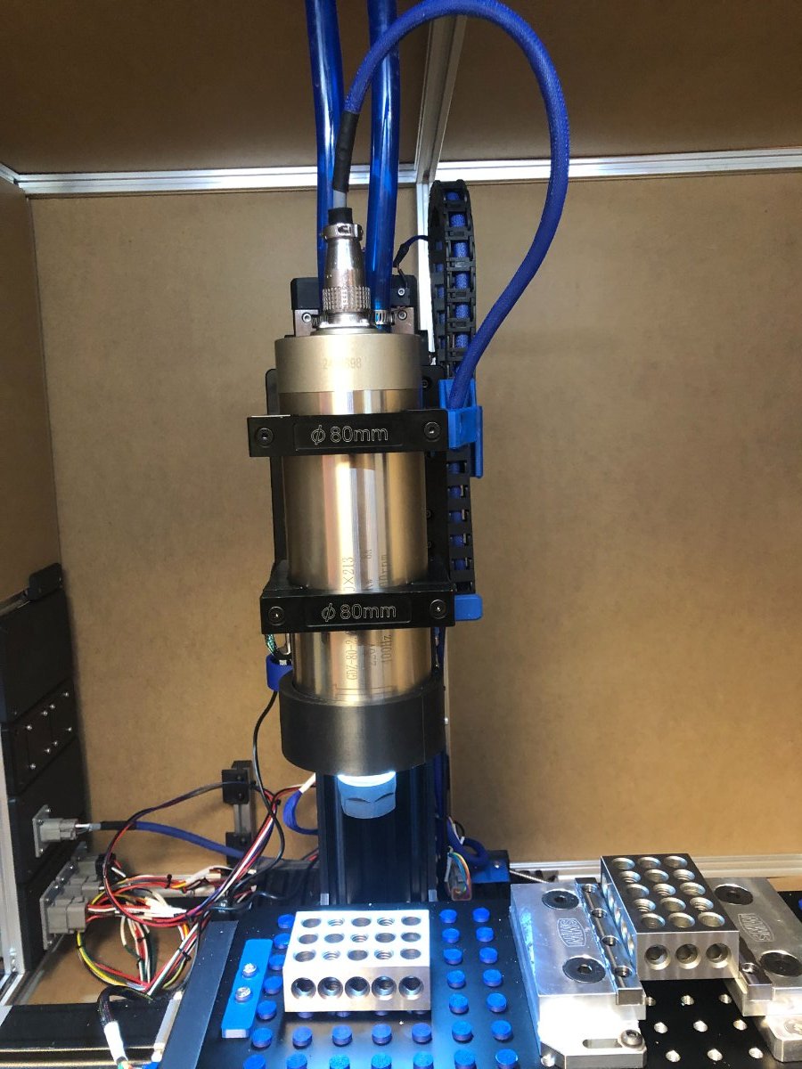

With the VFD mounted inside the electronic compartment, the door wouldn't close (hitting the knob).

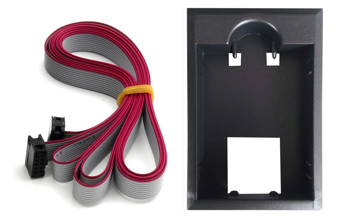

Order an extension cable kit for the VFD display on Amazon. Extension Cable Kit

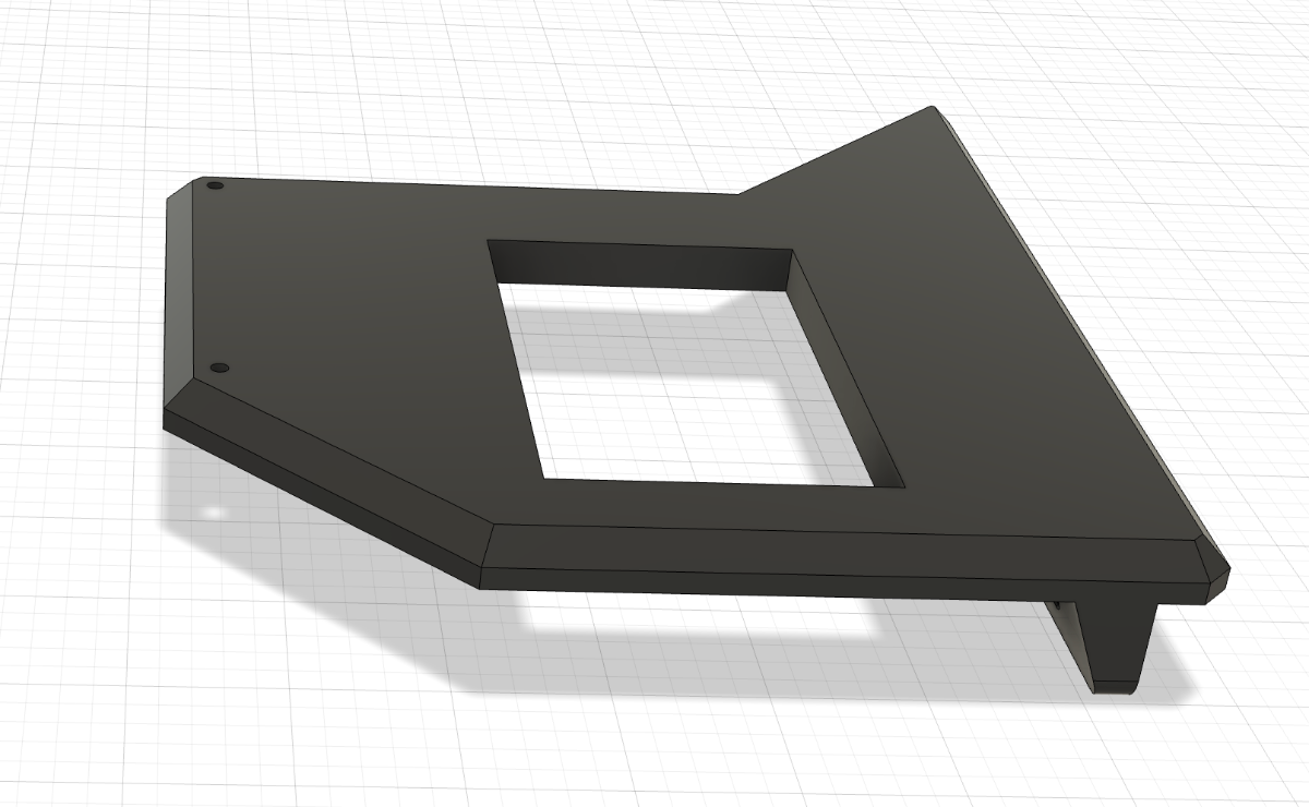

Re-modeled the Front Mid-Cover to accept the remote display.
The VFD display is fitted and the door now closes properly
Edited by PFarm
1 hour ago, claudermilk said:
Hiss! Old-school ribbon cables! I hated those things building PCs back in the day.
Can the wire be separated easily if you cut them carefully to get them started then pull them apart to separate them? I would rather have them in a bundle instead of the flat cable.
You could but I wouldn't. Too much can go wrong. When these wired are split apart, there is a risk of exposing the bare wire. How do I know?  Tried it. Also it will be a timely exercise. I personally would just make peace with the ribbon cable. Sometimes "old school" is OK 🙂

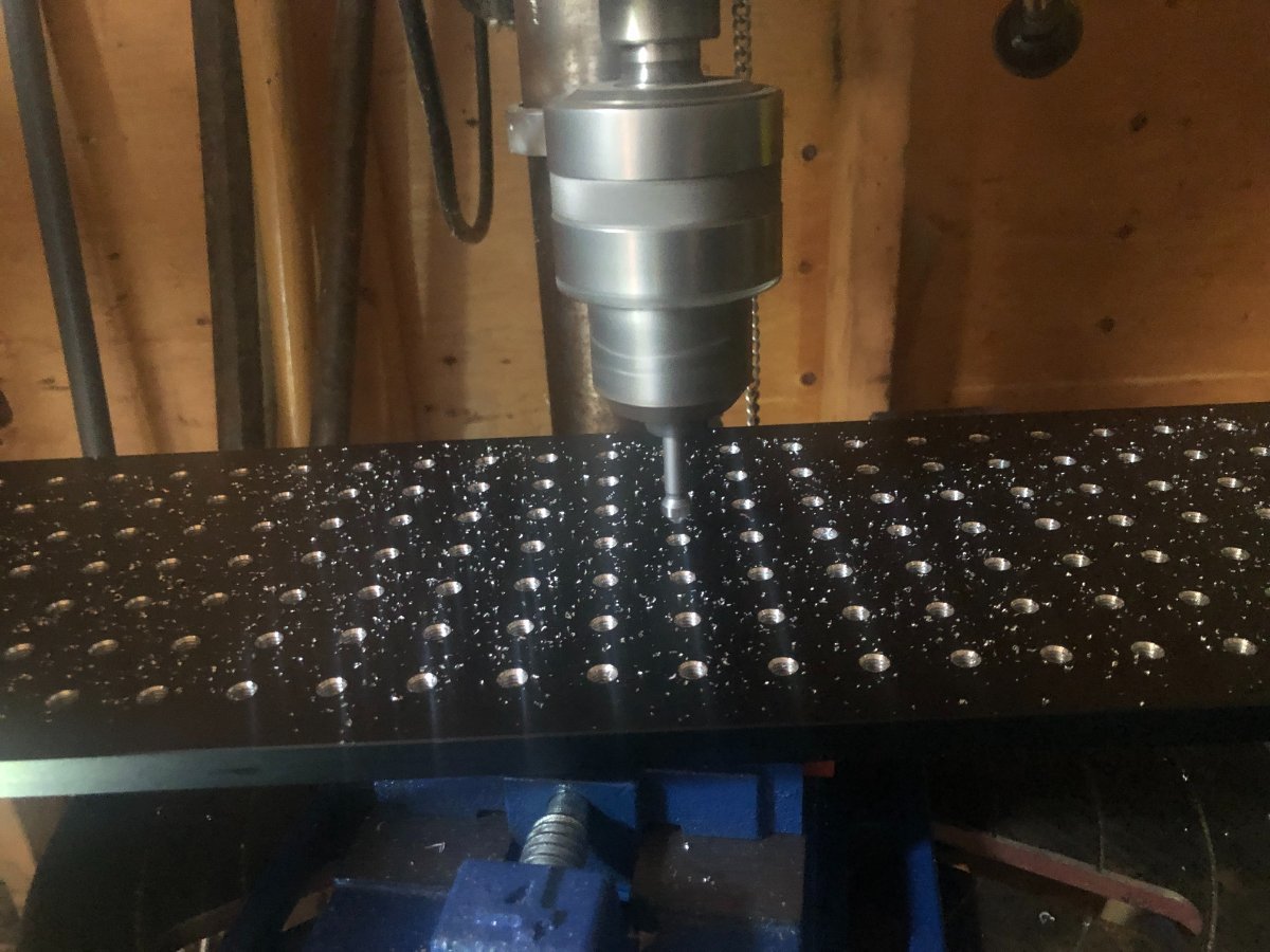

Having tapped my fixture plate for M6 fasteners SMW has modelled plugs, you can 3D print them with a slot or hex head. This will help keep the chips out of the holes.
https://www.printables.com/model/776413-smw-fixture-plate-plugs-14-and-m6
Edited by PFarm
Did you do this because most fixturing seems to start at M6? Did you do it by hand or with mill?

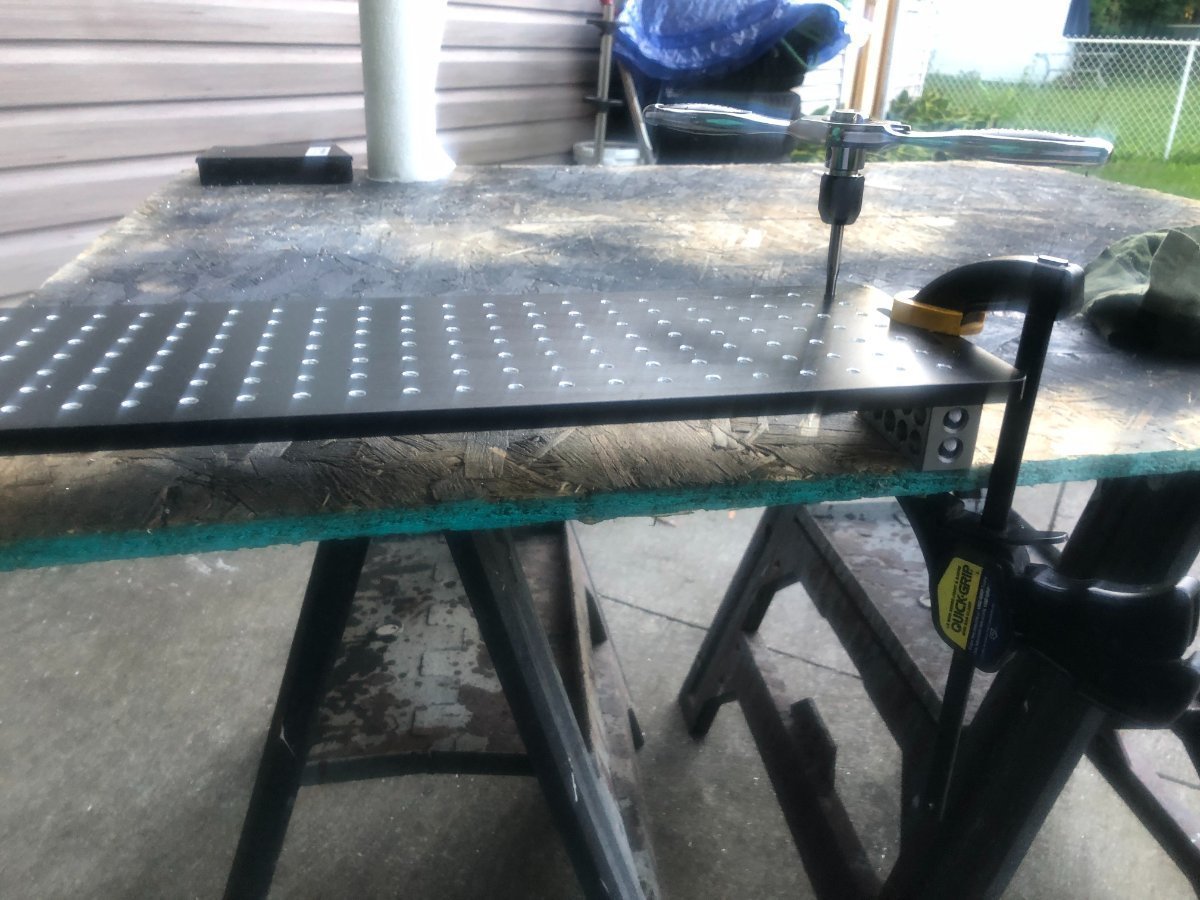

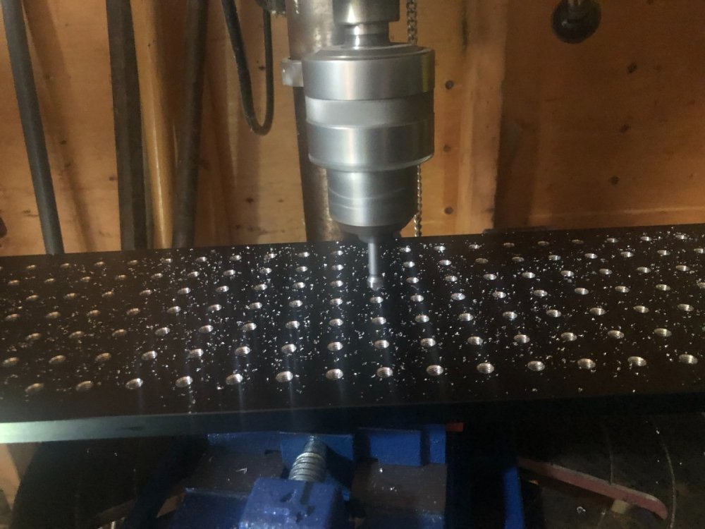

I purchased the fixture plate from DFH_FM USA which was drilled but not tapped. Since I'd purchased the SMW Hobby Vise which use M6 fasteners I drilled, tapped and chamfered the hole to receive M6s. Drill and chamfered with a drill pressed but tapped by hand. I preferred doing it by hand so it was started straight and could feel when the tap needed to be backed off long process but worth it IMO.
LDO kits come with an M5 hole fixture plate.
IMG_2419.JPG.31361d4330b0412865eca74c284b72e8.thumb.jpeg.9a0f05580c24455baac3e519fbbacdc6.jpeg
Chamfer bit in the drill press.
Edited by PFarm

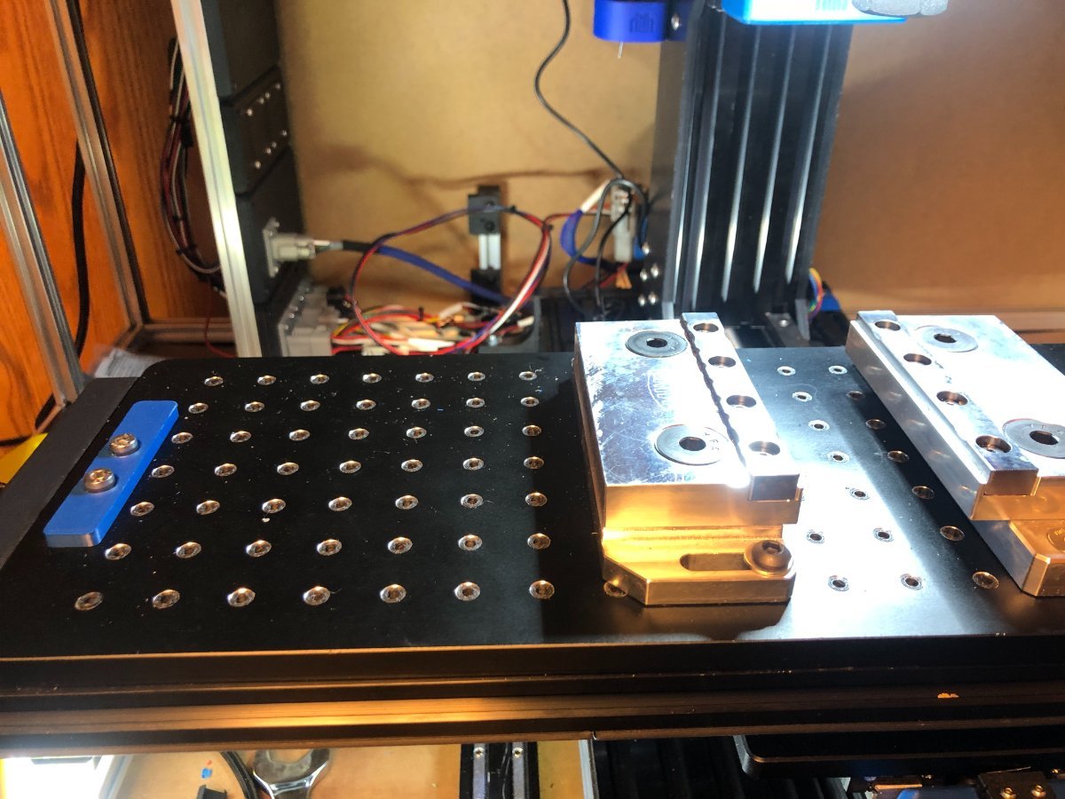

  • FYI the LDO fixture plate is tapped for M5 fasteners, and the SWM hobby vice comes with M6 fasteners. People use M5 fasteners with a counter sink washer or drill and tap the first and last row of the fixture plate to M6.
  • The reversible jaws are sold separately.
  • I'd also recommend getting 2x M6 pins they're used to align the fixed side of the vice.

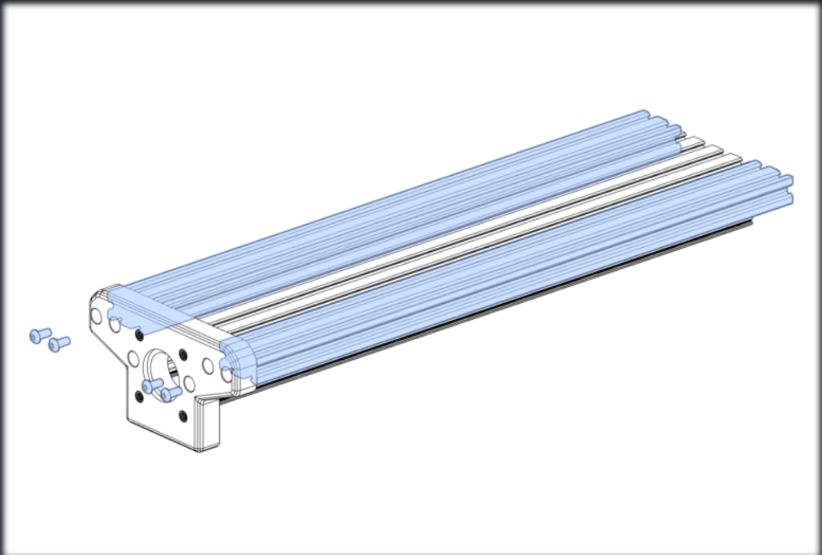

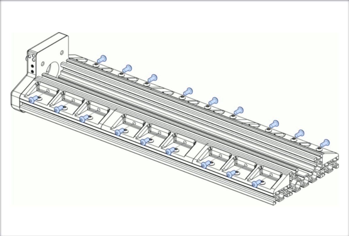

Update X Extrusion Assembly:

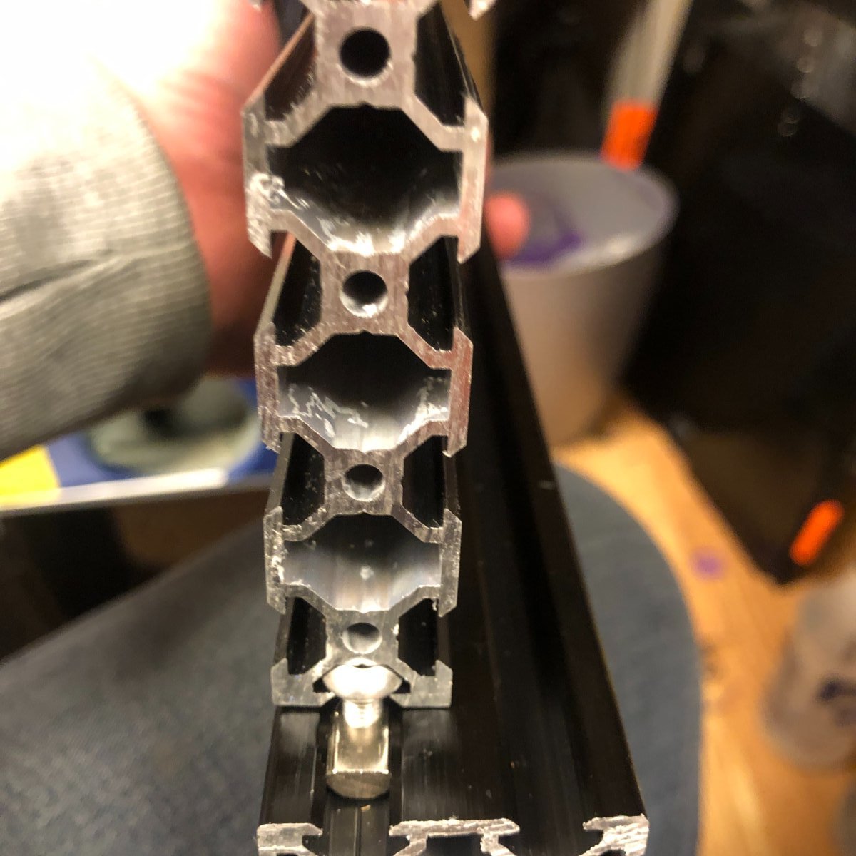

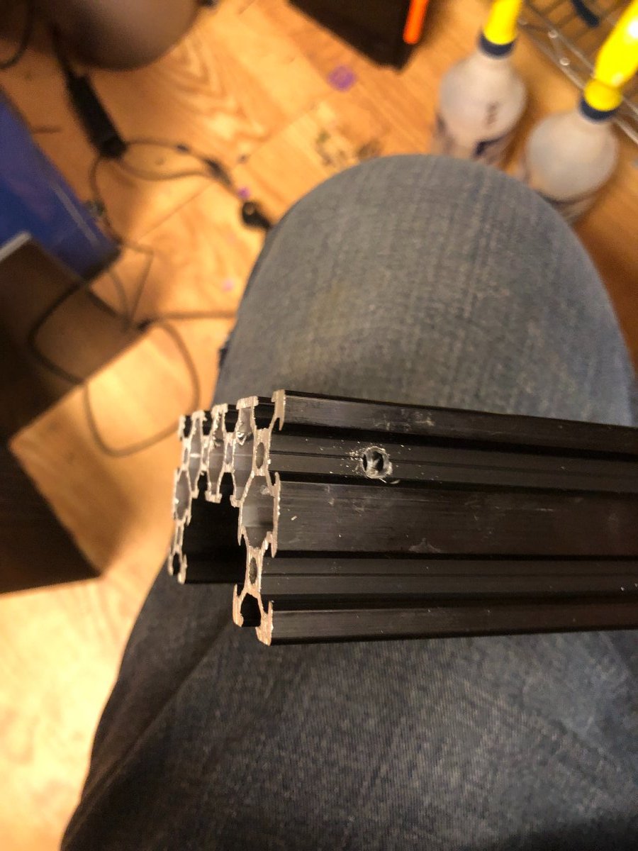

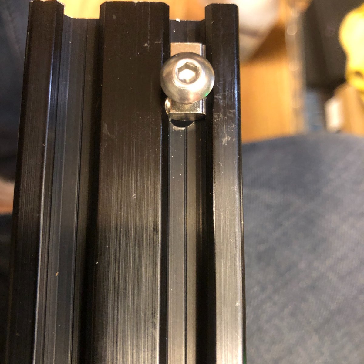

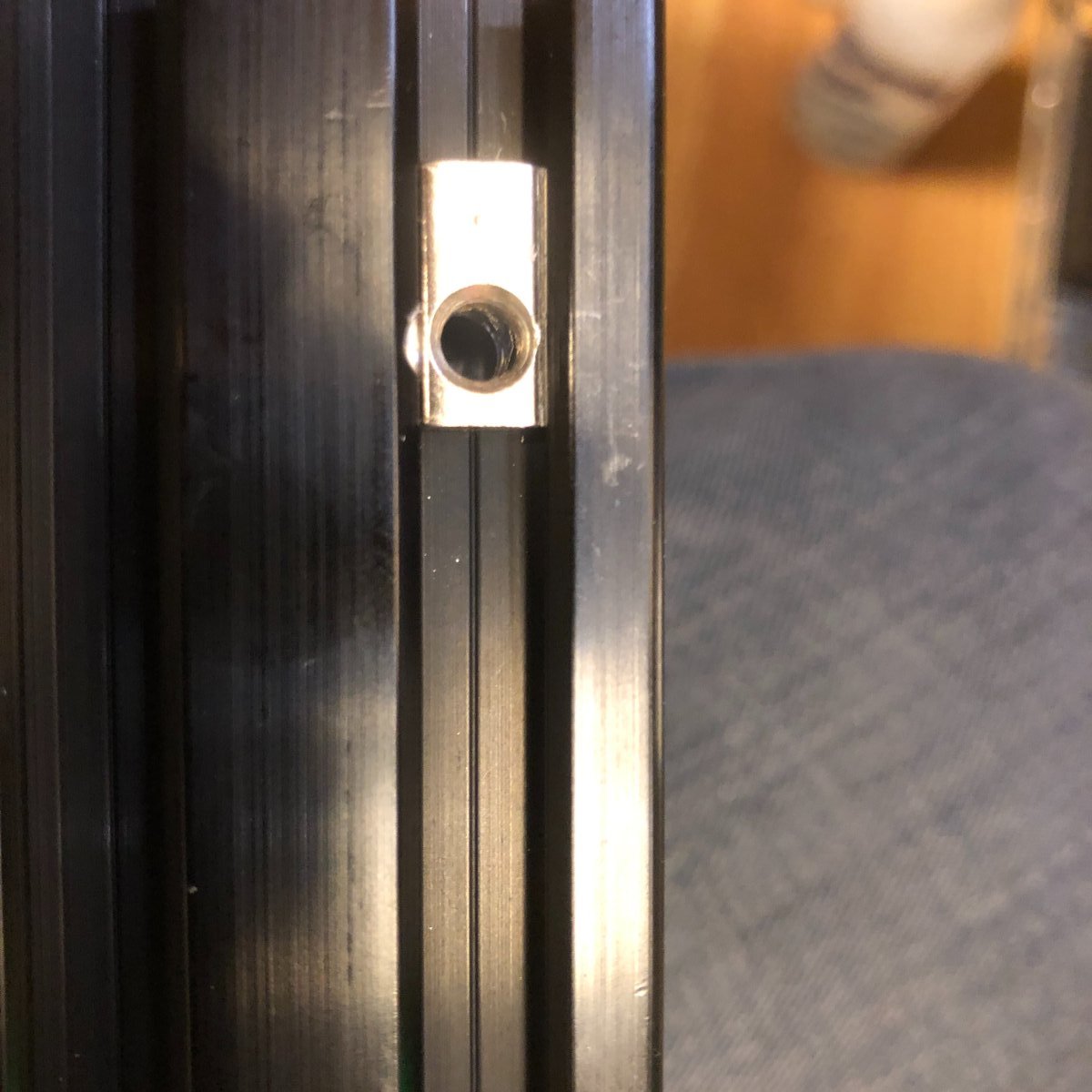

@Penatr8tor When assembling the two 2040 to the C channel mark the 2040 and C channel so they line up at the same locations (I use a cheap set of calipers). On a drill press drill thru 2040, on the C channel only drill into the first void. Hole should be big enough for the M5 to fit in it.
Line up the M5 T-nut with the hole
Screw a M5 -10 in the T-nut till it screws into the hole until it can no longer slide
Slide the 2040 over the M5 screws and tighten thru the hole in the 2040, Jake recommends 4 x M5 per side.
Use the 123 block to line up the surfaces flush. You can eliminate the printed angle parts shown below.

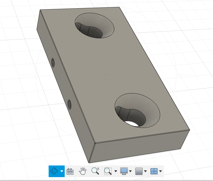

Here is a link to some steps files that a Discord member kaddeh|M113 is willing to share his designs with others.
He's modelled this fixture for both the SWM and Inception vices.
This is the fixed side soft jaws for the SWM vice that this fixture would mount to with the two fasteners you see in the above photo.
Edited by PFarm
