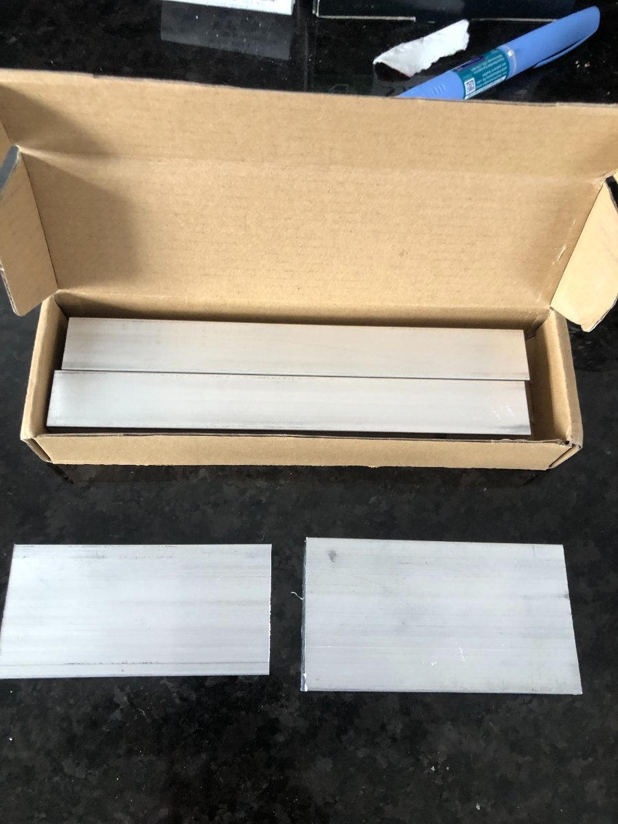

Aluminum stock came in today. I'm waiting on a 12VDC power supply replacement the one that ran Casa Elec.-bay fans, the water pump and the rad fans gave out.

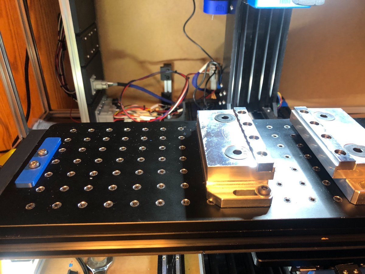

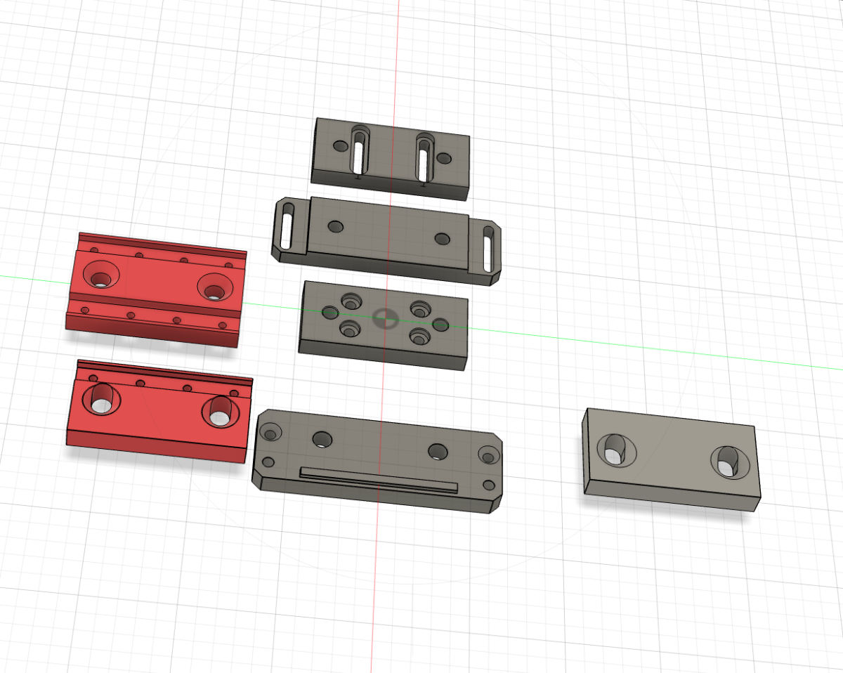

Yes, I will make the angled jaw first the fixture plate securing tabs to get a bit of setup practice.
The face jaws as well to secure the angled jaw to the vice. Need to order more 25x50x100 stock.

Yes, I will make the angled jaw for the fixture plate securing tabs first to get a bit of setup practice.
Yeah, kinda figured you would. I would do the same... My first parts will more than likely be additional fixturing, brackets, mounts, etc.

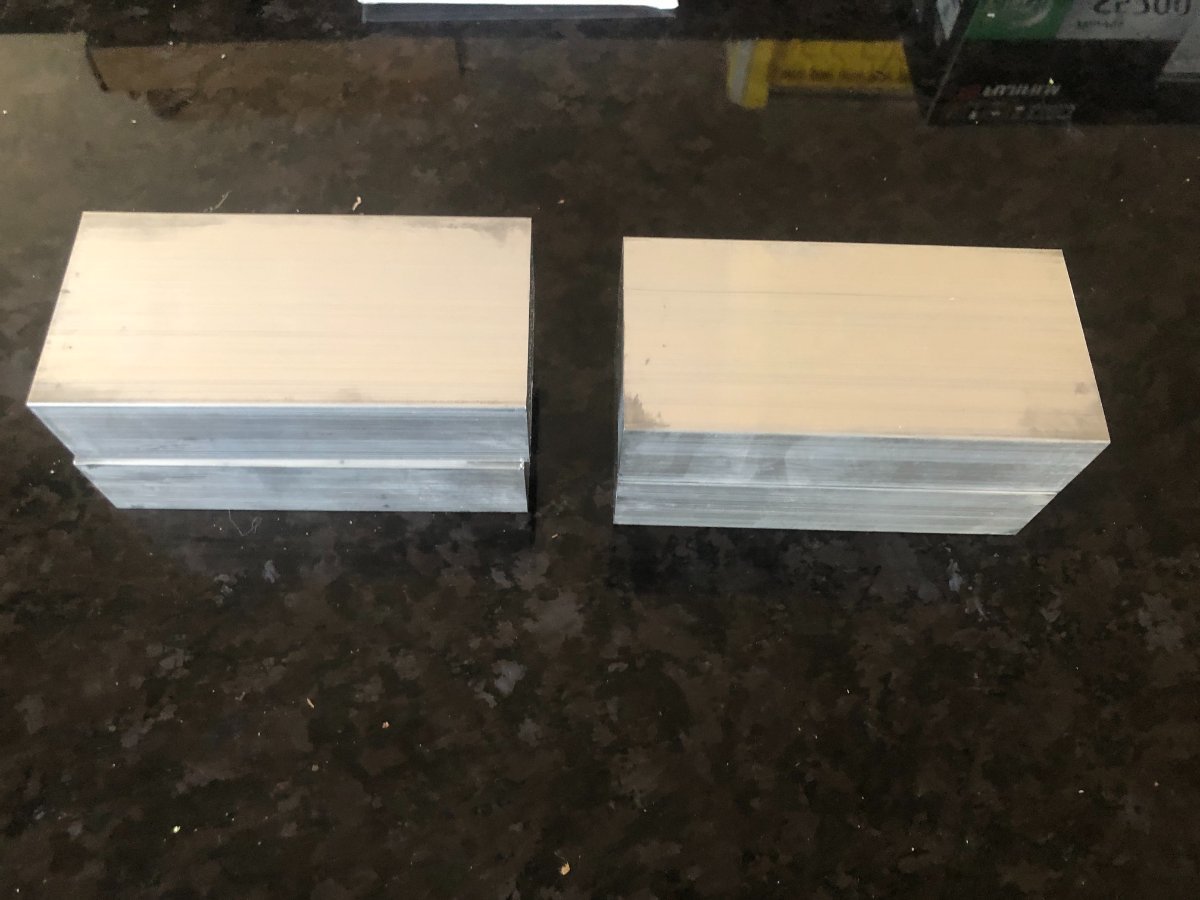

I received more aluminum stock and planned on making the double vice, the base for the double vice, and the sliding base for the single vice. However, I had ordered the wrong vice from SWM (1/4" instead of M6), so I have the top vices.
Today tramming the mill, installing the new 12V power supply, securing the wiring in the Casa, installing plexi in the doors, and completing the air lines and mist system.

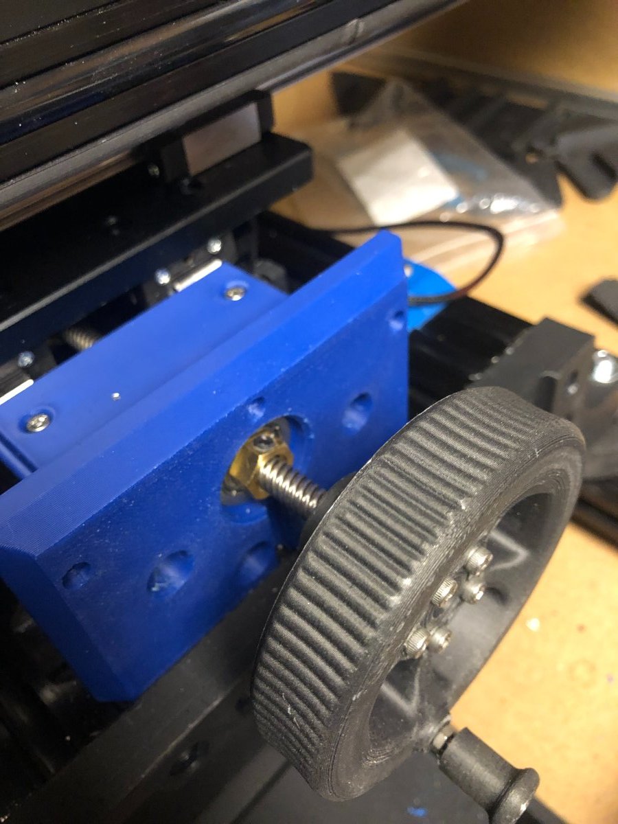

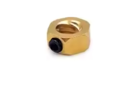

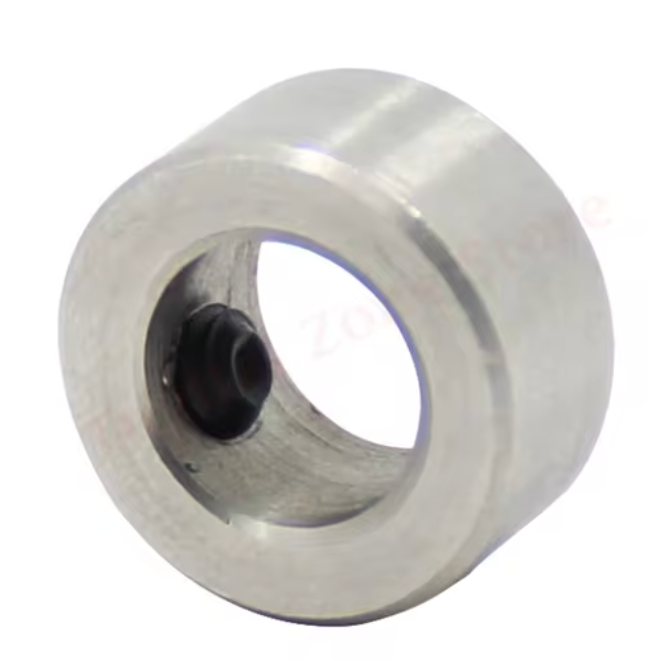

@Penatr8tor @mvdveer I'd suggest getting these leadscrew nuts. These ensure the the grub screw seat on the thread of the leadscrew. The conventional lock sleeve has the potential of seating in between (the void) the leadscrew threads
@mvdveer Installing these on the X/Y is not too bad on an assembled mill. Pull the handwheels off, remove the TR8 lock sleeve, and unbolt the stepper motor from the frame. This allows the axis to move freely and gives you access to the rear TR8 lock sleeve.
TR8 Leadscrew Locknut

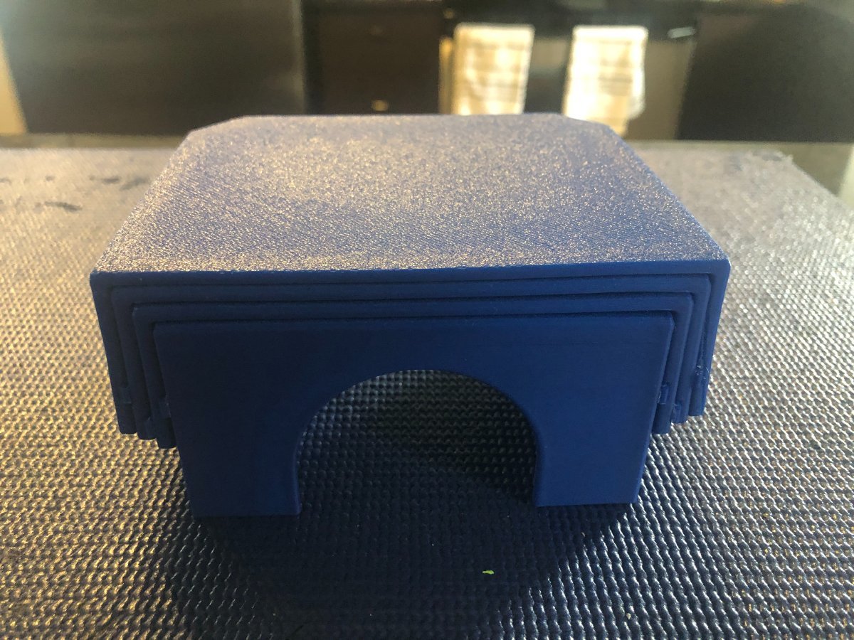

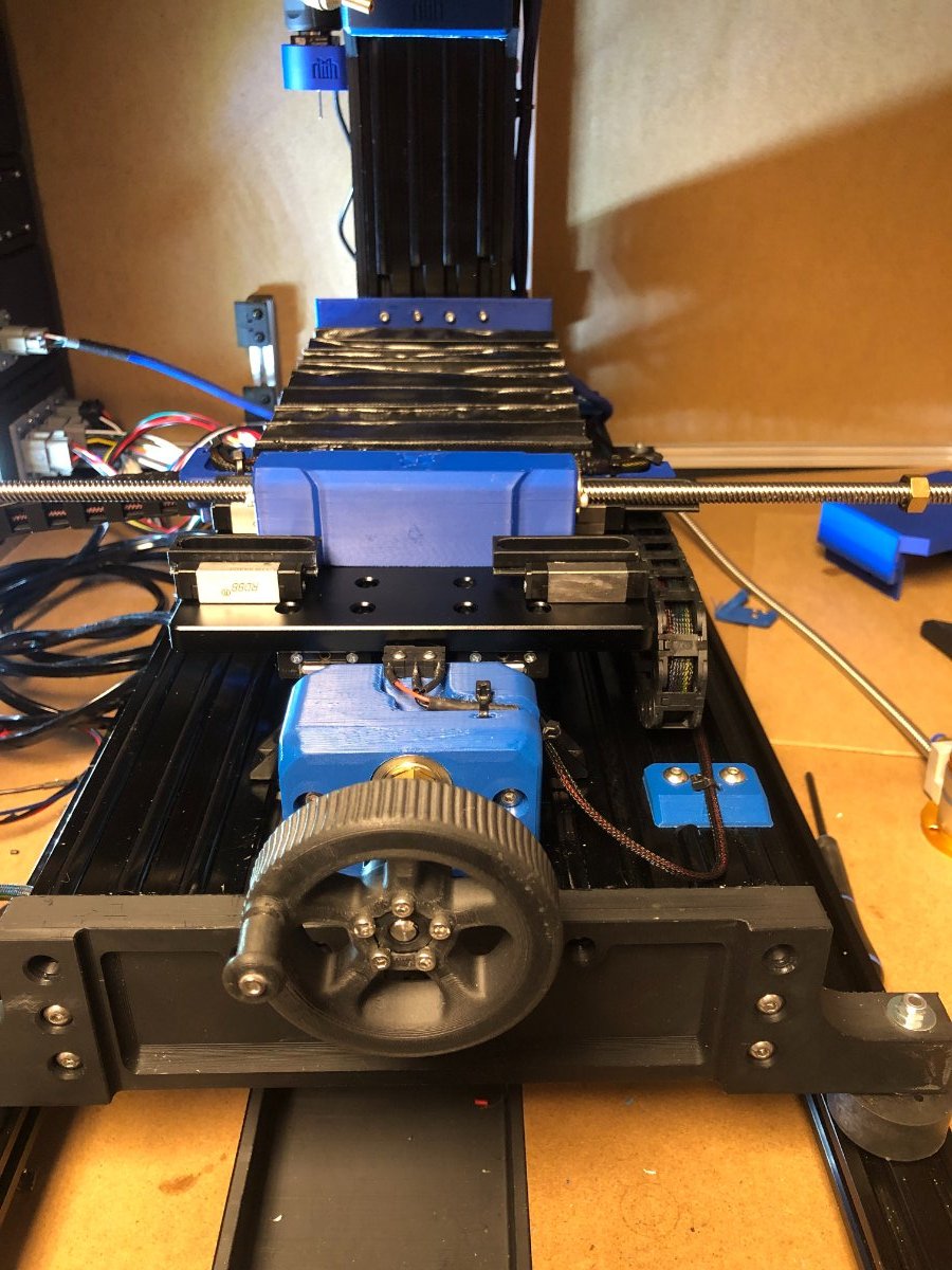

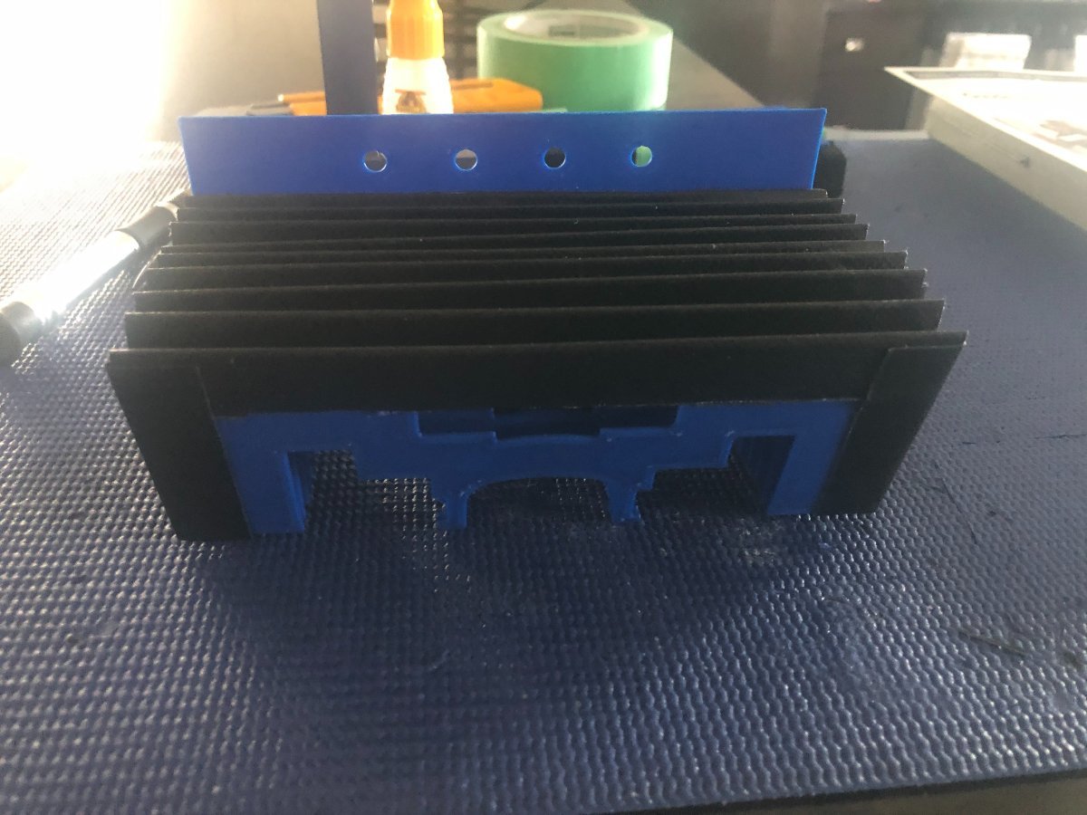

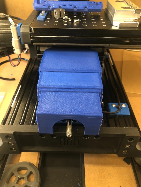

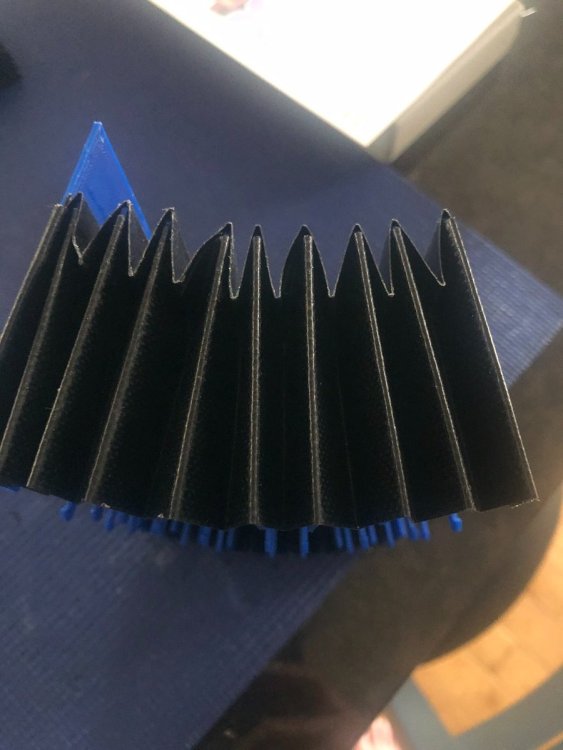

I've been building this project for a long time, and a few followers and I have been anxious to see the mill make some chips! I didn't want to start cutting without having an Y-axis bellow solution to keep chips out of the leadscrew area. I found two types of bellows from two different Discord members, one for the front bellows and the other for the rear one.
The front bellows are 3D printed parts a nice feature is it fits over the existing Y axis bearing block and the Y end stop switch is now covers to eliminate any chips reaching it. You’ll also need to tweak the endstop lever bend it toward the Z tower about 1/8”.
Front Bellows
Still working on the mounting of the rear bellows.
I've also installed 24V LEDs in the Mill compartment and electronic bay.

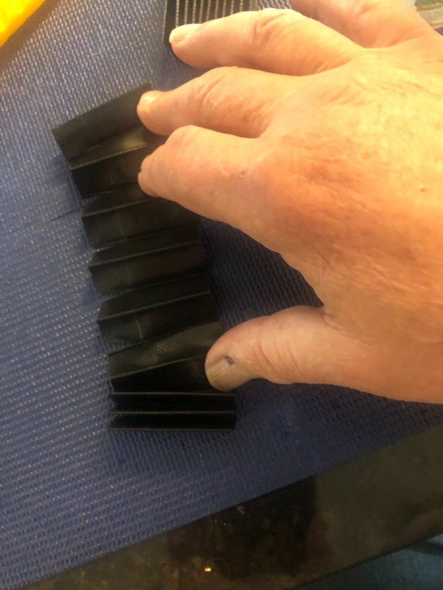

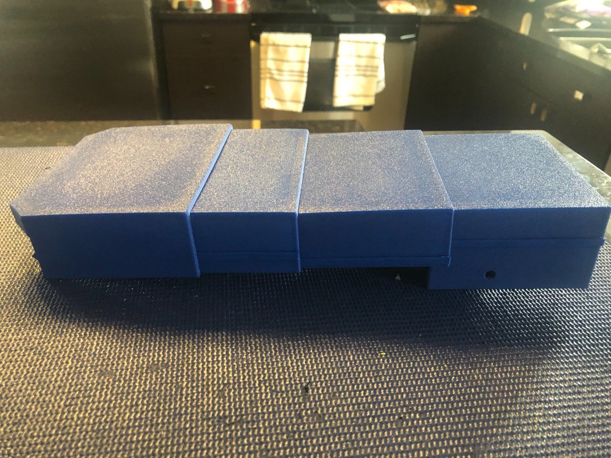

Built the rear bellows from this Discord member Discord Bellows Link . I've uploaded the modified STL and Step files
Bellow2 - with holes v1.stepBellow2 v1.stepBellow2 - with holes v1.stlBellow2 v1.stl
Make the side bellows so it fits between the V of the top bellow.
Shown is the slit of the side below.
The side bellows installed.

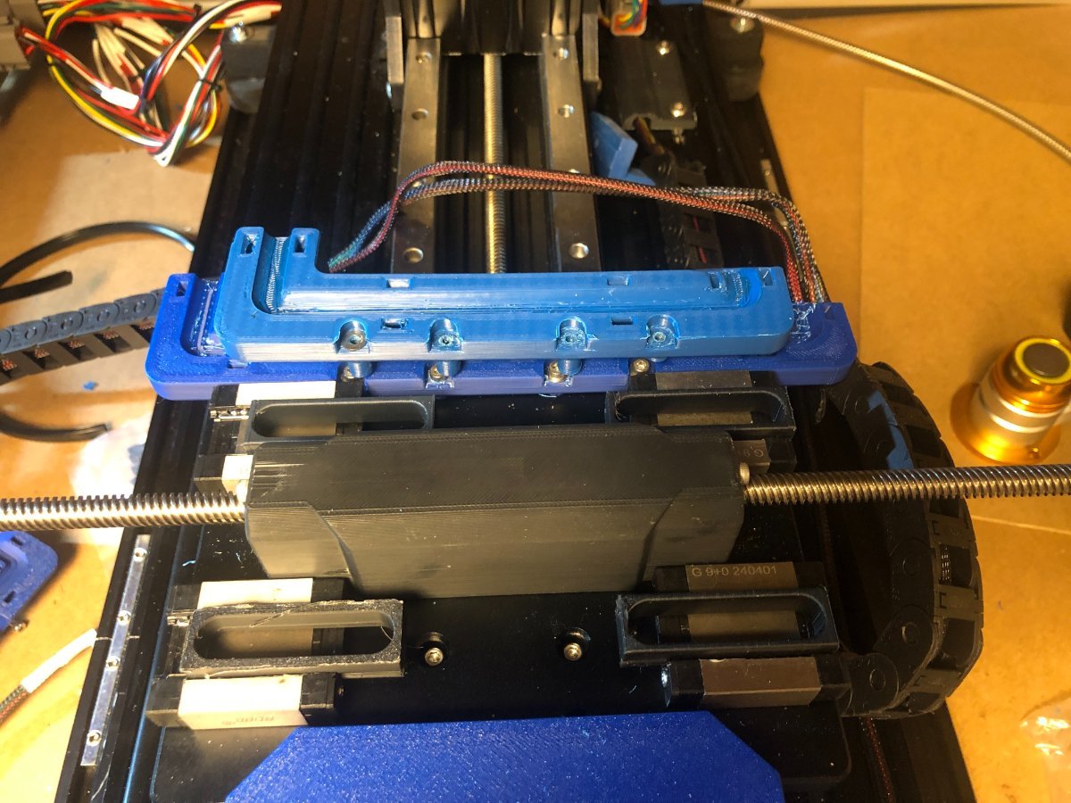

I'm looking at modifying the Y-axis transition bracket to fit the rear bellows
The bad news in order to secure the rear bellows  to the X/Y carrier is the X axis assembly needs to be removed. You need to remove the toolsetter, remove the hand wheel, remove the leadscrew lock sleeve, disconnect the X stepper wiring, remove the X stepper motor and loosen the grub screw of the stepper to TR8 bushing, pull the stepper of the TR8 lead screw, remove x axis end stop, remove screws from the X axis drag chain end link. Remove the X axis bearing block fromt he extrusion, pull the X axis extrusion assembly of the linear bearings, install linear bearing dummy rails.
Edited by PFarm

The clear blue MXD U-Fold Sherline bellows are very interesting. I think this is something that could potentially be adapted to the Milo. What I like about it is that it's all one piece.

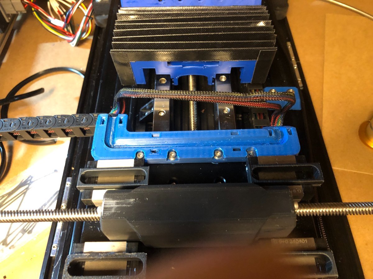

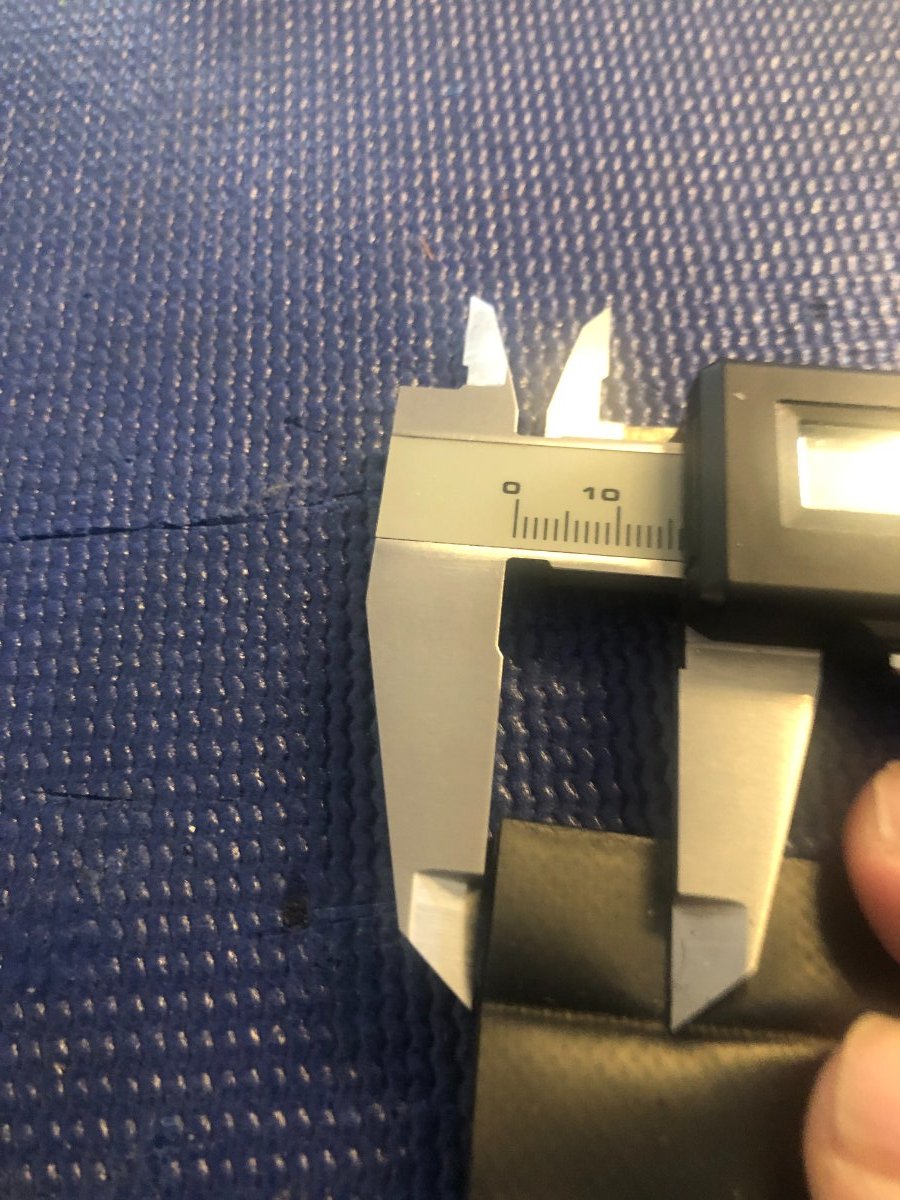

I removed the X-axis to measure what I need to extend the cable transition bracket so the bellows fit against it.
Transition bracket extended comparison.

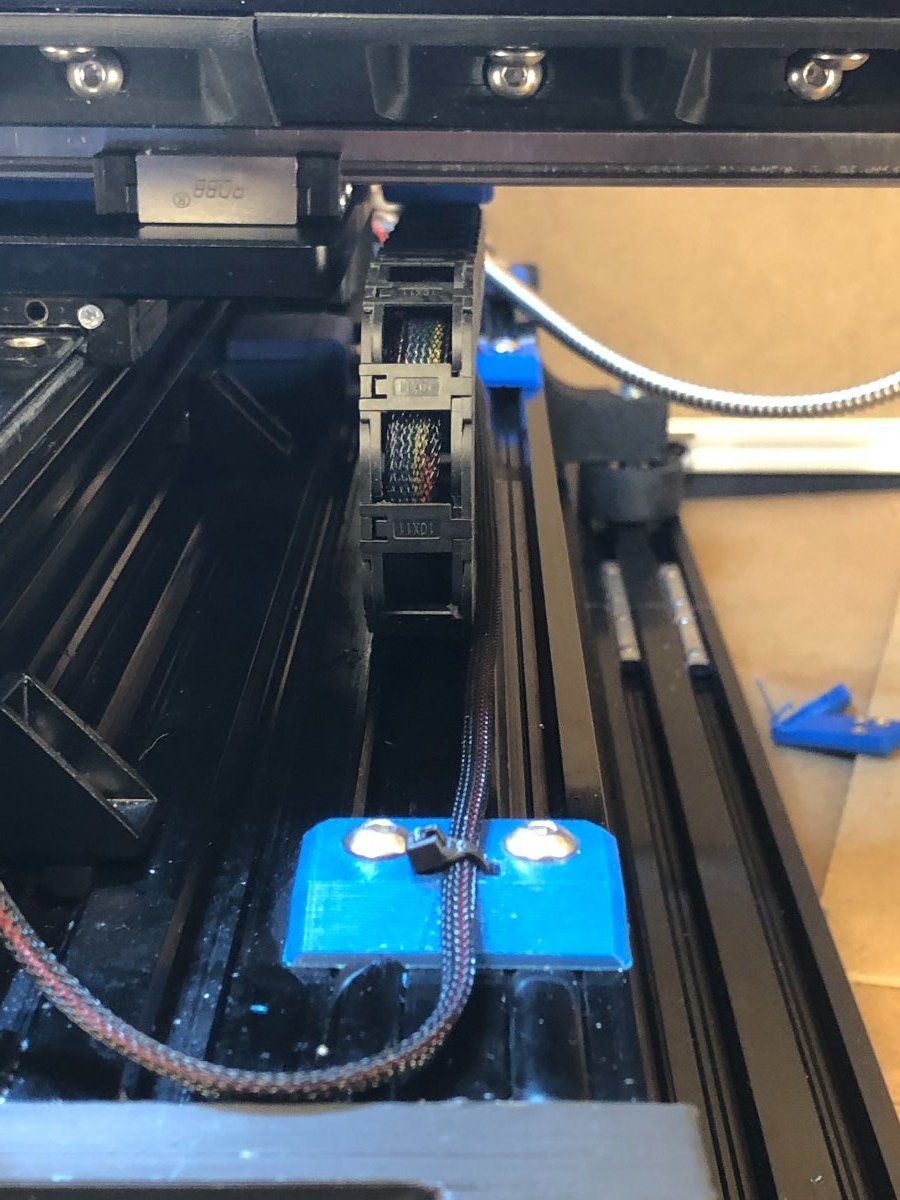

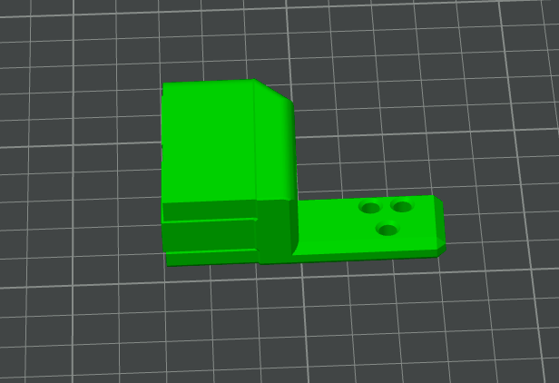

Extended the Y cable chain mount by 20mm so it lines up with the extended cable transition bracket.

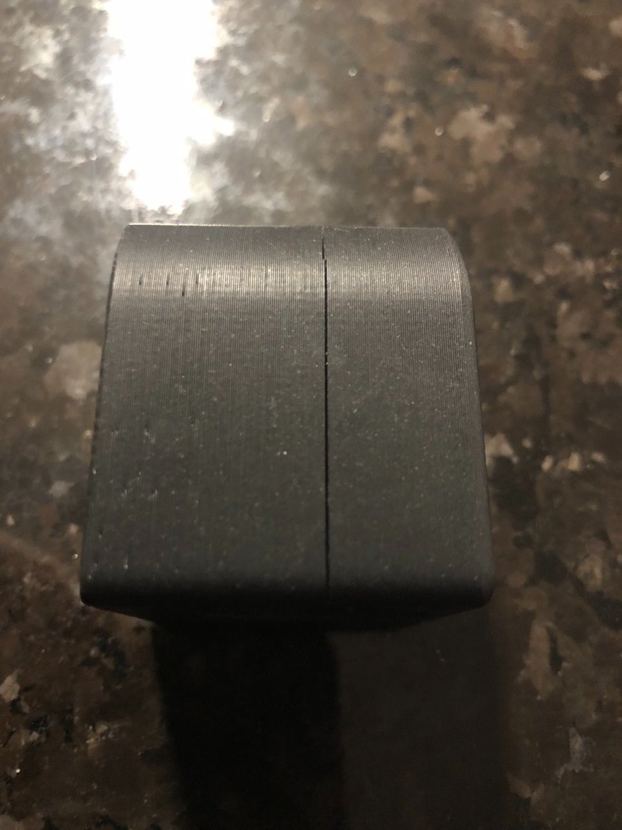

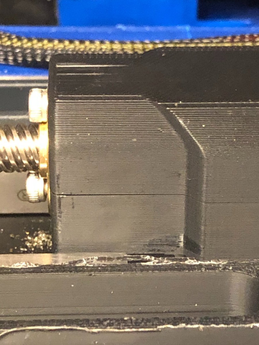

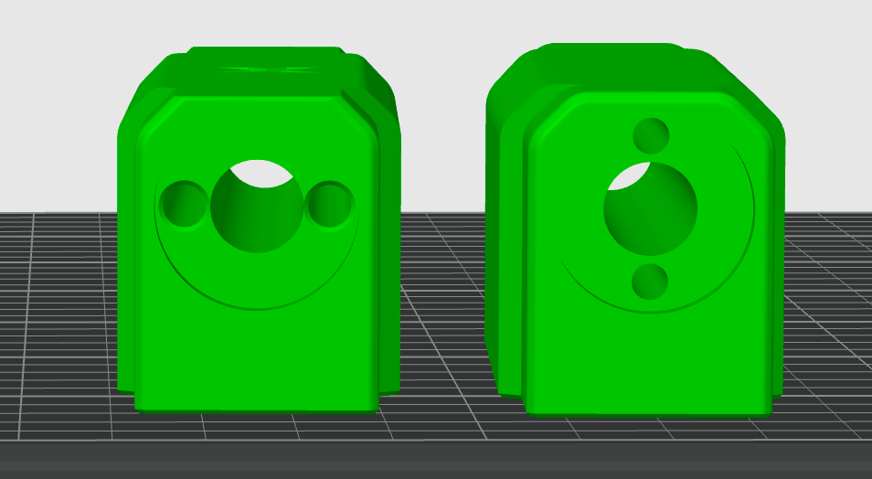

Glad I took it apart, the X anti-backlash block had a crack in it.

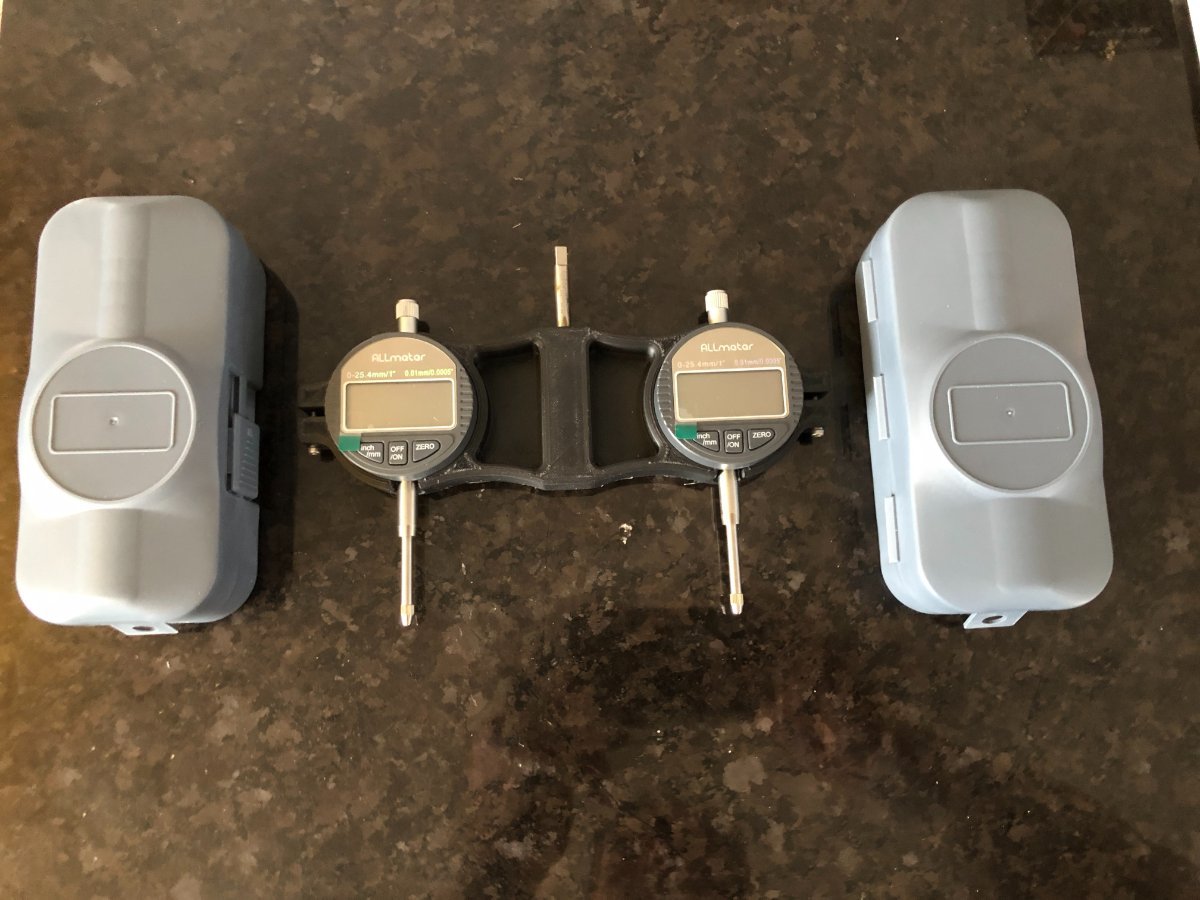

I'd printed the LDO X Anti-Backlash Nut. When they added more material, they moved the M3 heat insert hole from top and bottom to side to side and re-tweaked the hole size, which prevents the heat insert from bulging the plastic into the hole where the TR8 nut goes. Turned out the Y anti-backlash nut was cracked as well.
X Axis Anti Backlash Nut x1_LDO.stl Y Axis Anti Backlash Nut x1_LDO.stl
