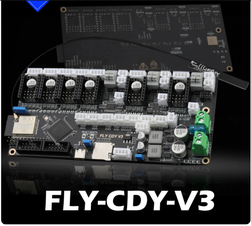

This is going to be a slow build, I'm self-sourcing the parts and will assemble them as parts are purchased and arrive. Years ago I purchased some parts to build a CNC machine but never completed the build. The frame and spindle were the last items to be purchased and built. Since then electronics for CNC have come a long way specifically the stepper drivers and motherboards. I already have the Nema 23 stepper motor but are larger than the suggested spec for the build. I'll be testing them with theĀ Mellow 32bit FLY-CDY V3 Wifi Control Board when it arrives.

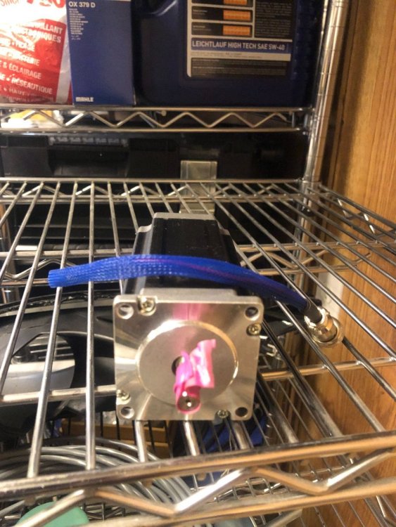

These are the steppers I'll be testing:

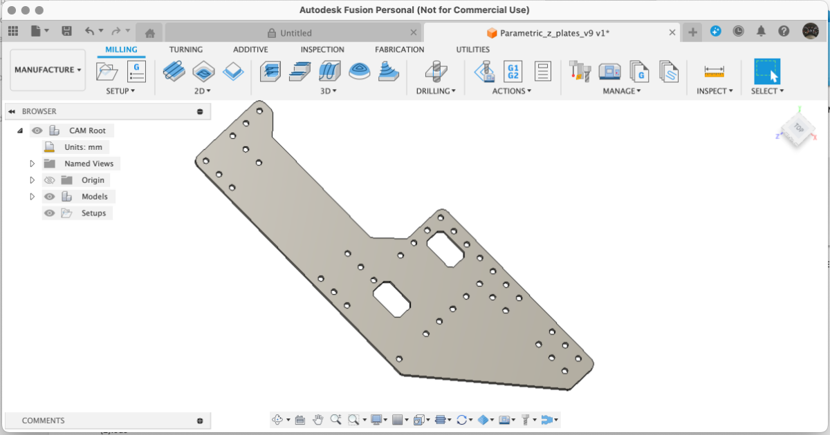

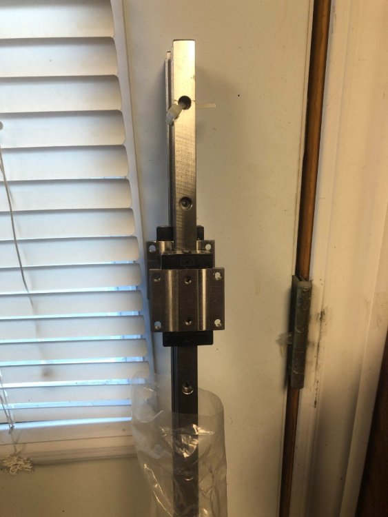

I have these Hiwin HGR 15 linear rails which I can cut to length, the blocks don't match the printed parts, but I can either modify the printed parts or order new blocks. The blocks alone will cost the same as purchasing a complete set of rails. The advantage of using Hiwin rails is the pre-load. Appreciate the lesson on the basic use of Fusion 360 that @Penatr8torĀ was kind enough to give me on Zoom.

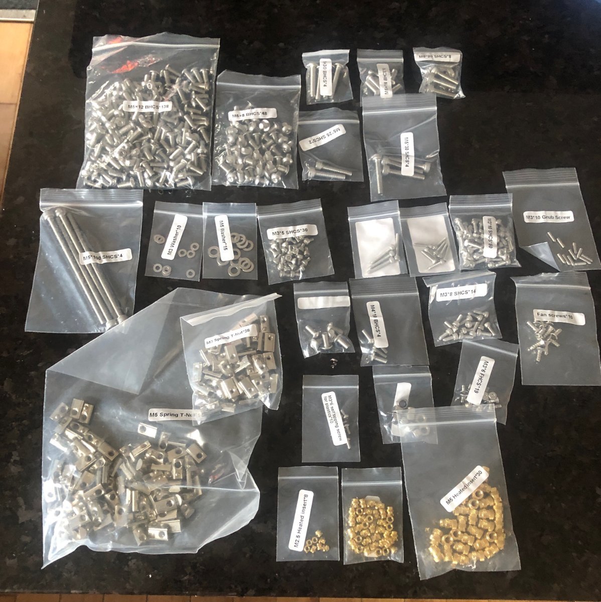

Parts ordered:
  • Mellow Fly-CDY-V3
  • Complete Fastener Kit
  • 2 x 4010 24V. Fans

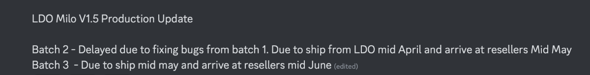

Have a birthday coming up in May - could not help myself - bought an early birthday present. But no stock in Oz until end of April - so not an early birthday present - pre-ordered, LDO shipping to suppliers end of March, expected in Oz 2-4 weeks later. Thus @PFarm - Lead the way, I will follow with GREAT interest

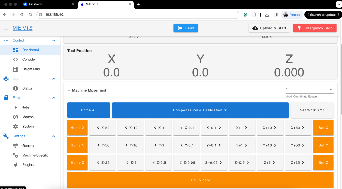

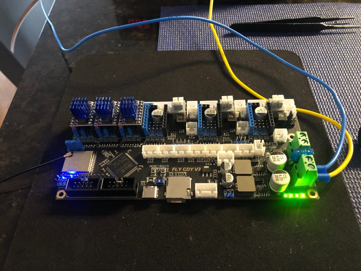

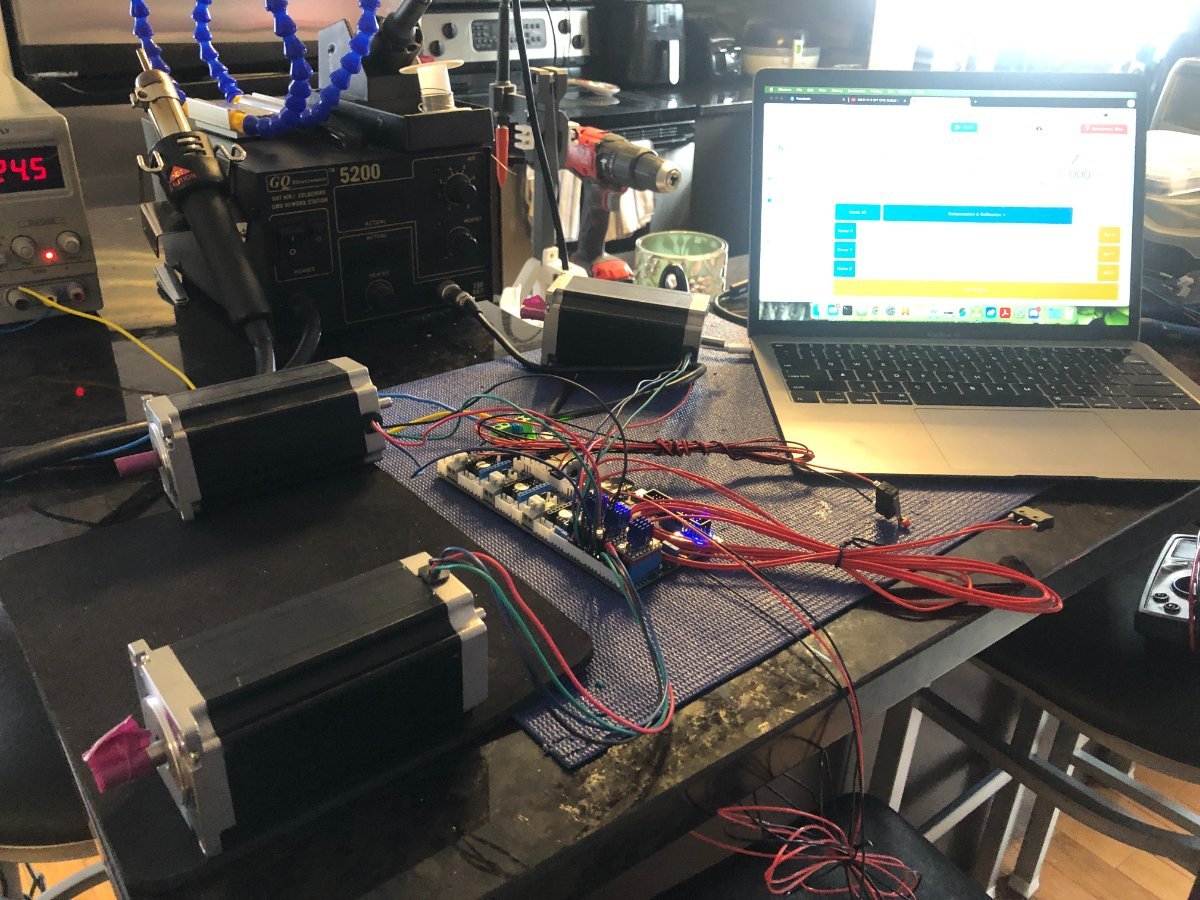

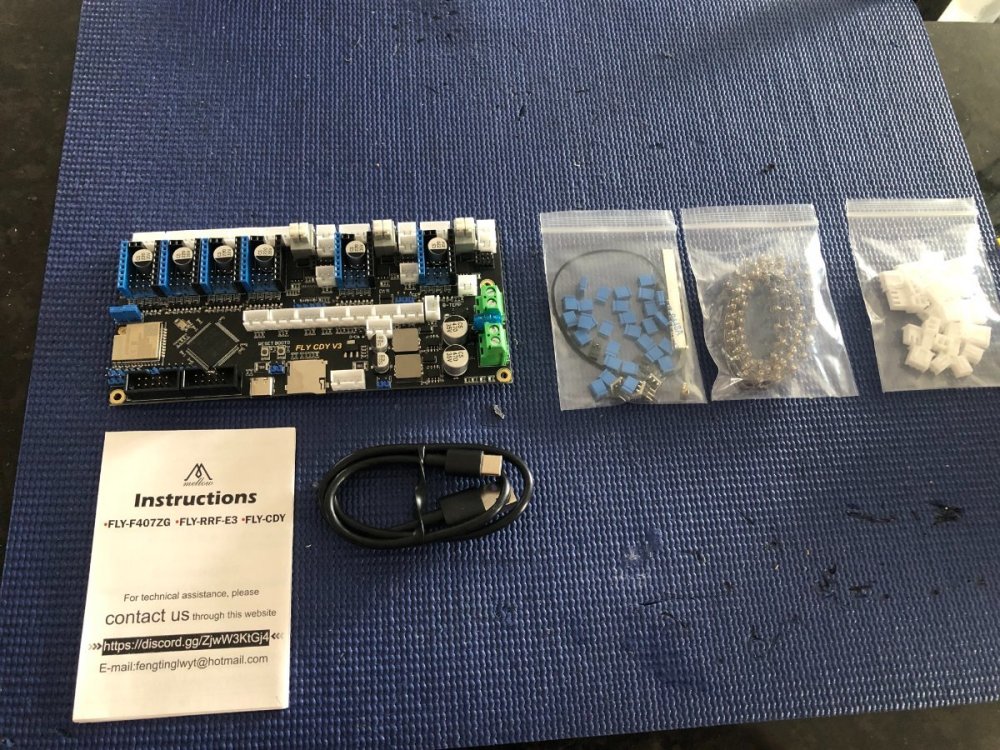

The Mellow FLY CDY V3 board came in today.
Got it flashed and connect to my network
Web interface comes up. Next I'll connect some microswitches in the end stops and see if the board will run these bigger steppers I already have.
Edited by PFarm

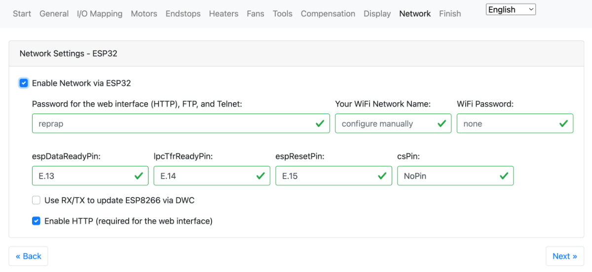

Just a note: the Electronics manual has you enable your wifi via "Putty", USB cable and command lines. In the online config tool there's a section to input your wifi network info. Much easier to set up and it connects right away to your network. All the files you need to setup this board are in the Config Example folder.
Edited by PFarm
Got three end-stop switches wired up, had to cut the diag pin on the BTT TMC2209 to disable the sensorless homing, and connected all three Act MotorĀ 23hs2430b steppers (425oz dual shaft) , they work fine with these 2209 driversšŸ‘

They've updated the RRF Config it now generates an Access Point which makes it easier to configure your Network connection plus added some additional systems files.Ā RRF Update. Still waiting for the Millennium OS release.

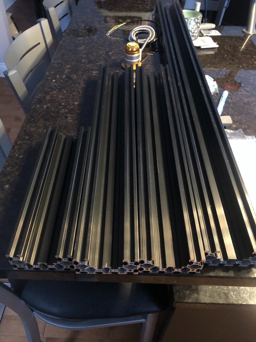

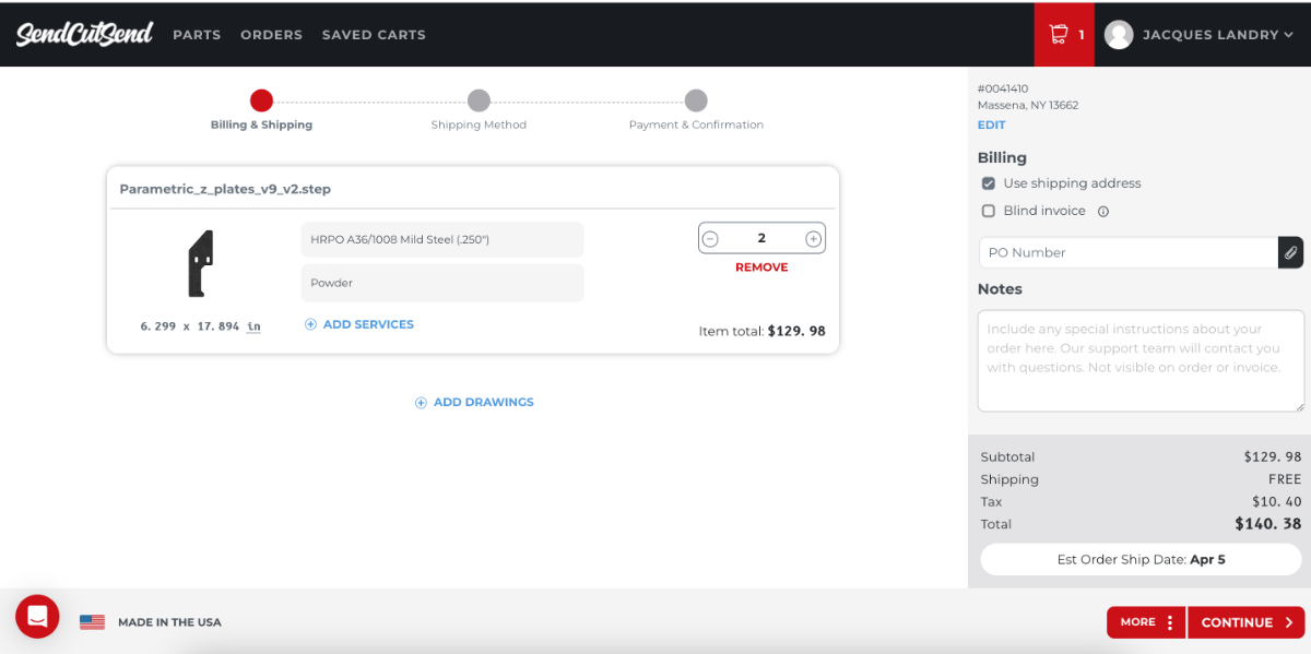

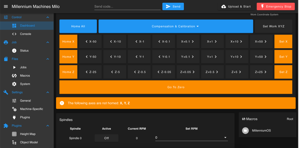

Millennium OS was released yesterdayĀ Link Here. Both the OS and RRF software were easy to install with good instructional documentation. The OS once installed boots up with a Configuration Wizard but since movement is required I'm going to run it once the machine is assembled and capable of moving. I've ordered all of the 4080 C channels, I'll need to cut the 2x320mm and theĀ  1x120mm from the 1000mm 4080 C channel. Next parts I'll order will be the Z and X/Y plates so I can begin partial assembly.
