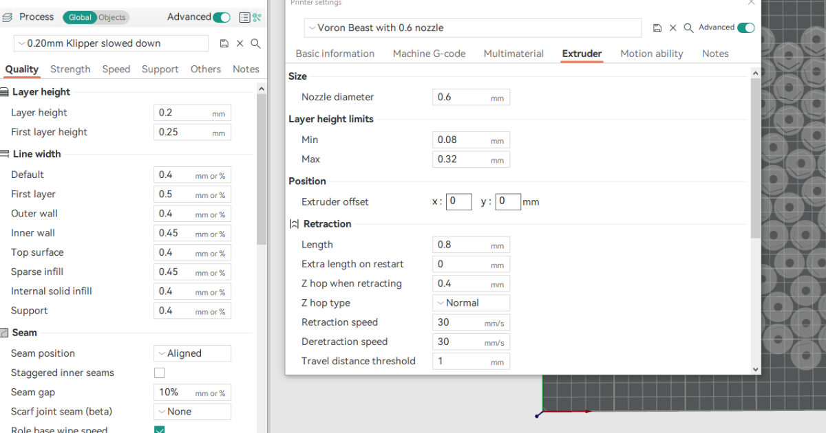

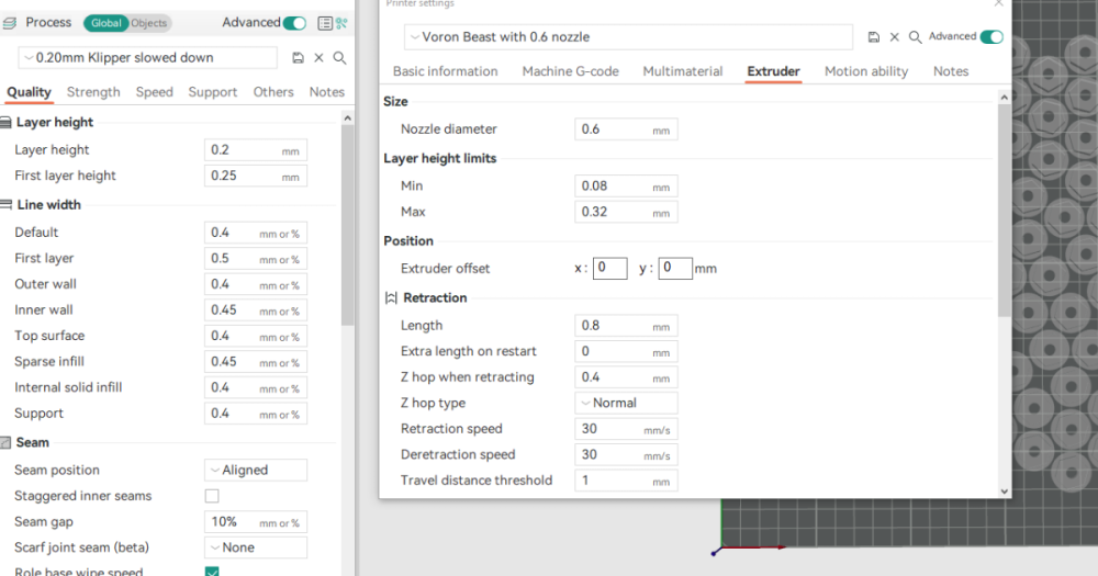

Thanks for that info @Penatr8tor.  When I change (add) a printer profile and under "extruder," I change the nozzle size, but nothing changes in the "Quality > Line Width > Default."  When I did this initially, I 100% expected that to change.
Attached is a screenshot of the two windows side-by-side.  In case anyone is wondering my "Klipper Slowed Down" is a profile with the accelerations tamed down.  But, as you can see, there is not a correlation between line width and nozzle diameter in my OrcaSlicer.

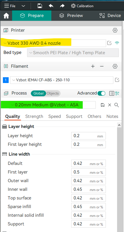

@7milesup That's because you need to change the "Printer" at the very top of the menu. If you look at the menu, starting from top to bottom, you have "Printer", then "Filament", then "Process". Changing the "Process" preset won't change your nozzle size... Changing the "Printer" preset will. 👍

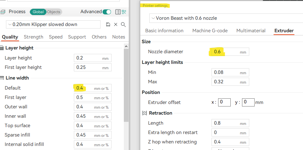

Isn't that what I am doing?  I will attach another screenshot.
At the "Printer," I am selecting my printer (Voron Beast with 0.6 nozzle in this case).  The "printer settings" dialog box comes up, and I change my nozzle to 0.6mm and hit the "save" button.  It says "save current machine" or something like that, so I hit "OK."   But there is no change under "Process" when I do that.  *scratching head*

You need to change both the printer (yellow) and also the process (green) to .6mm nozzle preset.

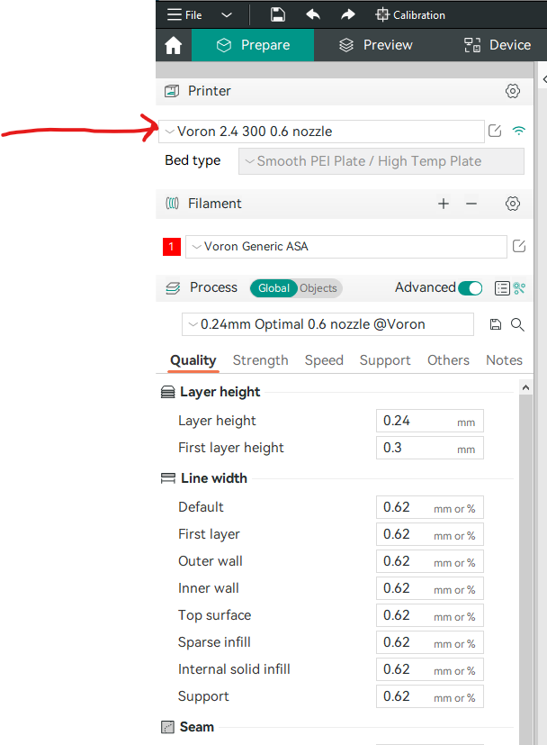

To be clear... You or anyone can name any of the presets .6mm nozzle whatever and save it with .4mm values because there is no AI or algorithm that calculates default line widths in Orca, you select a preset and it's either right or wrong depending on whatever the values were set to when it was saved... I suspect that this might be what you're encountering because obviously, there's no official Voron Beast and that means that it wasn't created by one of the Orca Slicer contributors.
Give this a try. Add a Voron 2.4 350 with a .6mm nozzle (I'm guessing this is what you Voron Beast might be) from the printer menu and take a look to see if your Line Width settings have changed.
At the very least you can take a screen grab of the numbers and plug them into your beast preset and save it and then when you change to that preset, it has the right values.

Okay, that makes more sense to me. I just did what you suggested by adding a Voron with a .8 nozzle width, and the settings did change. However, as you pointed out earlier, and I did not understand, changing the nozzle diameter in mine really doesn't do anything, i.e., there is no algorithm to make that change "globally" within OrcaSlicer.
I also did not realize (or forgot) that under "Printer" there is a "Create Printer," which makes those changes.
Obviously, I did not grasp how this works, so thank you for the clarification.  I had been using Cura and that program does make the global changes when you change nozzle sizes, so I was expecting the same here.

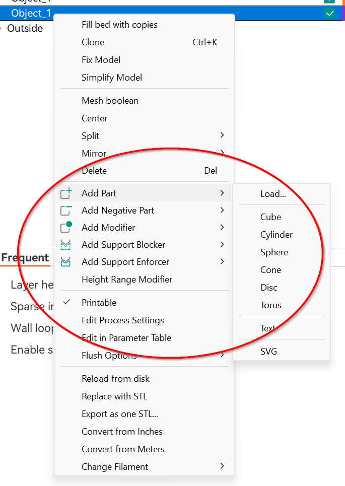

And never understod this part:
All of those additions, or just one? It's a situational thing with those. 99% of the time I ignore them, but that 1% I'm grateful they are there.
As examples: I had one print that was going to end up mostly solid which I didn't need, so adding a negative cube sized just so hollowed out the print and saved both time and material. In another case, I've got some models with specific difficult overhangs that the supports just weren't cutting it. So I added some carefully sized and positioned cubes to act as supports. One final case, I just needed specific sized rectangular plates, well adding a cube & sizing it to what I needed allowed skipping the entire CAD step.
So those are useful when you need them, but you can mostly ignore them.
