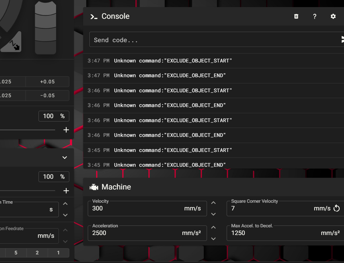

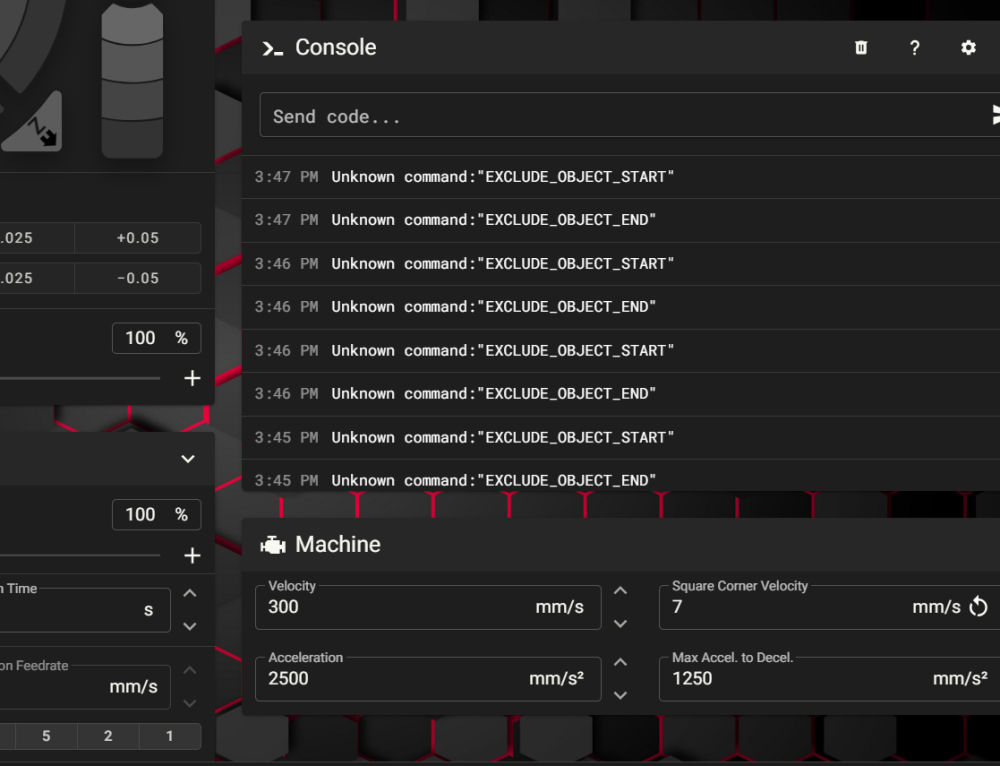

I'm trying to migrate from PrusaSlicer to OrcaSlicer and kinda stumbling through.

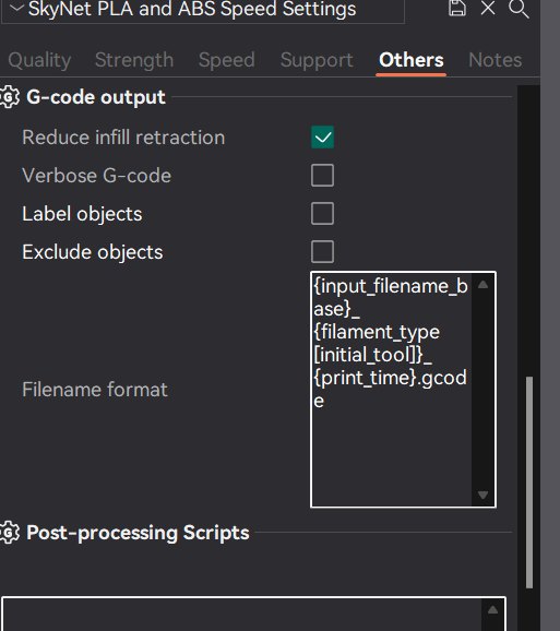

Anyone know how to get rid of this:
Edit to add:
Nevermind. I figured it out.  Just had to uncheck the "label objects" and "exclude objects" checkboxes.
Or if you want to use the feature, add
[exclude_object) into the printer.cfg file and alter the moonraker.conf as follows:
[file_manager]
# post processing for object cancel. Not recommended for low resource SBCs such as a Pi Zero. Default False
enable_object_processing: True
If you are going to use it, just remember to tick the "label objects" tick box in Orcaslicer again
It is a wonderful feature to have.
If an object fails, comes loose from the plate, you can exclude it from the print. Very handy if you have a full plate.

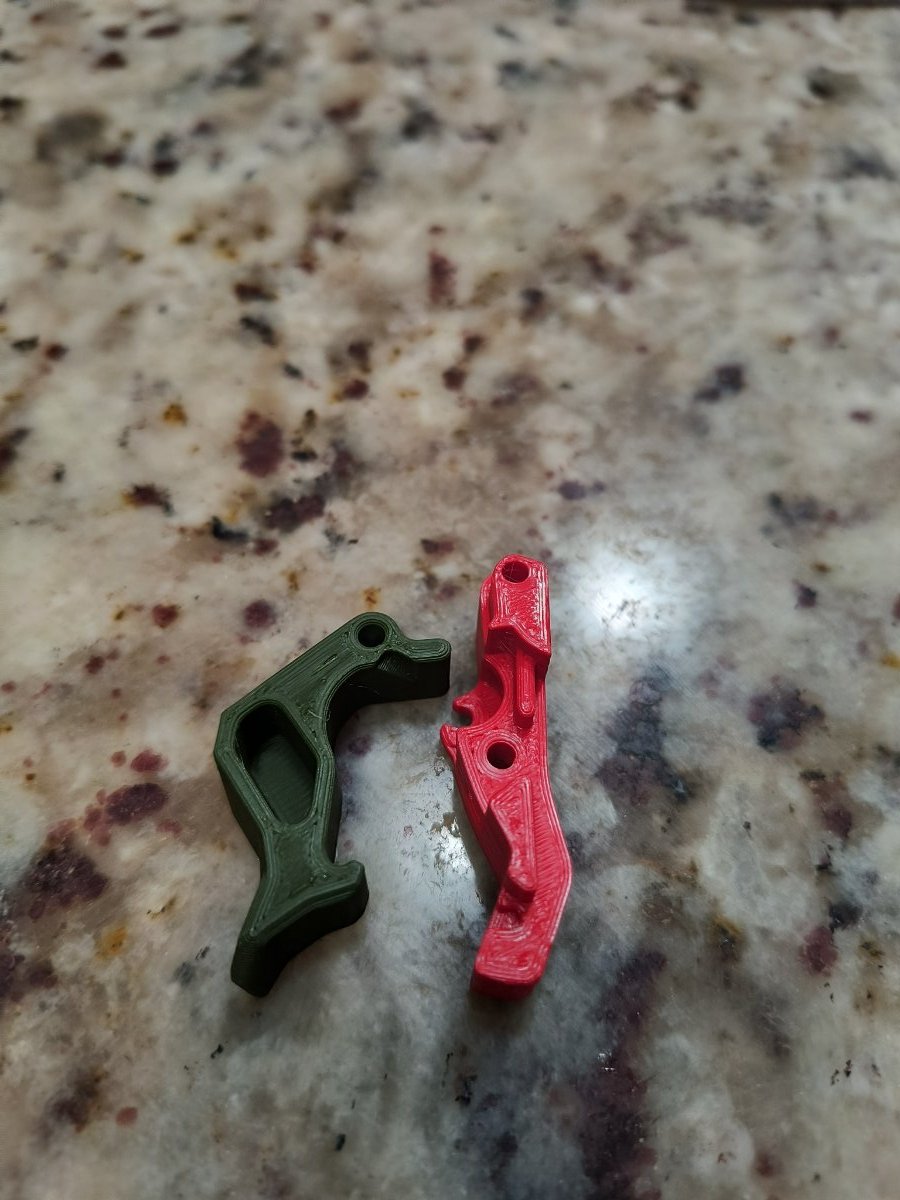

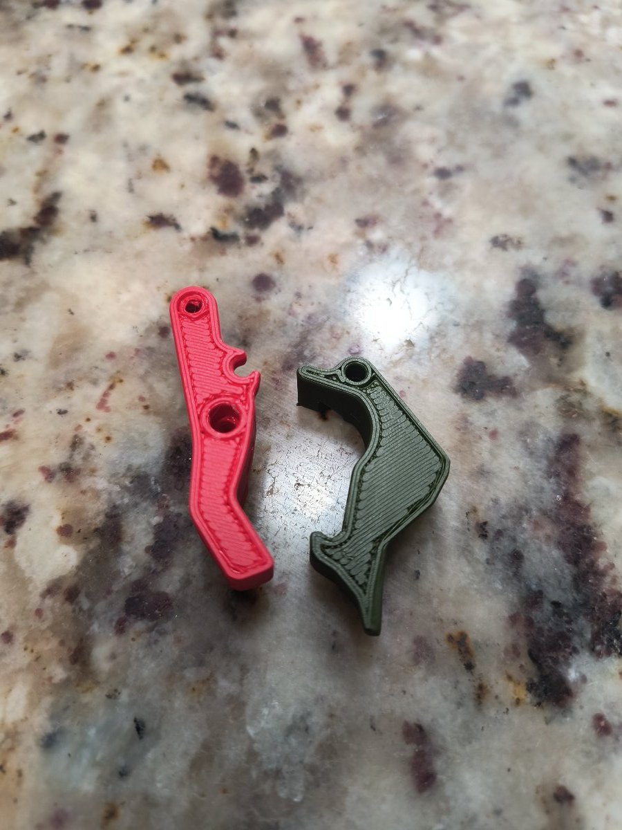

I've got Orca Slicer printing pretty well so far,  but I can't figure out which setting to adjust for this.
There is a gap between the 1st layer infill and the inner perimeter.   It's only on the first layer.   The second and all subsequent layers are fine.  The top looks good also.
Bottom, with gap:
And the top. No gap.
1 hour ago, claudermilk said:
Both the bottom and top layers look like it's underextruding to me. Have you done the Ellis tuning? Transferred the settings to Orca? Another thing to check is IMHO Orca has quite high speeds as default in its configs; I drop those to match my Superslicer tunings.
Yes.  I used the Ellis tuning guide to dial in my Klipper settings, ie rotation distance, pressure advance, etc.  I id all of its calibrations start to finish.
I also used each and every one of Orca Slicers built-in calibrations to dial in the slicer filament settings.
 I'm pretty confident in The flow rate,  because I did the he flow rate test (the one with the 9 square swatches),  the 0 swatch was pretty much perfect.
also, I copied all of my speed settings from PrusaSlicer.
Now that I'm thinking about it,   in those parts in the pics above, I had it set to print 3 perimeters.   But the bottom layer clearly only shows two.  It's missing the innermost perimeter?   The top has all 3 perimeters,so no gap.
that seems weird.
Edited by ken226
I think I might have it solved.  Another bonehead  oversight on my part.
I forgot to turn on skirts.   On such a small part,  I believe it's printing the inner perimeter first,  so with no skirt to prime he extruder,  it's probably just pushing air around the first perimeter.
I suspect that if the test part was bigger I'd have noticed, because there'd be a gap at the start of the inner perimeter rather than it being missing completely.
When I get home this afternoon I'll find the skirt settings and see if that fixes it.

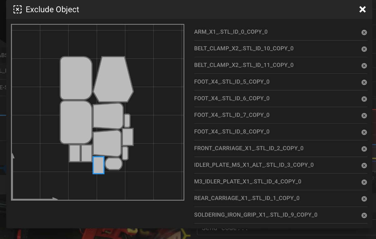

I didn't even know this existed,  but I just set it up and its working!  It isn't often that I need to stop printing one object from the plate and continue with the others, but it has happened a few times.  Thanks for the tip!
Also I did a test print with a single layer skirt added, as my purge/prime function.  It also worked.  No more gap between the infill and inner perimeter.
Thanks for the help!

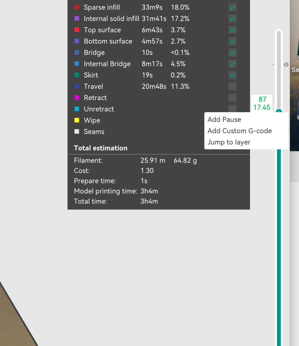

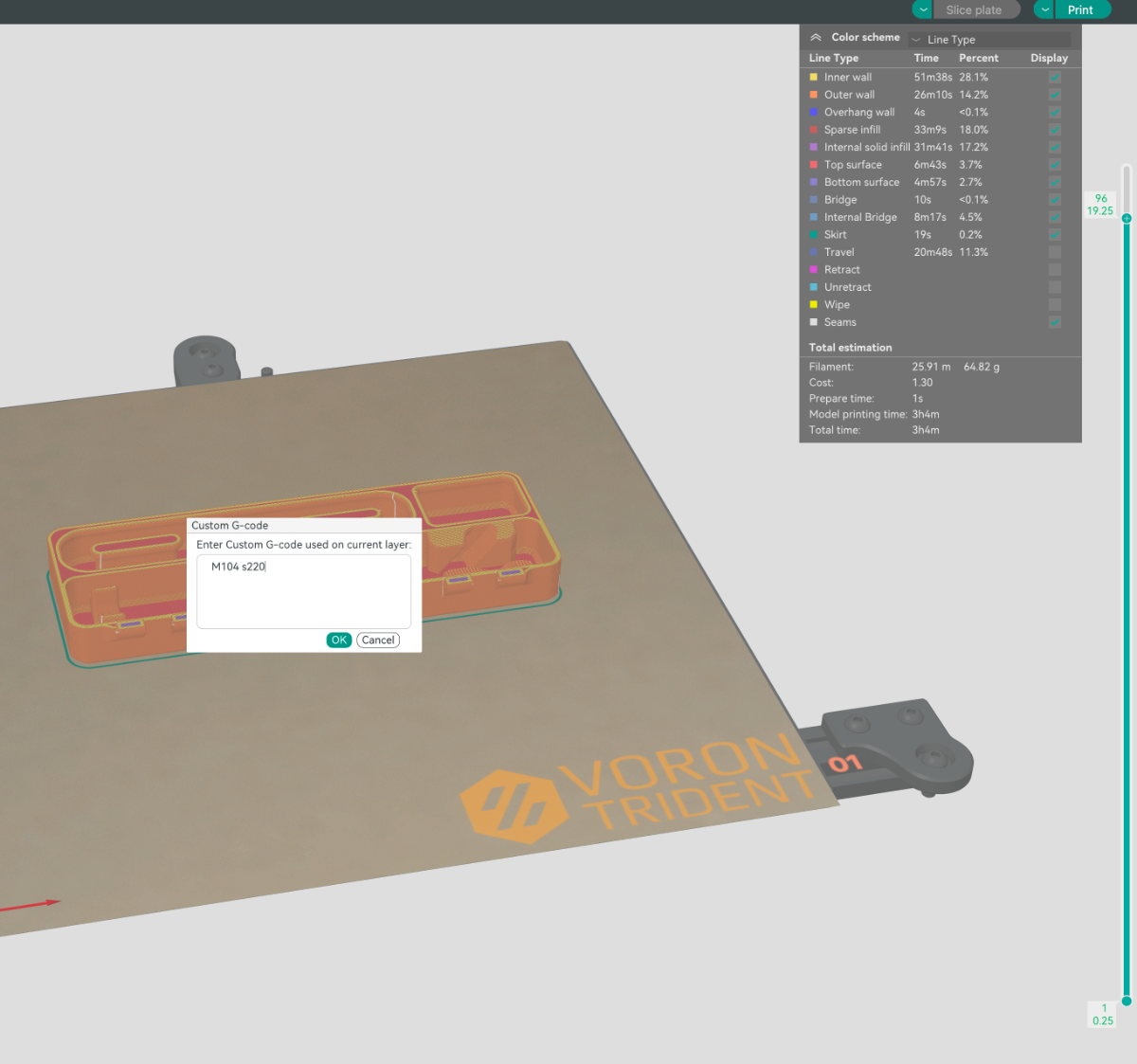

Anyone know how to have a different nozzle temperature when doing large top/bottom layers vs walls?
OrcaSlicer is my favorite slicer but with PLA the speeds get a little fast to print walls at the higher temperatures needed for the top/bottom layers.  I have a Voron 2.4 with Stealthburner and am thinking I might need a CPAP mod or something to print with PLA and not have to slow the stock settings way down.  Any insight would be greatly appreciated.  I have been reading and using this thread since day 1 of my Voron build and love the knowledge and help I have gained.
Don't know if it will work, but you can give it a try. Slice the object you want to print, then use the slider on the right to the point you want to change the temperature for the hotend.  Right click and enter custom gcode as an option.
and then enter m104 s220 as an example if you want to change the temp to 220
17 hours ago, claudermilk said:
I just slow down the default Orca speeds, they are set stupid fast by default. I don't know where the team came up with the default speeds. As Nero says: I'd rather have a slower successful print than a fast fail.
I’m starting to feel that too, but I love the game of pushing the limits and modifying the printer to get the desired outcome.  I’ll definitely try the gcode edit as mdvdeer suggested.  And post back
thanks
