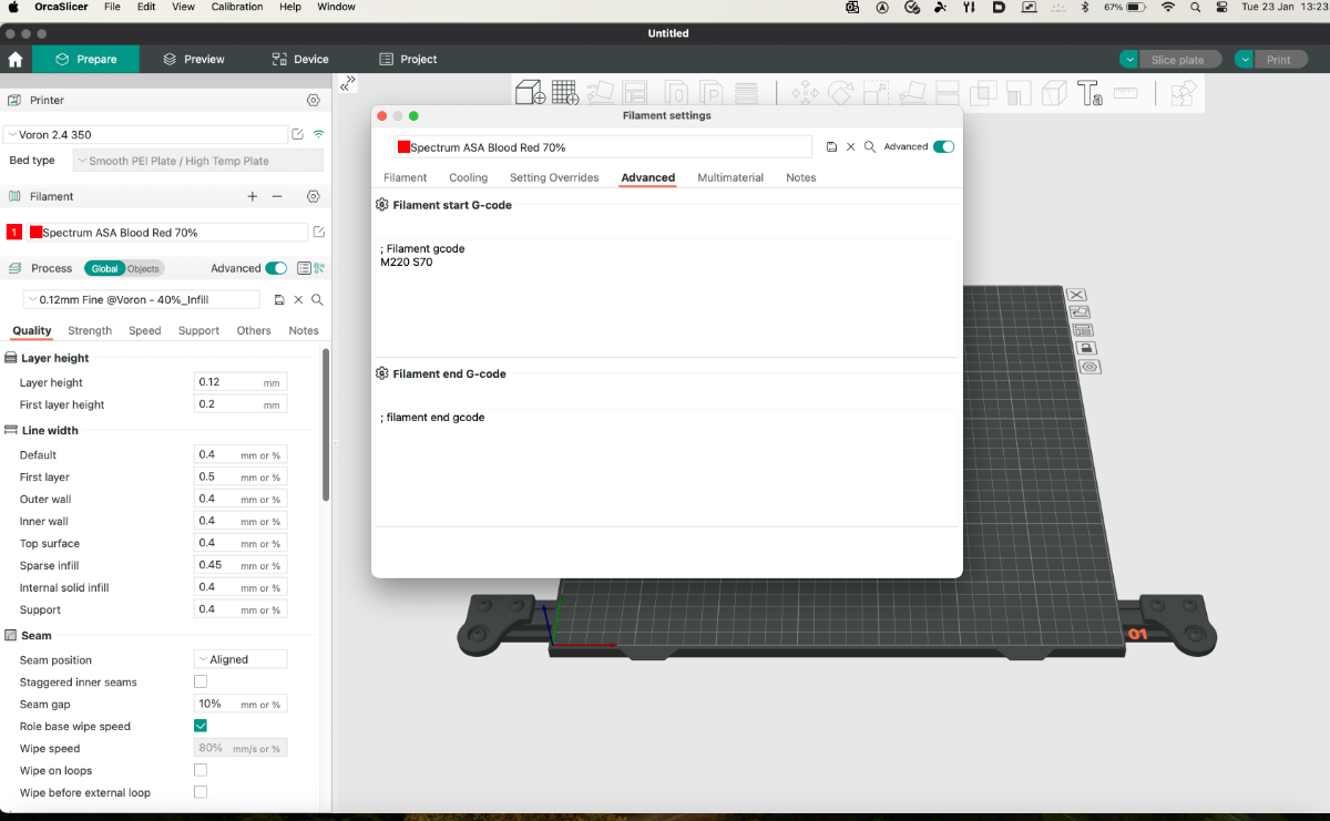

One thing I did for slowing default speeds is stick a M220 command in the filament start gcode. On my Trident, ABS doesn't like printing quite as fast as PLA, so I just slow everything down by a bit using M220 and it's happy. Same could work with TPU, just slow it down a LOT. No I mean REALLY A LOT. No, MORE. 😁
I really like SS as well got the support set up so they're removed easily and working out for me. Love the idea of the M220 gcode what percentage do you set it at?

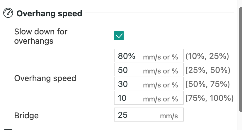

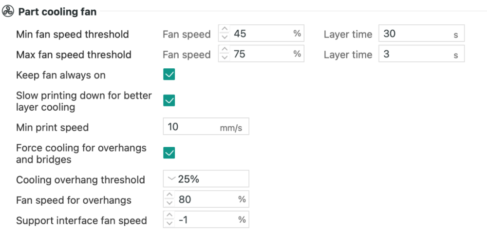

I got most of the settings dialled in bridging is good but having issues with overhangs. As suggestions?
Did you find a solution for this? I have the same exact problem, my SB is too weak to print good overhangs at those speeds, especially with PLA (ABS I just blasted more air at it and it is looking a bit better).
I am assuming that the M220 that is set in the print start macro?
I am testing out OrcaSlicer (vs. Cura) and am having a heck of a time with my prints.  It might be my printer, the slicer, or, or...
No, it is set in the filament Gcode as in the example below:

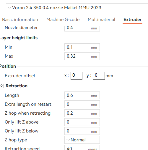

Also, I noticed the last version sets your Z-hop type to AUTOMATIC.
After that I gotten lots of G3 G17 errors during printing.
I changed it back to NORMAL and then those errors are gone.
It has to do with ARC stuff, but you dont need it with Klipper, it solves it in another way.
You can enable it in Klipper, but ... I think its not the best solution.

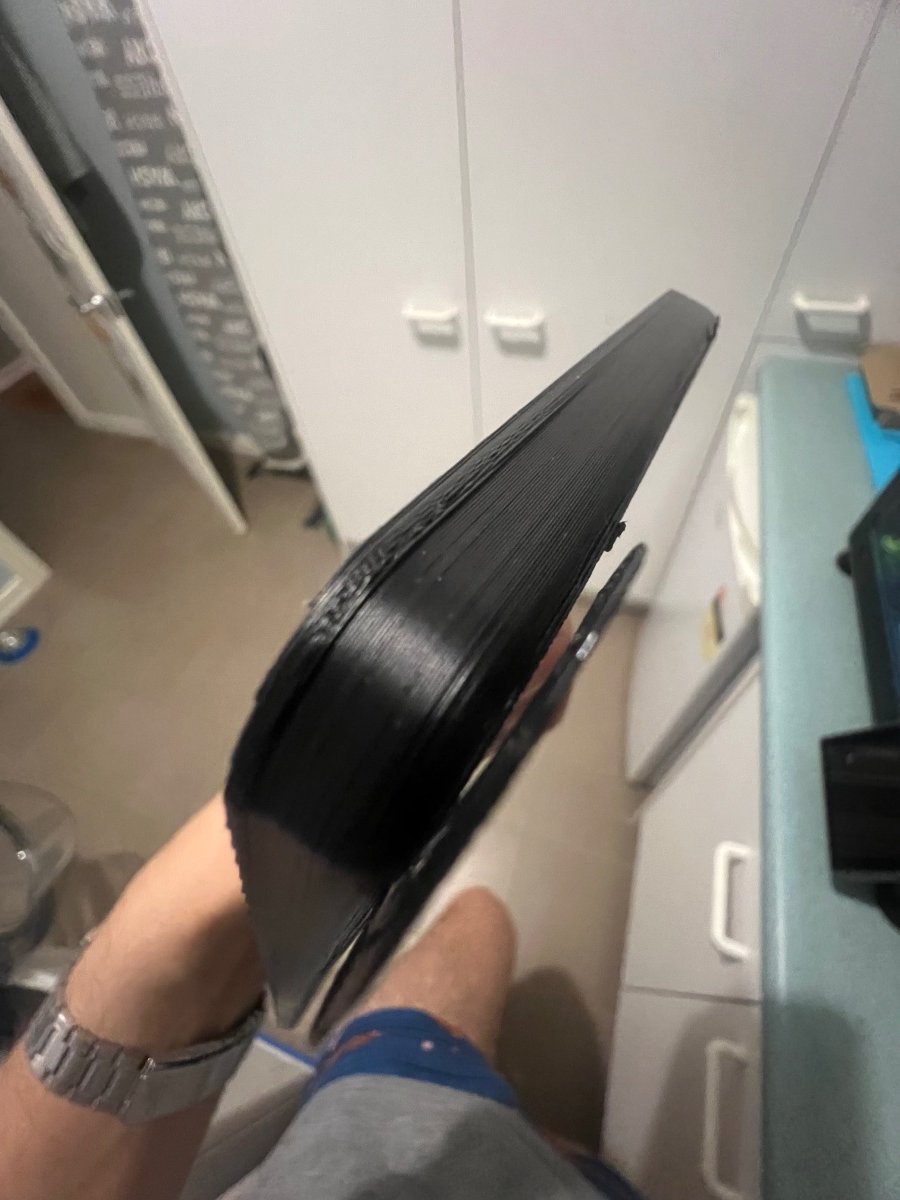

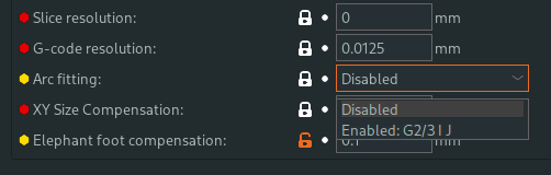

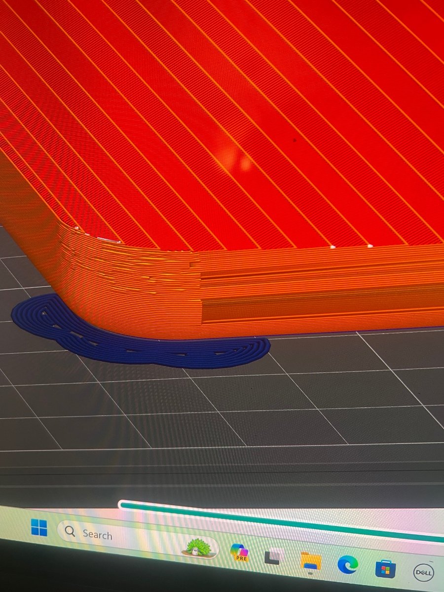

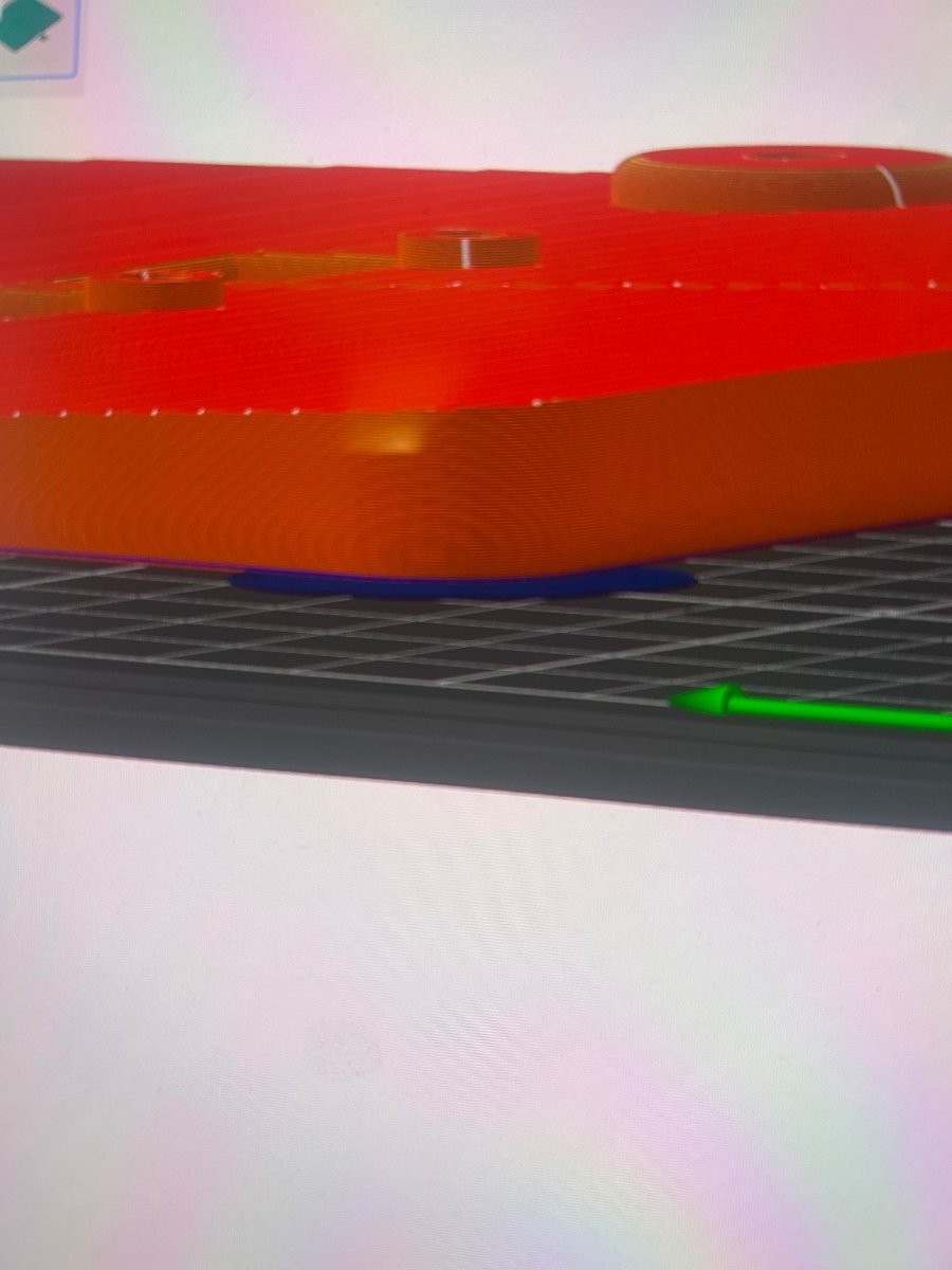

Hi everyone, I’ve recently enjoyed using orca over creality print for my K1 max however in the slicer my layers look really weird as soon as I change the z offset from 0 to -0.05 shown in the photos below. I don’t know if it’s a coincidence but I’m now getting some layer deformation in my prints, any idea why orca is doing this when I change the z offset and what’s causing my print to look the way it is (photo 3). Thanks in advance :))IMG_5182.thumb.jpeg.6d3838524d952f4f60978514ef9502b7.jpegIMG_5181.thumb.jpeg.c2954ca826a5fa58c440e0af96dd0450.jpegIMG_5183.thumb.jpeg.dbf7863a8adcd3b7f54c6d3da099ce02.jpeg
Do you have "arc fitting:" enabled? it uses G2 and G3 codes to define an arc about a center point but maybe it is not able to fit the curve well enough.
It almost looks like the 'random seam' setting is having a fit. And I don't know how a z-offset setting could be causing such an issue. Troubleshooting can be such fun..

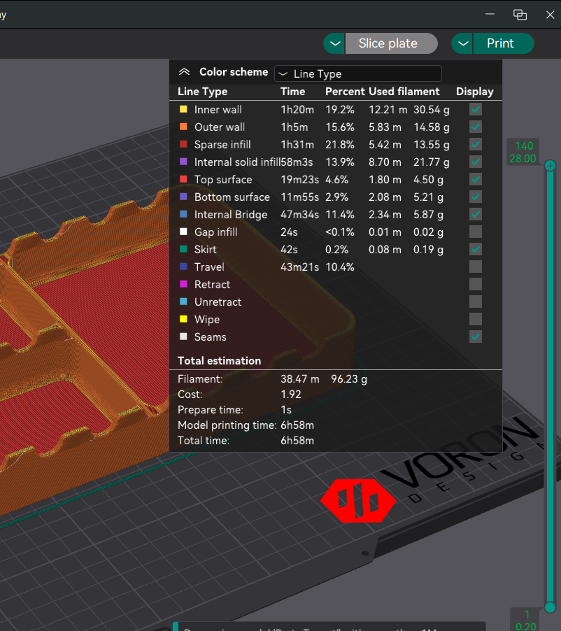

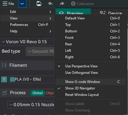

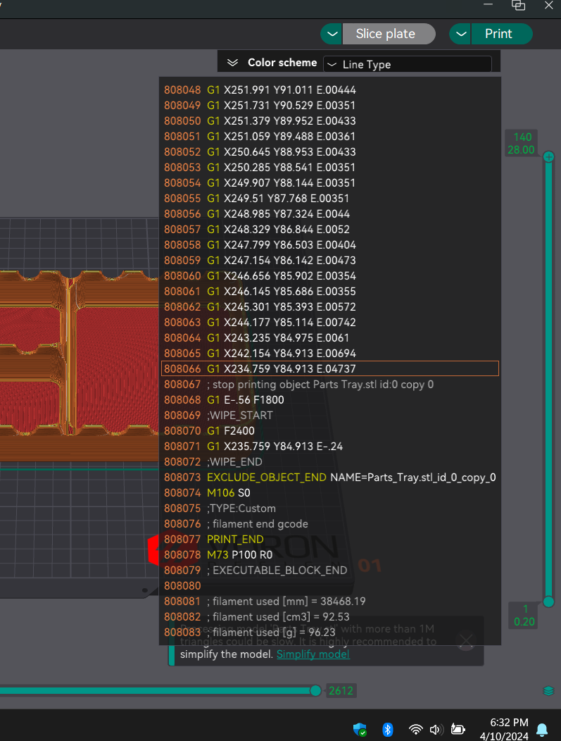

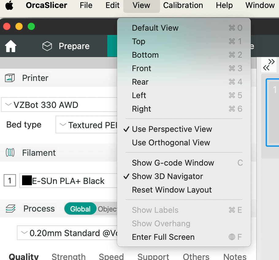

The newest release of OrcaSlicer is driving me nuts.    This big wall of text is obscuring the view, and I can't figure out how to turn it off.
Anyone know?
Also, same question with this:
It also pops up after slicing.    I can minimize it, but i can't figure out how to get it to persistently stay OFF.
Edited by ken226
Under view - untick show G-Code window - turns it off
There is no way of preventing this from appearing as far as I know
