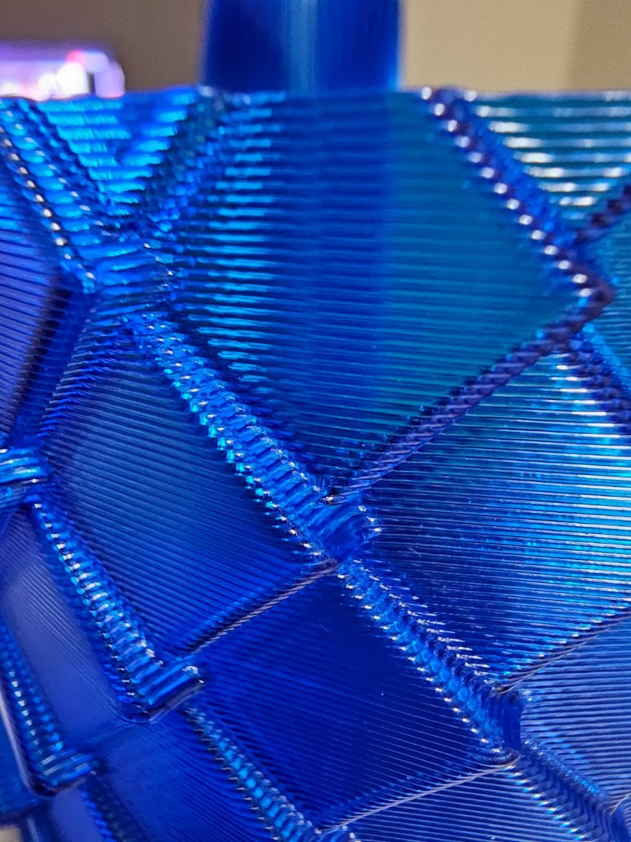

I've been farting around with PETG lately and bought an assortment of cheap nozzles off Amazon with various orifice sizes. I only needed to print a couple test cubes to get the material dialed in and went one step further and installed a 1mm nozzle. I can push as much as 30 mm3/s thru it but found that limiting the flow to 20 creates beautiful results.  Transparency is pretty impressive.

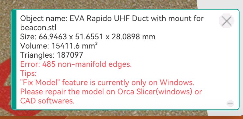

Orcaslicer has now become my default slicer. The only issue I have is the OSX (Mac-Version) does not have the stl repair algorithm built in. Need to use the windows version for this. (I have windows running in a virtual environment on OSX for times like this)
I saw the repair option on the drop-down but didn’t really know what it is actually doing.  I didn’t get any errors so I figured I didn’t need it.  The default settings are starting to grow on me.  Cool seeing the machine really getting a workout.  Might have to check belt tension more often and be sure they are dialed.
At times you may get an error when slicing a downloaded model, e.g
which then needs to be repaired. Superslicer Mac and Orcaslicer Windows does this automatically.

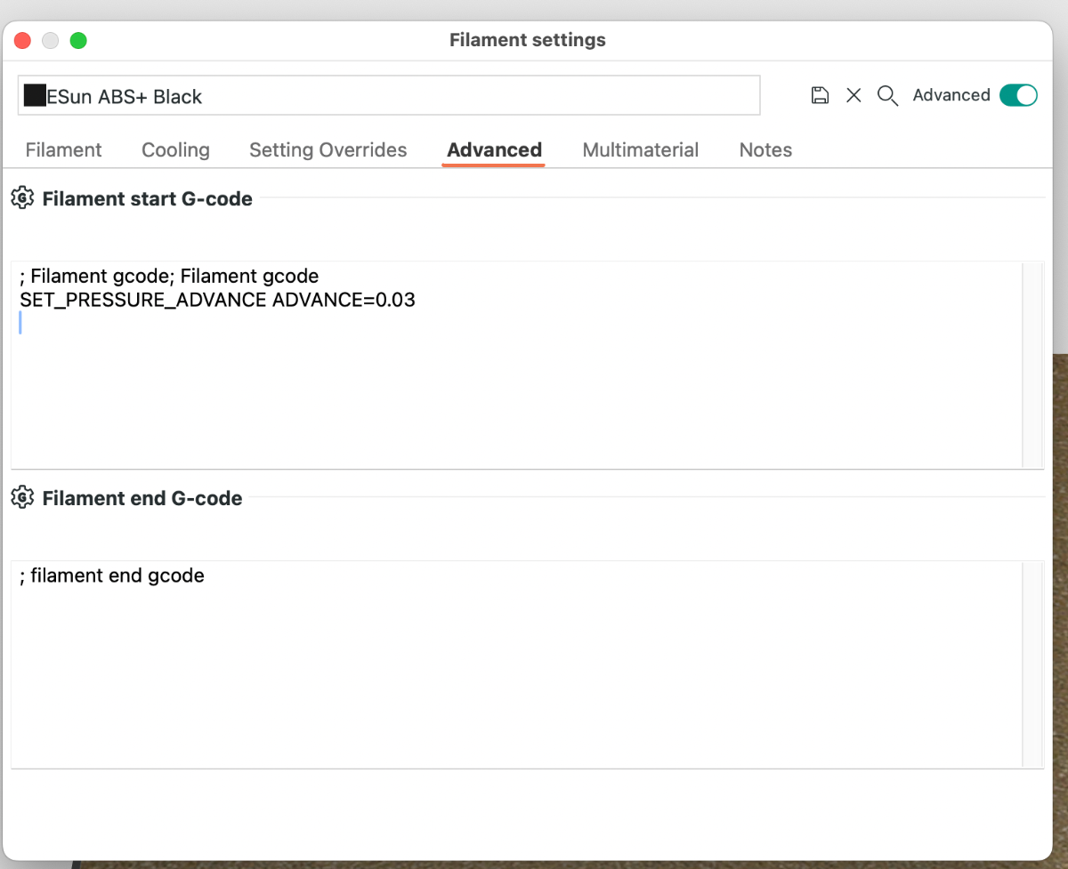

What function is the Material section performing in your Start Macro?  Is it passing specific PA in your.cfg?
It can be used to call other functions in the macro such as heat soak for example when printing abs but ignore it when printing PLA.
The PA can be individually set in each filament's gcode space:
Filament PA

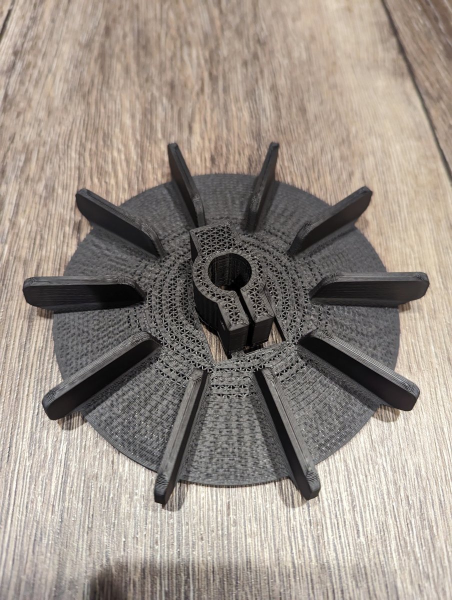

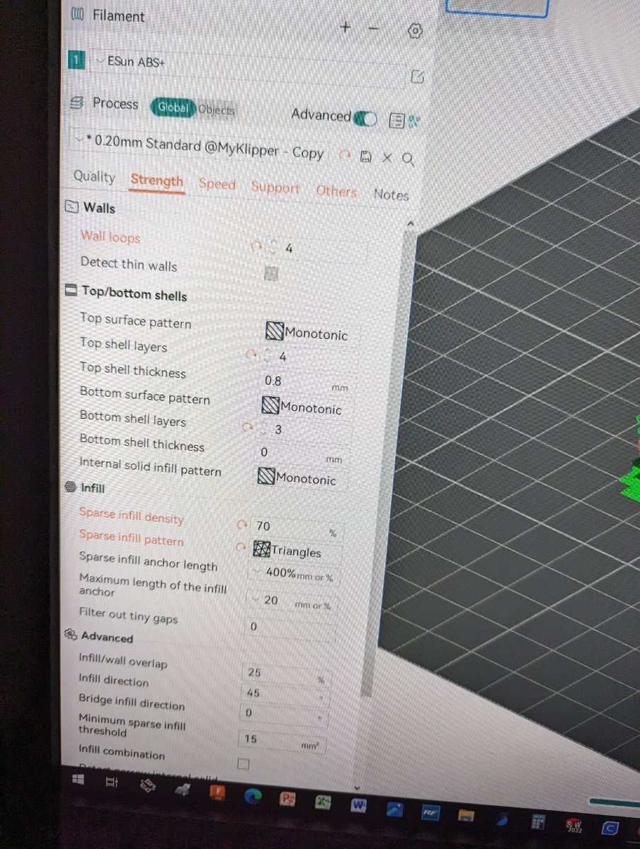

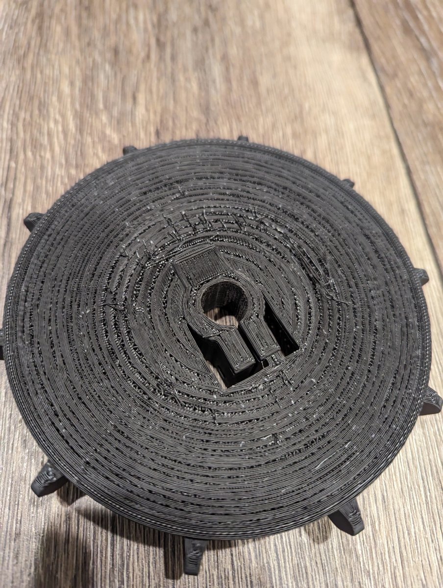

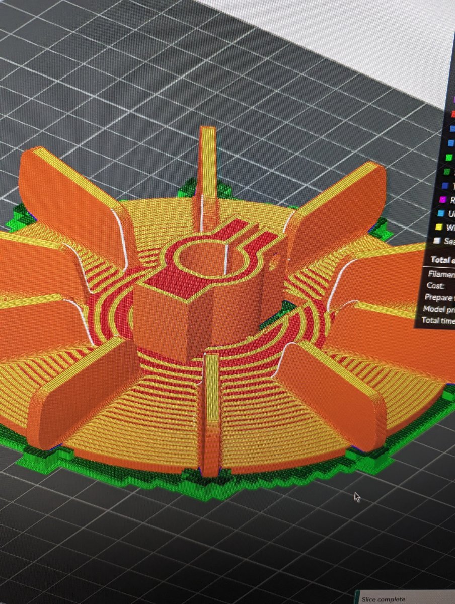

I just printed a cooling fan for an electric motor in my metalworking shop.  It did not print correctly, and in fact, it did not slice correctly.  The top and bottom layers are not complete, meaning you can actually see light through it in areas.  I have top and bottom shell layers changed to what I thought would force it to complete. Attached are some pictures...
Any ideas?
