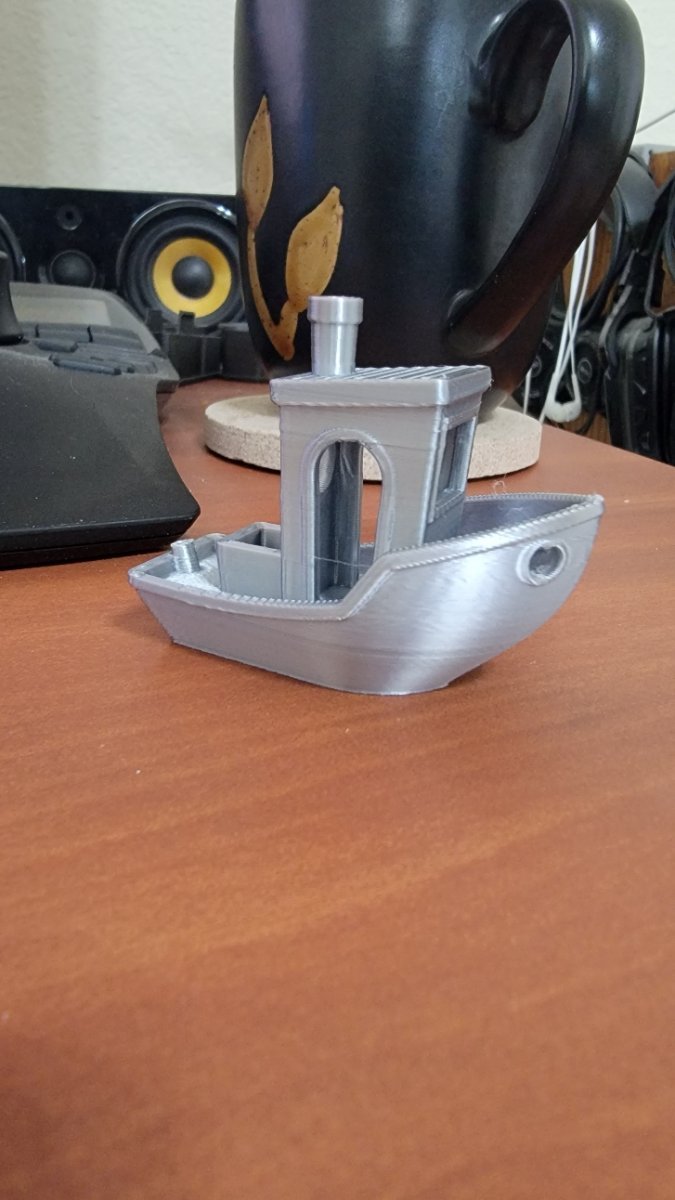

Rather than hijacking an existing threat, I thought I may start a separate topic. My interest was peaked at the discussion around this slicer, so downloaded and installed and sliced a benchy - standard Klipper 0.4 nozzle profile - no changes, no tweaking. Pleasantly surprised with the results.
I felt that the stock profiles push the printer a lot harder than what you usually find.
This was a 30 minute Benchy, Stock profile, all I did was slow down the 1st layer to 30mm/s. PLA = Ziro Silver Silk.

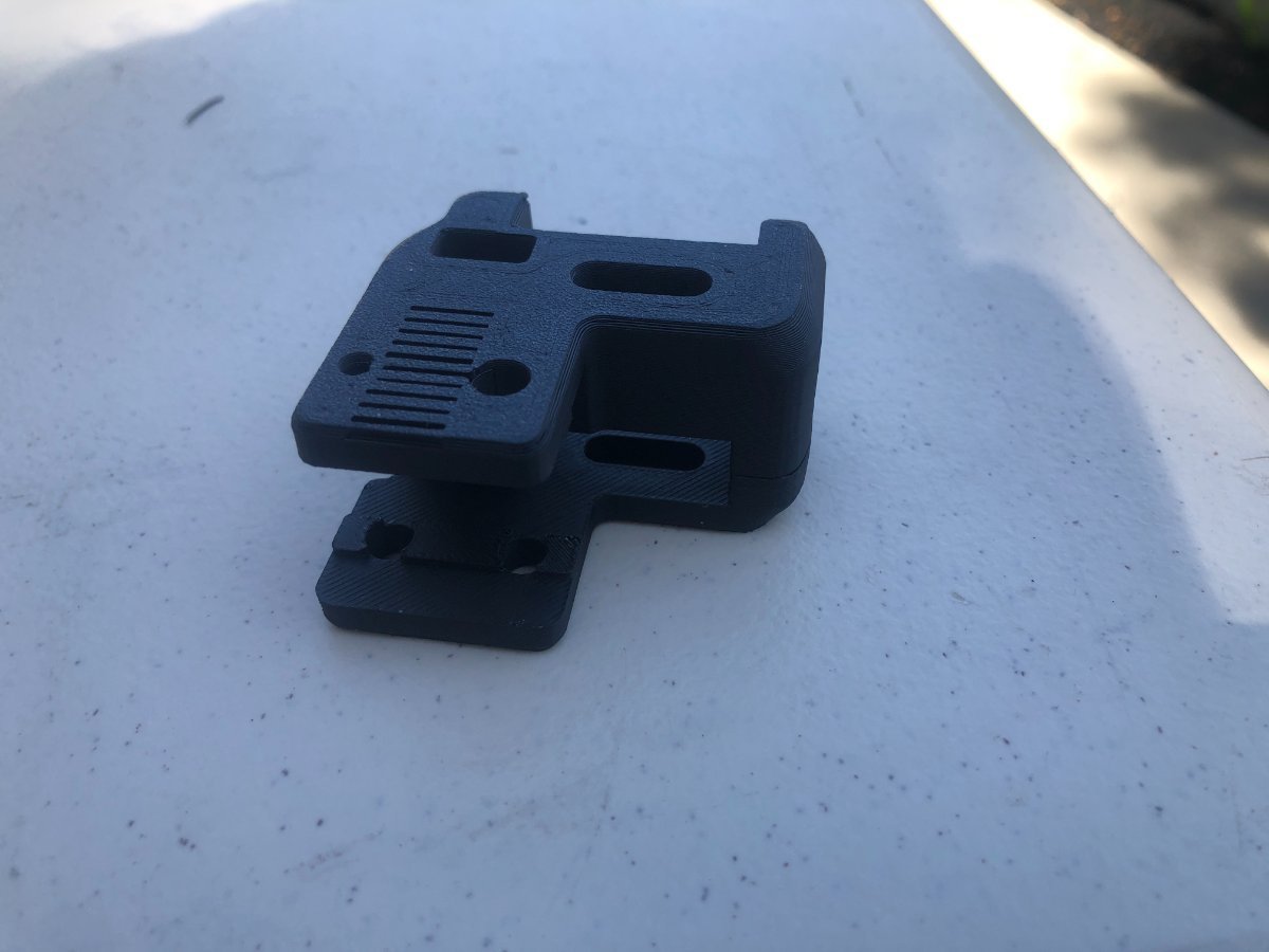

I did the same thing and tweaked a few settings but it knock off quite a bit of time off the print. I set the seam at the rear but was not to impressed, the seam is quite obvious. But the rest of the print looks pretty good. Testing some more 2.4 printer parts.

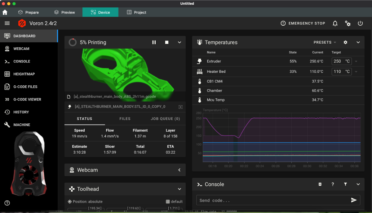

Ok, so I got hooked in as well.  There is one thing that I really like.  The device tab actually shows me my printer.  Its all there, my mainsail interface inside the slicer.  Now, that is nifty. Slicing a part now to see how it prints.

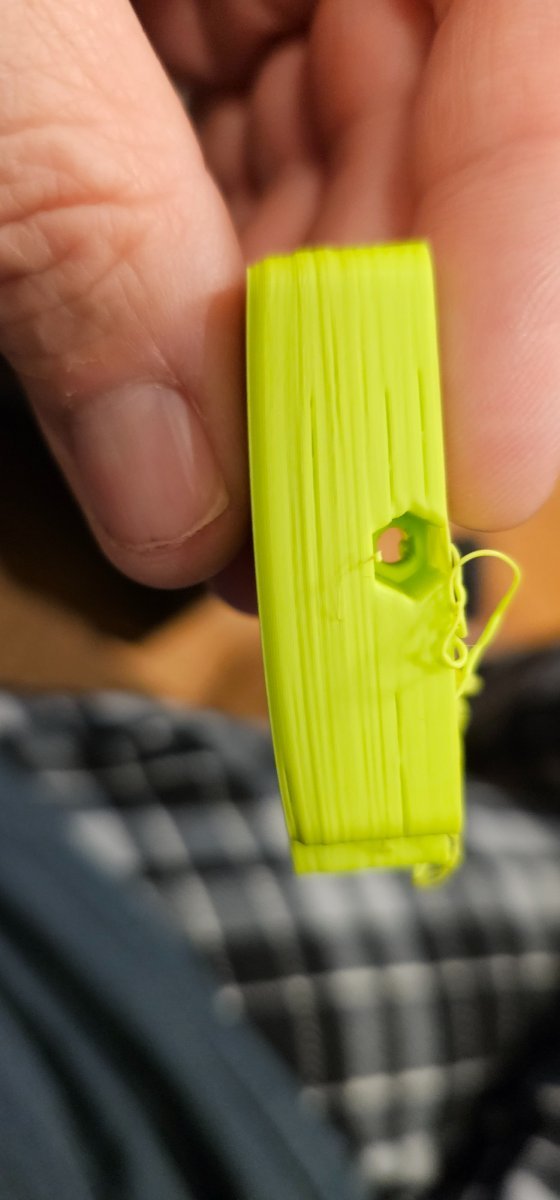

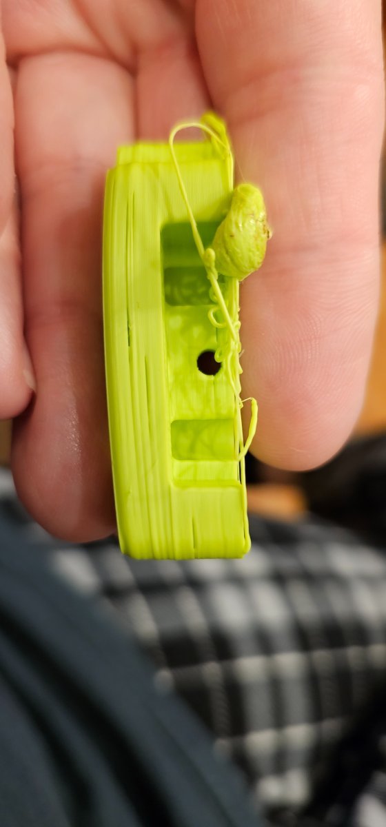

Well, This didn't go well. Seems to be far faster than my current setup can handle.  All I did was change the basic setting to match the walls and top and bottom layers. It got to about 70% and it released from the build plate.
May need to tune some of the other settings.

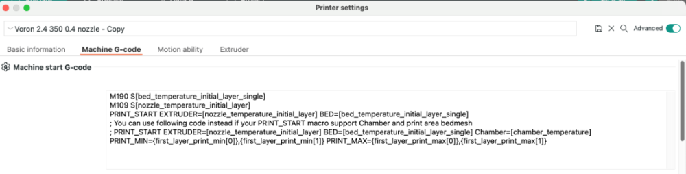

Prints are coming out nice and being that time is knocked off the print time I'd like to continue testing this slicer. But for the life of me, I can't figure out the Print_Start sequence it heats to 250 then back to 150 for mesh then back up to 250. I had it figured out for Superslicer but can't remember how I did it. In my Superslicer setup it heat the bed to 110 when bed temp is reached does adaptive mesh, heat extruder to 250 then line purge.

The slicer likes to assume and insert start temperatures unless you define something. You might need to add the following two lines to the 'Custom Start G-code' within Orca Slicer:
M104 S0 ; Stops PS/SS from sending temp waits separately
M140 S0
I went in and cut the speeds down to 1/2 of what they defaulted to and the print finished this time with only a few small issues.  Looks like my printer just can't run at the speeds it's starting with.  Just got as far as I can with building the Gantry for the next printer so I am back to testing this out.  I want this to work so bad due to the integration of the mainsail interface.  That is one feature that is very nice to have.

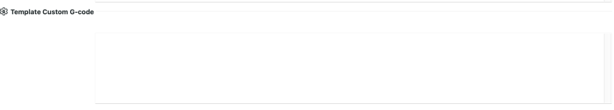

@atrushing
Insert here:
or here:
Edited by PFarm
1 hour ago, PFarm said:
Insert here:
The first one. You would need to comment out (or remove) the first two lines or modify them as my prior example.
Right now those two lines are instructing the gcode to set the bed to full temp, then set the nozzle to full temp. Then the third line properly calls your Print_Start while passing the required temperatures. The Print_Start then sets the nozzle back to 150C until the mesh is finished.
The M104/M140 S0 lines need to come before the Print_Start is called.

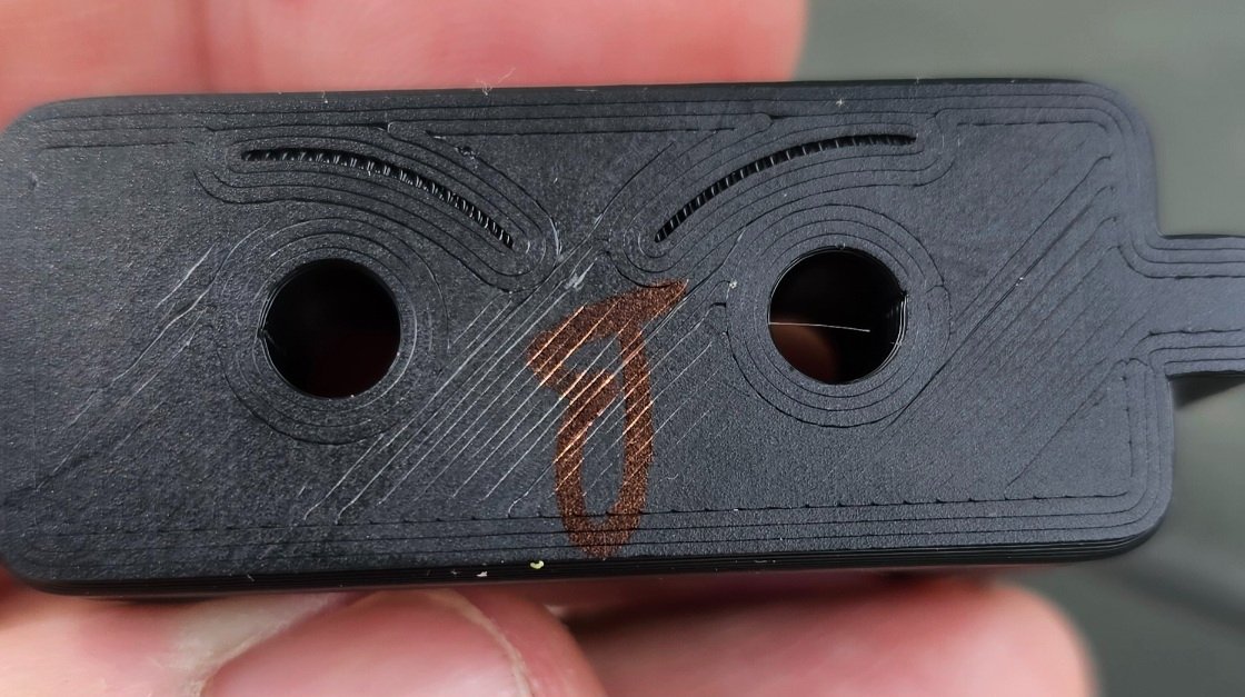

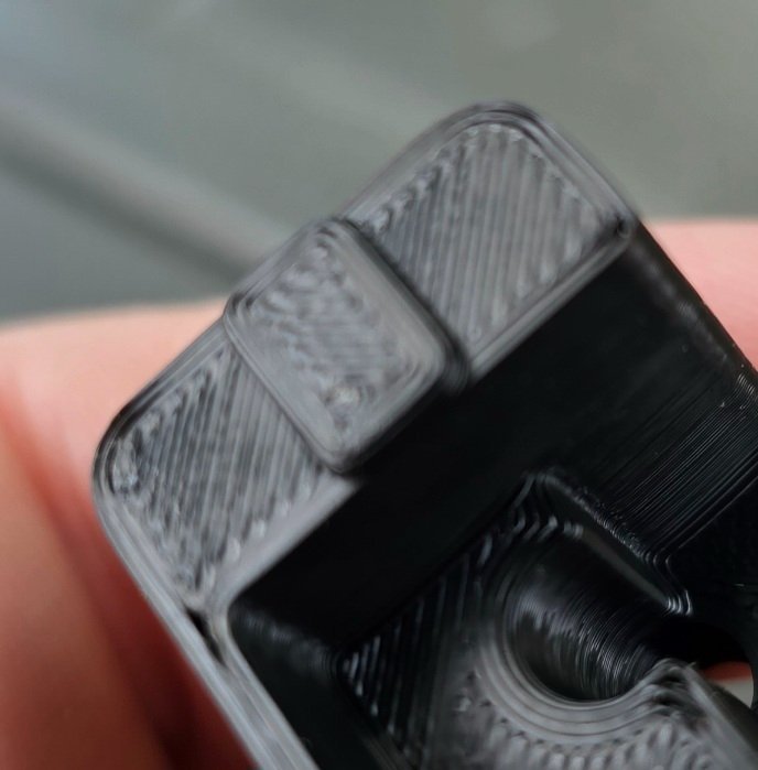

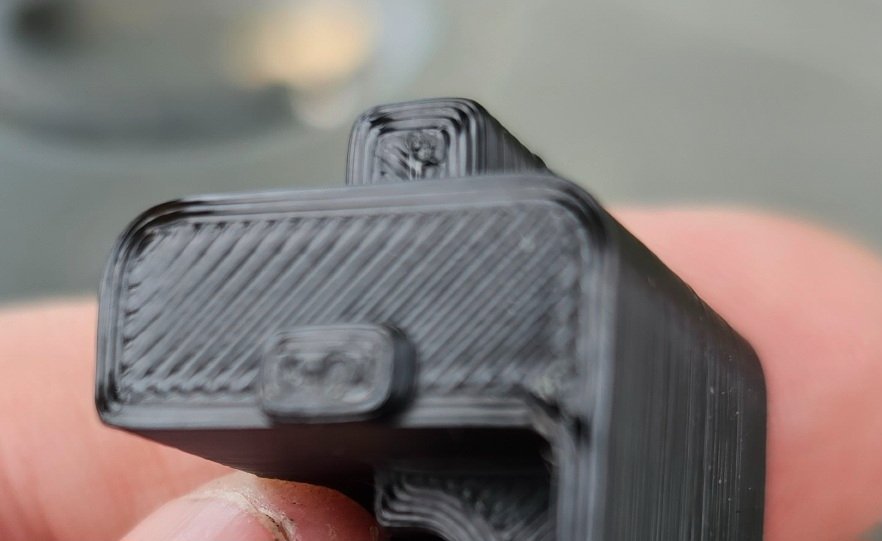

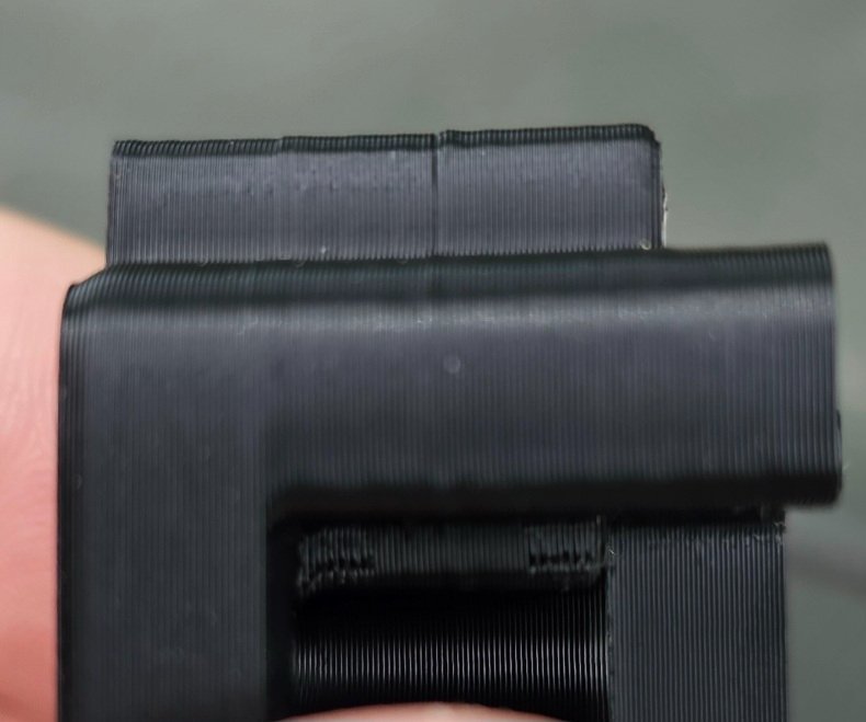

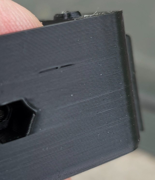

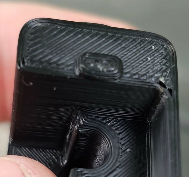

So went back and started a profile for the ABS I am using.  Sliced a single Z Idler in both PS and OS.
PS is 54m using my fast profile which was a balance between aesthetics and speed.  For OS it came out to 31m.
Here is what the OS print looked like.  Ignore the B, that's just to keep track of settings. This is as OS wanted to print it. Not sure what happened the first time but this one looks usable. Not sure what cased the layer gap. A few shifts that are marginal at best. Pretty sure this would last a long time.
Top layer is a bit proud and rough as well.

@Buurman First I like the feature that you can access Mainsail from within the software
Then there's the speed it's not crazy faster but it is noticeably faster when comparing the ETA with S.S. there is a difference. The only speed settings I change from default are the first and top layers set at 30mms. So far and don't see a print quality change. You can set up 36 different platers under one project like printing Voron parts, bringing up the plater slice and print. The interface is pretty easy to navigate, I think it is worth your while to give it a go.

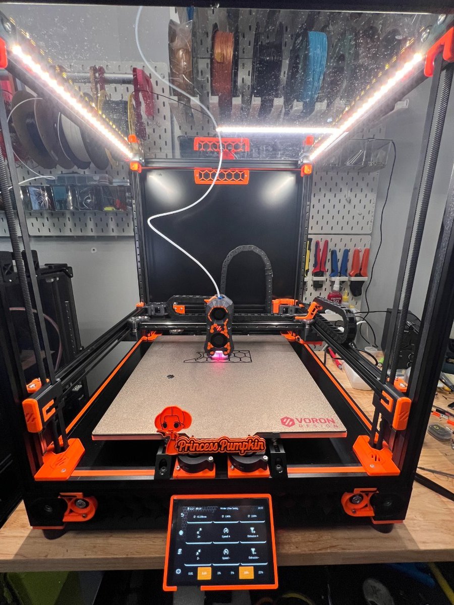

started first print on this printer now, orcaslicer, one fron Skirt with a Keystone in it.
Estimation 1:21 hour to print, I think thats not bad, but ok, its also with a 0.6 (tungsten) nozzle.
Yes, I give my printers names now 😛 on request, meet Princess Pumpkin.
