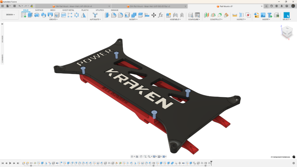

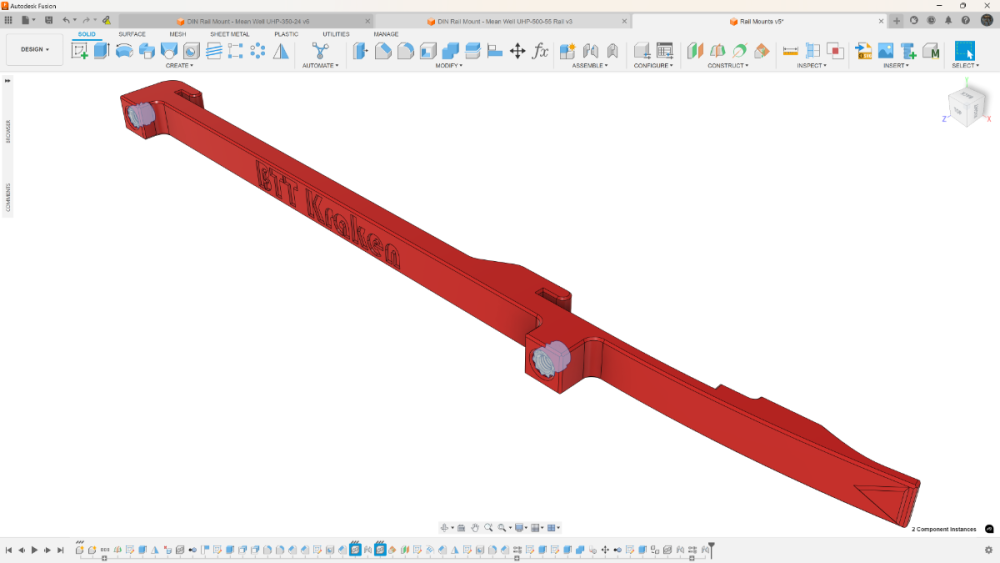

Add 2x Voron Style M3x4mm Heat Set Inserts per Rail Mount ( marked in blue ).
Use 4x M3x8mm Flat Hat Cap Screws to attach the Board Mount to the Rail Mounts ( marked in blue ).

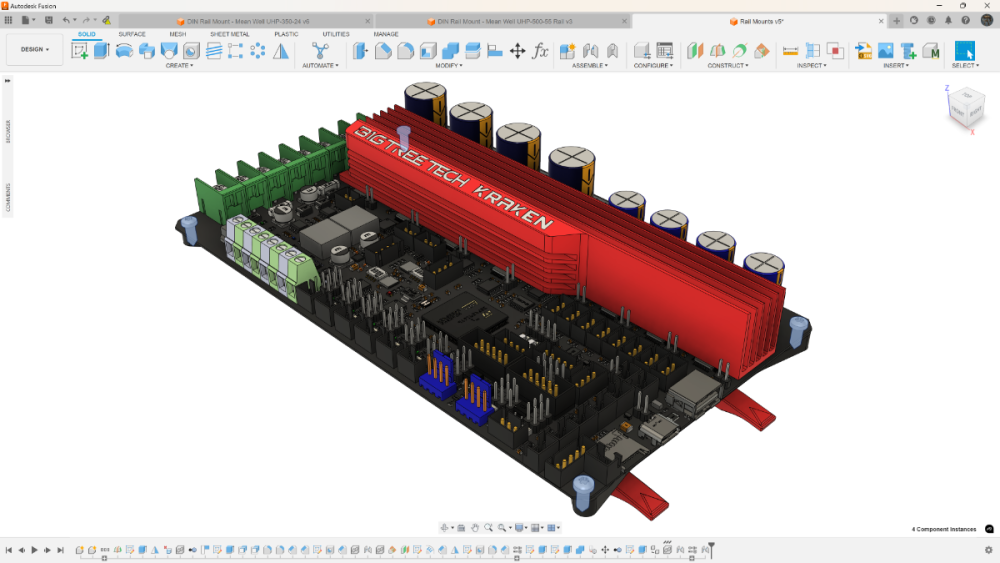

Use 4x M3.5x8mm Self Tapping Button Head Screws to secure the BTT KRAKEN to the Board Mount.

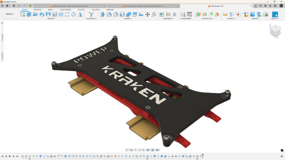

Attach the Assembly to the DIN Rails with a sliding motion while pressing down at the end with the Securing Latches ( BTT KRAKEN removed for better visibility ).
To remove the Assembly, pull the Latches slightly up followed by sliding it back out.

This Design requires the distance between the DIN-Rails to be of proper length!
Too far apart and the rear Hook will prevent the Locking Mechanism from properly seating onto the front Rail.
Too close together and the rear Hook might not catch.
As such perhaps consider using the Mounts themselves with setting up the required distance between the DIN-Rails.
