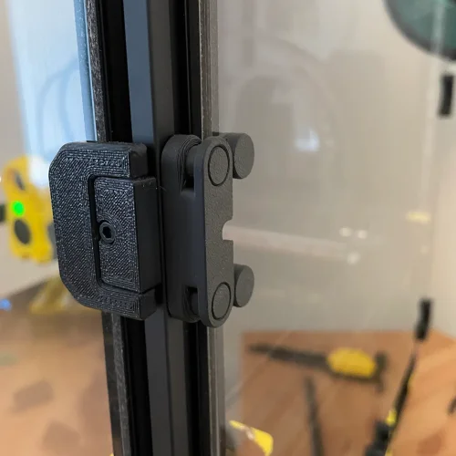

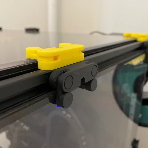

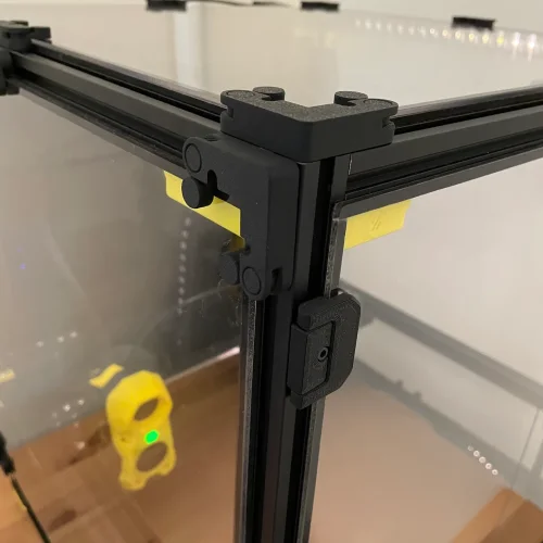

I really liked these panel locks, they look very pretty and have less moving parts than panel clips.

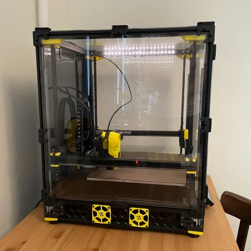

My Formbot kit came with unusual acrylic panel thickness of 2.5, so adding a sealing foam of 3mm, my total depth should be 5.5. I've also increased the horizontal tolerance between knobs and main body.
I've also uploaded the .step and .f3d files, so you can modify those for your thickness through changing parameters.
