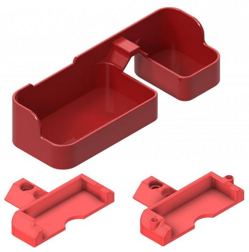

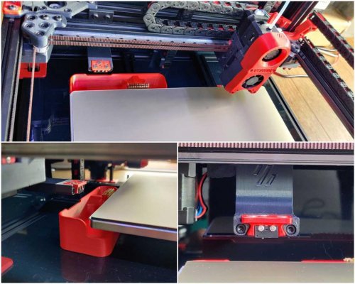

Purge bucket (Klicky) Mod.
Credits:
- @edwardyeeks: Decontaminator Purge Bucket & Nozzle Scrubber
- Basically his design is already perfect, there is nothing really to improve on it. I just made a small Cut-Out for the Klicky (which you can do tbh yourself with a side cutter xD)
Printing:
- Default voron settings, correct orientation, no supports needed!
Bom:
Description:
- The bucket itself is v2.4 350 only compatible. I don't know and can't test the dimensions of a 300/250... But it's a dumb cutout anyway only.
Description (Only for Blurolls-Kit Owners)
- The Blurolls kit includes M4 Knurling-Nuts, that are a bit smaller and shorter as BOM (DIN466) ones. The difference is: BOM-> height: 9,5mm / OD=16mm Blurolls->height: 8mm / OD=12-14mm
- So for exactly this reason, this repo includes a modified Brush-Holder.
