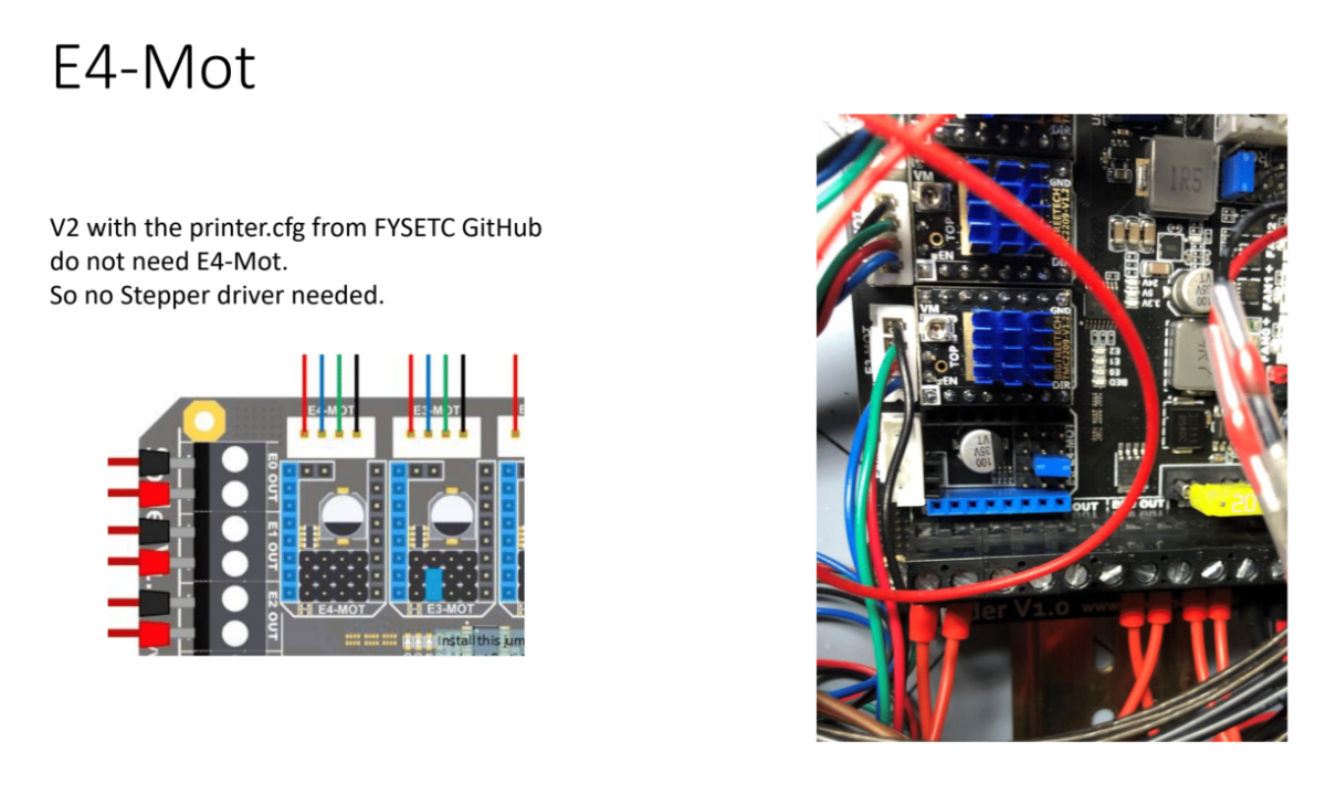

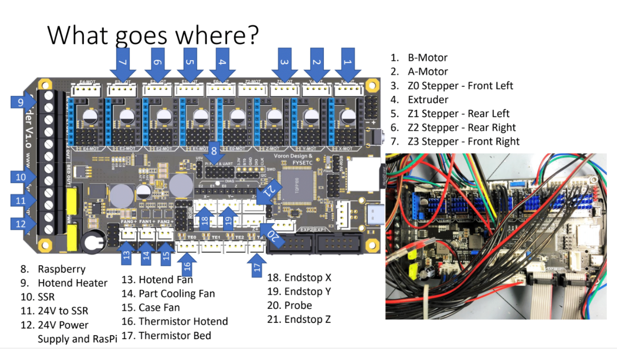

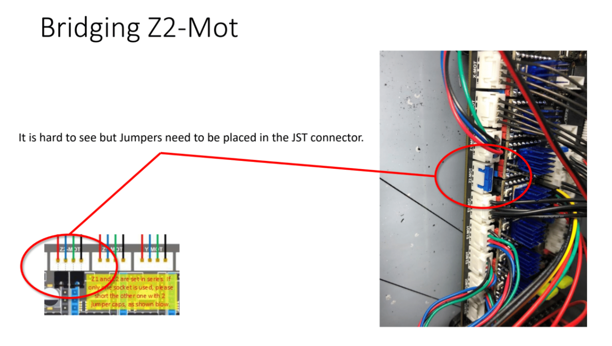

  2. While researching wiring diagrams for my upcoming 2.4 build I ran across an important document for those using a Fysetc Spider board in their build. The document is specific to using the Spider Board for a Voron 2.4 Build and references the Fysetc Github page for .cfg files, that can be found here... https://github.com/FYSETC/FYSETC-SPIDER Klipper Config - https://github.com/FYSETC/FYSETC-SPIDER/tree/main/firmware/Klipper Marlin Config - https://github.com/FYSETC/FYSETC-SPIDER/tree/main/firmware/Marlin Voron 2.4 Spider Wiring Diagram I was unable to locate the original author, if that is you please let me know so I can give you credit!
