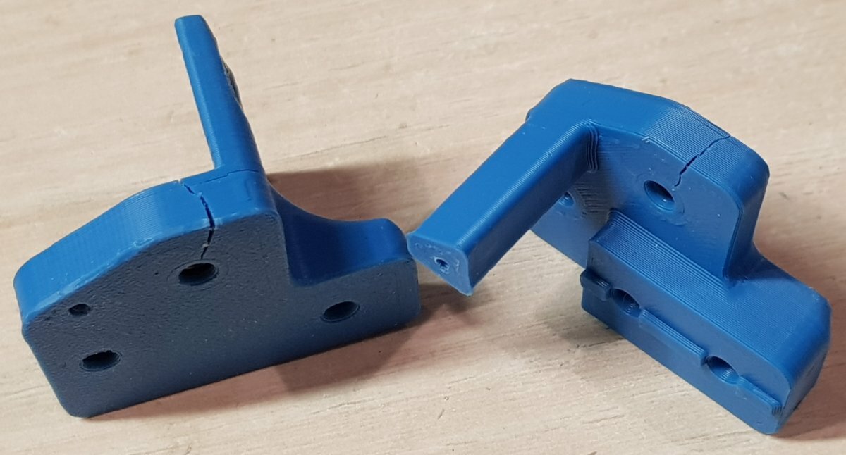

You can say that again. I am in the process of rebuilding the gantry on my V0.1. Both left and right XY joints developed cracks and were causing some serious print quality issues.
  • Sad 1

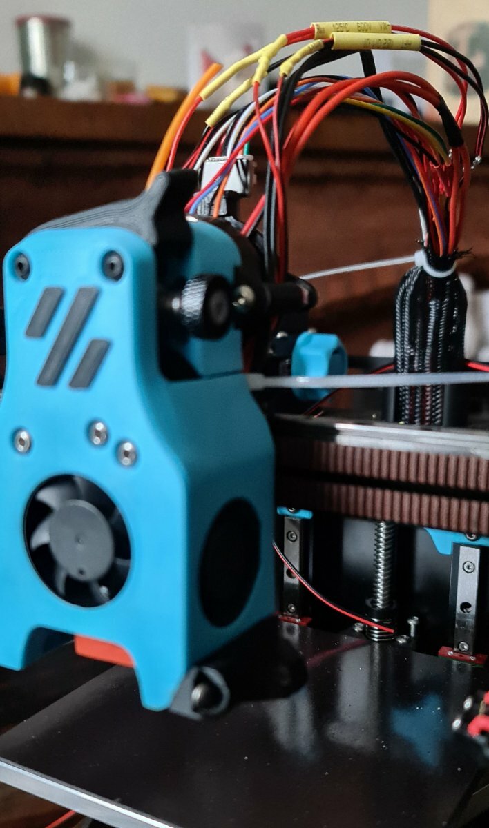

Apparently fixing a Voron isn't a priority (something to do with the time of year, I dunno must be Hogmass or something),but I got the fans refitted, and ..... <drumroll> ... they still work (and the wires didn't drop off this time).
Clearly I've got to reinsate all the wiring and hide all that splicing and solder (thank goodness for heat-shrink); reinstall the electronics bay (had to remove that to give me some slack on the cable). One benefit has been adjusting the umbilical  so it's not quite so "prominent" which might give me a chance to get the top-hat on....well here's hoping.
At some point I think I'll need to replace the x-carriage and the motor mount - reffiting the Mini-AB was a complete pain (even worse than the first time). Despite having spare x-carriages I did not fancy replacing the belting (as I probably trimmed the ends a little too short to even be able to grip them (remember fat sausage fingers) and retension. Guess I can keep that for a future project.
