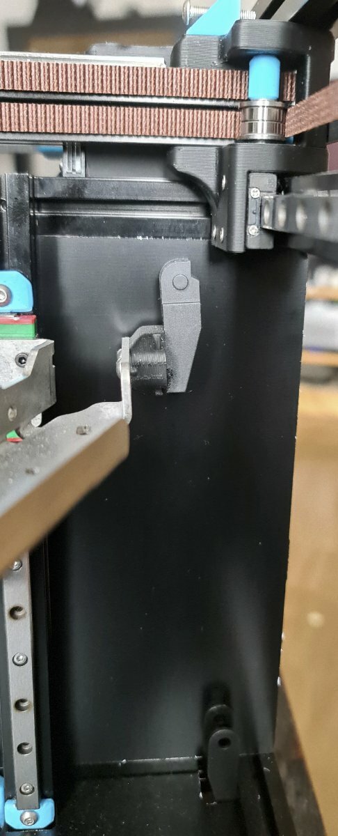

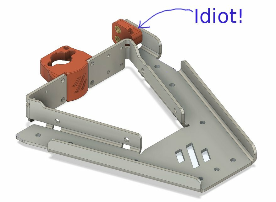

I vaguely remember, from weeks back, when attaching the cable chain mount to the kirigami bed thinking to myself "that will be impossible to remove" once assembled into the printer......not enough room to get in and remove the screws [I should've listened to that inner voice, and questioned it a bit more].
When I fitted the bed and was running the cables and trying to route them nicely and secure them, I realised that firstly I had fitted the cable chain mount on the wrong side of the bed:
How I managed to do that or miss that, given how much faff the assembling/fixing/kludging of the Kirigami bed has been, I don't know. It is perfectly clear on the github instructions:
Not only had I fitted the cable chain mount in the wrong orientation I had also managed to fit the wrong bloody end of the cable chain. The end that I had on the bed would not allow the cable chain to flex/bend sufficiently so the top of the cable chain could curl over nicely as the bed goes up and down.
I would love to say that I noticed that at the same instant that I realised I had fitted the mount on the wrong side of the bed......but no! It was my second attempt at trying to route things and attach the cable chain proper that I realised that I had the ends switched around. So I guess that would technically be Mistake #147 (possible Mistake #146b)

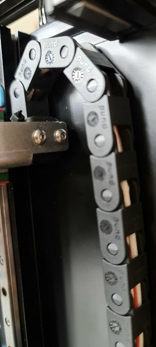

Fortunately, other than having to remove the back-panel to give enough access, I did not have to dismantle anything. Eventually after much more time that I wanted I managed to get things corrected and now have the bed mounted and the cable routed through the cable chain:

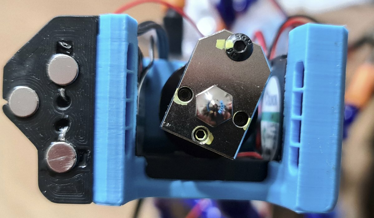

For whatever reasons, I never though about [test] fitting the hotend itself, not until I came to fit it for real:
The damned holes did not line up, the hotend was squint. Yes, I printed the wrong Cowl! I had even printed it twice (in case I destroyed one when fitting the threaded heat-insert for the kilcky mount). If you look really closely in the reflection on the nozzle you can see a really grumpy old beardy bloke (wearing a Goral skin hat).
Well I'm printing another cowl (hopefully the correct one) and I'm not looking forward to trying to pop all the components back out (although I might just cheat and cut them out).

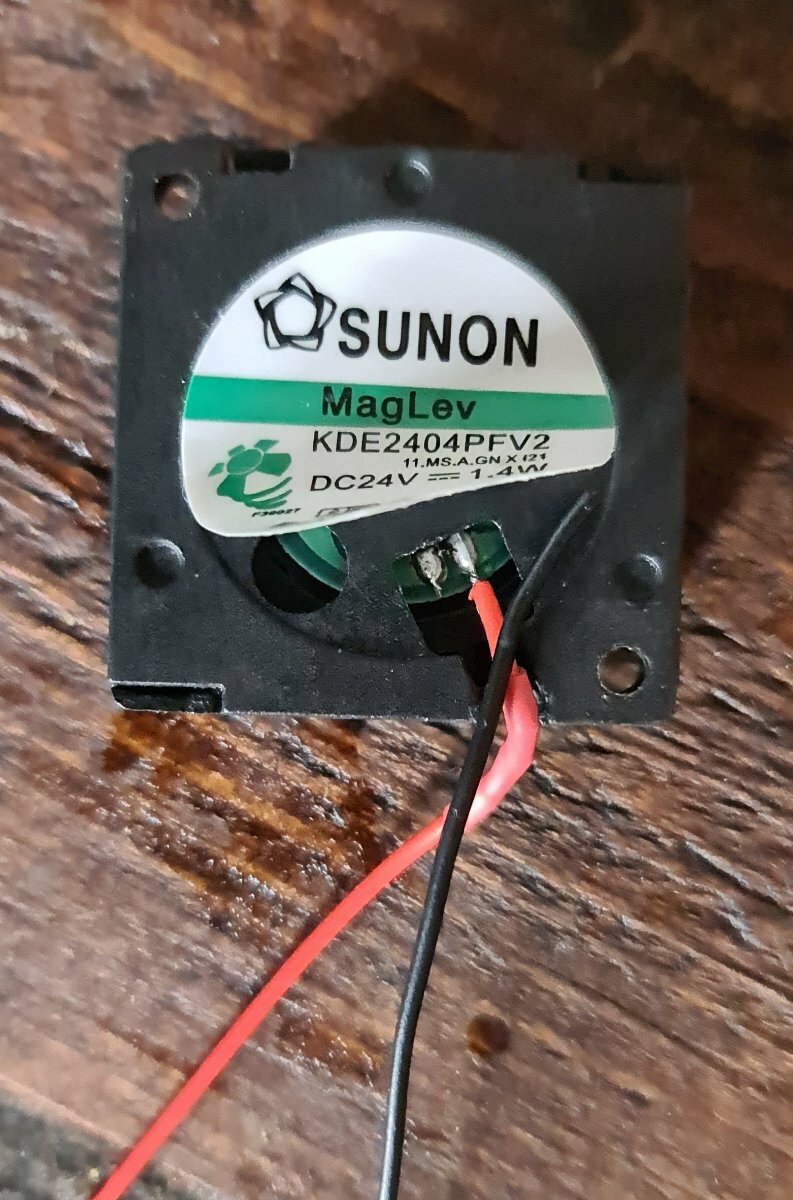

Re-fitting the first part cooling fan and it  slid in beautifully and clicked into place....but clearly I was not careful enough with the wiring. When checking the wires, I thought "Hang on, ones missing". Yup I'd managed to slice through one of the wires attached to the fan (clearly pinched it between the fan housing and cowl:
You couldn't make this up. It's salvageable, although I don't look forward to trying to solder the wire to the miniscule terminals inside the fan housing...I might try and cheat and just splice the wire but that's for another day....

I did repair the wire on the fan, last month, but I chickened out trying to solder it on and simply spliced it. However, it worked.
So I've been farting about on other projects ressurecting some of my VAXen, sorting the firewall and general procrastinating  but I thought "Enough! Today's the day". So I started assembling the mini-afterburner. I made sure the cooling fans all worked before assembly (they did). I was very careful. It took me about 20minutes to install the most awkward part-cooling fan making sure I didn't pinch the wires again. I even put the repaired fan on the "easy" side where the wires just feed out of the back, rather than having to feed underneath the fan body. After getting them installed, I checked the fans still spun  (and they did). Hoorah,my fat sausage fingers have not got in the way (well they did significantly increase the time taken but slow and steady wins the race).

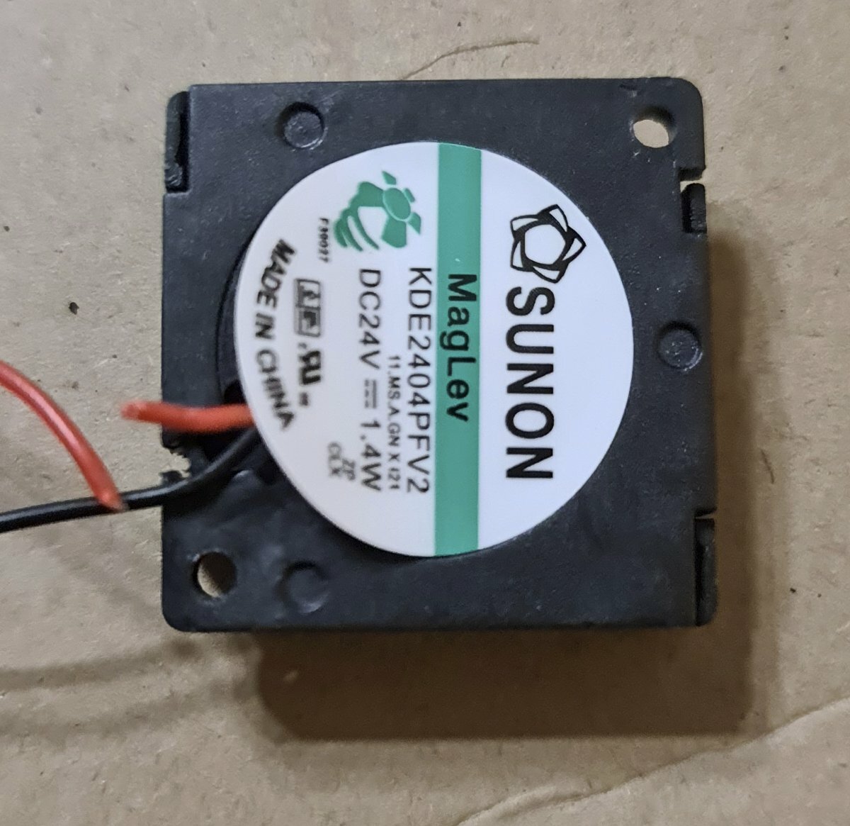

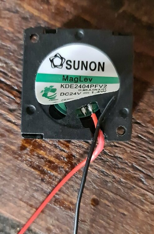

Everything is looking good and still working. So I prepare to permanently install the Dragon Hotend. I've already test mounted it,so I know it works. I reach down......I pick up the mini-afterburner cowling............and the 🤬 wire drops off the part cooling fan. Not the wire I had spliced. No, the other wire! It just dropped off!
Someone up there hates me. It's the one part I don't have spares of. I could've ordered a set in my "month off". That'll larn me for covetting another mans PIs
