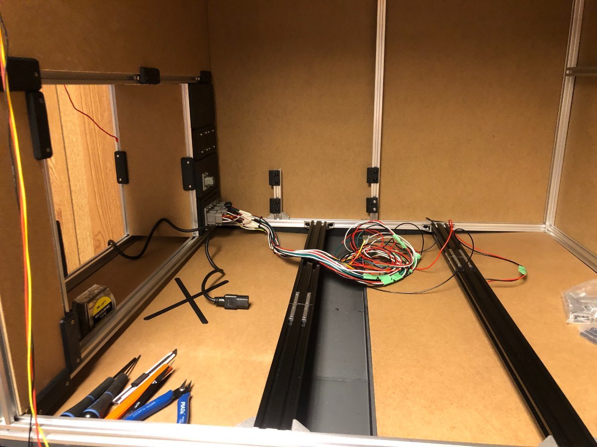

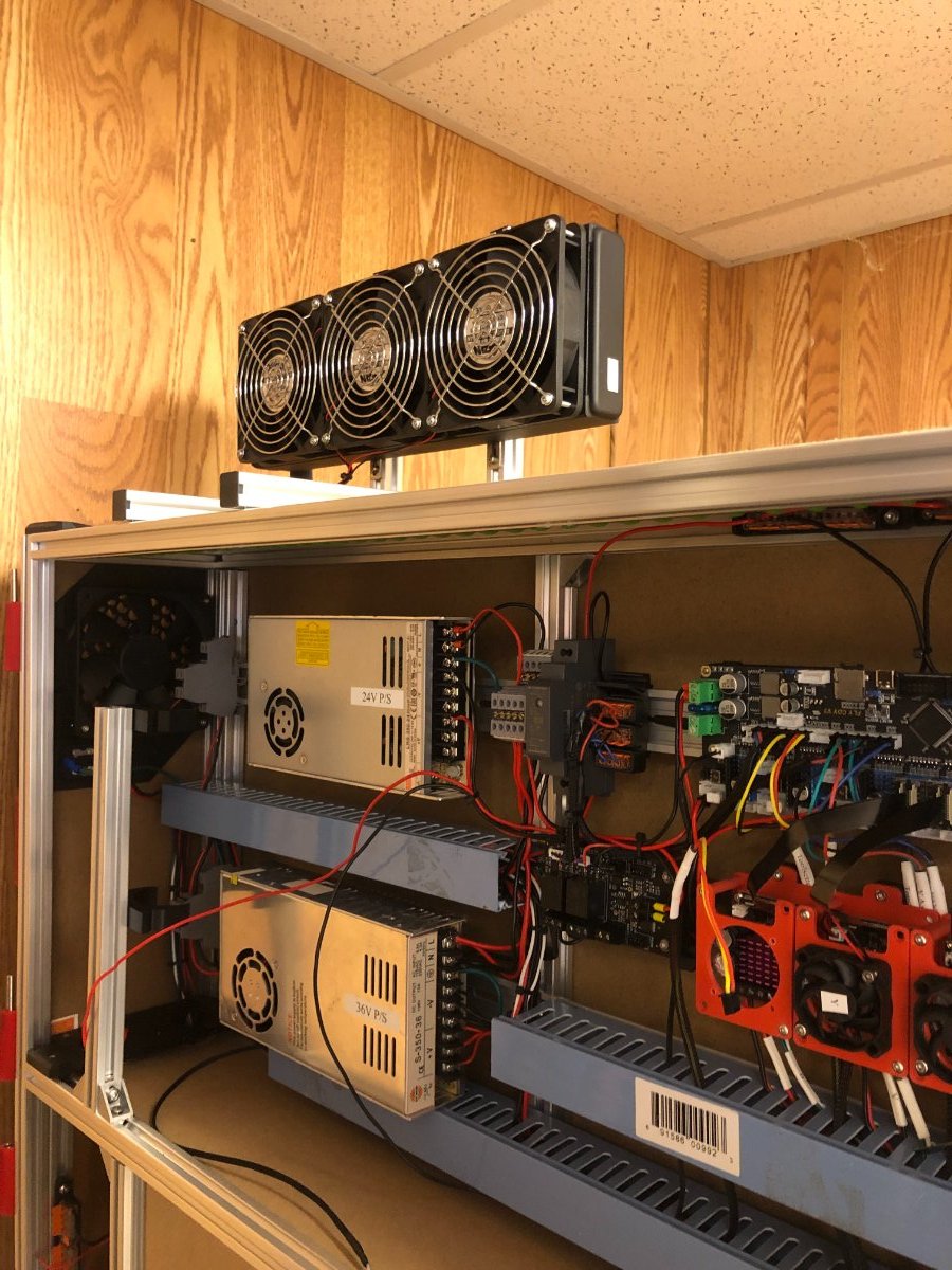

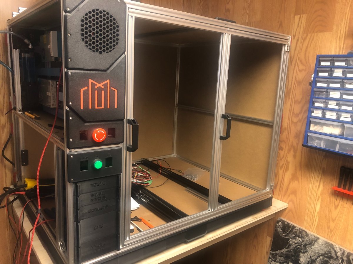

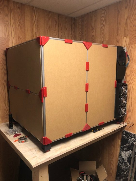

Coming from the installation/service industry I would drill into my installer to think about the positioning/orientation of the components and ask yourself if it is easily serviceable. My original location of the radiator was at the back of the Casa enclosure. With little room to spin the enclosure on the table, it was awkward to access the radiator should it need to be serviced for any reason.
I relocated it on top of the enclosure which is much easier to access. The only drawback is having to route hoses and wiring to this location.

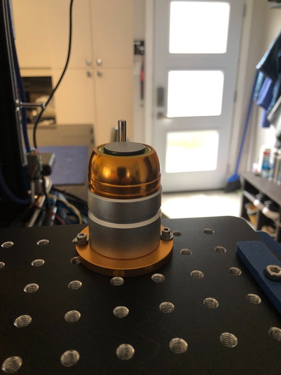

I removed the 1/8" mounting plate I had fabricated for the tool-setter and drilled and tapped the Milo fixture so I could mount the tool-setter directly to it.

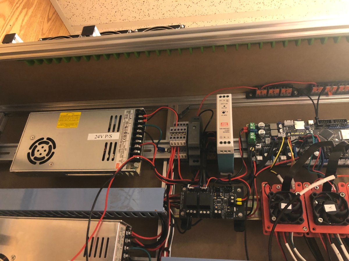

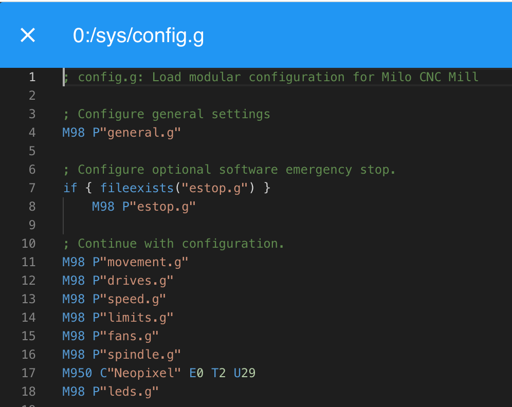

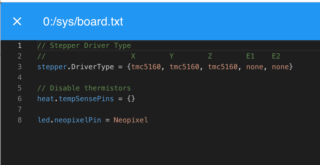

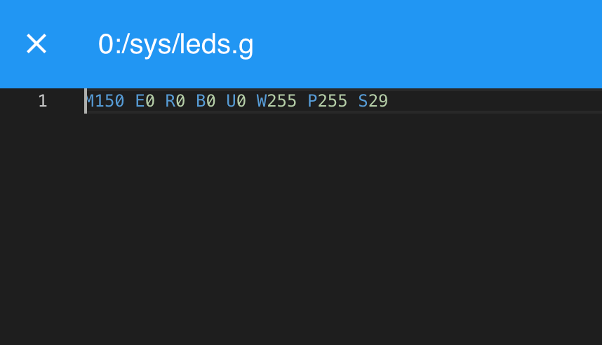

I'm trying to set up the LEDs in the e-bay; this is what I have in the RRF system. I'm having no luck powering the LEDs. 5V comes from a separate power supply signal and ground connected to Neopixel port. Do you fellows use RRF or Klipper for your VZBot? I tried to get help on Discord but no luck there.
Update: turned out that the 5V—power supply when metering voltage to the neopixel ground pin was only getting 1.4V. Wire the 5V neopixel wire to the port 5V. and all is good.

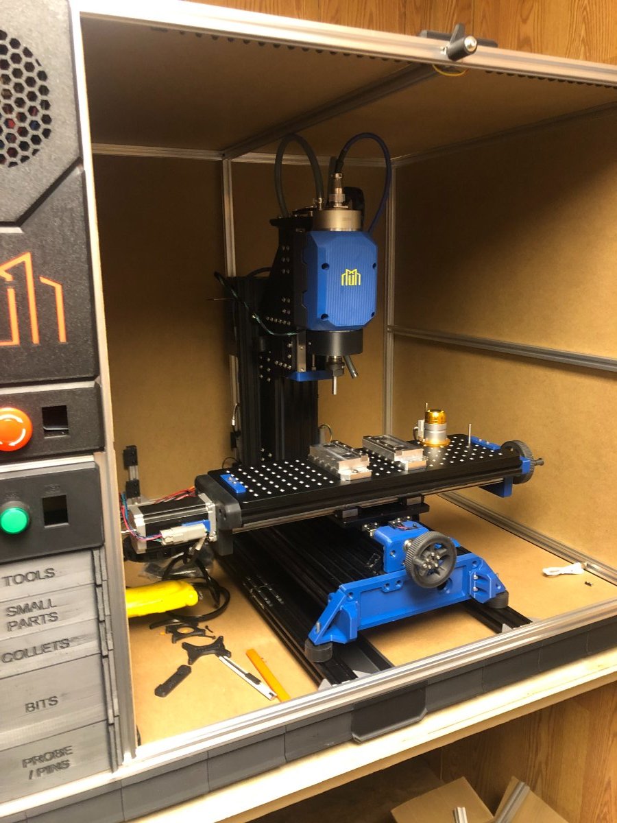

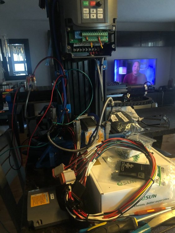

Milo is inside the Casa enclosure. I need to complete a few electrical connections and plumb the water cooling system. Then ready for start-up and trimming. Measure the X travel to the right and the Milo needs to move at least 10mm to the left.
The Milo has some movement, the z and y homes smoothly. The issue is with the X-axis the stepper is loud. I think I've set the backlash too tight. The other issue is not homing correctly. I'm going to reset the backlash and rewire the stepper.

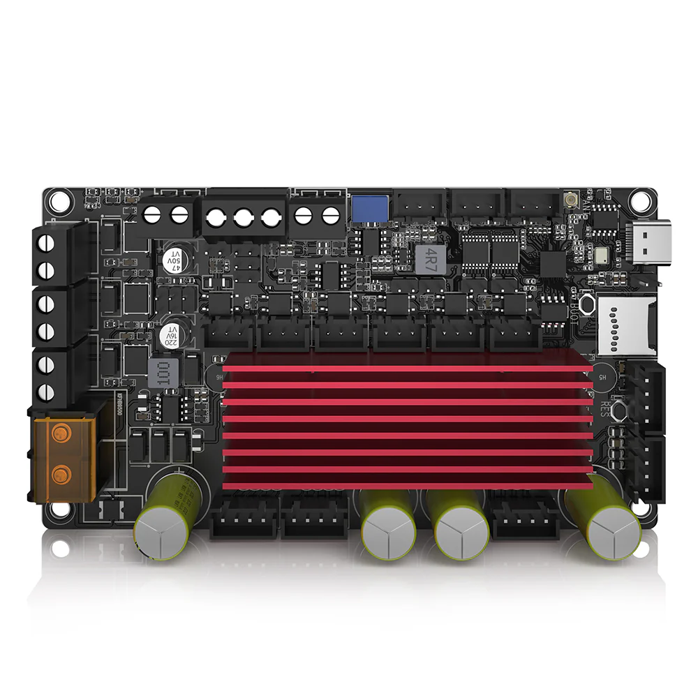

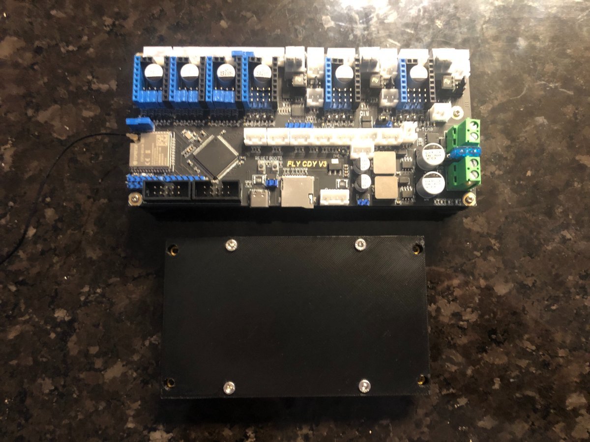

Well, this sucks 😟 the Mellow Fly CDY V3 board stopped communicating with the SD card. Tried a second SD card with no luck, and tried to re-install the firmware but this confirms the no communication it will not load the firmware.bin. I guess I'll need to wait for the BTT Rodent to continue testing.

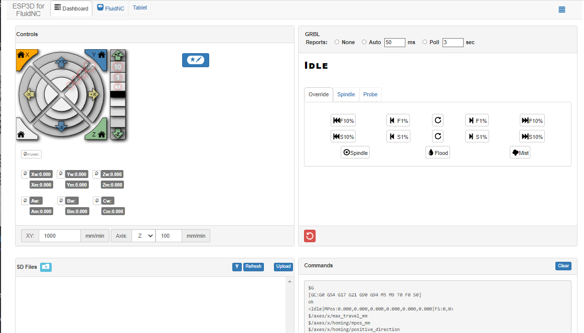

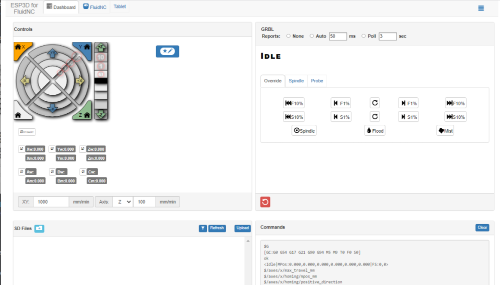

Yeah, I have a hard time keeping anything stock 🙂 . I'm glad I ordered the BTT Rodent since the Mellow board bit the bullet, and I like what FluidNC has to offer.

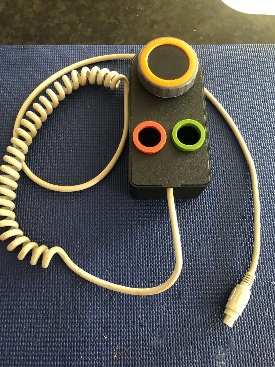

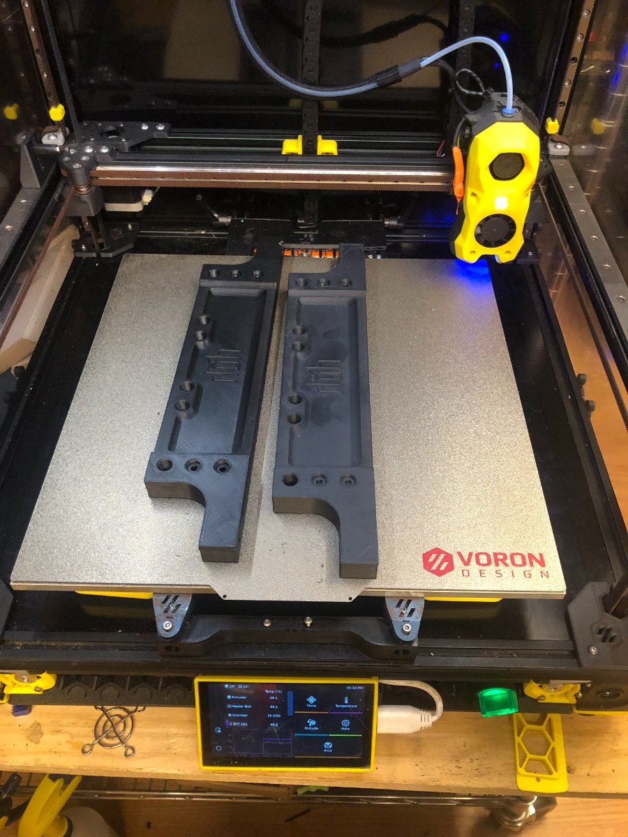

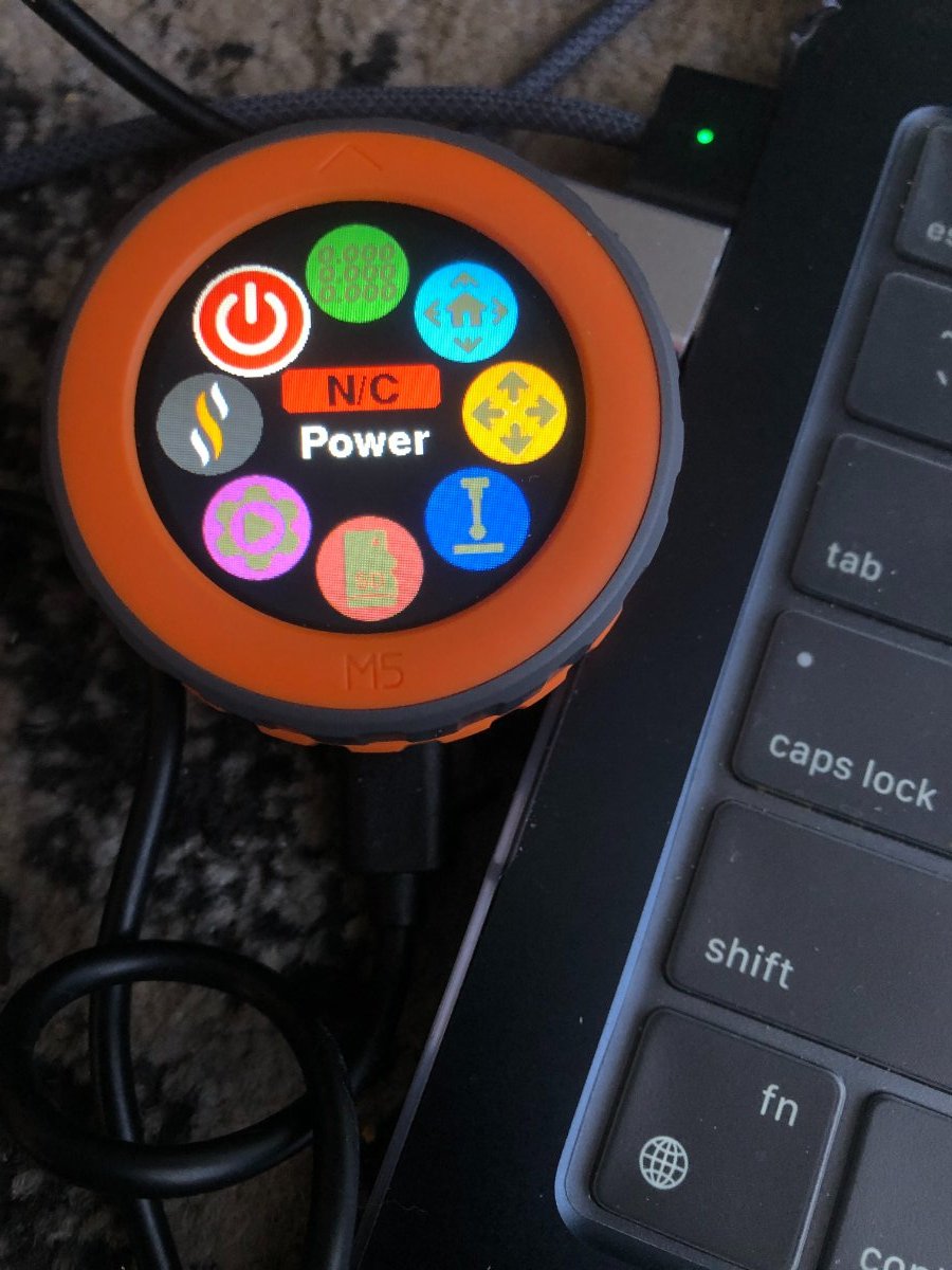

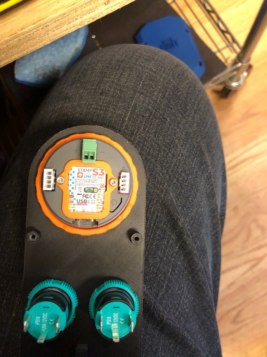

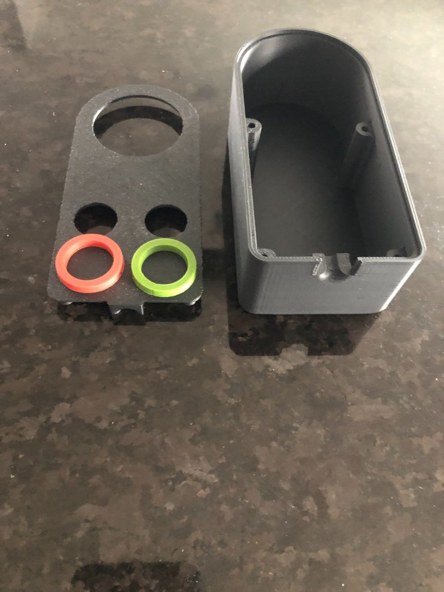

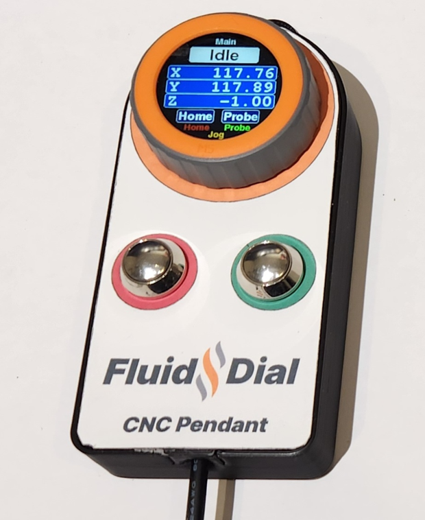

I printed the pendant case. If you want to print this, note that the step files listed on GitHub are completely different than the STLs they're for CYD pendant. What I've printed here are modified step files the bottom base is extended to accept the 19mm switches and the top switch holes are to fit the 19mm switches. Coloured rings have been modelled. The momentary button switches I've ordered have coloured LEDs. With Canada Post on strike not sure when these two projects will move forward.

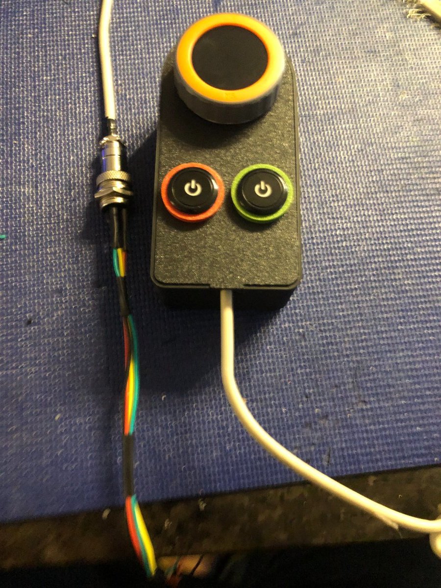

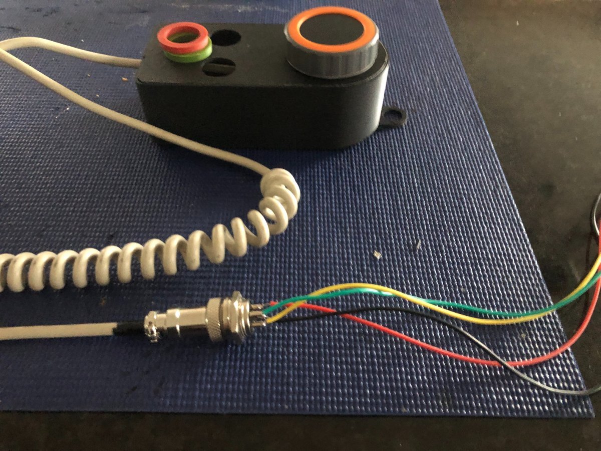

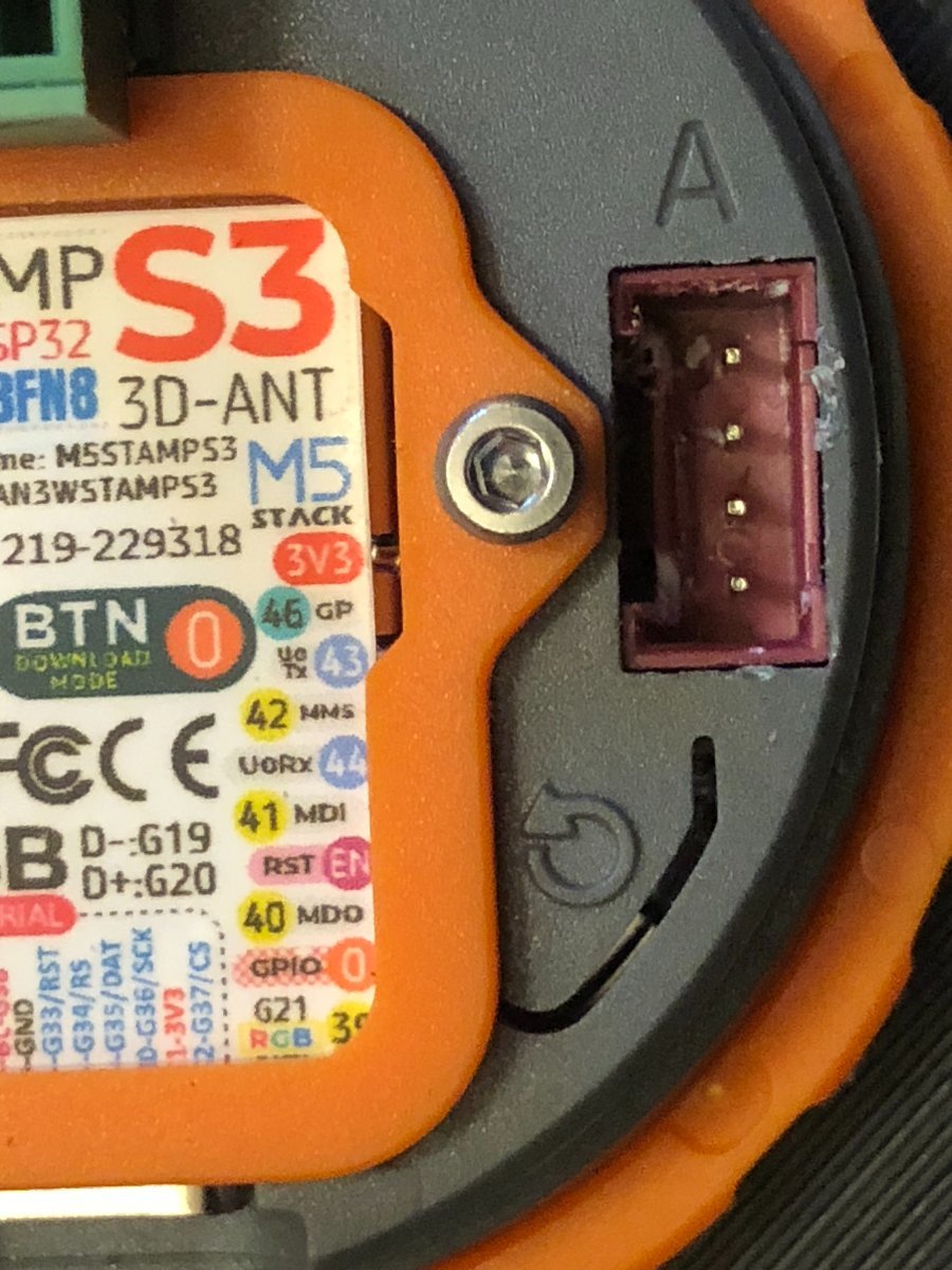

I purchased the momentary switches and rockers switches for the Casa from an electronic store in Montreal, Quebec an hour drive from home. Use a 4 pin 2.0 JST for the wire connection on the MS5. I needed to remove lock tabs so the connector would fit. Once I confirm the operation of the pendant I'll glue gun the connectors in place.
I've installed heat shrink over the 4-pin connector. Momentary switches are wired and installed.
