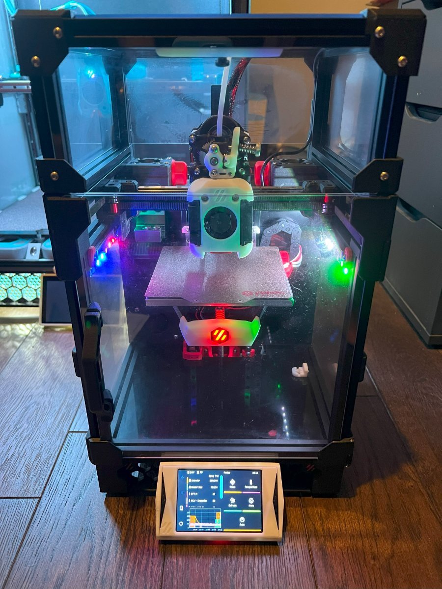

I knew this wasn't finished...
Dragon Burner V8, CANBUS and Screen
To improve quality (i.e. issue 6) I decided to switch the mini-SB to something a bit more flexible. The DragonBurner V8 was the perfect upgrade, with compatibility with my ZeroClick z-stop. I did lose about 2-3mm of Y-travel, plus I also needed to move the ZeroClick probe mount forward, my remix here. Sherp-Mini was my extruder of choice. One thing to note, I bought super cheap 4010 blowers from AE and they were extremely weak, later replaced with GDStime 9500rpm ones. Buy cheap, buy twice.
I was also frustrated at the rigidity of the original umbilical and so I went with an EBB36 CAN board with Katapult. This interfaced neatly with the U2C Can Module of the BTT Pi. I had experience with CAN on my current V2.4 build, so this was relatively straight forward. Katapult will make things easier in the future.
Finally I added a BTT SPI TFT35 screen. This was surprisingly not as responsive as I thought, requiring very firm presses. I would say it is more of a display rather than an interface device.
