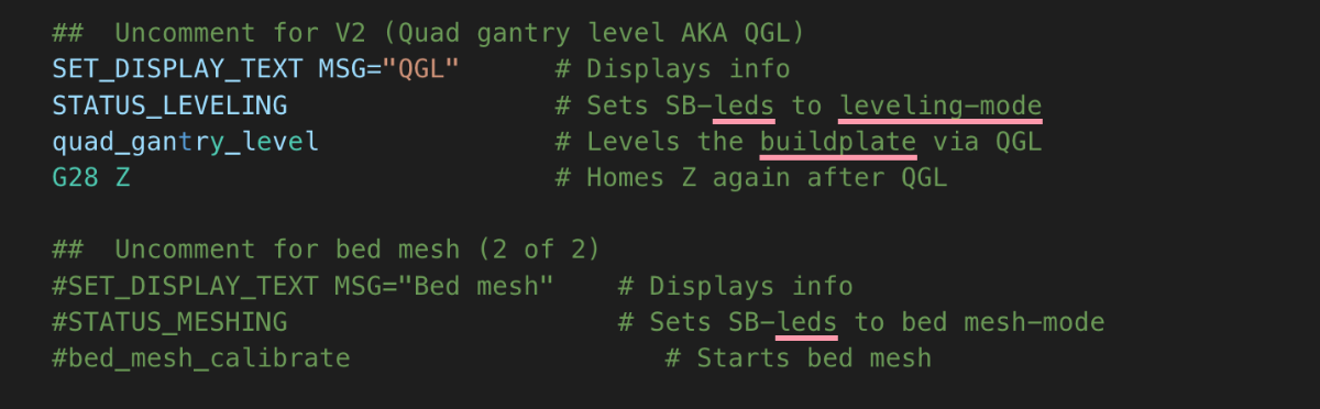

Things are coming along well.  The panels are on and I am slowly printing the remaining ABS parts now.  The only bug I keep running into is that anytime I try to do a bed mesh calibrate I cant get a QGL to be successful after unless I delete the bed mesh.
I actually only use QGL for bed levelling but have uncommented the bed mesh and it works.Screenshot2023-07-12at11_28_23AM.thumb.png.ecffa078a19f17ad9836564e5d2896f1.png
