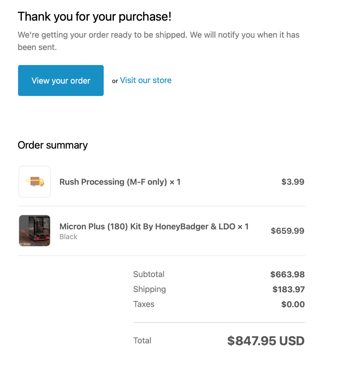

Thanks for your suggestion @claudermilk! I know the quality of LDO's kits, though I wasn't aware Fabreeko sells a Micron kit.
Unfortunately, I live outside the US, and therefore ordering from Fabreeko is a less viable option for me.
Fabreeko’s shipping estimator shows a minimum extra of $140 for shipping (higher cost for faster couriers).
On top of this I’ll need to pay %25 taxes, which will make this the most expensive Micron in the world, especially when considering the additional components I'll have to purchase, such as mainboard, hotend, etc. 🙄
When shipping from China, most often than not, orders pass without extra customs and duty, plus the Chinese kits has some components that the LDO kit doesn't (even if they aren't the ideal ones).
(Edited for clarity)
Edited by gargamel778
I think I can say it is more expensive in Australia:
Normally try and find a local supplier, but no one stocks the Micron. And I must sayFabreeko has quality products and excellent service and happy to support them from afar.
