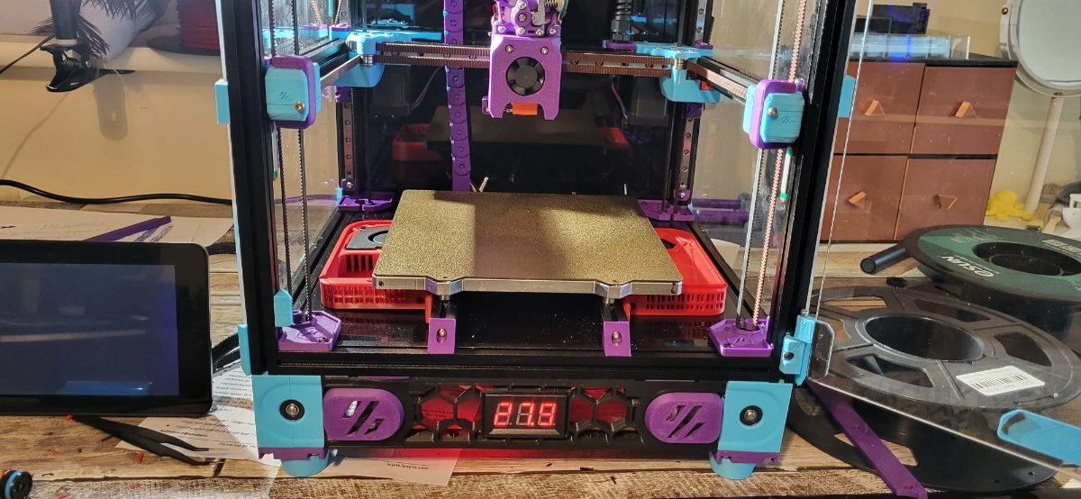

I did write to Hartk Via instagram... he modified the cad to 180 after I complained to blurolls about the issue. Nevertheless, I could not handle it with 180mm. It was not enough space to land one of the outer nuts. I´m guessing If you start to lose tenths of mm in the frame or in your prints tolerances, is pretty easy to stack up 5 tenths in total.
I also gave him some suggestions to help improve the blurolls kit if is of any interest, as despite is not one of his referred links, the kit has allegedly been vetted and checked by himself (I honestly doubt it) Sadly I didn´t get acknowledge of reading and not sure anything will be taken on board.
The sexbolt thing... once I had the whole deck with bed and gantry mocked up, was pretty clear it was no space for it.

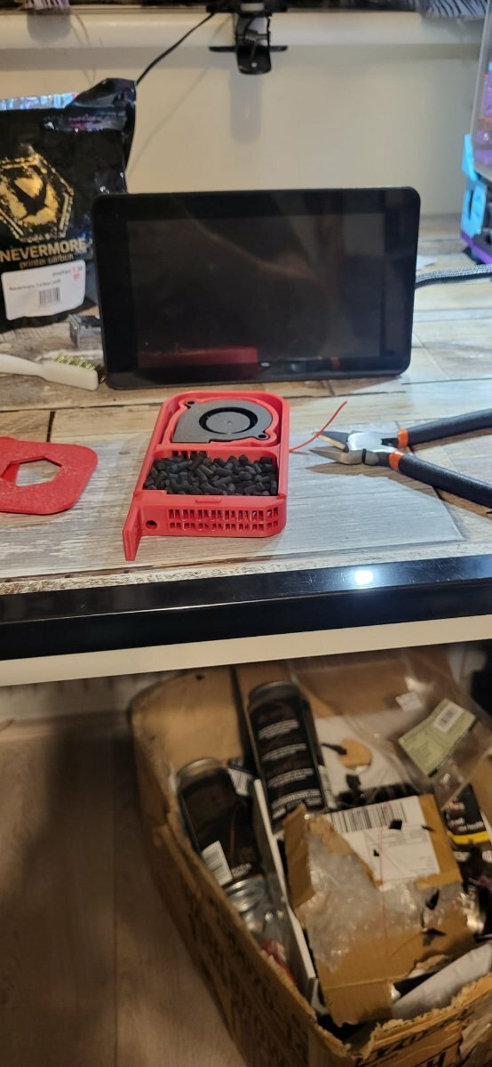

Well. Joining discord was a great shout.
Asked a question. 3 minutes later had an answer.
6 hours later had filter(s)
https://github.com/nateb16/VoronUsers/tree/master/printer_mods/nateb16/THE_FILTER
Ideally you want to have Zero pannels or the likes, and a dupont coonector just in the back of the fan to be able to change the carbon without faff!
As Is my printer, It had to be a bodge somehow. I´ve been controlling myself for the whole build till now! I´ve ran out of accent and main ABS... the only ABS remaining at home was signal red.
At least It will be visible, isn´t it?

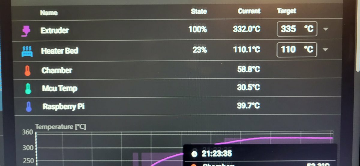

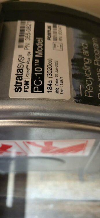

First print over 300 degrees. (330 actually) the hot end struggles to keep the 335 I do really need, but I think is due the 24V cooling fan when it should be an smaller 5V ones.
61 degrees (and creeping) in the enclosure. 50% part cooling for bridges (not sure how well PC will cope with this) and THE MEGA MATERIAL. If that thing turns out OK, and the strenght is comparable of what I get in the enclosed cartesians with the BIQU h2 extruder, I´ll have a problem.... coz I will have no excuse to throw the cartesians out trough the window and get a whole new 2.4/trident.
This dragon HF hot end is MEGA BTW...
I hope the print turns out at least half OK, as I´m pretty sure the current ABS+ Miniaftersherpa installed won´t survive the print and needs to be replaced by the product is printing...

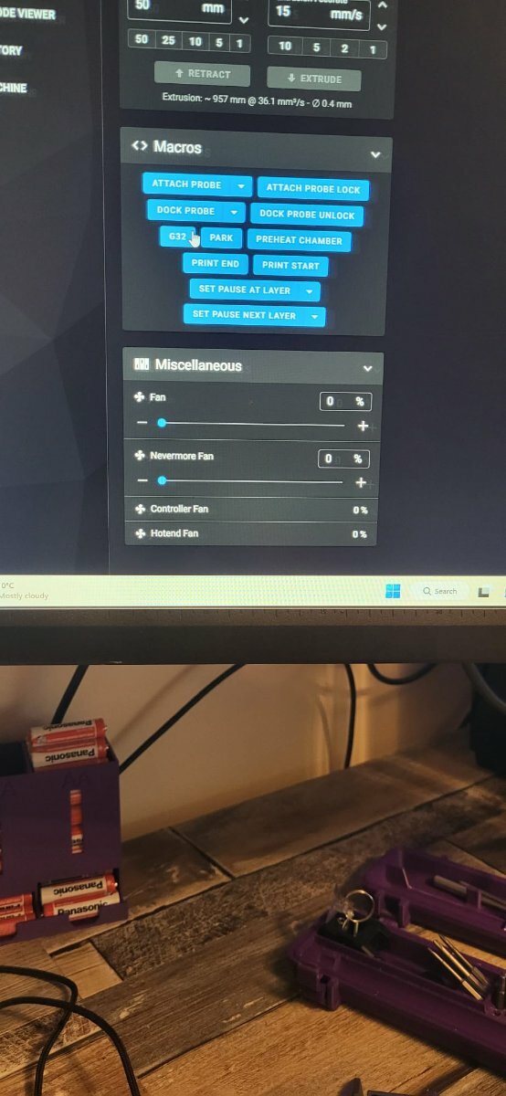

yep. dropped the "hot end fan speed" to 0.7 and is now keeping temperature at 335 no problems. Really stable taking in account is been PDI'd tuned @255

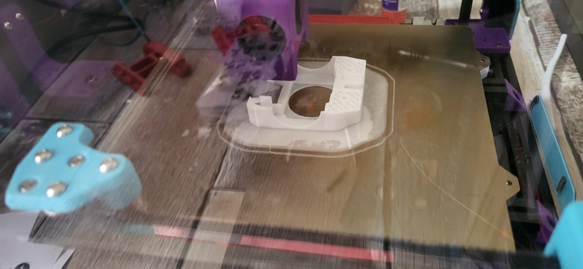

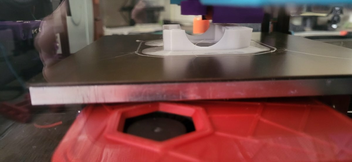

Well. No need to wait anymore. Nothing has melted...
3 prints failures with significant wrapp and corner lifting within the first 15 layers.
Im confused.
Same surface used in the cartesians... (glass with pvglue)
Even higher chamber temperature. (50tops in the cartesians, 60 creeping to 65 in the micron).
Same speed setup.
Tried tuning first layer... big brim... no luck.
Any suggestions?
I thought i had this material figured out and it would be just a matter of finding out if the printer would melt or not... but apparently there is more to it. 😞

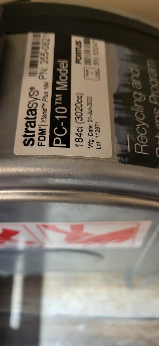

PC-10. Wit ABS no troubles.

No Fan at all(other than bridges)... same speeds as on the other printers...
Not sure where to go next. I´ll keep trying. (I´ve even harmonised temperatures to the degree with an external thermistor)...

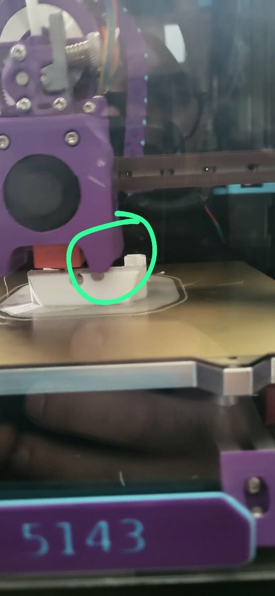

Well. Live updates,
Managed to make it stick (so far somewhere around 1/2 of the print height and not wrapping). Smooth PEI sheet with PV glue, has worked out. sadly isn´t what worked in the cartesians.

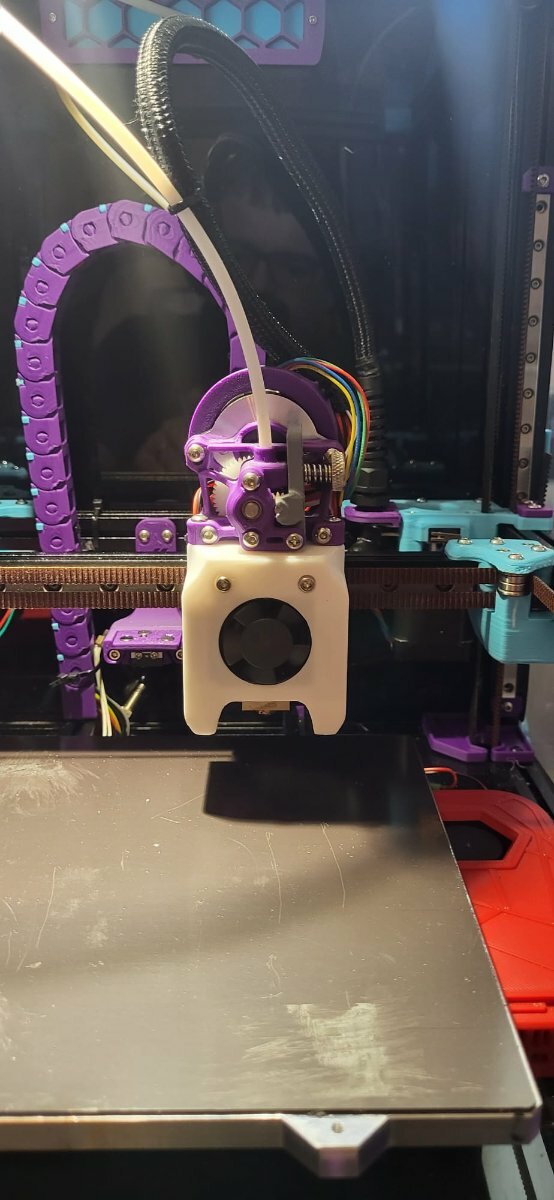

Also managed to melt the ABS aftersherpa, so... I hope the print finishes!!
You can see It tried to pull the brim out, Happily without sucess.
The print is looking really really good tho.
my hot end cowling has moved back to the 70s and bought a pair of "bell" flared cut Jeans...
  • Haha 2
Back to the late 90s... white jeans now.
A really really smart print that requiered no fiddling to even insert the small part fans.
Impressed.

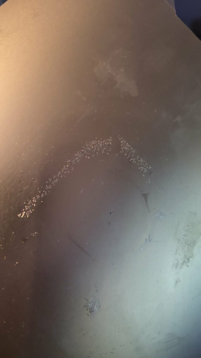

On the other side... ruined my PEI sheet.
Any recommendations of brands that may work at a decent temperature?

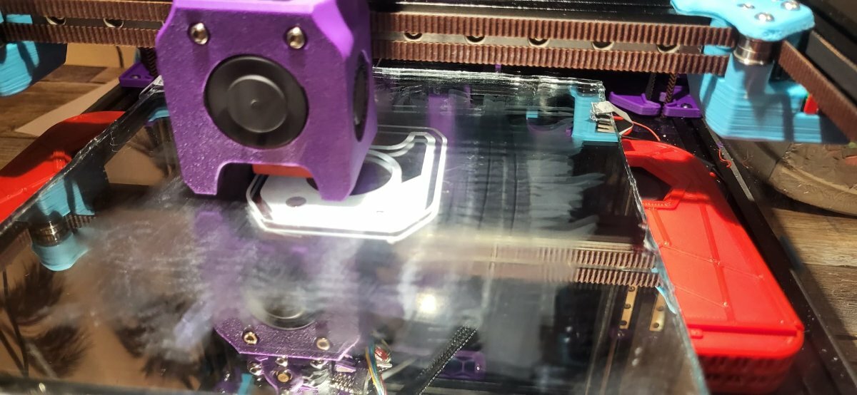

Tried once more in glass with PV glue. This time measured bed surface temperature...
I was losing about 10 degrees on average on the glass vs the PEI sheet and VS what I see in surface on my cartesians.
So... I´ve given today someone the advise to harmonise temperatures between different printers (if you want to cross-match profiles) and I was failing on my own advice and ruined the smooth part of a perfectly good PEI sheet on the process.
Well done maurici, well done.
