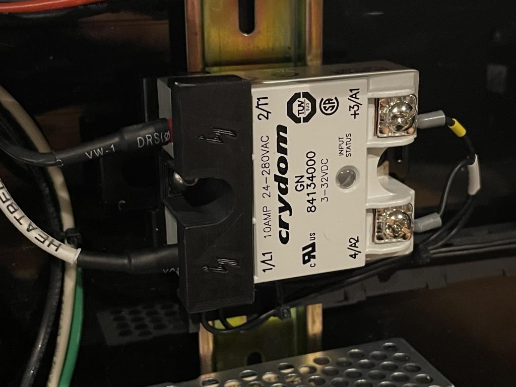

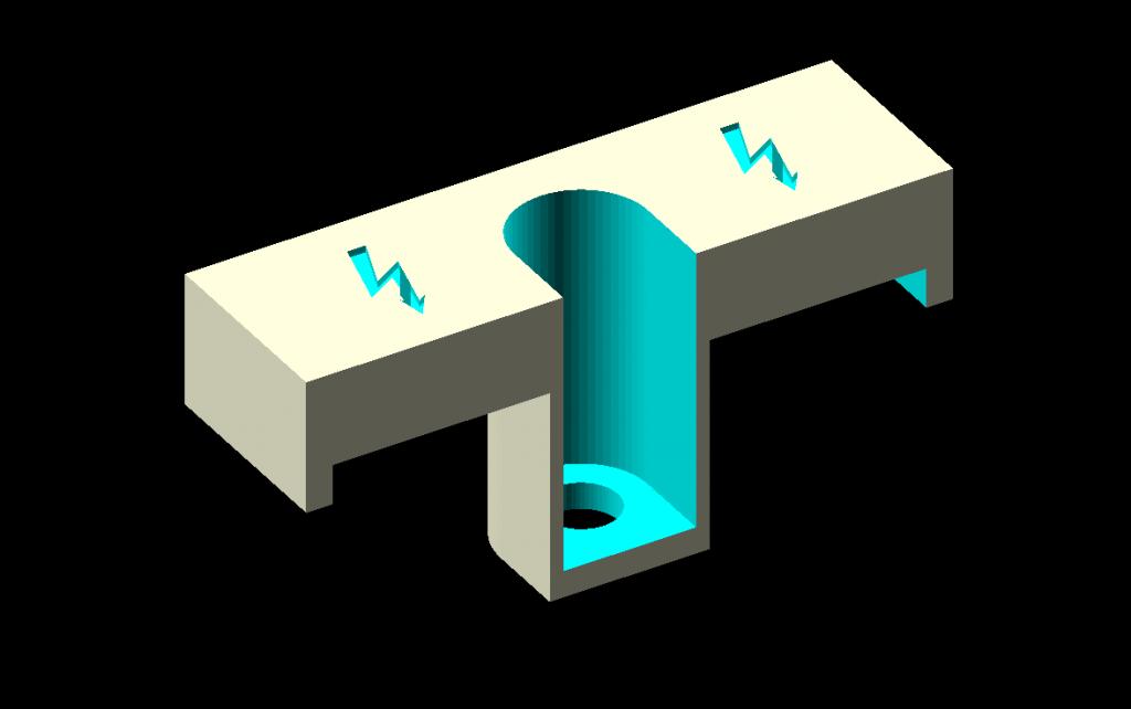

I replaced the SSR on my build with a Crydom GN series SSR. The model I received didn't have the terminal cover, so I created a simple cover that is secured with the mounting screw on the SSR, and helps prevent accidental touching of the high voltage terminals.
Installed it looks like this:
Printed in eSun ABS with standard Voron print settings.
