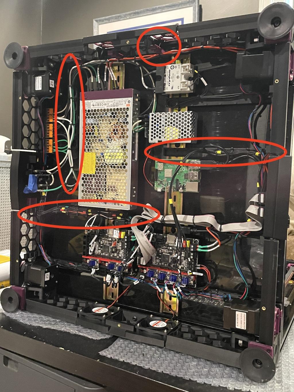

I used this set of clamps to route and secure the wiring in my Voron 2.4 350mm.

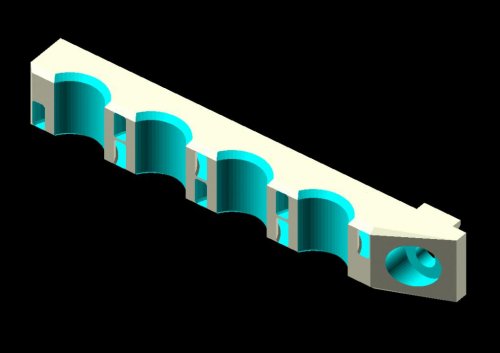

There are three types, each requiring an m3 bolt and t-nut in order to secure them to the inside perimeter of the upper (meaning closest to the deck) 2020 extrusion. The deck should rest on top of the clamps. You'll likely need a ball-end hex driver in order to connect to the nut at an angle via the access hole.

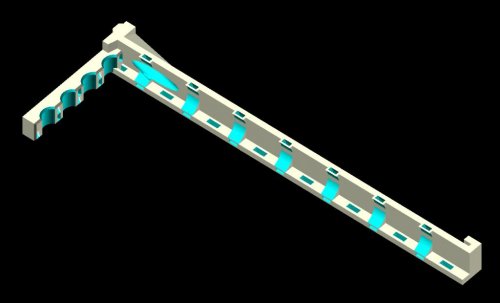

Each type of clamp has an internal channel for multiple small zipties, and the DIN rail clamps also provide secondary holes along the rails.
openscad files are provided for your own tinkering needs.
Clamp types
The first type only secures along the perimeter. I used this to secure high voltage wiring from the power inlet to the power supplies. Multi
