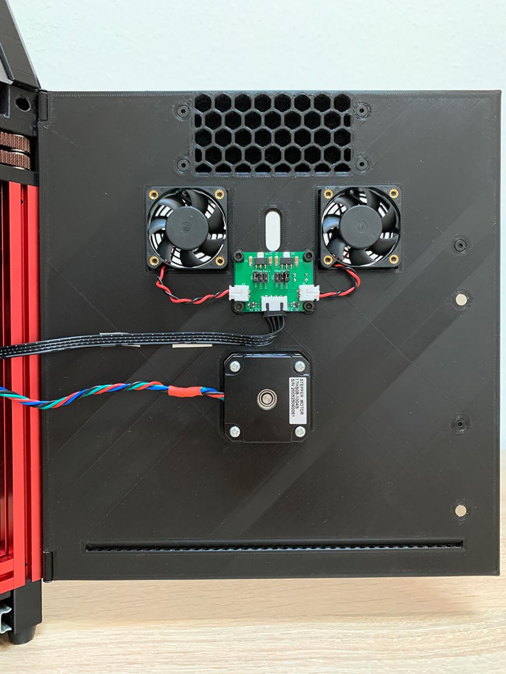

Door for easy access to electronics
Carefully drill the 1mm hole to 3mm for the hinge
Required material:
2x M3x30 BHCS as hinge
4x M3x6 BHCS for PCB
6x M3x8 countersunk flat head for filter and handle mounting
2x Magnets 6x3mm
10x M3x4mm heat inserts for handle and fan mounting
