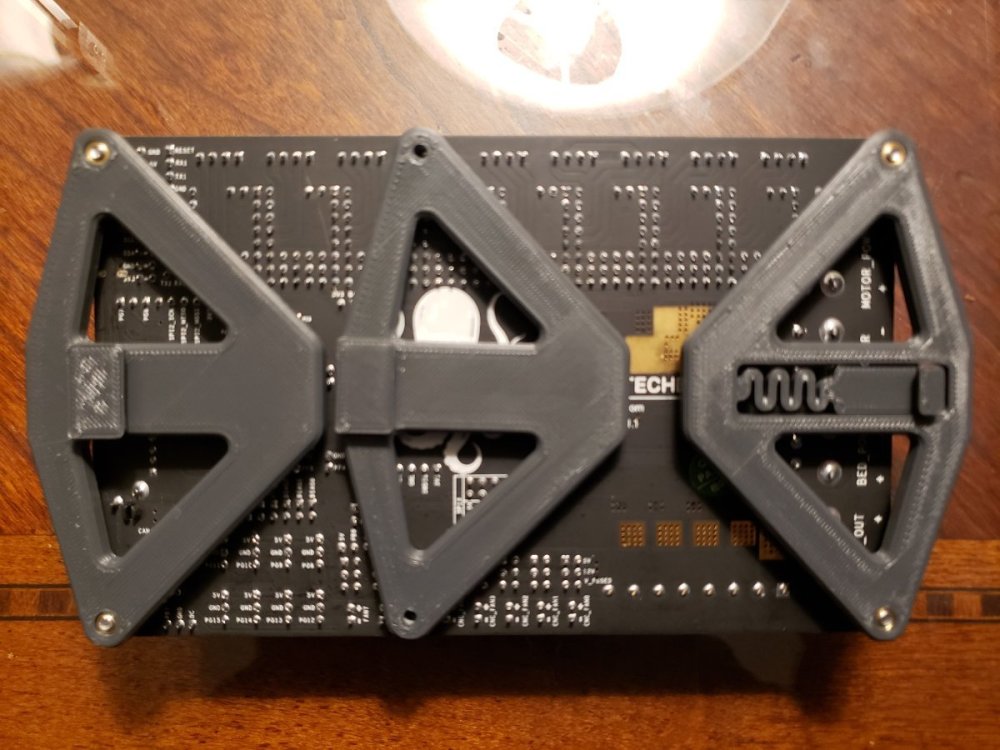

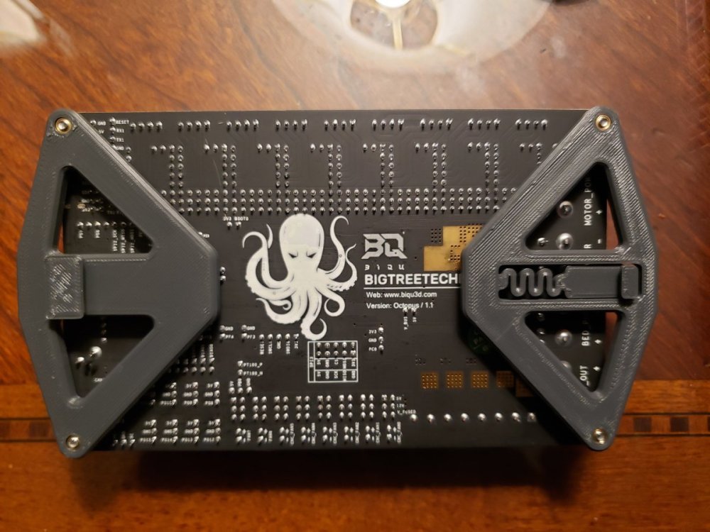

hopeinformer 5 January 26, 2022 3 of 3 members found this review helpful 3 / 3 members Share this review These are gorgeous, thank you for a great design. The only down sides are that the spacers were too small for M3 screws. I scaled up to 110% on the X & Y in my slicer (PrusaSlicer) then the M3s fit perfectly. Also, I changed these for the DIN rails in the Formbot kit, which was 10mm closer than these original setup. Plus, now you can use the brass inserts. Keeping with the Voron theme. BTT_octopus_DIN_mount_A_insert.stl BTT_octopus_DIN_mount_B_inserts.stl spacer_x4_scaled 110.stl Response from the author: Thank you so much for including the updated changes you made as well - a HUGE help for others! 1 1 Link to review
