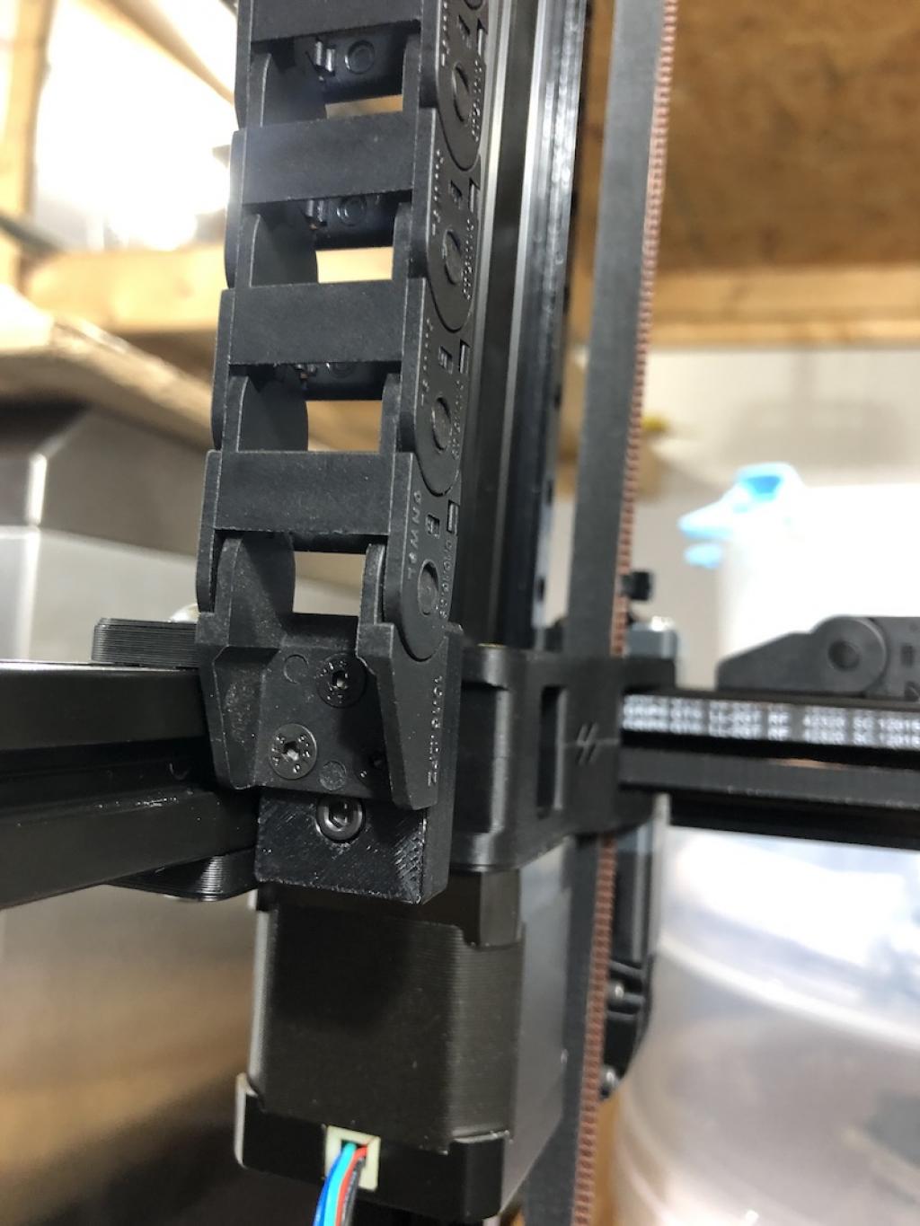

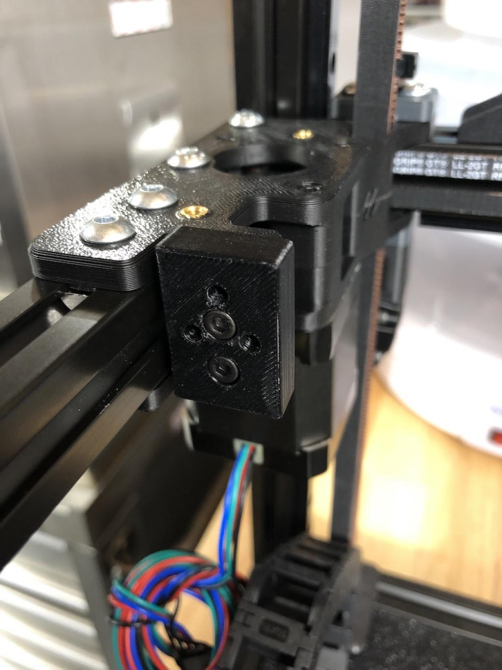

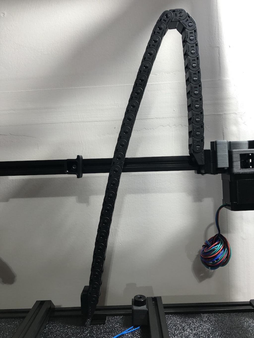

This mod is used to mount a generic 3-hole Z chain in a VORON 2.4. The lower mount replaces the stock lower mount, and the upper mount attaches to A drive in the stock location instead of the 2-hole chain, and then the 3-hole chain mounts to the upper mount.

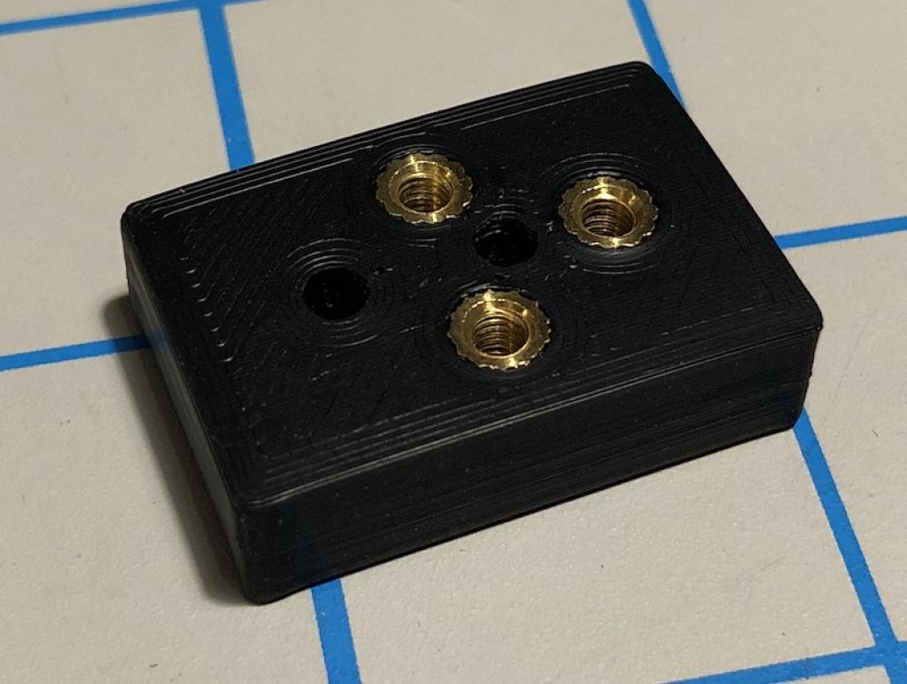

Lower mount:
- 1x M5x10 BHCS
- 1x M5 ball spring nut (or other extrusion nut)
- 3x M3x8 FHCS
- 3x M3 threaded insert

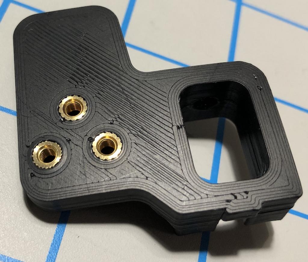

Upper mount:
- 2x M3x12 SHCS
- 2x M3 nut
- 3x M3x10 FHCS
