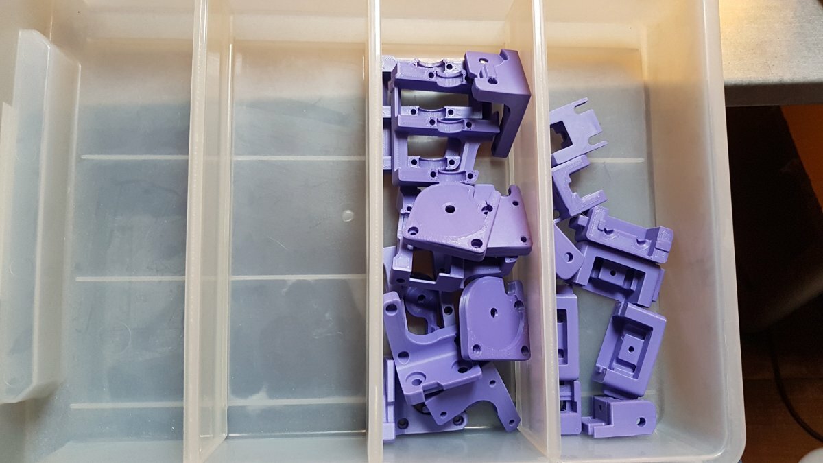

i organised my printed part in plastic boxes (i have tons of them empty).As you can see, i just started to print...
about my warping problem : 2 plates perfectly printed then... warp. don't know why 😕
I print at 250°c, bed is 100°c, on buildtak.
I will try the ABS juice (ABS piece dissolved in aceton, then brush plate with the mixture before print) then skirt around pieces if this doesn't work.
