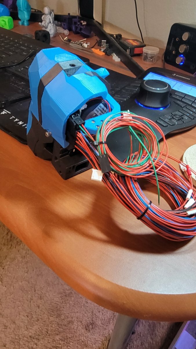

Well it is printing after a long troubleshooting session, rebuilding, rewiring, recrimping, rethinking, regressing, rehoming - you get the drift. Installed the octopus board and everything seemed to be going good. STEPPER_BUZ worked as expected, QUERY_ENSTOPS work as expected.
Safely homed
Z_TILT_CALIBRATE worked like expected.
BED_MESH_CALIBRATE: Started getting errors - Endstop triggered prior to movement. Now this sounds familiar - my reason I swapped out the boards.  Eventually got a bed mesh.
Extruder Rotation Distance calibrated
Time for a test cube - NOT
X-Stop stayed TRIGGERED, could not home X.
After a lot of choice GOM words, and hours of wasted time, it finally dawned - maybe not a Klipper issue - maybe electronics.

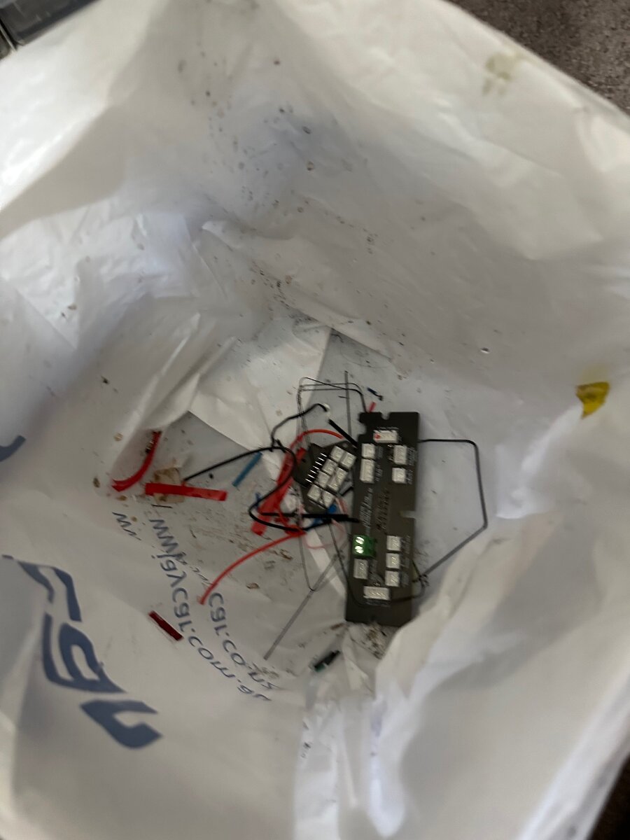

Traced the fault to a short on the Toolhead PCB. (Maybe @Buurman, you had something with your original thought of too many electronics....)
It is now where it belongs - in the bin!

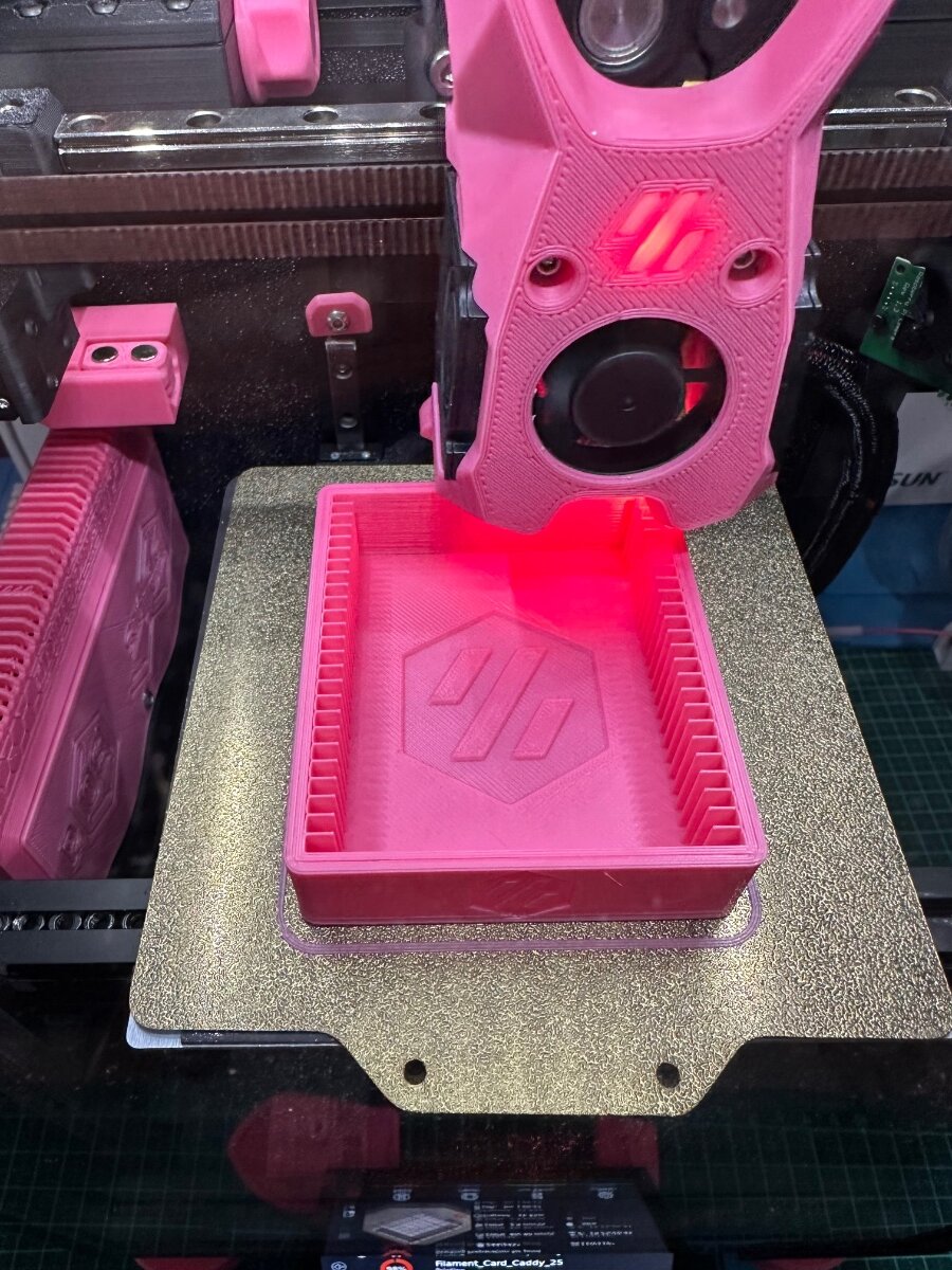

Rewired the toolhead, started all the tests and finally got a test tube printed.
Oh, that little malformed cube was because I used 16 tooth steppers on a GT2 belt but did not change rotation distance to compensate for that 😒
So how much of your spares stock-pile has this thing burnt through? That's two E3 minis and one toolhead PCB so far?
E3mini still operational. Will they ever be used - Don't think so unless I want to revive my Ender 3. However the Voron bug is too strong.
The toolhead PCB was the cause of all the headaches all along

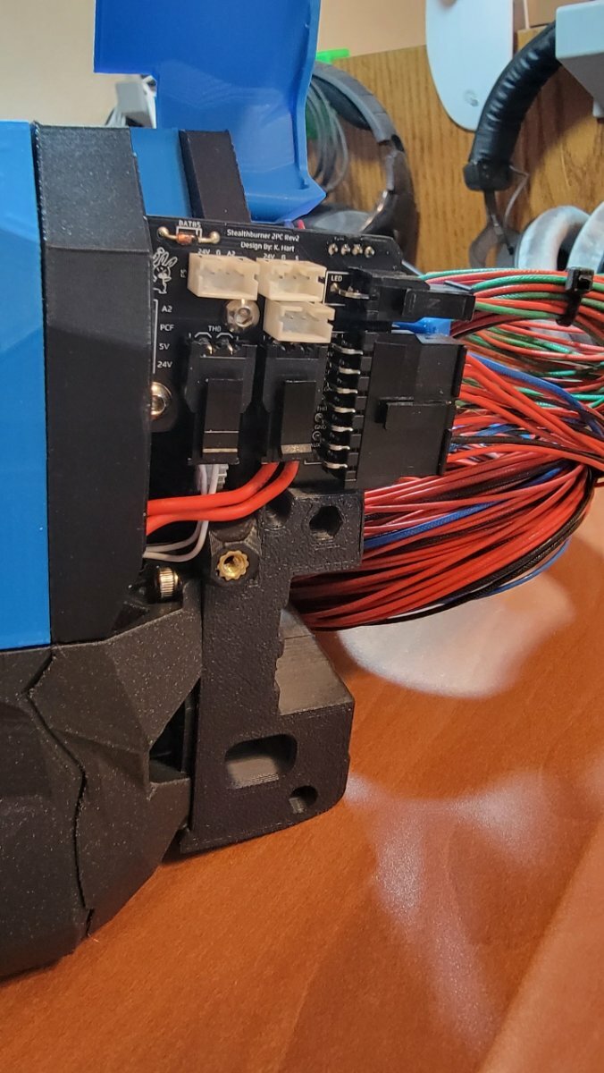

LOL, now you're all making me nervous. I have a nice set of purple(!) hartk 2-piece tool head boards waiting for me to install. I also grabbed--perhaps prematurely--the LDO electronics bay breakout board. More wire on order. I was planning on rewiring the gantry when I had it all torn apart for the Tap update. I guess I can hit the boards with the multimeter to verify everything is connecting to where I expect...

I'm sure you should be fine. All the other toolbars - genuine Hartk toolhead and breakout boards work well. The one I had for this V0 was a left over board that was ordered as a "just in case" PCB for the previous build. Ordered through Aliexpress from an unknown store - came unbranded and looked CHEAP - which it was. Lesson learned. Sometimes I just don't take my own advice.
Buy cheap - Pay more! So don't do it

Cool. I just need to figure out exactly what connections to make.
My envisioned setup will be hartk PCB on SB -> LDO Breakout -> Octopus.
Most of them seem straighword-ish. It's mainly the LEDs & 5V I'm currently a bit confused on at the LDO PCB end. I'm also now starting to strongly consider the ERCF-style filament sensor in the toolhead instead of the RefillPlease one I have on the back of the printer now that I've found there are mods for that SB part to incorporate one; so that adds the Aux line.
The V0 PCB did not have a 5V or LED input, thus had to run wires to the Octopus. Funnily, the breakout board that came with it had all sorts of connectors fitted. (5V and LED included)

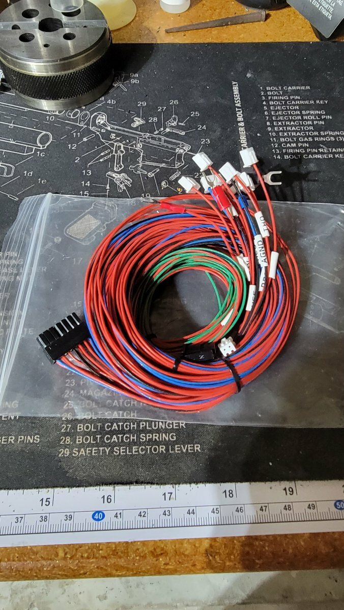

Upon doing further research, I'm thinking I might punt and buy the LDO harness. Reading further on hartk's Github it sounds like that just works. I'll need to set a fan to 5V and attach that to the CT input, which works fie for me as my chamber thermistor isn't on my tool head. Then simply run the LEDs and possible filament sensor separately. But enough hijacking your thread.
Can't fault that thinking. AS said - learned my lesson by trying to save a few bucks.

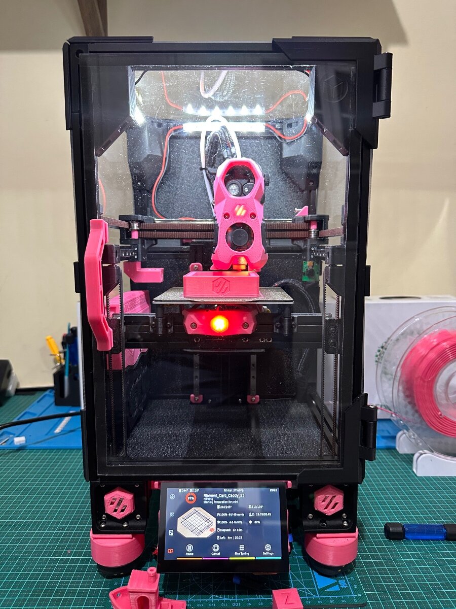

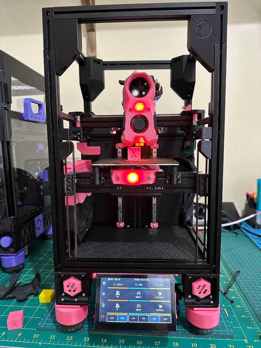

Build is complete.
Tuning done as per Andrew Ellis guide - first layer looking good.
Happy with how it is printing.
Thanks for following along.
Next up - Trident 250mm in Grey and Silver,  Frombot kit with Voron TAP.

Dude, I absolutely love the way it looks, such good choices, ok, pink is a bold step, but I love it!
Maybe my 2 year old daughter is having influence on me somehow... 😉
But... have to rebuild mine now... I cant life with it, knowing how it could be.. so.. thanks!! f*ckin DutchAussies... 😛
