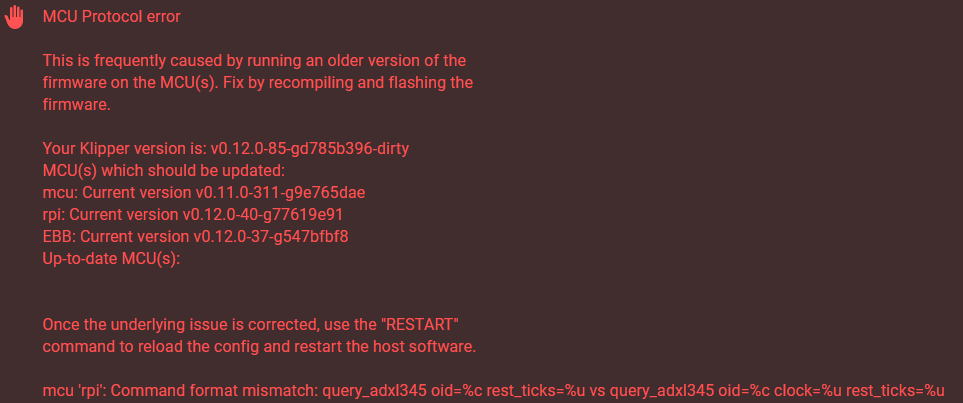

Just received the nofificattion for your post. Minutes after I started to do some searching about firmware updates.
Some message similar to this one ?
Have this on both the 0.2 and the 2.4

Shouldn't the EBB and SB2209 be updatable over CANBUS ?

Yes, that is the error I got as well, both the mainboard and the EBB devices need the newest version of Klipper installed. Can be flashed over Canbus if Katapult is installed. I've used this link to reflash both devices.
https://github.com/Esoterical/voron_canbus/tree/main/mainboard_flashing/common_hardware
One way to find out if you've enabled Katapult previously is to press the reset button twice on your mainboard, ssh into the device do the lsusb command and you should see your mainboard ST32 number come up.
Canbus with Katapult Update Guide
Edited by PFarm
The weird thing is that the error disappeared after flashing just the "linux firmware" on the RasPi... Was about to reflash everything... Klipper didn't complain anymore about the EBB36. Seems to be related with some recent changes in the accelerometer communication protocol (?). It's illogical Klipper now doesn't complain about the EBB36, as it seems it's about the ADXL, and there's one on the EBB. Looking at the Kliper change history didn't help due to a massive lack of knowledge.

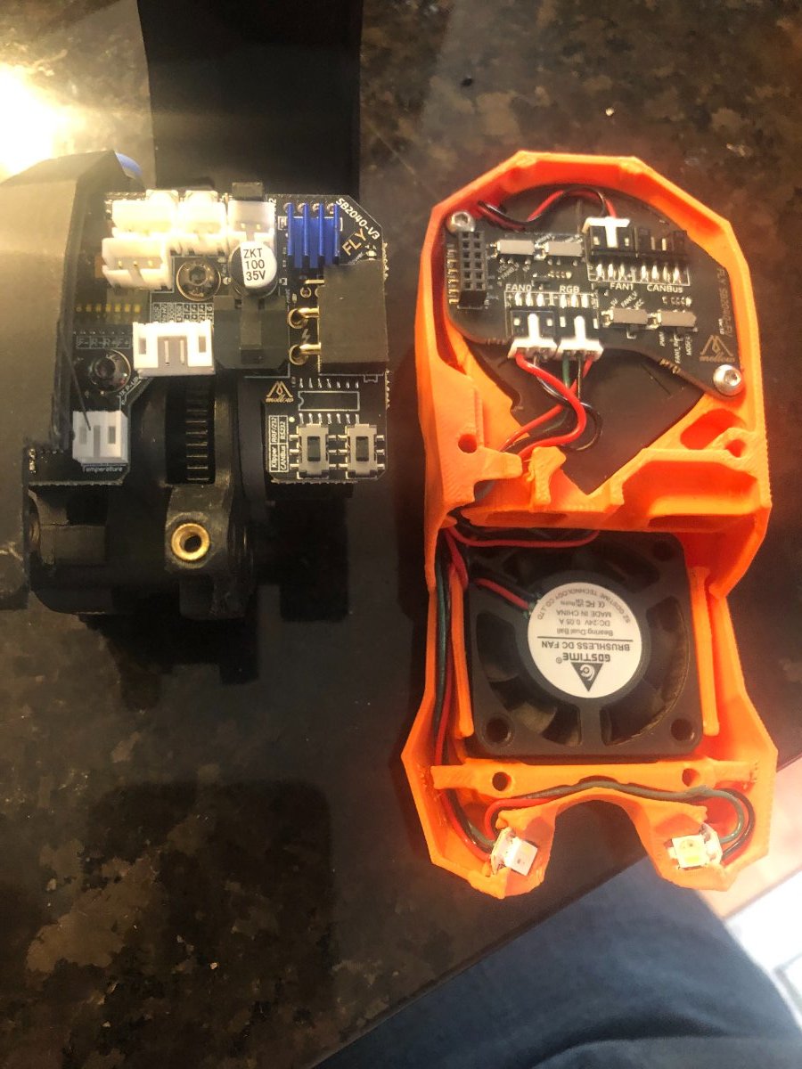

  The BTT SB2209 for some reason the cooling fan circuit quit working so I'm trying to replace any BTT products with the Mellow ones. The Milo Millenium Mill I'm building also uses a Mellow controller Mellow Fly CDY3, the VzBot uses a Mellow Super 8 I believe, you guys that built VzBot @mvdveer @Penatr8tor @TitusADuxass how was the experience with that board? If any of the BTT motherboards fail, I'd like to replace it with a Mellow board.

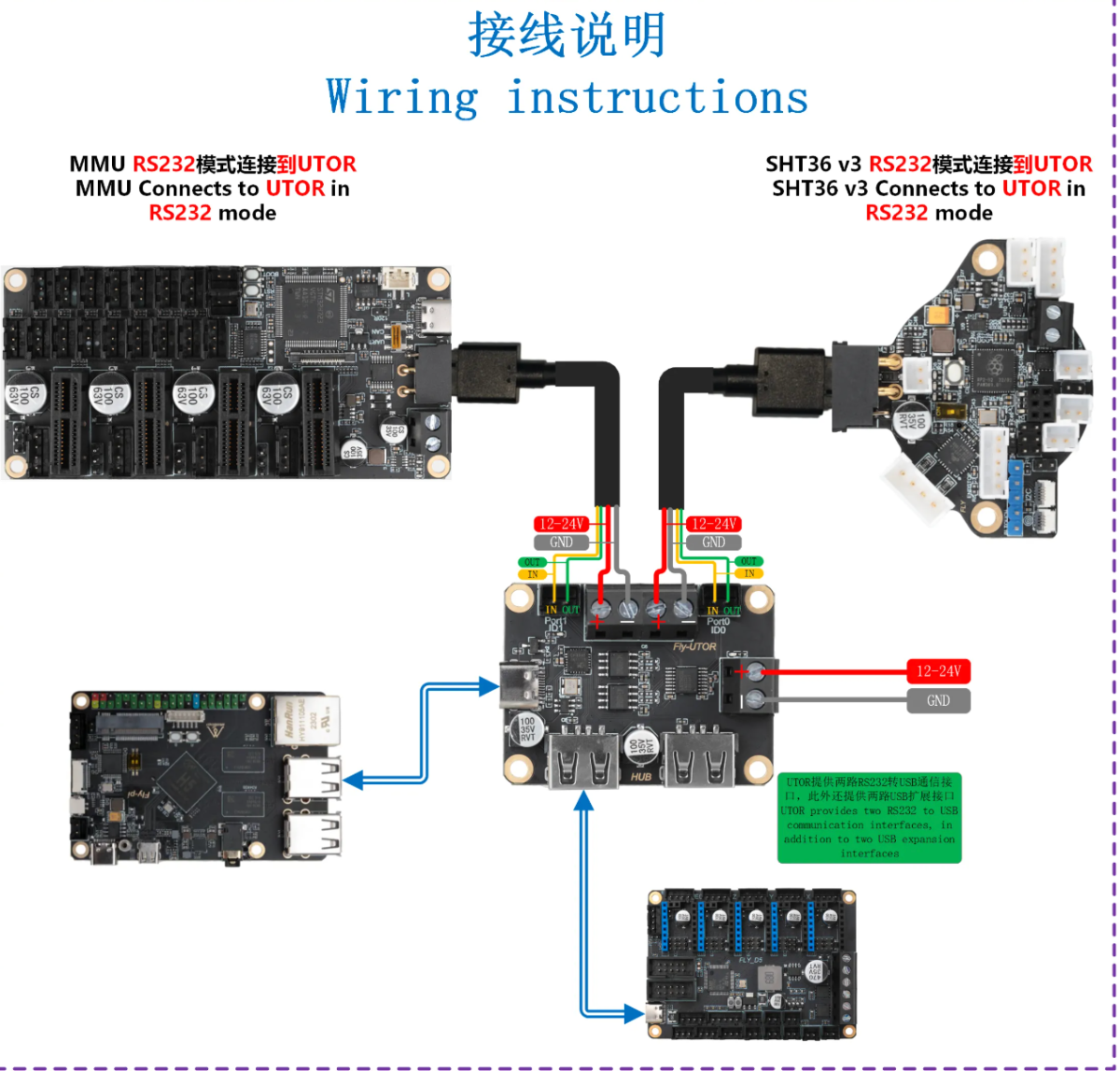

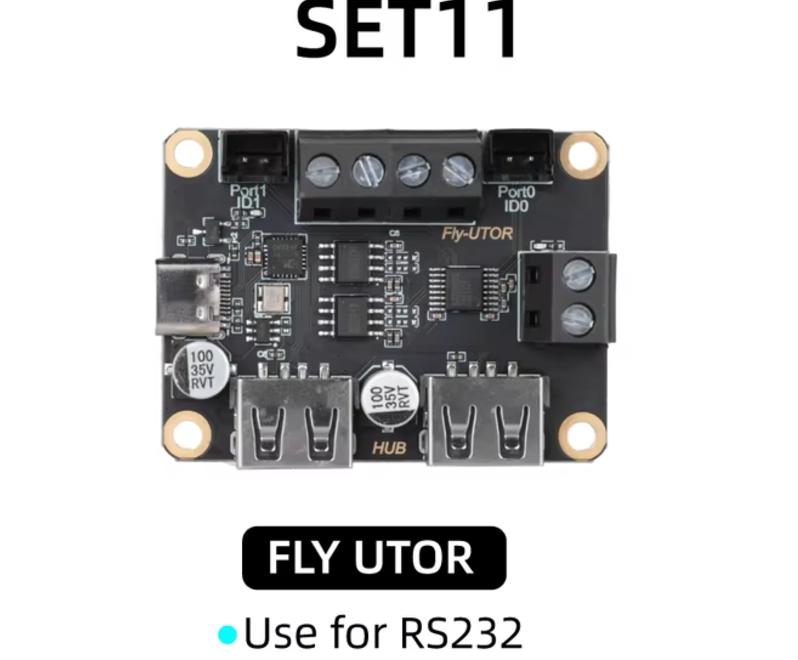

I installed updates for the Trident shortly after receiving the MCU read error. Thinking that the update caused the error I dove into some diagnostics, and I found that the issue is a 120-ohm resistor. It's a Mellow SB2040 V3 with dip switch 1 in the on position. It meters 60 ohms at the H/L connection. I can either purchase a replacement board or salvage the SB2040 with Mellow UTOR board to operate on RS232 (UART to USB). Does anyone have any experience with the UTOR? It's half the price of the replacement SB2040 v3 and have one coming. It uses the Canbus cable the H/L wires connect to the Port ID, and 24V is supplied to the board and distributed to the terminal beside the ports. A USB A to C cable it connected to the motherboard for communication.

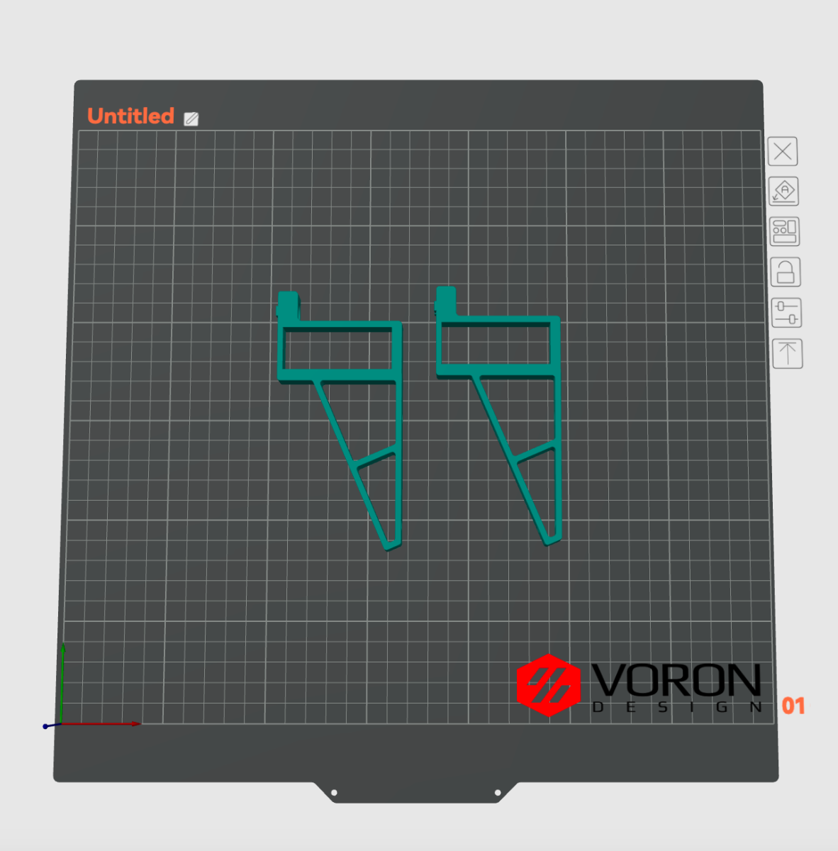

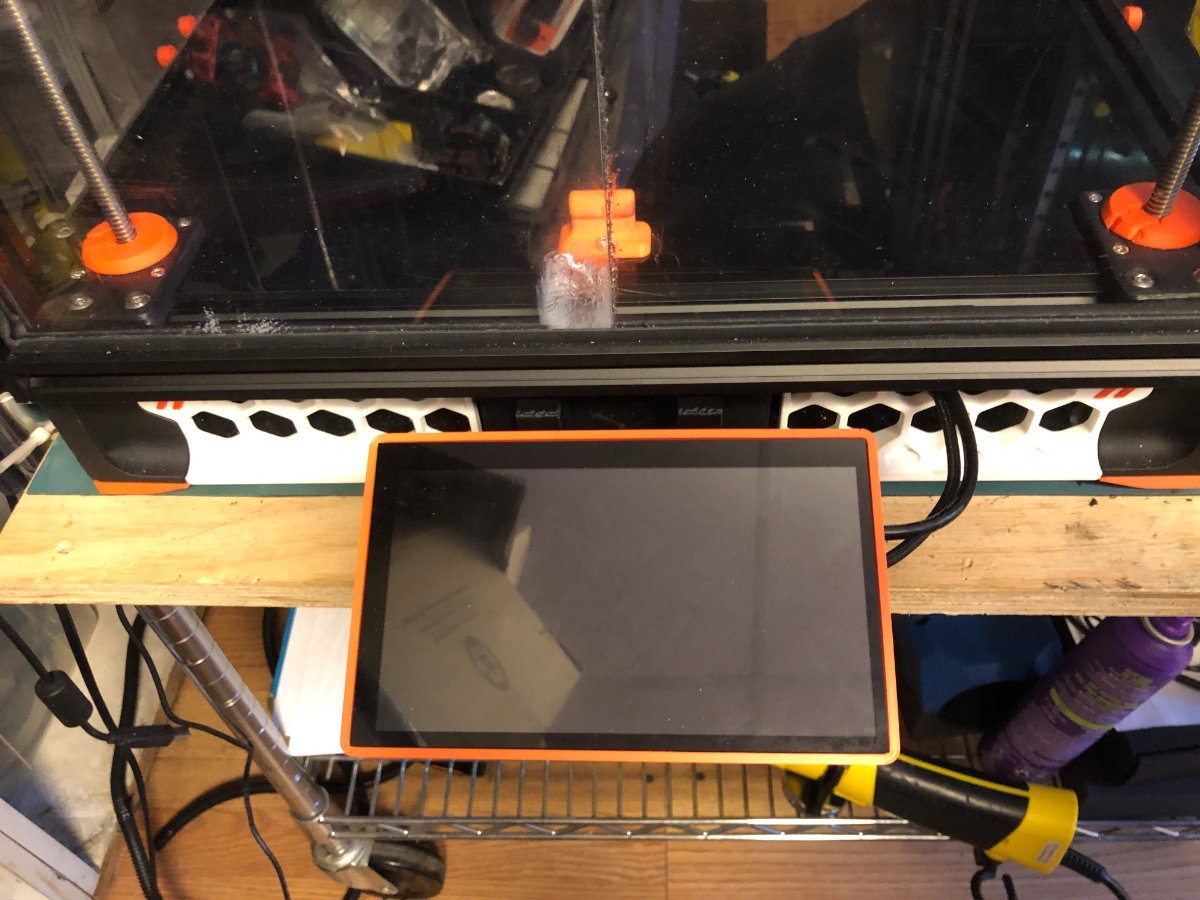

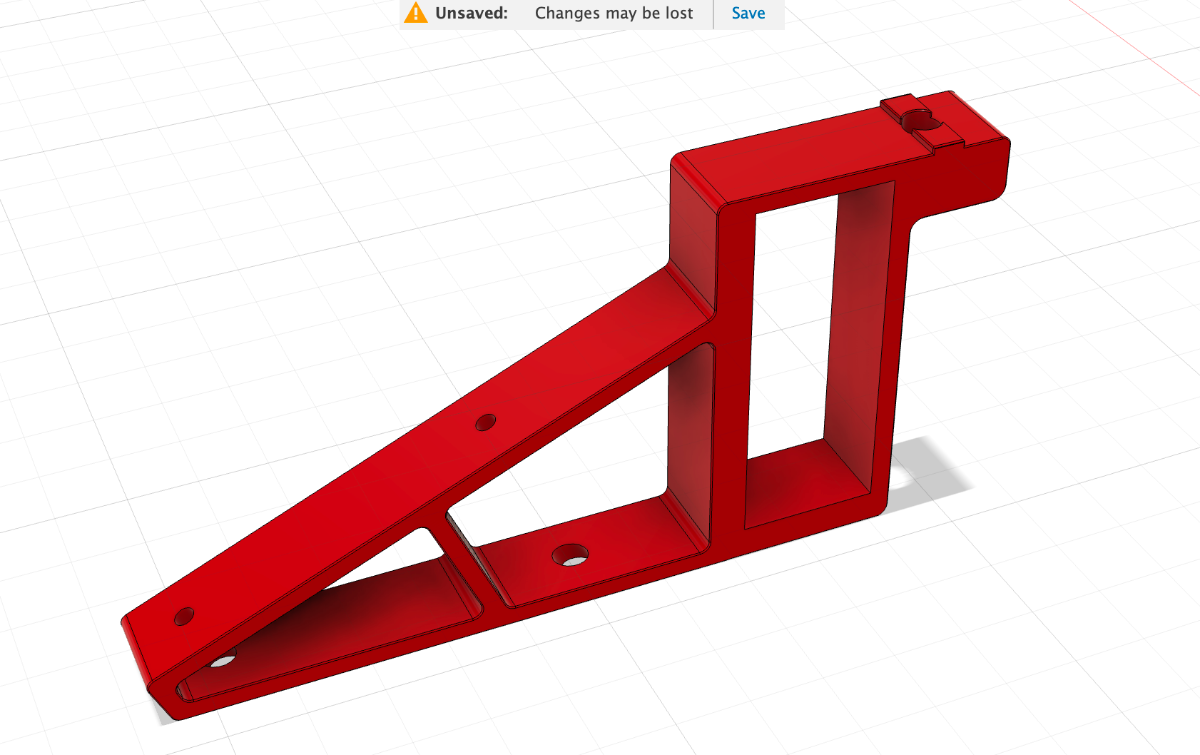

I couldn't find an STL for BTT HDMI 7" mount with the Clickly Clank door. I found one for the regular mounting of the screen to a Voron and luckily it had the CAD files available. I modified the mounting bracket to extend 25mm out from it original position. Will see how they fit after they've finished printing.

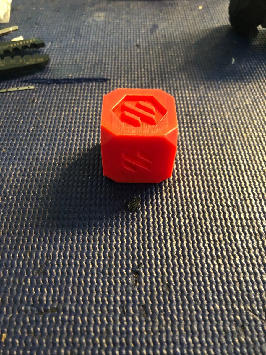

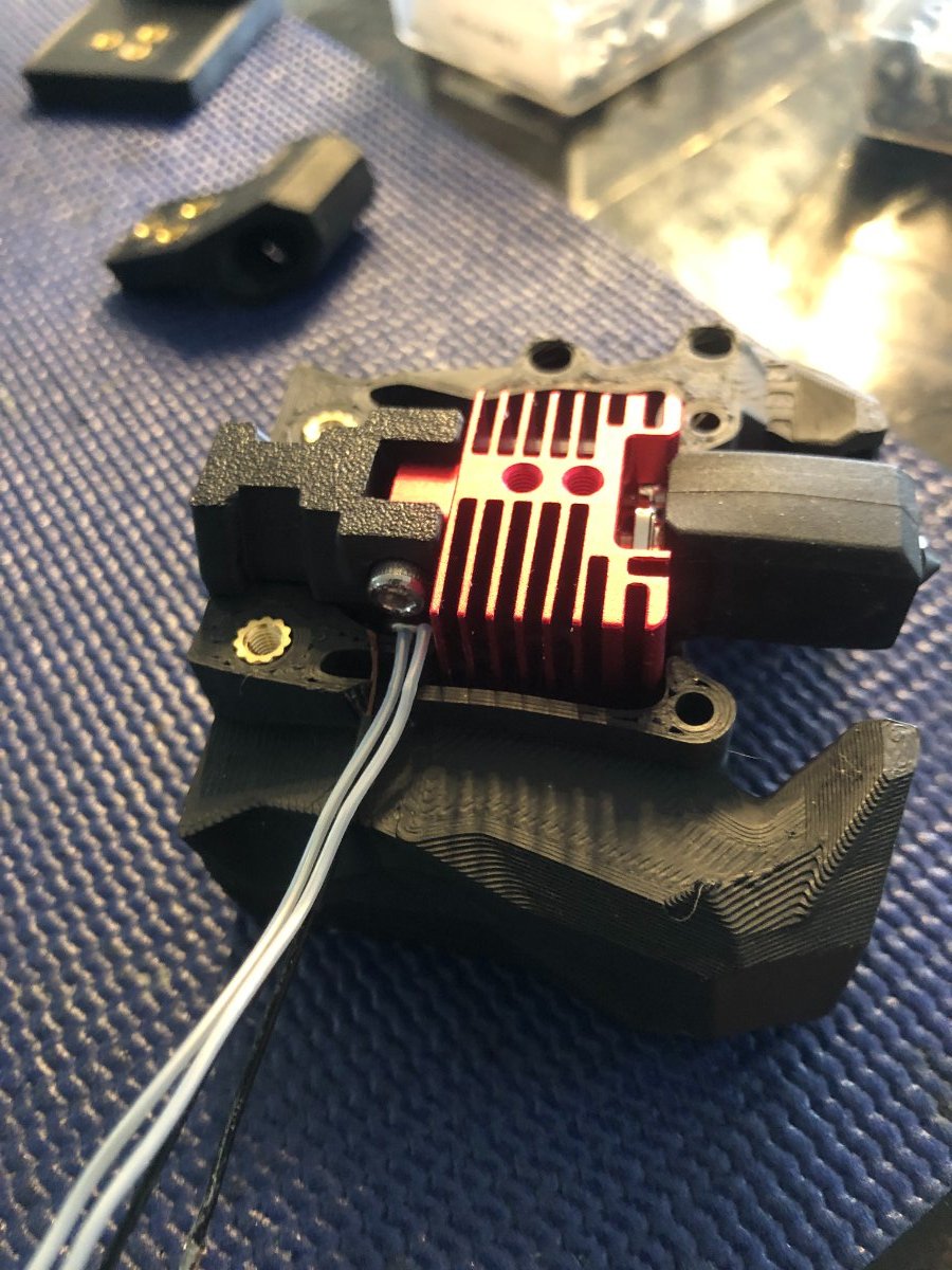

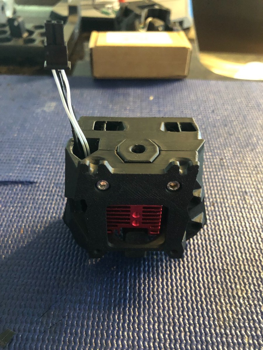

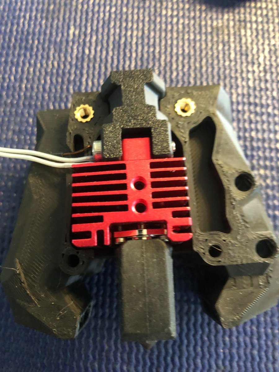

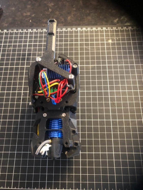

The Phaetus Dragon hotend gave up the ghost, so I decided to try an Aliexpress Bambulab X1 clone hotend Link. At these prices, I can buy 10 of these for the price of one Dragon hotend and shipping. Plus, I needed a hotend for the second Trident I'm building.
With a little wiring re-routing, so as not to have to lengthen the wires, they are just long enough to connect to the SB2040.
With a little bit of tuning for this hotend, prints come out pretty decent for a $15.00 hotend compared to a $110 one. You need to change the connector, though. A bonus is the quick ramp-up temperature and quick cool down, which helps with oozing. This is noticeable when you PID the extruder.
