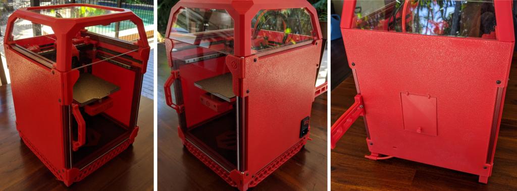

G'day, Dr Ghetto here coming to you with money saving tips from down under. Too tight to buy acryllic? Too lazy to cut, saw or otherwise manually fabricate panels for your cute little Voron 0? Well you're in luck. This mod is a set of printed panels, ghetto panels if you will. Buckle up bozos, deets to follow.
The right hand panel integrates the front door hinge mount. You don't need to print any corner pieces at all. A side panel is 248 x 237mm so maybe you can print it on a 250. Do you feel lucky punk? The panels mount with two holes a side, so be sure to drop a nut from stock.
Word in the hood is you guys like it from the rear, so the back panel has a hatch to access the extruder. The stock spool holder fits with the back panel. If you printed the beta deck-panel-rear.stl then it blocks the ptfe tube. The Doctor shivved that sheet until it fit, because that's how we roll in the ghetto. Get yerself some hot foot-filament-guide.stl for a modded rear foot which grasps that sweet tube like Mrs Ghetto, know what I'm sayin'.

Good to go with 0.6mm nozzle, 0.3 layer height. The panels print outside down. This works real nice on textured surfaces. If you're using a smooth surface, maybe you wanna use a nice top pattern, or no bottom layers for dat exposed infill look. Yeah baby.
Plastic? The ghetto abides. Always gonna be that guy that prints it in PEEK but anything you can print without major warp is ghetto approved. After that, it's a bling thing. Show us what ya got!

The mount holes are slotted to deal with ABS shrink but but shrink is bad for hinge alignment. Like duct tape on your AK, the ghetto has your back with remixes of the front right panel hinges panel_hinge_bottom.stl and panel_hinge_top.stl designed to fit standard ABS shrink.
The right hand panel has two versions, panel_right_iec.stl has a cut-out for the commonly available* switched and fused IEC power inlet, part number JR-101-1FRS. These are like eight bucks down under and they're officially ghetto approved. This part is for a 1mm (metal) panel so some silicone sealant is advised. As the hacker sage Naomi Wu once said, you can never have too much silicone.
