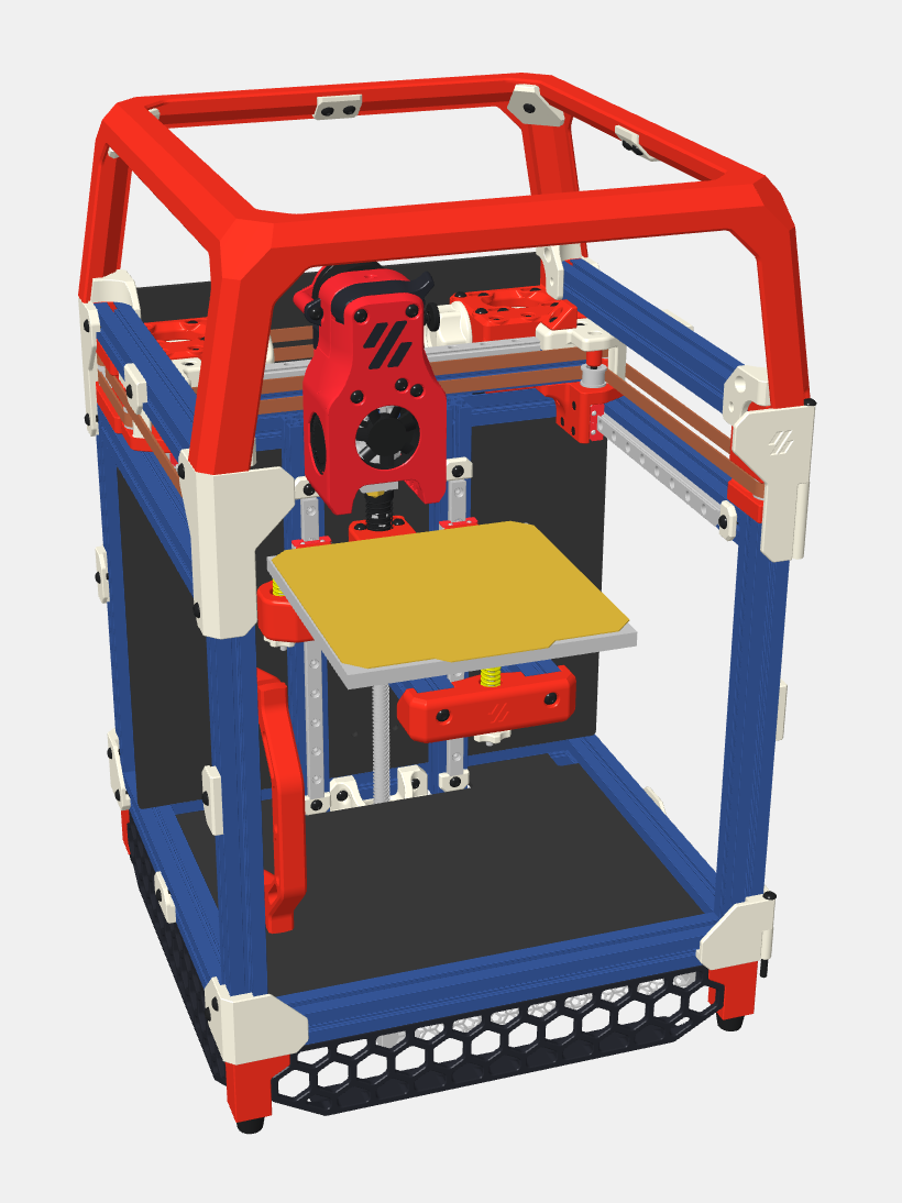

Yes, so colours. I hadn't thought about much, if at all. But you folks are really creative with colour choices. Then I found the Colour Configurator. Wow. So I've now bought some eSun ABS+ Fire Engine Red and Natural, as well as the black and Sunlu blue. Thinking something like:
But with a blue top hat and black tensioner/nuts. Now having fun.😊

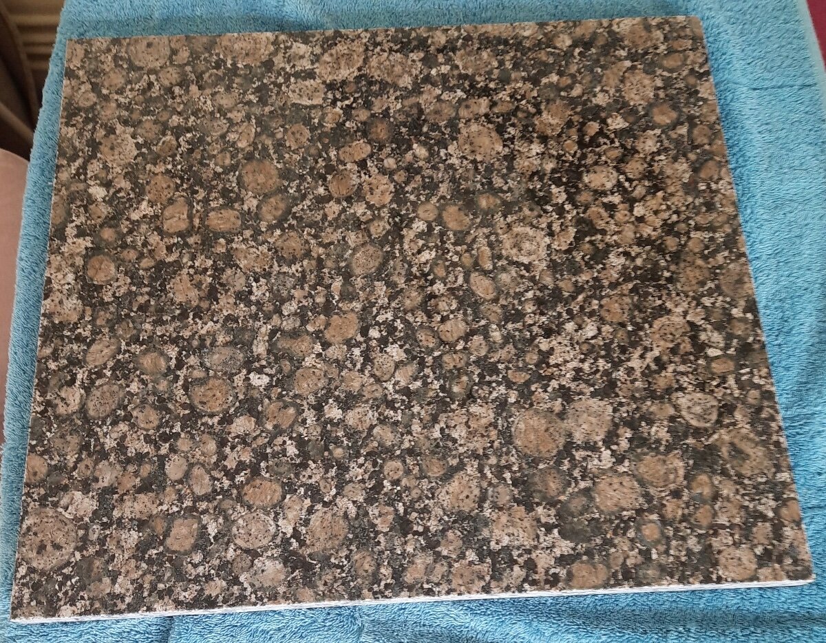

And then, I was looking to get a flat surface to build it on. I had ordered a tempered glass 6mm thick shelf about the right size, but it came smashed to bits - really smashed. It was only 3mm thick, obviously not tempered and downright dangerous to have in the home. Got a refund, eventually.
Then started think about granite, maybe a chopping board, and then the nice Mr Google pointed me at a granite worktop stone mason about 10 miles from me. I messaged them and explained my inner flat surface desires and dimensional requirements. They said "pop along and we'll probably find something in our skip you can have" And I did just that yesterday and came home with this:
It's Baltic Brown granite, 410 x 460 x 25 mm, smooth and flat as something that's really quite smooth and flat - they gave it to me  😀
Some days really do work out better than others.
Love the color scheme. But then I am partial to Blue and Red.
Great score on the granite slab! That will get you a nice surface to square the frame up on.

Couldn't believe my luck with the granite. The guy, disdainfully dismissed a quart offset as "man made", "but this", he said stroking it quite affectionately, "is how it came out of the earth!". Big hand shakes.
😆 Well, quartz countertops ARE man made. For our purposes it doesn't matter which. For counters, well, whichever takes your fancy I guess. My own counters are granite and lovely. His reaction is quite amusing.

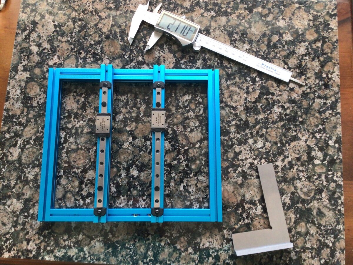

Anyway, I've printed all the bits for the Voron now, printed all the bits for the Lack Enclosure too, and am now going through the manual and inserting as many heat insets as I can before I get too bored - also good way to review the build. Linear rails are all nicely cleaned and greased, so let the real fun commence. I'm going to take it at a walking pace and hopefully enjoy the journey.

So far so good. I found the jigs I'd printed a bit vague on the z axis positioning, so spent a long time with callipers to get the distancing accurate. The Kirigami bed mount is next, probably early next week. I have lined it up and the all the holes do seem to be in line. Those M2 x 4 bolts are tiny, and looks like it might an interesting struggle to get 8 of them in. The coating on the bed has made the holes a bit tight, so maybe loosen them up first. All hints welcome!
