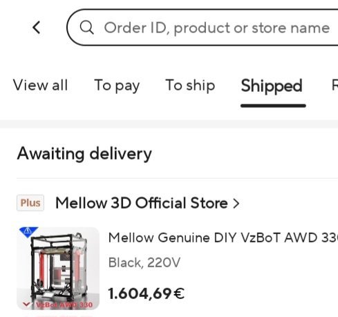

The kit from Mellow has been ordered and is awaiting dispatch.

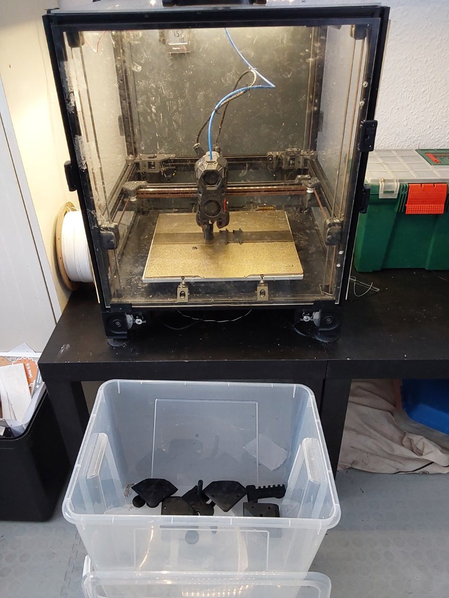

So I thought I'd make a start printing the parts with my trusty (yes I know its dirty) v2.4
I'm using Overture ABS, black for the main items and probably black for the accent parts - although I maybe a bit boring and go for red accents.

this is without the shipping right? I remember 400 more for shipping. So that's a nice round number... one year  month less money for pursuing a 'wife'
No, that's the end price that I paid.

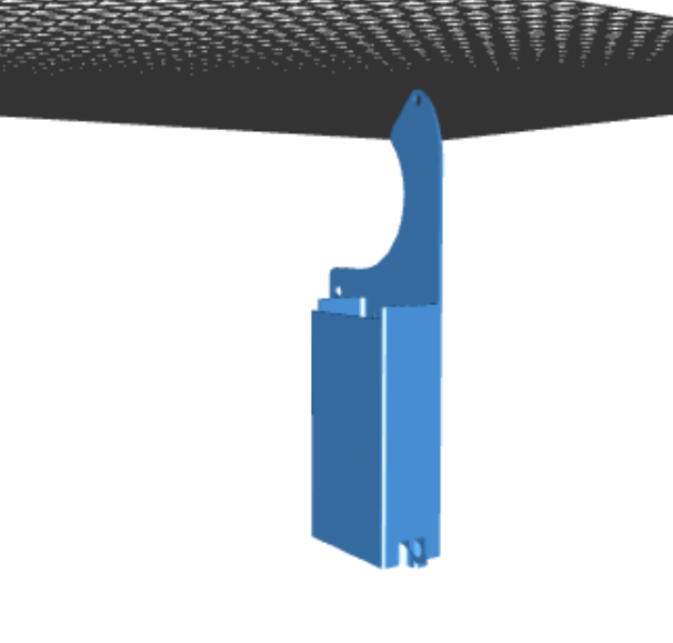

The only one that's giving me grief is the lower part of the RSCS. No matter what I try, I simply cannot get enough part cooling for the upper blade of this. As a result it gets very blobby and mishapen. I'm going to look into Orca and see if I can set the print speed for the last bit.

Back on topic - I've done a bit of research. In Orca preview I can identify the starting point (layer) where I want the print to slow down, then right click and add a custom gcode M220 S10 (for 10% of the original speed). The M220 applies to all motors (X, Y, Zs & E).
