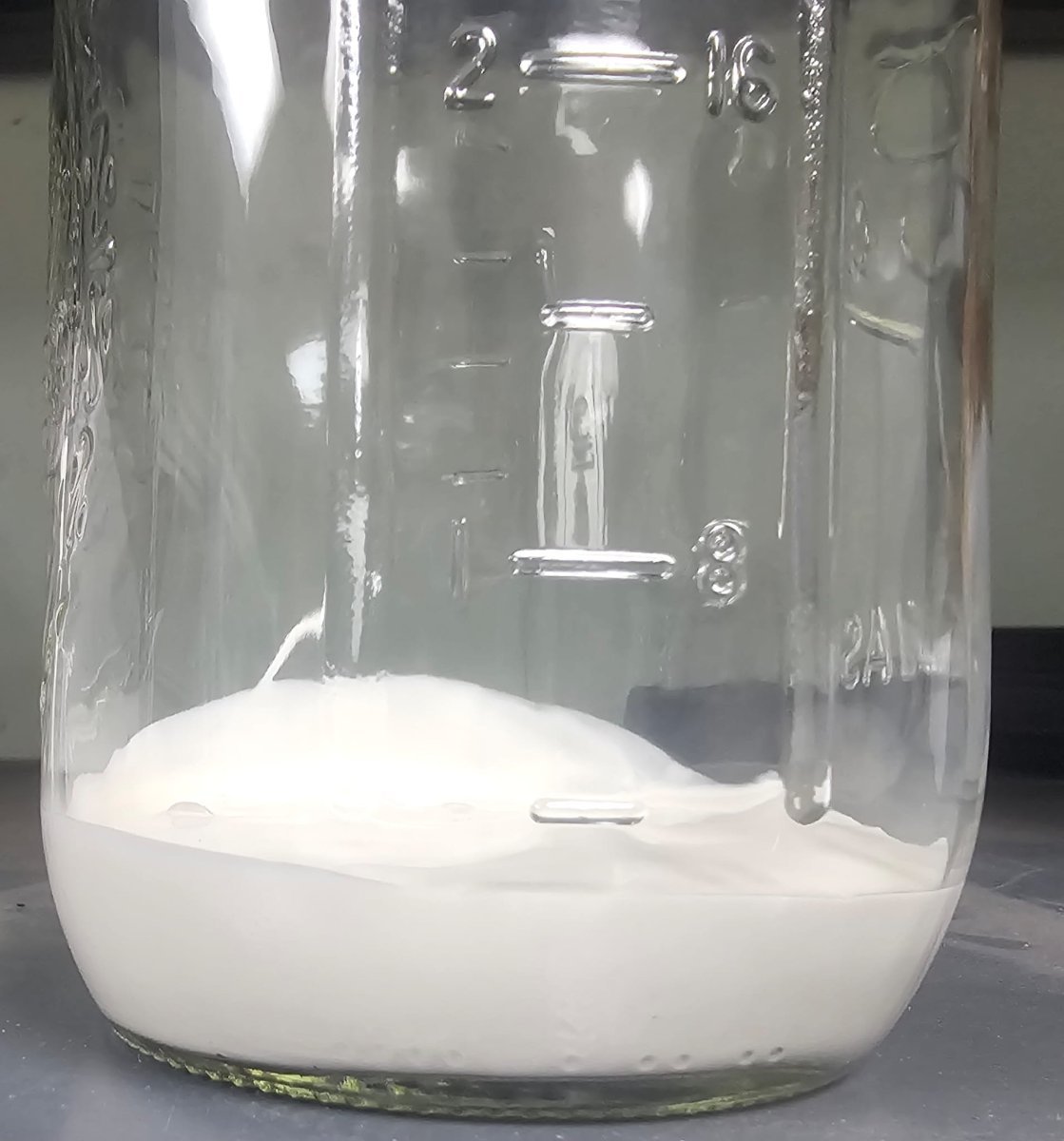

If you want to use glue but also want a smooth finish try using PVA wood glue diluted 25/75 (ish) water and apply it with a foam brush.  It gives god adhesion with the thicker snot from glue sticks.

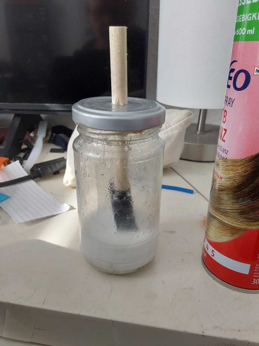

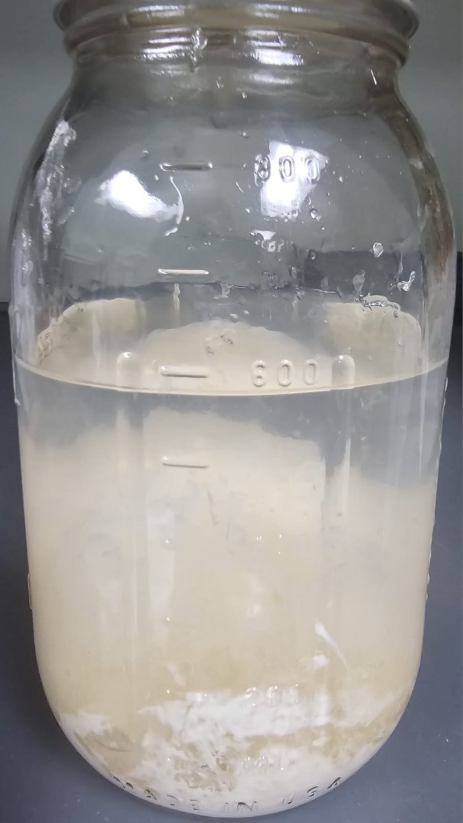

This is my glue jar.

I tried a few things and what I like now is white pva glue diluted in 99% ipa. dries fast and super thin.

2 hours ago, TitusADuxass said:
PVA is water based, so it's never going to be a good mix with IPA.

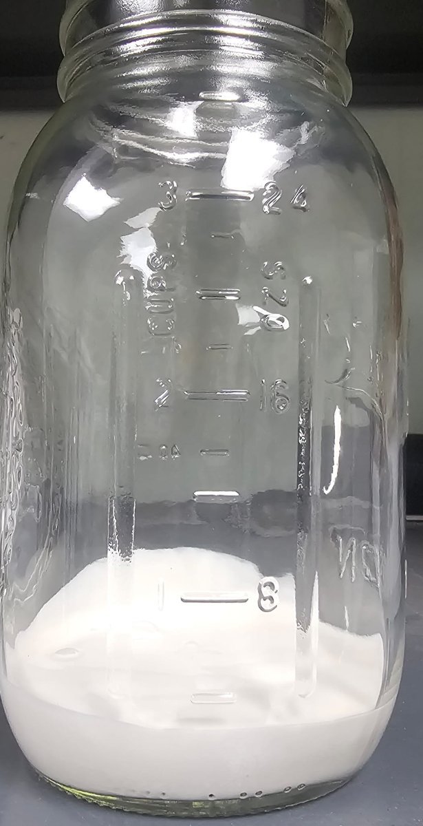

I guesstimate mine to be 10-12% glue 88-90ish water - YMMV.

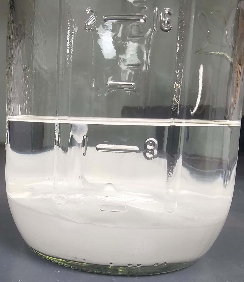

I did say that it was a guesstimate. I really can't be anymore precise. My glue jar is a bit like sour dough starter bottle - it's a living thing that I feed with glue from time to time.
I cannot lay claim to this technique, I got the tip from someone (WhiskyBlackSmith) on discord.
Yeah, that is what I have being doing on my own jar, since the beggining I have being adding glue, like you said a sour dough hahahah, I should have restarted from the beginning and added water until I was satisfied, it would be faster to find a good compromise, but yeah I understand your feeling all too well, I think that a 75 glue and 25 water with a good shake would be a perfect combination, but at same time I don't want to lose all the glue I already invested, sunk cust fallacy as it's best haha.
