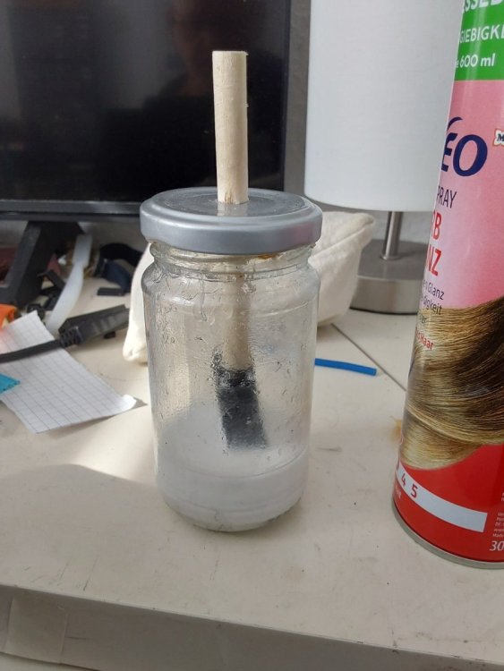

If you want to use glue but also want a smooth finish try using PVA wood glue diluted 25/75 (ish) water and apply it with a foam brush.  It gives god adhesion with the thicker snot from glue sticks.
This is my glue jar.
sorry for taking so long to answer, i was traveling, i really appreciate your idea, and i will definitely try, better than getting a huge cylinder over the entire bed haha
