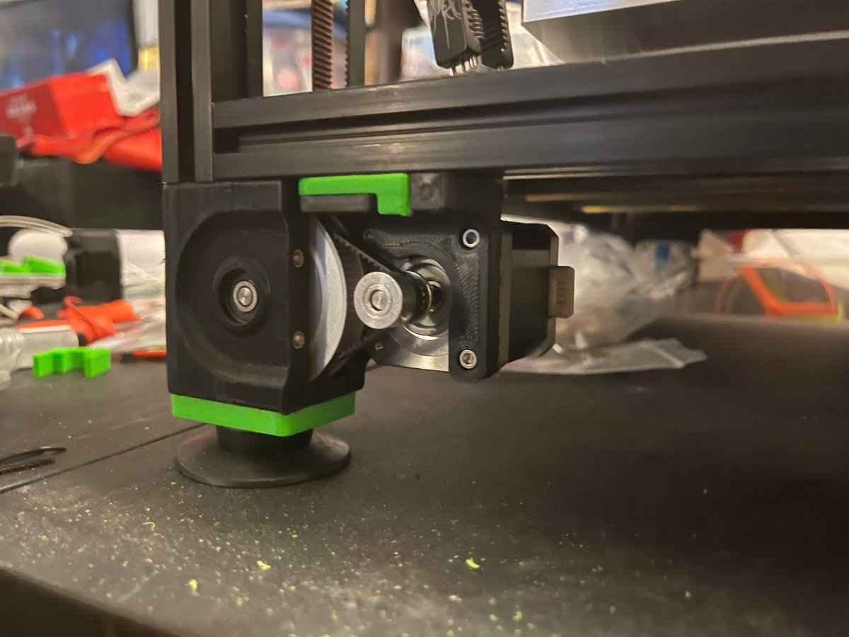

Printing and assembling the Z drive units went smooth. no issues or work arounds to figure out.
Up next is the AB drive units.. i made some mistakes here.. all my own fault.
