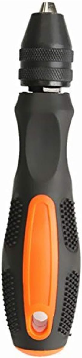

A very handy tool indeed, very useful for those more delicate jobs such as reaming or drilling out the smaller size holes. I usually clean out my 3mm inserts with a tap after pressing them in with the soldering iron. You can also find them on places like Ali Express, Temu etc.

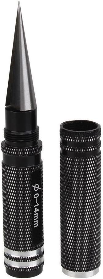

13 hours ago, Wannabe said:
Yet another useful tool.
https://www.amazon.com/Hobbypark-0-14mm-Puncher-Reamer-Drills/dp/B01EIH573K
Also available from Ali Express, Temu.
Yup, and if you go back one page, you'll find that I already posted this tool last October. 😄

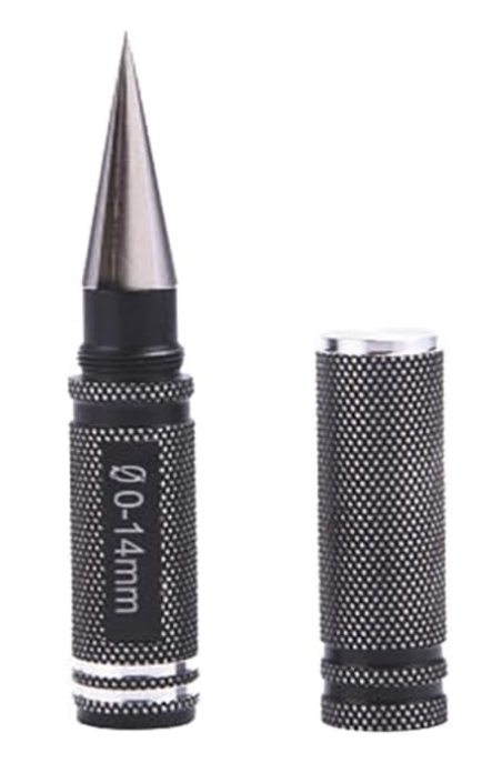

I will say this about those tools though... I have two of them, one has about 2-3 degrees more taper than the other one. So, if you are in the market... The tool with a bit less taper works better i.e. removes more material per twist.
This is the more taper one - Doesn't work that well for 3D printed holes.
This is the less taper one - Better for 3D printed holes.
