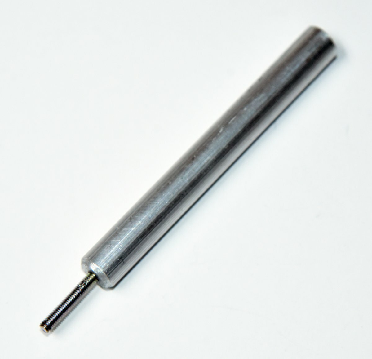

The missing tool... I have worked with threaded metal inserts for years. The one thing I have found indispensable is a simple to make tool that allows you to pull inserts out of plastic and help with getting them started to install.
The one shown is for 3mm inserts. I used an aluminum rod, drilled and tapped a hole on the end, and cut the head off a 3mm screw to put in the end. I thread the insert on a few turns and place the insert at the hole to be "threaded". I use a old Weller soldering iron with a conical tip, and finally the non-blade end of a large hobby knife (1/2" round flat surface) to flatten out any plastic ridge formed.  I also heat up inserts and then use the tool to pull out ones to recycle (I know, cheap parts but I don't like to waste them).

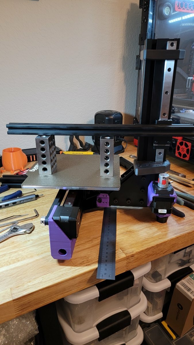

I would add 123 Blocks to the list. 123 blocks are, as the name implies, 1"x2"x3" in size (metric version is 25x50x75mm I believe).
  • Size within +/- .0001"
  • Flatness and parallelism within .0001"
  • Pairs are matched to a tolerance of 0.0001"
  • Squareness on all sides is 0.0003" per inch
There's 3/8" dia thru holes in them and 5 of them are threaded with 3/8-16 threads. This lets to attach two or more of them of them together to make a right angle square, riser, etc.
Amazon has them for around $20-$40 - 123 Blocks
Below you can see how I used them to perfectly align the cantilevered X Axis arm to the Z Axis slide.
They also work great for frame building. Clamp one to the inside corner of two extrusions and torque down the screws to make a perfectly square corner. Way easier than using a square.

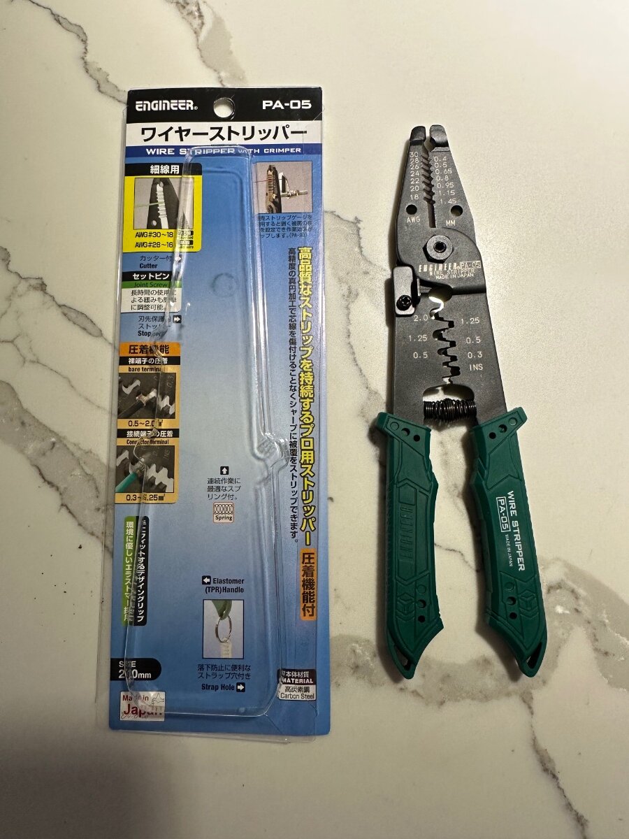

After watching Steve's build on the TAP, I decided to purchase a set of the Engineer Pa-06 wire strippers. Could not find any that would deliver within the time frame requested but got a set of the Engineer PA05 - Wire strippers with integrated crimper.
Strips 18 - 30 AWG (1.45 - 0.4mm) and crimps 0.3 - 1.25mm connector terminals and 0.5 - 2.00mm bare terminals
And as per package and tool - made in Japan, not Taiwan. Maybe I will yet to come to enjoy crimping.image.thumb.jpeg.c7ba9c3643590cef97fb294302ca6ac5.jpeg

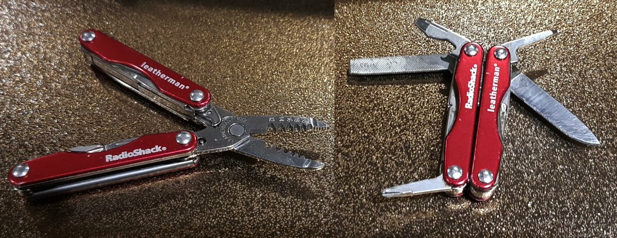

9 hours ago, atrushing said:
I got them back when Radio Shack was still a thing so I hope the quality has held up with the newer ones.
Yep, Got a pair back in 2009-ish. Still use them today but most of the time I use either one like this.
