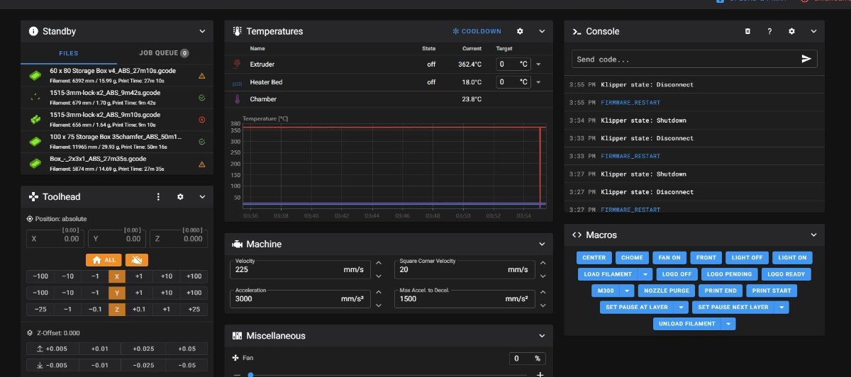

Okay, on a hunch, I set my max temperature to 370 (from 270) in printer.cfg and klipper dashboard stays up, and shows my hotend at 362 C*. It's actually at room temperature. Is that a pullup resistor adjustment I need to make?
