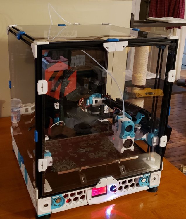

I had very little trouble, considering it was my first total build. I'm just having a tough time getting used to Klipper. I never used it before. I hit a bump in the road with my XY endstops and getting my z motors going in the proper direction, but this community straightened me right out. I've printed nothing but ASA on it and the quality is really impressive, compared to my other printers. I got exactly the same kit and hotend as Keppdogg for my 2.4. Mine didn't have the logo on the PEI sheet, though. 😉

I actually fixed my problem. It seems to have been my XY belt tensions. I loosened them and then found a frequency analyzer app. I tightened them to 110hz according to the voron documentation.
Another big fix was adding the bed mesh probe operation in Mainsail. I now have a specific mesh for PLA. I will create other meshes for ASA and PETG. But the software now adjusts the print head height  during its printing operations. My first layers seem to stick a lot better with the mesh taken into account.
I got the FYSETC kit and it was a snap to put together. I did replace the extruder motor with an LDO motor, but the kit motor worked fine.  I got the printed parts from makerPanda and is was nice but not the same quality as the parts I got from PIF.
Did I mention the FYSETC 2.4 shipped from the US?
