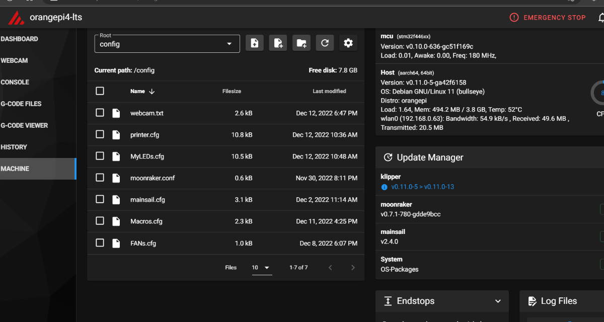

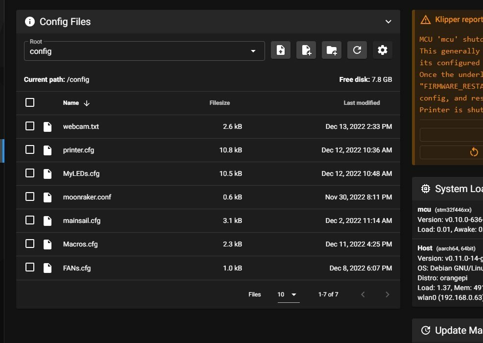

You are correct you need a "webcam.txt" file in the klipper config directory. Everything is commented out as most stuff just sits at defaults. The most I've got is a:
camera="raspi"
line in the file as I am using the raspberry PI camera, but if it was a USB camera changing the line to camera="usb" should work. Having said that the default is "auto" so it should figure out for itself.

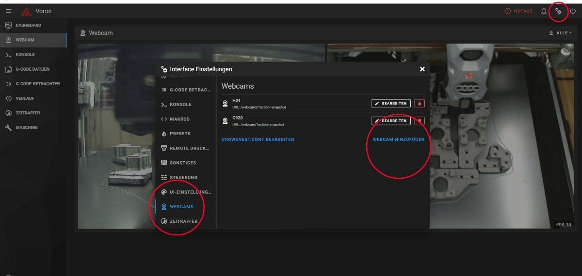

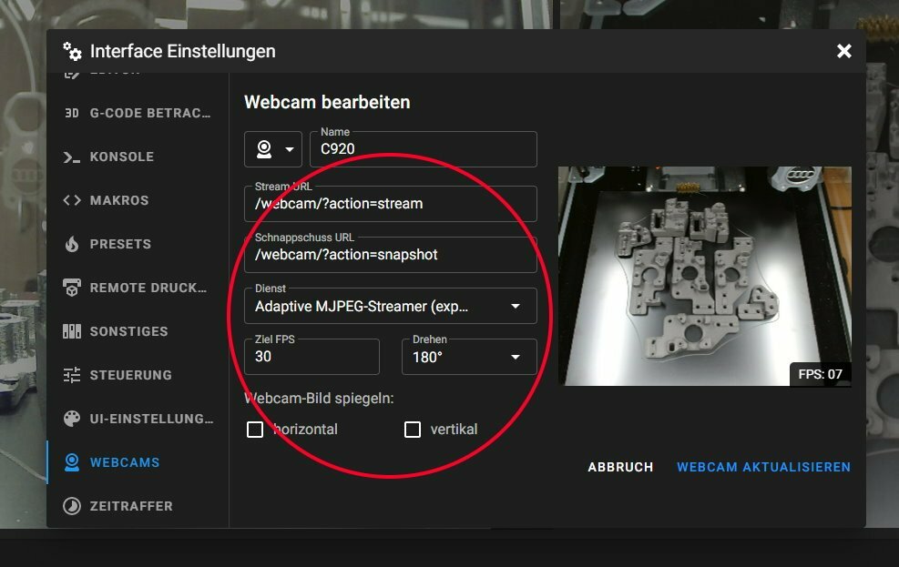

The first camera was relatively easy to set up. At the top right on the gears and then in the submenu "Webcams".
here I am then on "add webcam" and that's it. I have neither installed Crownest nor created a Webcam.txt. I even read somewhere that the instructions for Multicam are outdated and you no longer need the various Webcam.txt. I haven't tried it, I'm glad it works so I'll keep my hands off it.

My two cameras are also displayed multiple times via the SSH query, each with a different index. I think this comes from trying them on different USB ports on the Pi.
What you haven't told us yet: is a camera displayed in Mainsail's "webcam menu"? If not, have you tried adding one? If so, is the video format (MJPEG) correct?

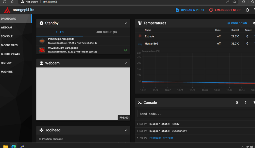

After plugging in the camera, I went to the mainsail webcam menu, and it showed no cameras.  It wasn't there automatically, so I added it, after which I started getting the white screen.  I originally tried the MJPEG option, and when that didn't work I tried the other three options.  MJPEG (experimental), and the other two.  I don't remember the names of the options.

Very strange, what changes on the display when changing the video codec or when the camera is unplugged? When unplugging, a "No Signal" should definitely come up
Is there a Crownest.config now?
In your picture above it looks like Crownest is not listed in the update manager, is that possible?

Crowsnest wouldn't install correctly,  so I removed it.
I get the same white screen regardless of what the cam is doing.
I still get the white screen whether the cam is plugged in or not.
I'm starting to think this issue has something to do with the orange pi, drivers, ports, or something else that would require a week of studying Linux command line stuff that looks like Klingon hieroglyphs.

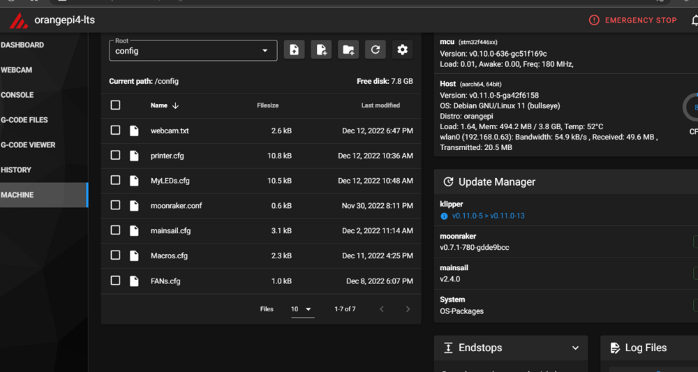

7 hours ago, claudermilk said:
I have the default webcam.txt file in my base Klipper config location. The only uncommented line is camera="auto". I just turned it on from within Mainsail and it just worked, just like @Stadi showed above.
Just to make sure i'm not making an incorrect assumption.  This:  "I have the default webcam.txt file in my base Klipper config location."
Means here?:

As already written, the webcam.txt was only relevant for the second camera, before that I didn't have it either. While googling for the Orange Pi, I read that it is a bit bitchy with installations and that many automatic installation scripts do not work. So you would have to get Crownest installed manually somehow. Unfortunately I can't tell you how to do that. But I think this is where the main problem lies. Or you can get a Raspberry Pi to avoid such problems in the future.

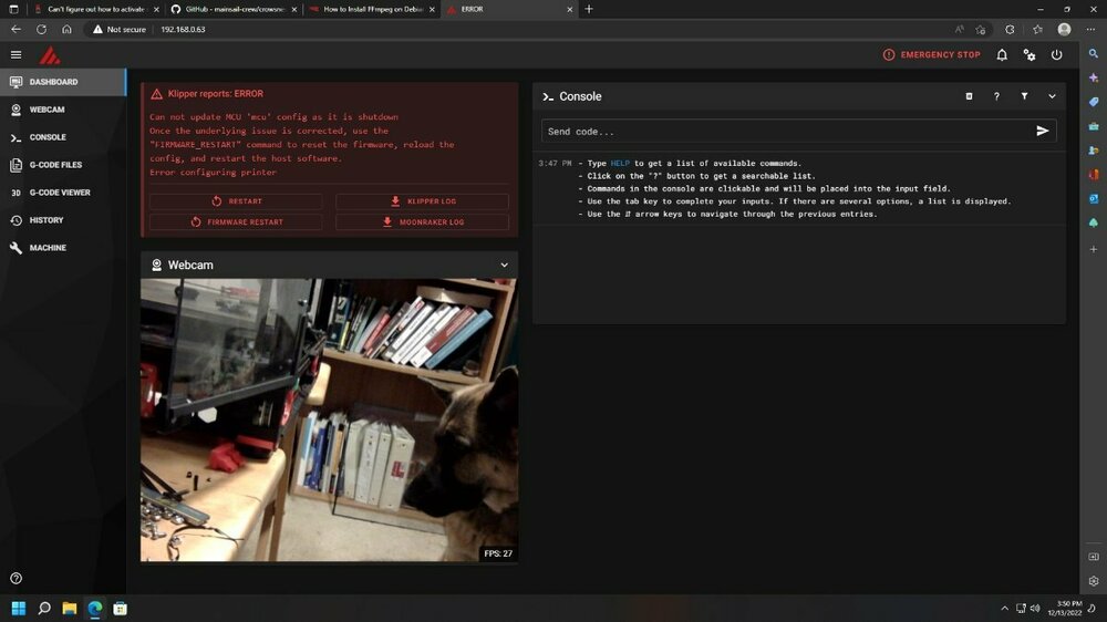

Ok.  I got it, finally.
And, it sucked.
For future reference, since Raspberry Pi's are being scalped for ridiculous prices and Orange Pi's are becoming more common in these type of applications.  In case someday, someone is searching the web  looking for a way to get their webcam set up with an Orange Pi 4 for Mainsail.

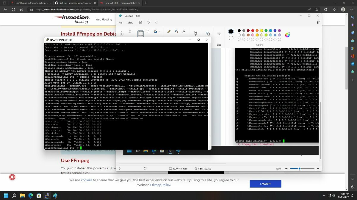

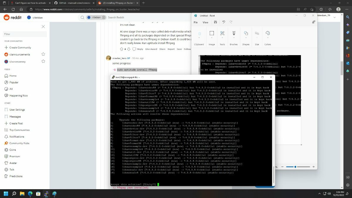

First, after multiple attempts to create webcam.txt files, trying to download and install "Crowsnest", sacrificing a live chicken and then beating it against the side of my Voron, I started taking screenshots of everything, and comparing them to each other when the next failure occurred.
So, crowsnest failed to install because the Orange Pi didn't have an FFMpeg,  whatever the f... that is.  So i spent half an hour googling "debian install FFMpeg.  Found a command line script to install it, and ran the script.  That, of course failed, because I neede the following "dependencies".
Geat, so another hour or so google searching each of these things by name, until i found a copy/paste command line to install each.  After I managed to install some of these things, apparently of them was just the right one, and afterwards I got the option to "accept this solution".  I typed Y, hit enter, and it installed a whole bunch of shit.
  I went back and tried the "ffmpeg" install command again.  For the first time, something actually worked.  Oddly, this time It gave me a list of other dependencies that needed to be installed as well.  So, I typed Y and hit enter, again,  and got this:
Naturally, at this point the cam still wasn't working in Mainsail.  So, i went back to the Crowsnest github thing, and copied/pasted the install command into the ssh terminal, and oddly, it worked.  Crowsnest installed this time.
Feeling confident, i rebooted the Orange Pi and opened up Sailboat, and it was working!  No webcam.txt files. No config files.  Just, a webcam image of my assistant, who took care of the sacrificed chicken.
There.  Done!

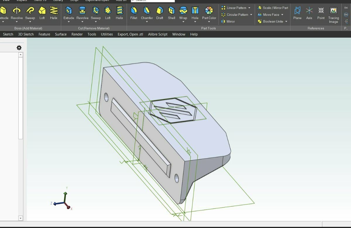

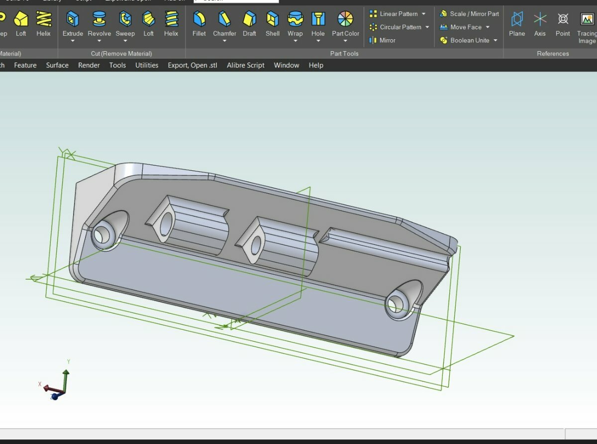

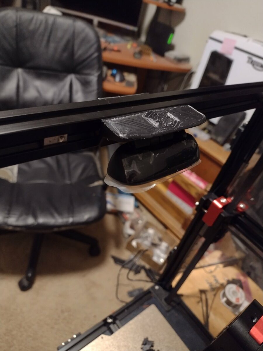

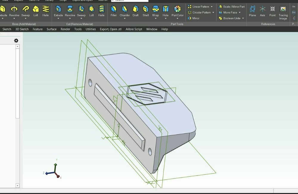

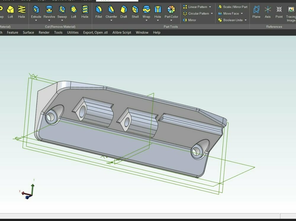

I modeled up and printed a mount for the C270.  It replaces the little clip thing that comes on the camera.
Just peel off the rubber screw covers, remove the screw, push the pin out and replace the clip with this part.
I printed my in black ABS.
Here it is for download, on Printables.
