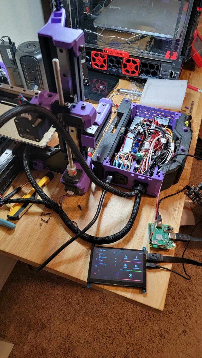

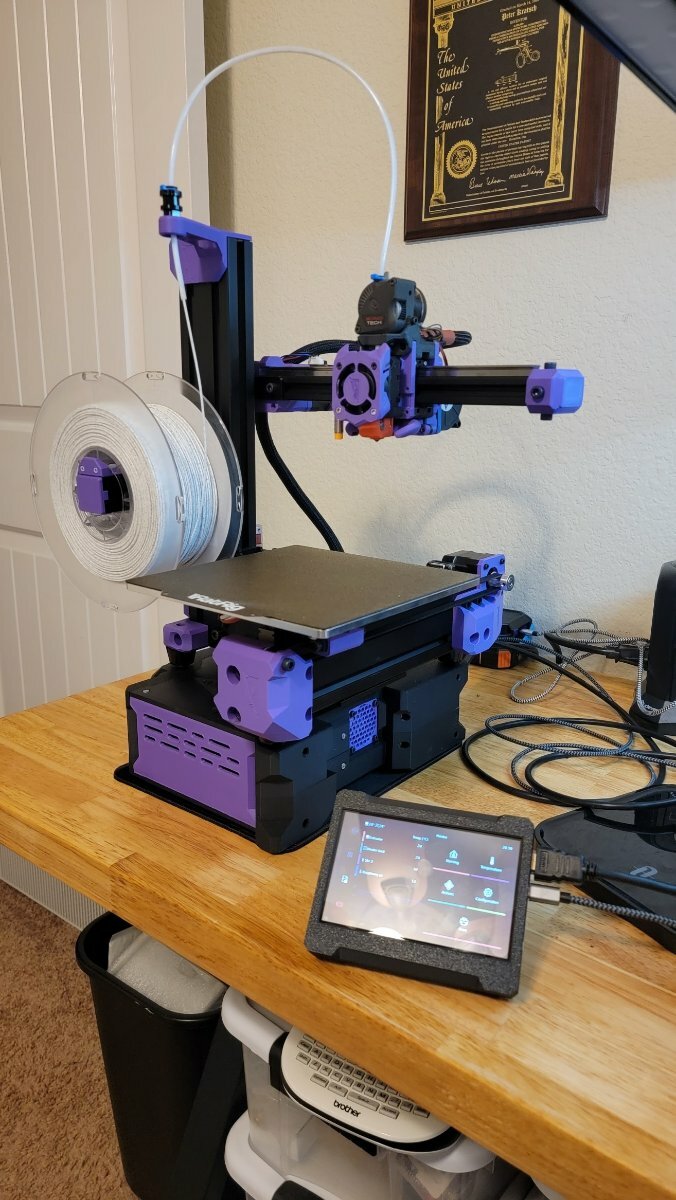

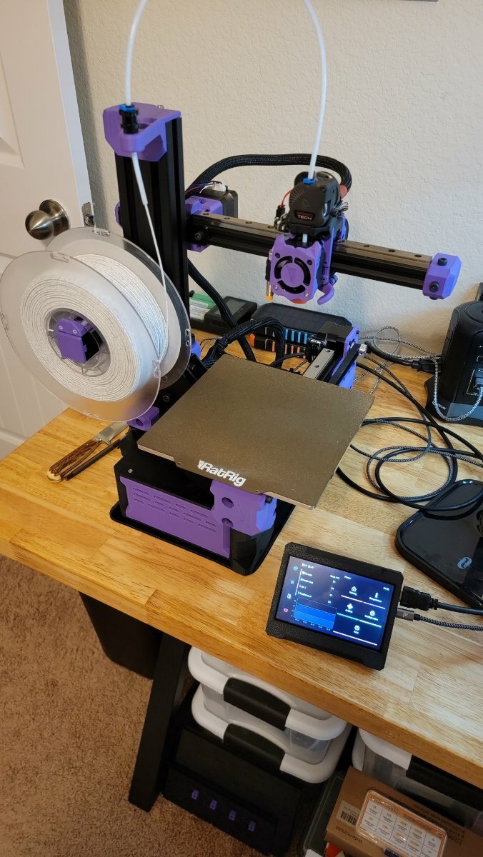

OK, Got the RatRig ready to travel. I decided to not change the WIFI but rather... Add a Klipperscreen. This little printer is so automatic that all I need to do is load filament and click on one of the many g-code files I already have loaded.
The Klipperscreen install involved getting a 5" screen and a USB Hub Hat for the Pi 3A+ as it only has 1 USB port and it was being used by the SKR-2.
