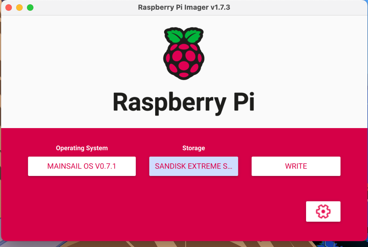

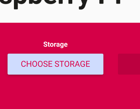

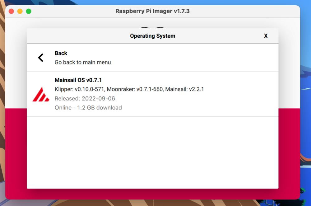

The easy way to configure the WiFi, in my opinion. I use a Raspi imager which allows for this to happen when writing the image to the SD card - much easier than editing the file in an editor.
https://www.raspberrypi.com/software/

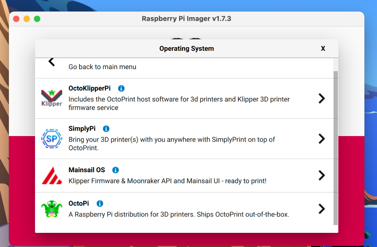

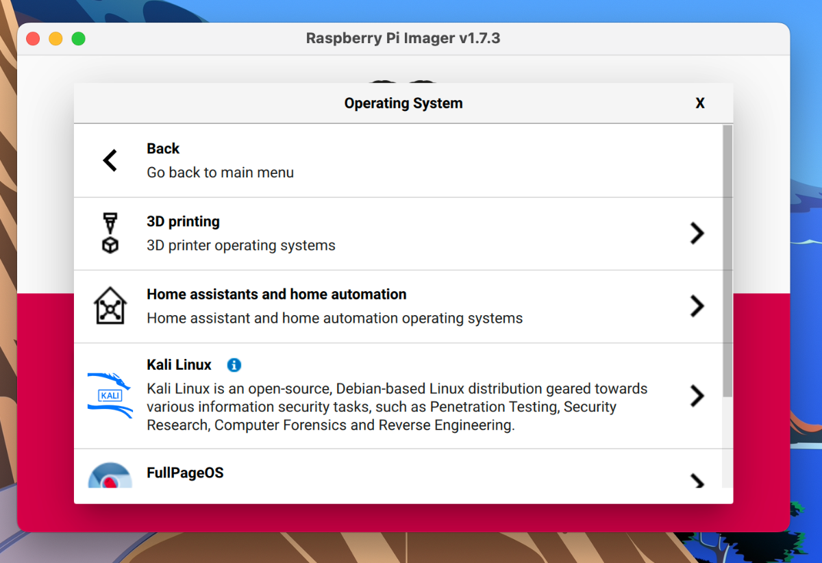

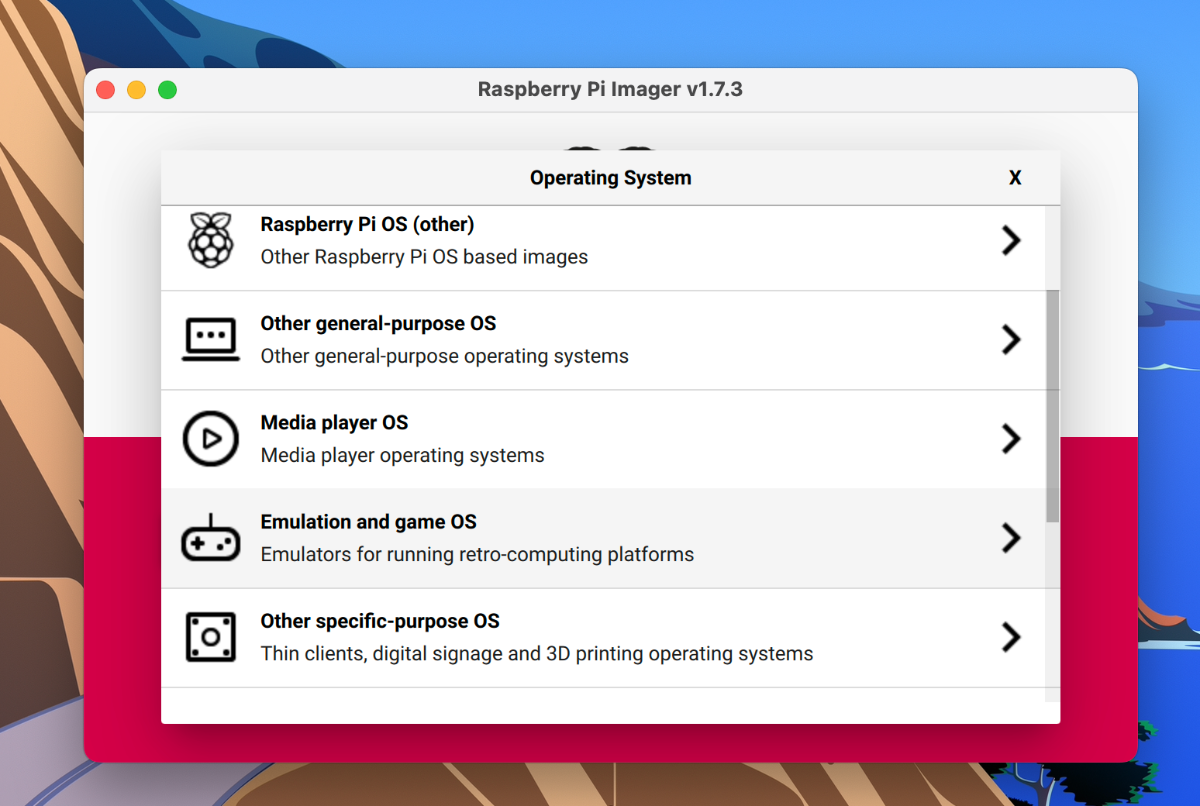

Use other specific-purpose OS:
Then choose 3d Printing

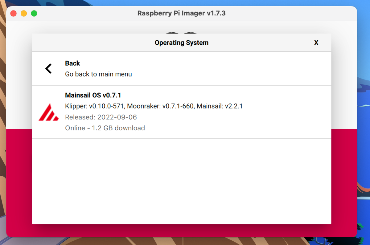

Mainsail OS:

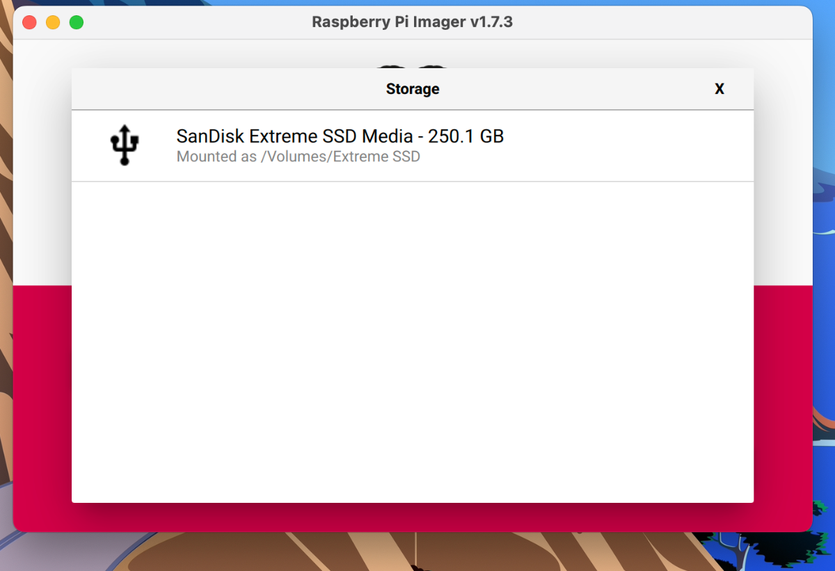

Choose storage

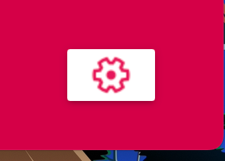

Then before choosing Write

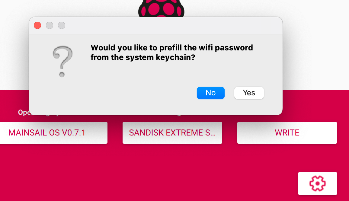

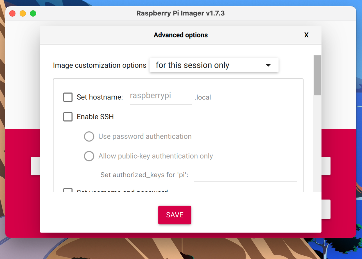

Click on the gear icon:
Now the main happens:

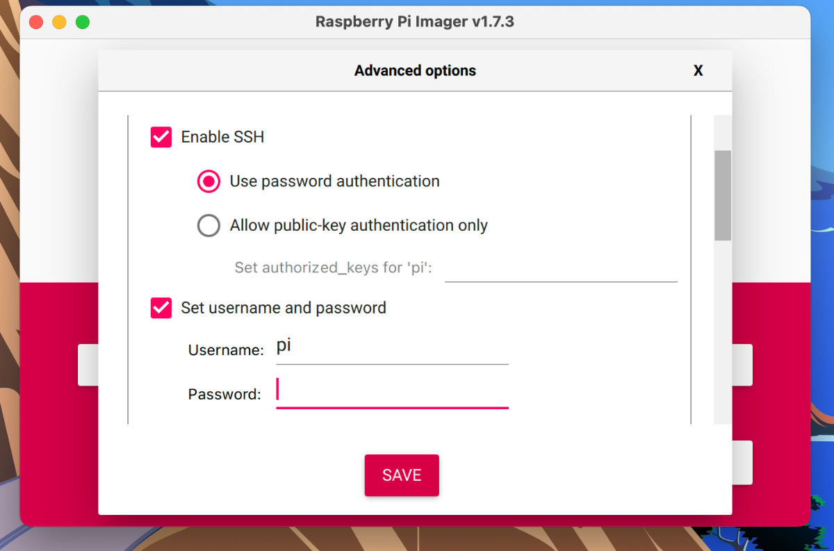

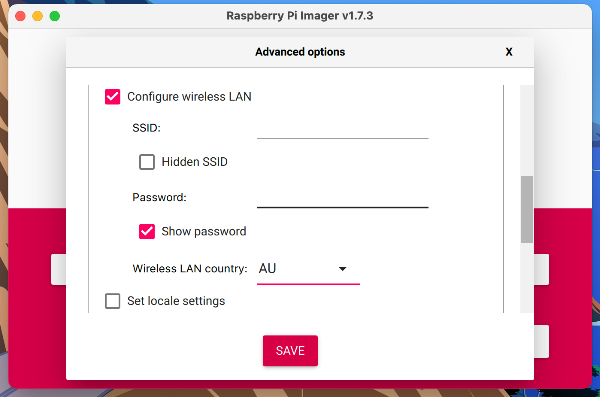

Obviously click yes and fill in the parameters: (Tick all the boxes you want the OS to pre-configure.)
For wireless settings:
Once you happy, click save and then write the image.
And Wha-lha - all done without much effort at all. (Only issue may be that it is configured for mainsail, but you can always change that through kiauh and install fluid.

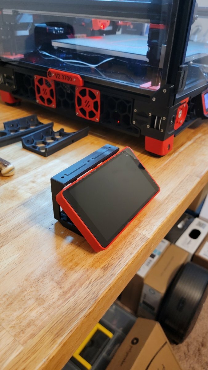

I'm hoping I can plug in the printer at my sisters house and connect with my laptop. If I can do that... I'm golden. I have ~50 g-code files that can be printed on the pi already. What I really need is a screen that I can plug in to my V-Minion with klipperscreen. Then I don't think I need to be on wifi at all. Hmmmmm
I happen to have this 6" AMOLED hanging out... Maybe... Just Maybe...
