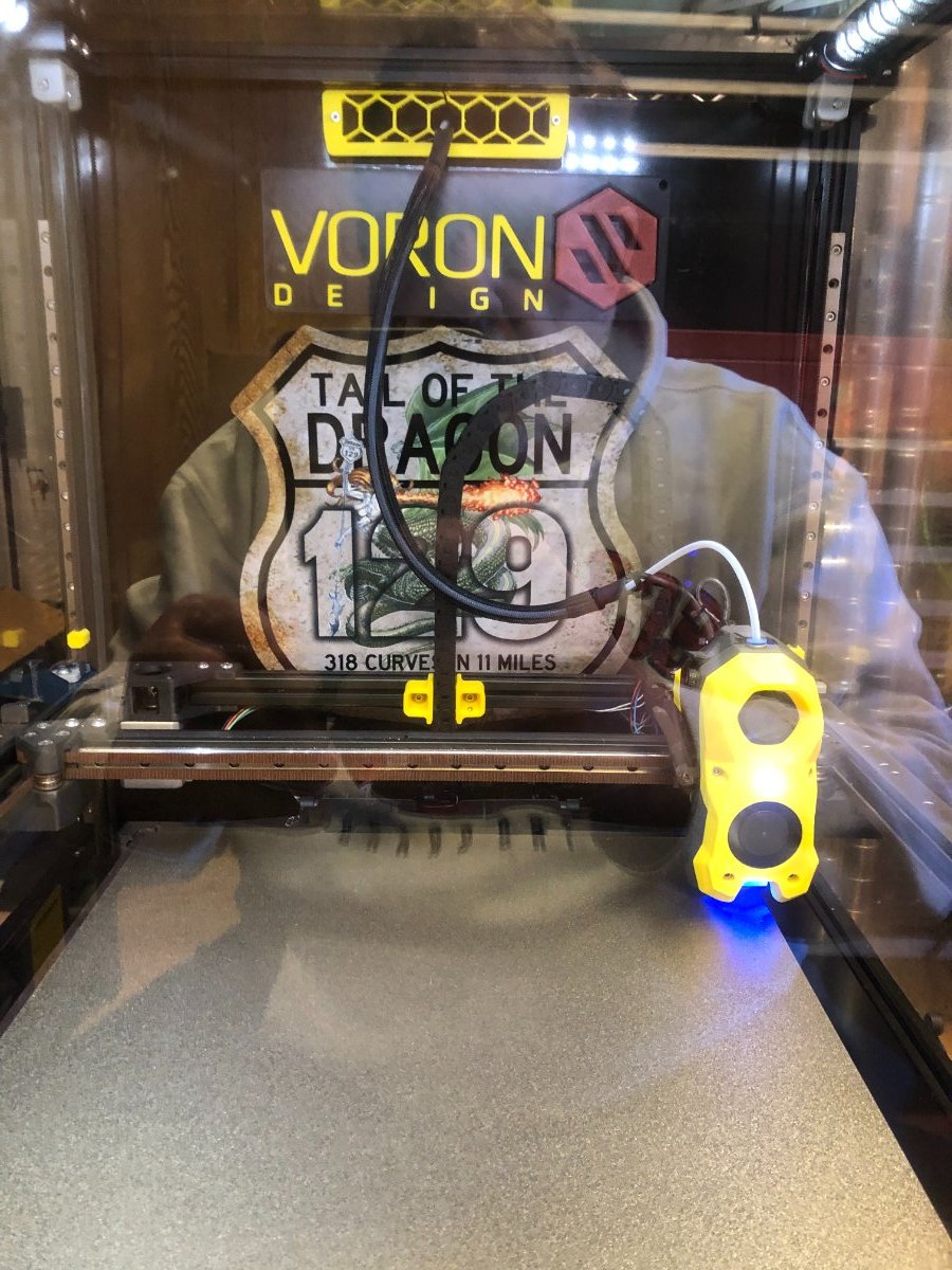

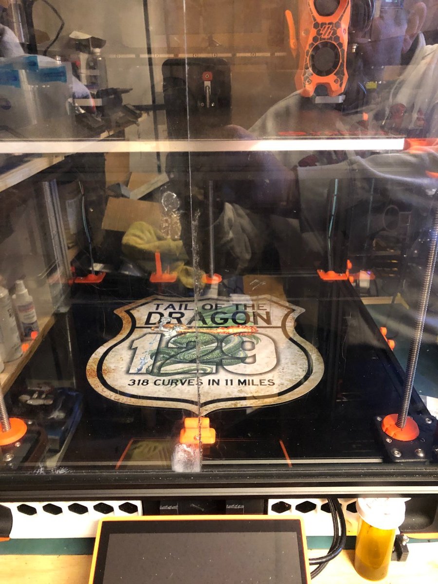

I purchased these signs last year when we travelled to the southern US and drove the Blue Ridge Mountain Parkway and the famous Tail Of The Dragon. I was looking for a home for these two signs and figured the printers would be a good home. For those who aren't familiar with Tail Of The Dragon it is an 11-mile stretch of road with 318 turns it is an awesome feeling to accelerate out of the corner and downshift for the next! Blue Ridge Mountain Parkway is a stretch of twisting 400 miles of road through the scenic mountains and a thrill to drive.
IMG_2831.thumb.JPG.b8b541144d5283060d839534f3396562.JPGIMG_2832.thumb.JPG.0780c3697850f8f24134b92fd1a0b1e8.JPG
Edited by PFarm

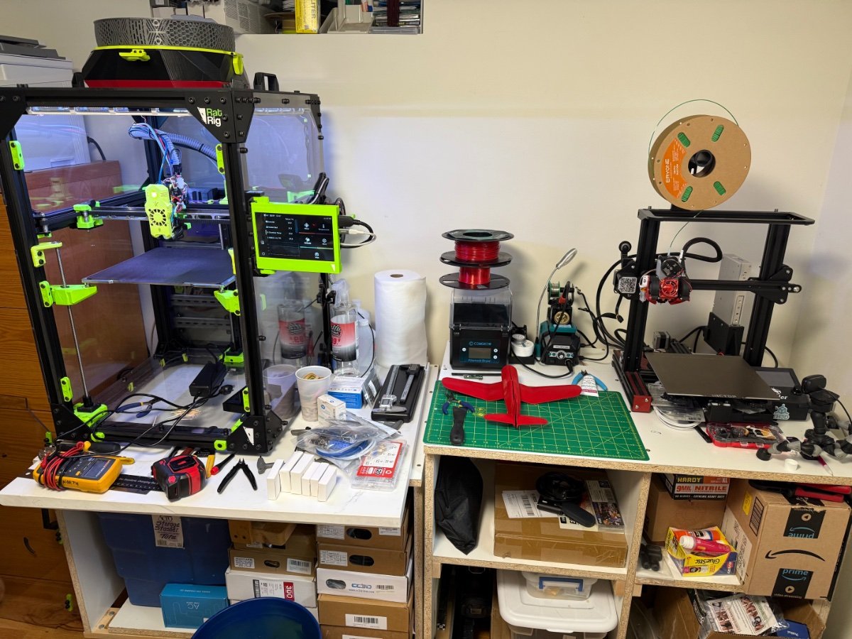

I'm looking to jump into a build on the Box Turtle, as I've been watching the development over the last six months or so since this iteration was first mentioned by MakerMylo.  I purchased an ERCF kit many months ago but haven't been able to get the time to start this. And, given the headaches people are complaining about with the Rabbit, with the benefits of this one also described, I'm very inclined to sell my kit and start this one.
But - I'll be building for an Enclosed RatRig 3.1 300 I built last year, and updated to latest RatOS release. Reasonably modified from stock - main items include BTT EBB42 toolhead, Phaetus Rapido 2 UHF with Bondtech LGX Lite, VZbot CPAP part cooling and muffler, Beacon Rev H, SFS 2.0, custom DIN electronics rails and attachments, X/Y isolation mounts, and nearing completion on Nevermore StealthMax (although some troubles here).  All around, a very good printer as I upgraded to add from my Ender 3 Pro (still have for my kids).  I'm looking to upgrade my multi-color experience as it's currently a fully manual process.
I know my config isn't near mainstream for base Vorobn toolhead builds as it doesn't have the Stealthburner family of toolheads (Orbiter extruder and CPAP cooling changeup, I think mainly), so I figure those points are where many issues may come up.
Looking for some tips here from those who have built the Box Turtle, and your experiences seem to show very good chances of success here -
The tricks I'm seeing is going to be adapting to the size of the Rig.  Some questions -
  • Cutter - I see an early reference to a different cutter.  Is the Snappy cutter still a thing?  I've seen some toolhead cutters on Printables that could be usable for me.  The official recommendation is the FilamATrix on the Stealthburner. I'm not opposed to either, but also haven't been able to discern where the actual cutter seems to be better.  My suspicion is that mass reduction for print performance may prevail here, but contradicts the recommendation in GitHub. Ditching my current toolhead setup isn't something I'm drawn towards given the cost to do so.
  • Is the cost reduction of self-source worth the extra work?
  • Frame match up - Vorons and RatRigs are slightly different in their sizes.  It seems that I'd need an adapter to mount the Boxturtle to the top of my Enclosure?  Or - custom sized frame for Boxturtle? I'd like to keep a low horizontal profile on my printer base - so mounting to the top of the printer seems the likely direction.
  • I did find a Printables toolhead filament detector for the LGX Lite - in process of assy.
I'll continue to watch the progress here and look forward to your insights.  My main theme is to build on the shoulders of others, but I'm not opposed to jumping into a build.  My kids certainly want to see the more near term fun. 🙂
Thanks in advance!
Edited by Coeus
Incomplete post.
